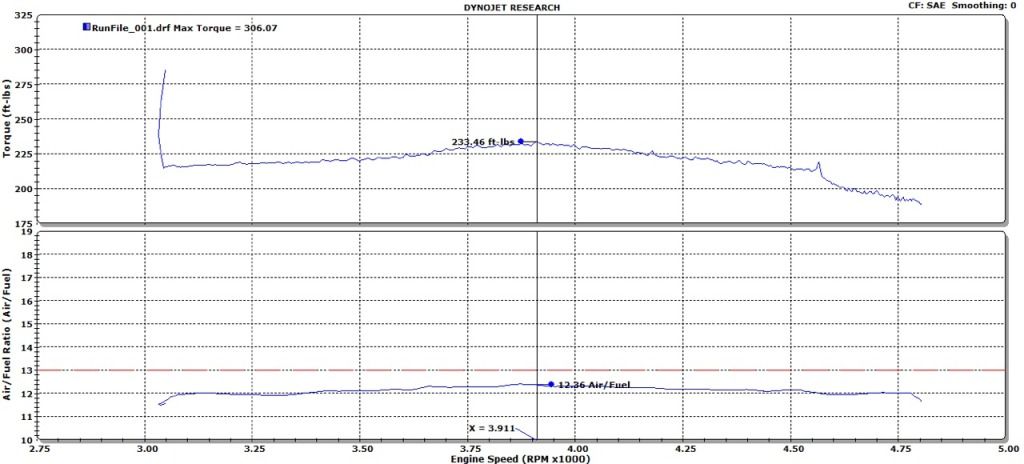

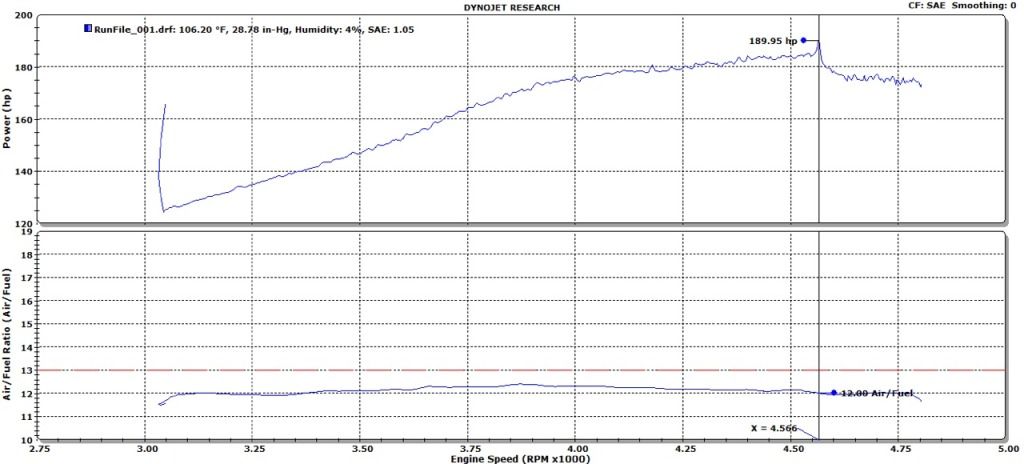

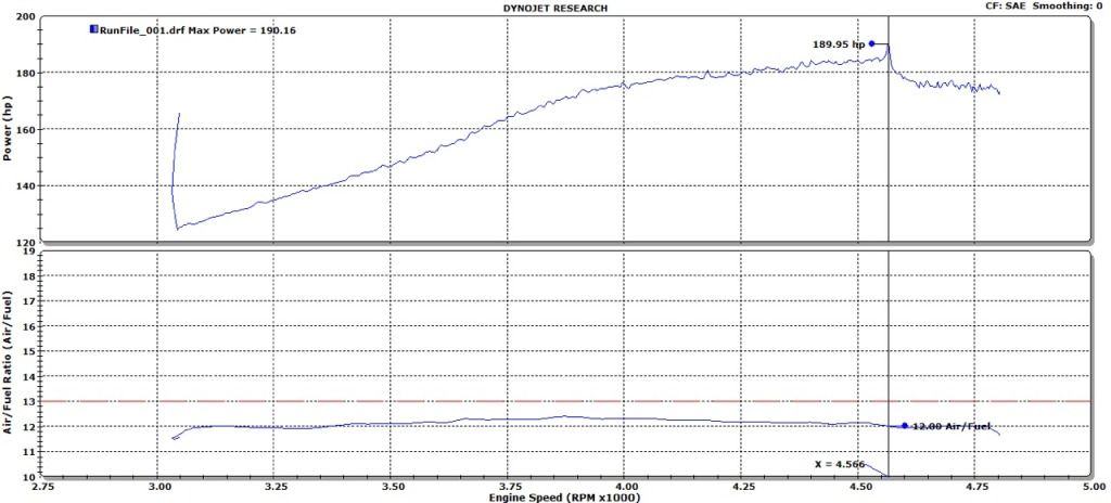

First run (not really a baseline, as some adjustments had already been made):
Horsepower-
190hp
Torque-
233tq
Temperature and dyno conditions at first run
upper left hand corner

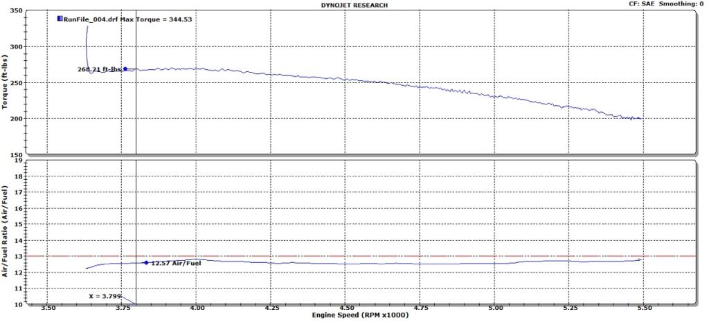

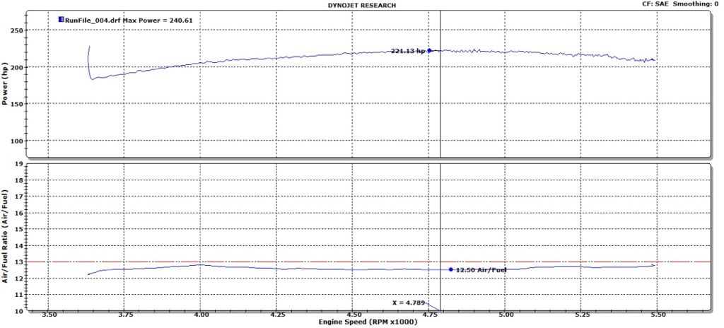

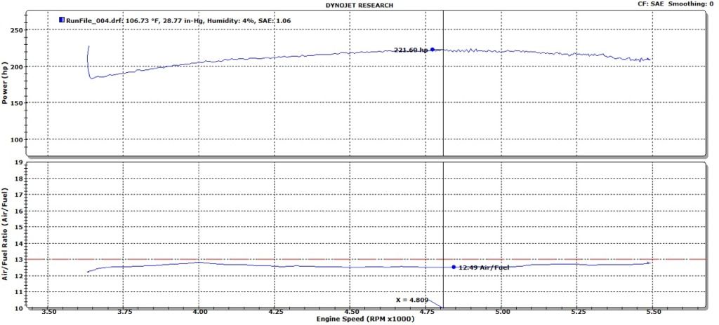

4th run- Horsepower 221rwhp
4th run- Torque 268rwhp
temp. and conditions at 4th run
upper left corner
