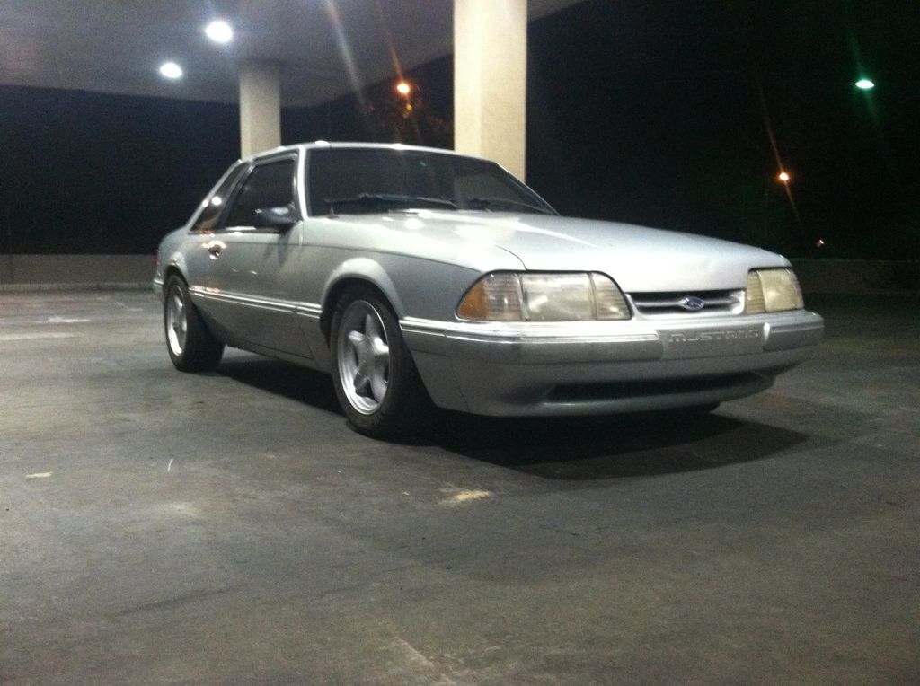

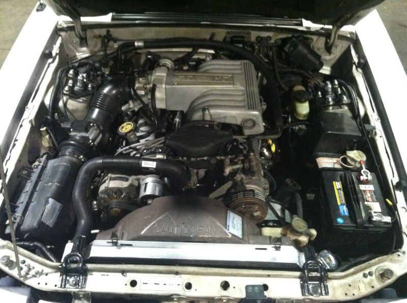

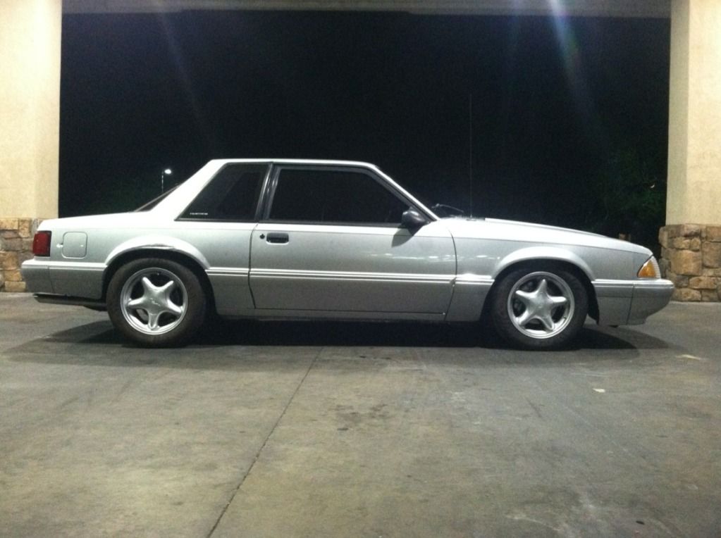

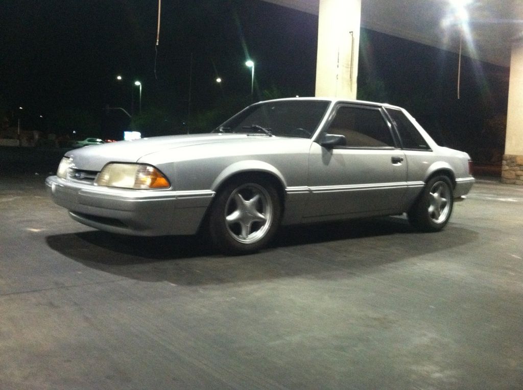

1993 4-cyl. To v8 302 swap! Eye candy ;)
Mnstr50
I've been driving the beast around, the AC and cruise are functional, which is a plus! the alignment is off, so I need to find the time to get that taken care of. The TV cable needs to be set, as it's prematurely up-shifting under light load. Once those two are taken care of, I'll get the car on the rollers so we can see what kind of power this thing is making.
