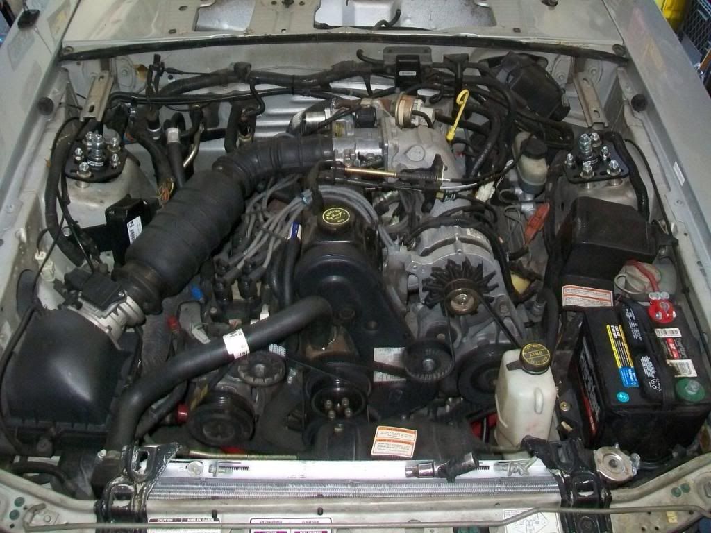

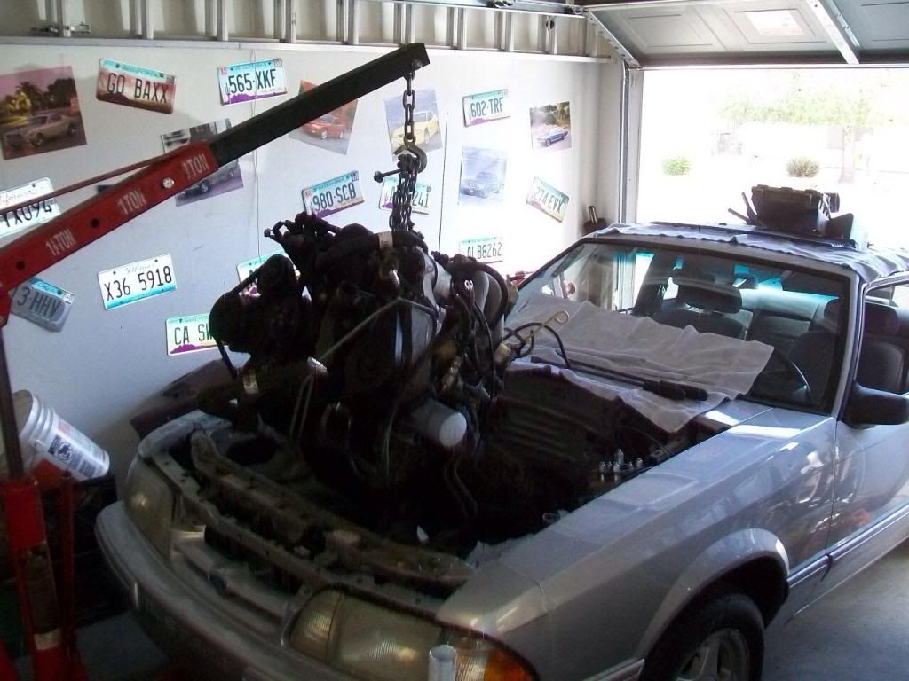

Hey everyone, I purchased a 1993 4-cyl. notch a few months ago with the intension of converting the coupe to a v8. Little did I know the true magnitude of the process that is involved to do the swap right. For those interested in doing this conversion, I encourage you to source a factory v8 coupe, but if you insist on tackling this swap, there is what's involved;
Items that are different;
Front spindles
Front sway bar
Front strut
Front brake rotor
Front brake caliper
Brake booster
Brake master cylinder
Brake lines
Fuel lines
Headlight harness
Engine harness (specific for model year, my 93' needs 93' specific harness)
Engine computer
Gauge panel
Rear axle (of course)
Rear lower control arms (no provisions in the 4-cyl. Lower control arms for a sway bar)
Transmission (in my case converting from auto to auto)
Transmission shifter assembly (AOD has "1, D, OD", A4LD has "1, 2, 3, OD")
Radiator
Radiator fan assembly
AC system
Exhaust system
Intake system (harness will also depend on MAF or Speed Density)
Steering rack (v8 has a quicker steering ratio)
My best advise in this case would be to find a DONOR v8 car to strip. This is exactly what I did! I purchase a 1990 Ford Mustang LX convertible, with an AOD. I later sourced the proper 1993 engine harness to accommodate the conversion.

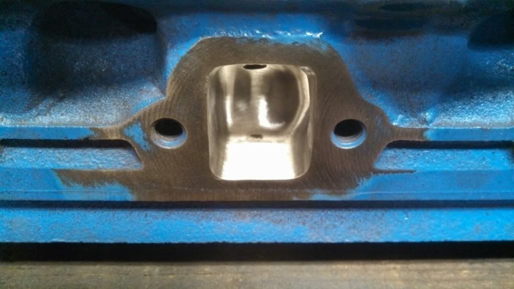

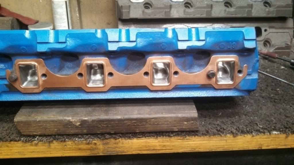

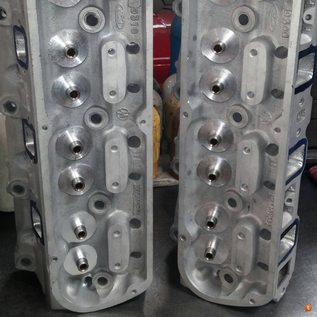

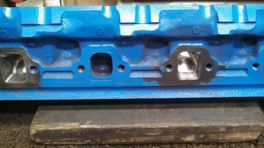

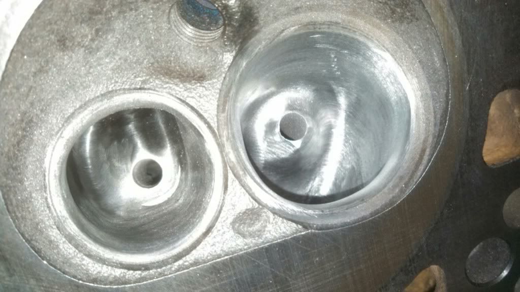

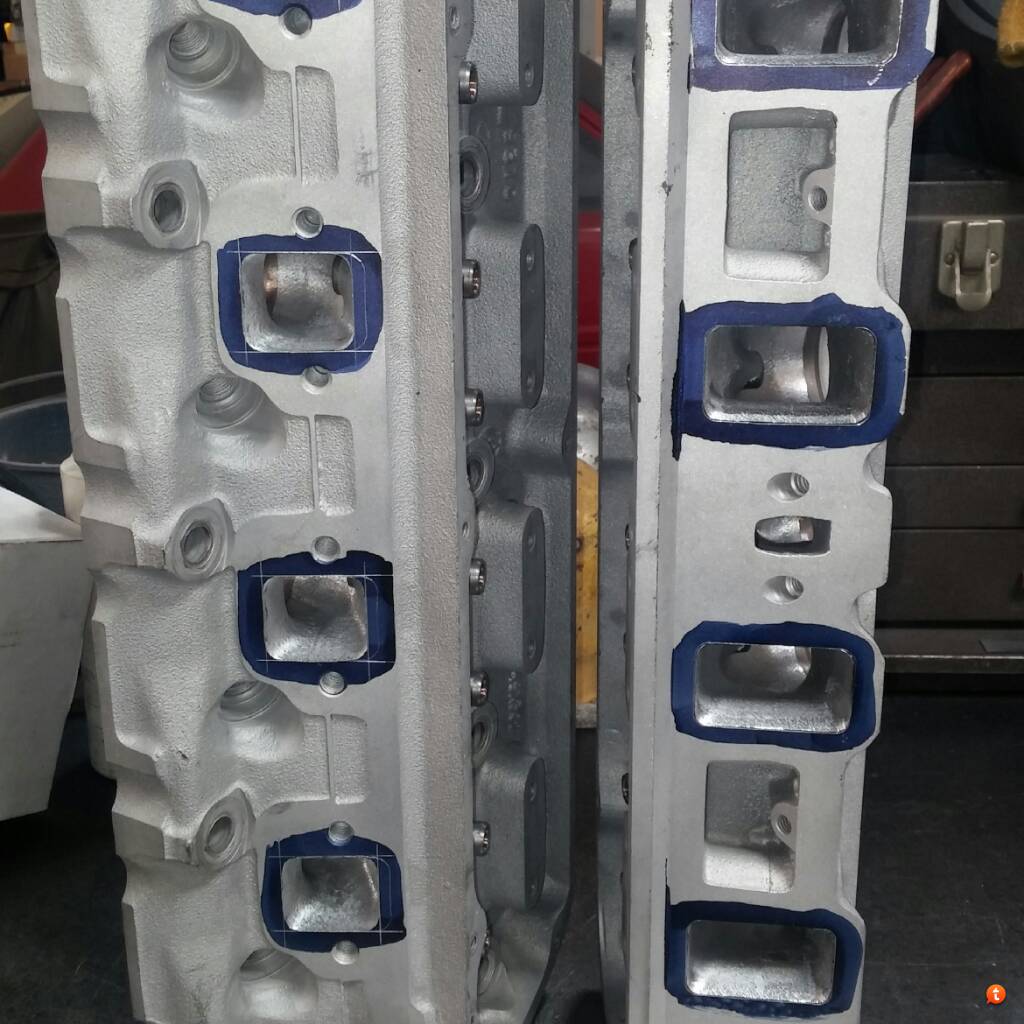

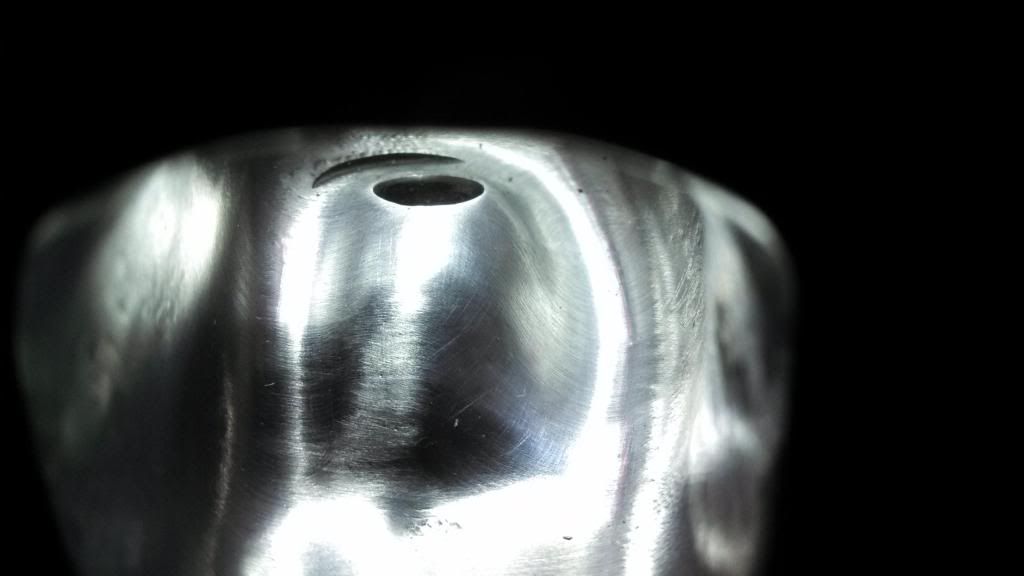

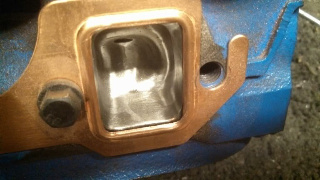

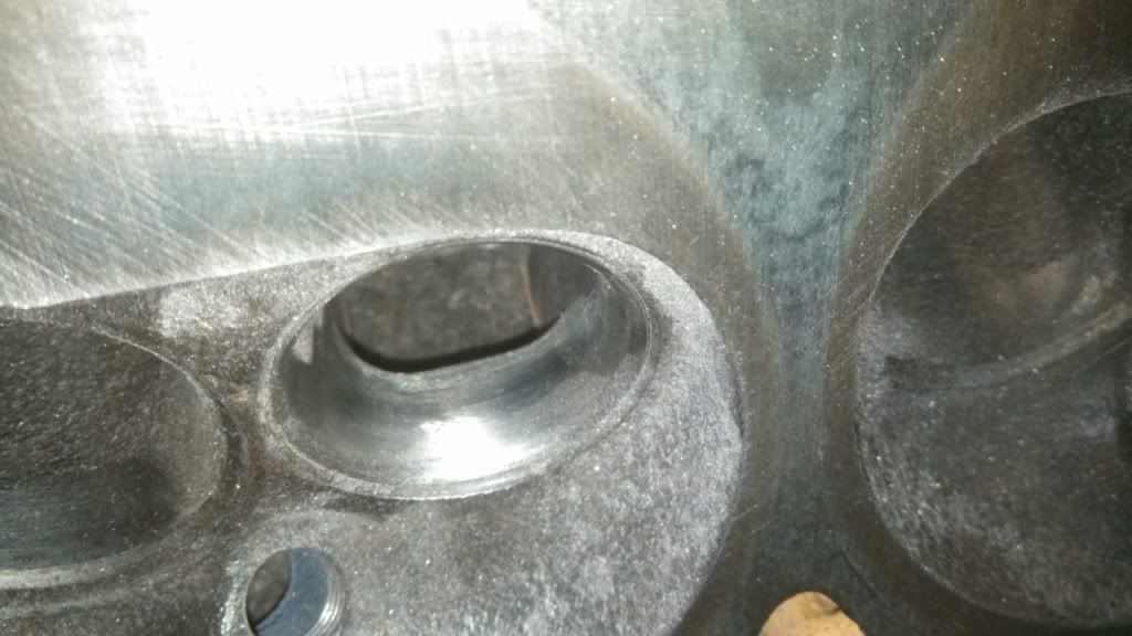

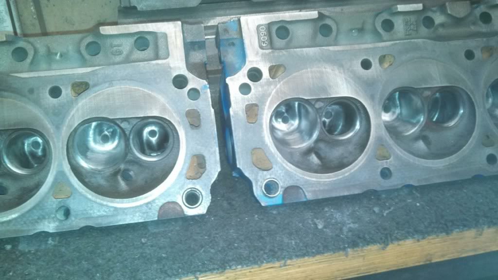

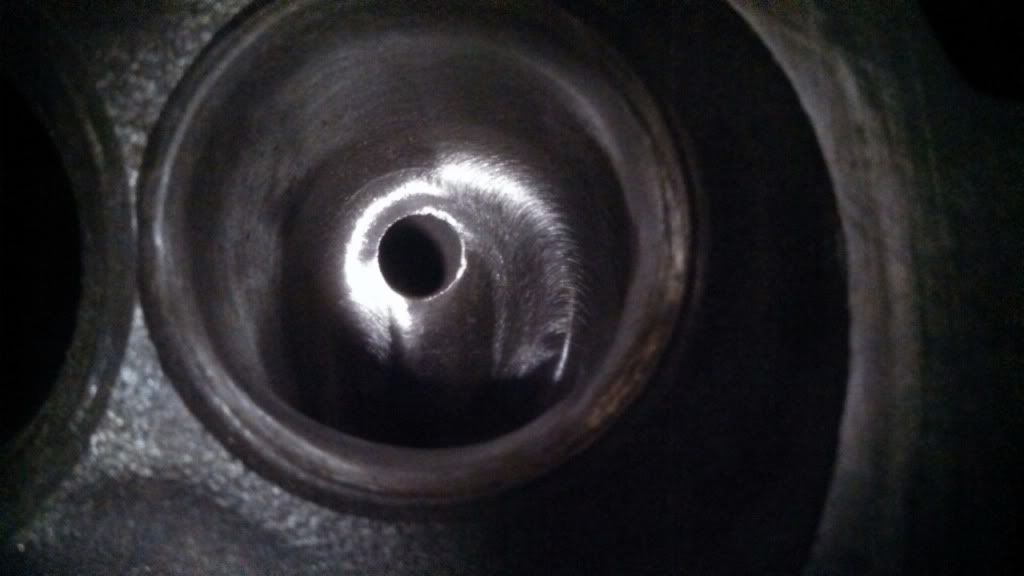

Pictures of Mike starting the port work
Stock vs. ported
Inside radius
Bowl
Contact Mike, he's an extremely friendly guy and very knowledgeable. Great work, great prices.

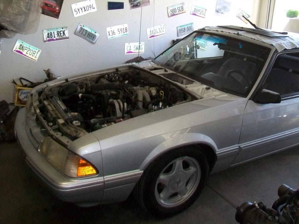

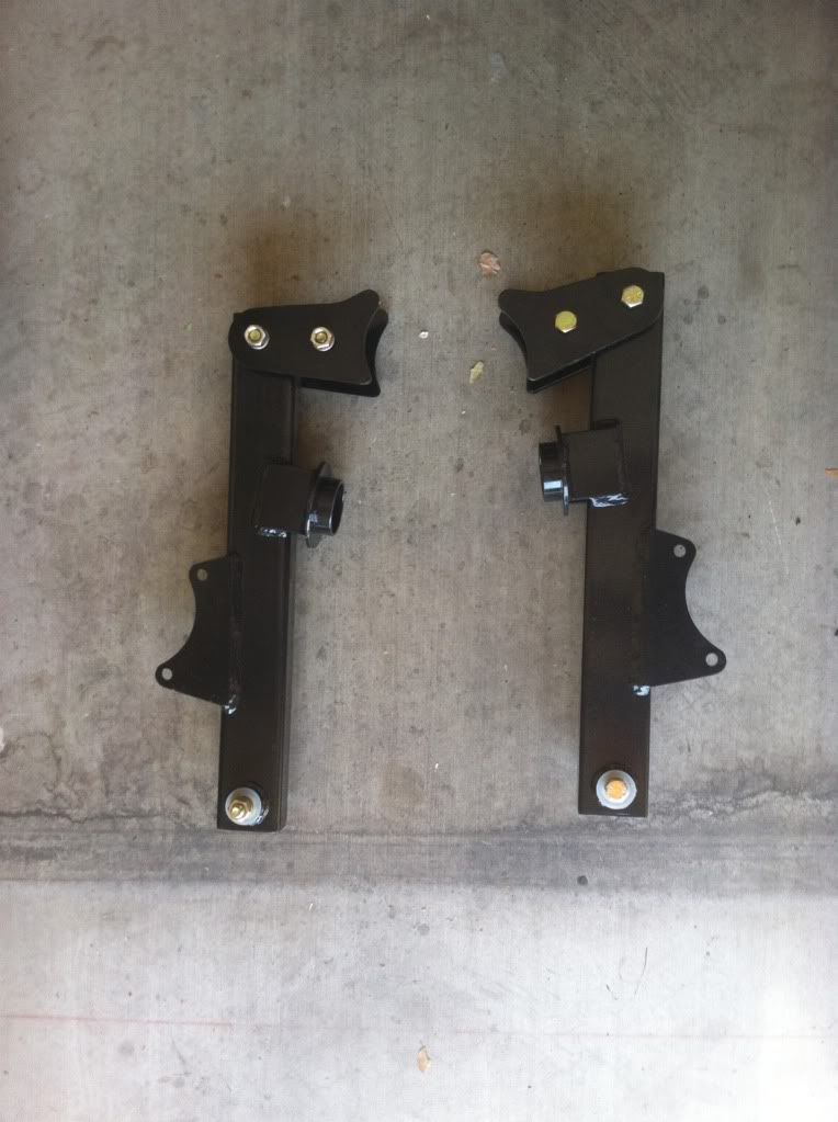

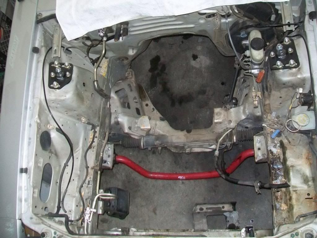

Check out these lower control arms!!

Mike has a few "stages" of porting, with a stage 1.5 costing me $400, this does not include the cost of machining, cleaning, assembly. The porting to the lower intake a manifold and opening up the throttle body for a 75mm costs $175.
Mnstr50
Not to bad
Sent from my LG-D800 using Tapatalk
Honestly, I called up a few shops in town to get an idea of the cost for porting on iron heads, and most shopped declined to even touch iron heads! The only two shops that would port on these heads wanted well over $900 dollars. Of course, shipping them out for port work was also out of the question due to the cost of shipping, and turn time. I "could" have gone with aluminum heads, but I wanted to see what I could do with some factory castings. Mike has several years of experience and he's currently running low 12's in his notchback with the factory E7 heads, and STOCK intake manifold (ported)! I figure the GT40 heads are a reasonable step up, along with the ported Explorer intake manifold. I also wanted to demonstrate a "budget" minded build. The strip will be the ultimate test, so we'll see when it comes together.

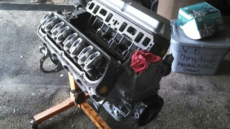

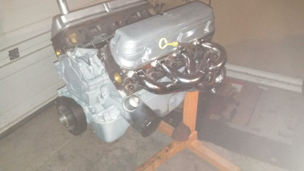

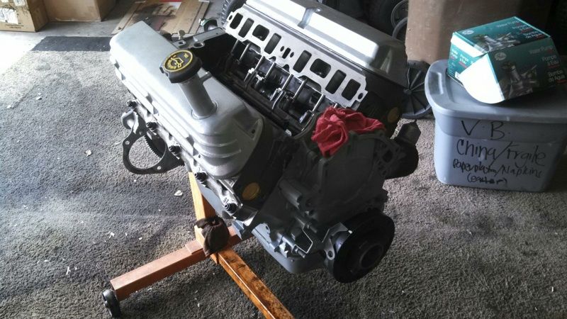

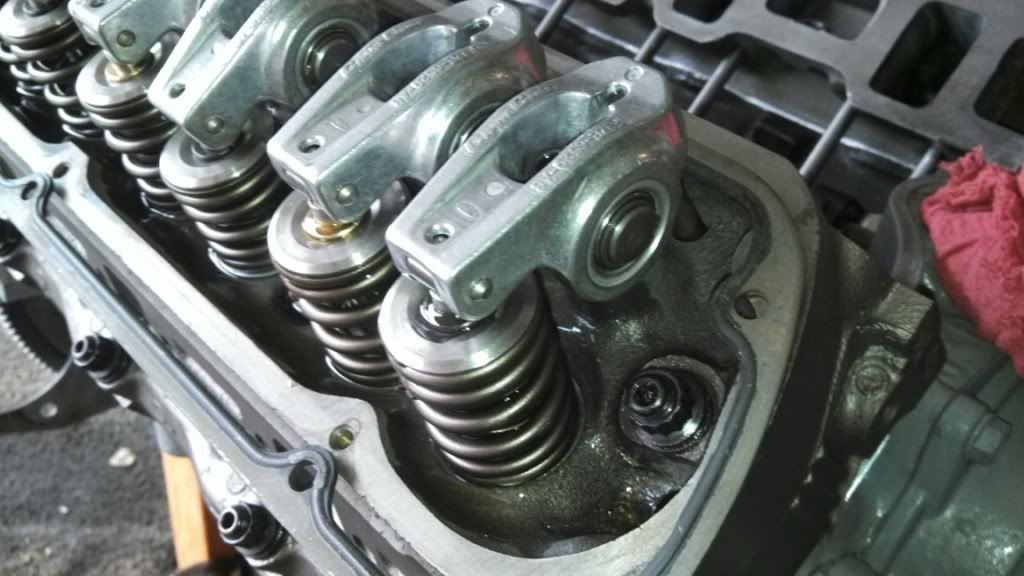

Motor coming together, trying to stay with grey colors to make it appear stock! lol
Titanium retainers, 10 degree locks, hardened pushrods, 1.6:1 crane roller rockers. The details make the difference!
Equal length 1 5/8" shorties (MAC);
ARP head studs, FRPP gaskets throughout.
