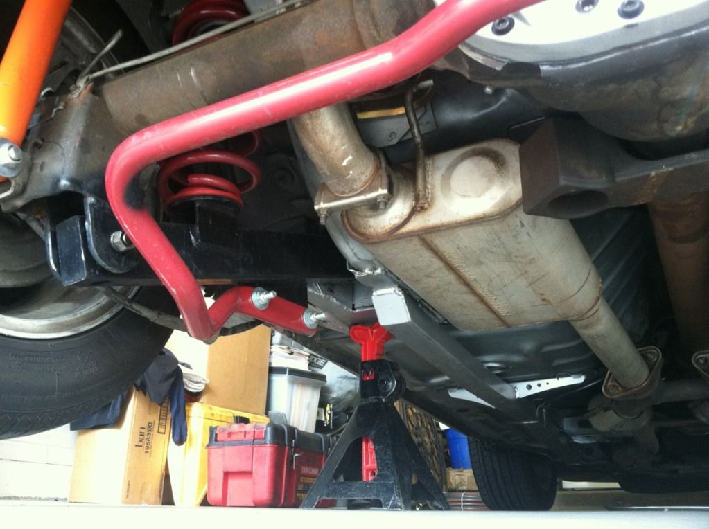

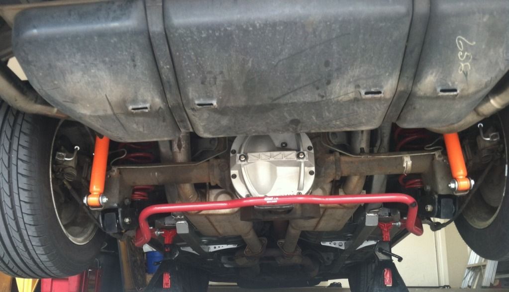

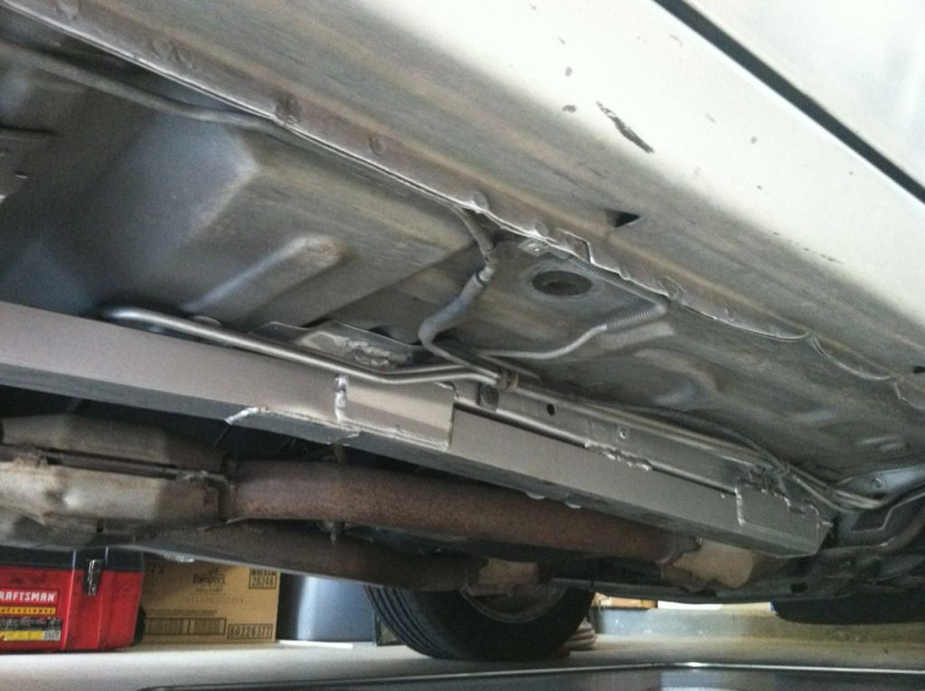

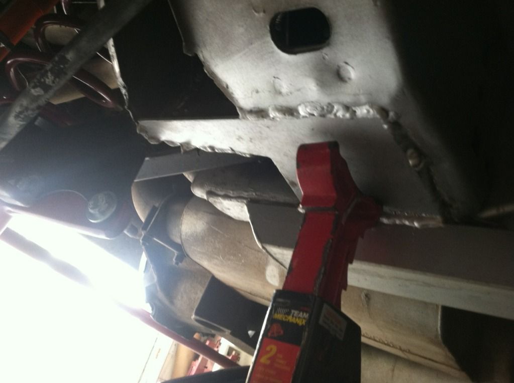

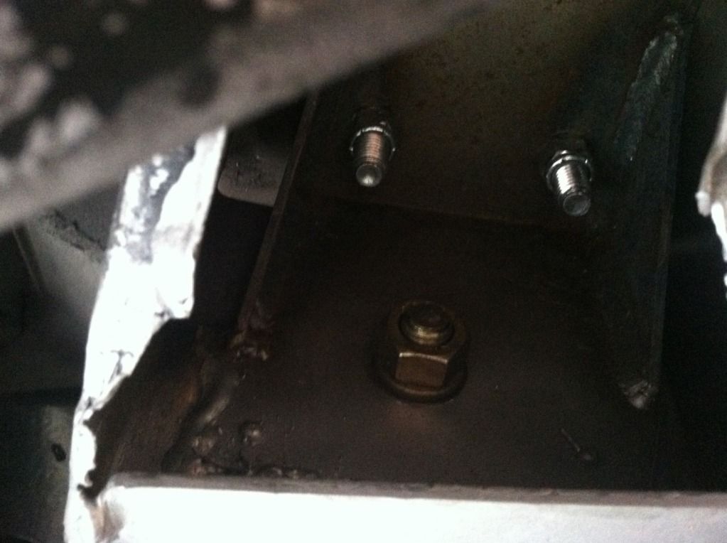

Ok here are some pictures;
Subframe connectors-
Lower Competition Engineering plates-
Lower torque box braces -
Differential cover, Lakewood lower control arms, subframe connectors-
Notice the rear lower control arm mounting brackets, they are welded in-
