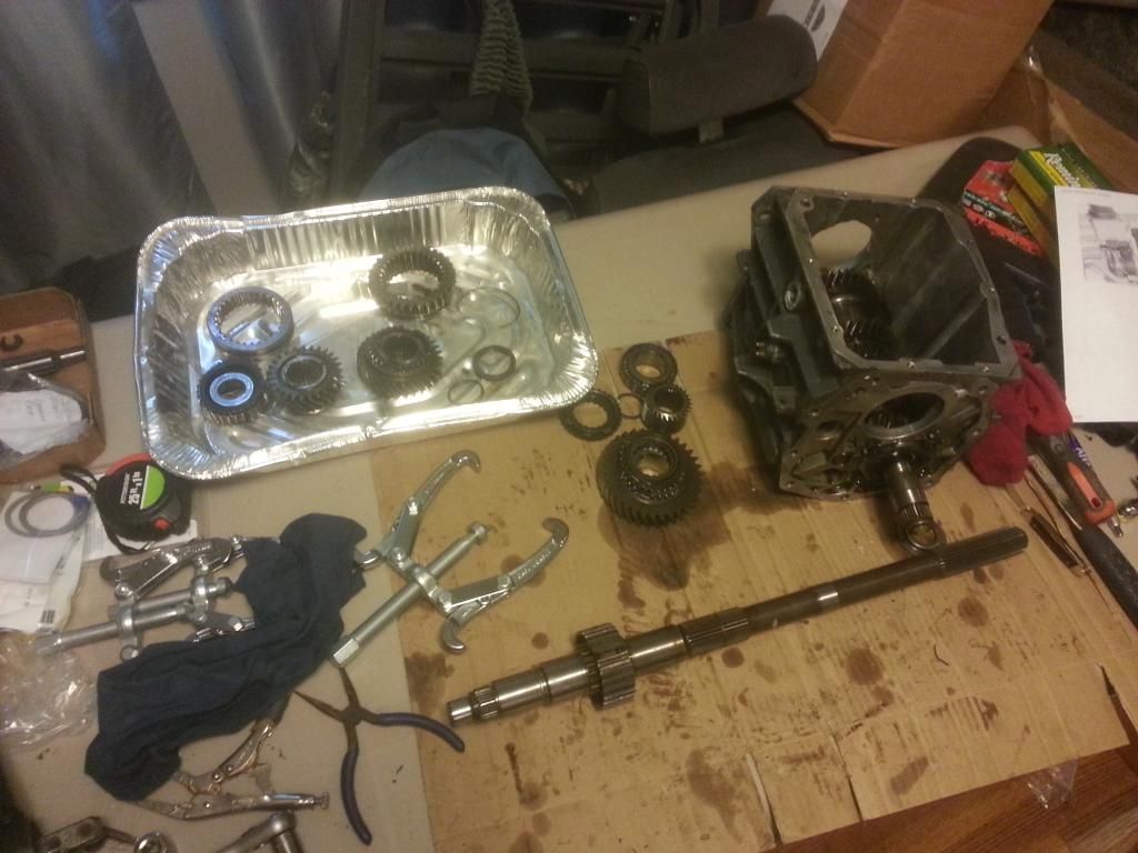

I tore down the original T5 that came out of it and the rebuild parts should be here tomorrow. All of the gears and bearings looked pretty good, but the synchros showed some wear. I went ahead and ordered a new input bearing retainer and some other small parts.
I picked up another used t5 the other day from a '99 V6. It was supposed to be a good one, but I opened it up and 4th gear and reverse were trashed. Coudn't see anything else wrong with it, but I figure there's a good chance some more damage is hidden. The guy pulled a fast on on me, that's for sure. But I was researching it and it appears that this model t5 is a good candidate for a swap/upgrade. These v6 Tremecs were rated a little stronger than the older V8 models, but they need some mods to work in a fox body. They need a new input shaft and retainer...shorter length, just like swapping from the sn95 models, which had a longer shaft and bellhousing to set the shifter back where it needs to be. You can swap bellhousings instead, but the input shaft is pretty easy to swap. It also needs a tailshaft housing from an older t5, since the speedo is electronic on the 99-04. This is also an easy swap, but may be a little more difficult to find. I found the tail housing and input shaft from a guy, ordered a new steel bearing retainer, along with a speedo gear set. Oh, and the swap also requires a small hole to be drilled in the output/main shaft to accept the retainer clip for the speedo drive gear. The whole swap seems pretty simple. I'm going to keep my eye open for another one of these transmissions, since I already have the parts to do it. I started another thread on this, but it's on hold pending another transmission in better shape.

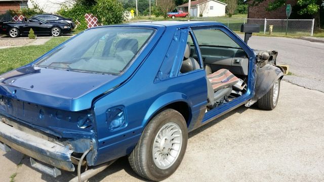

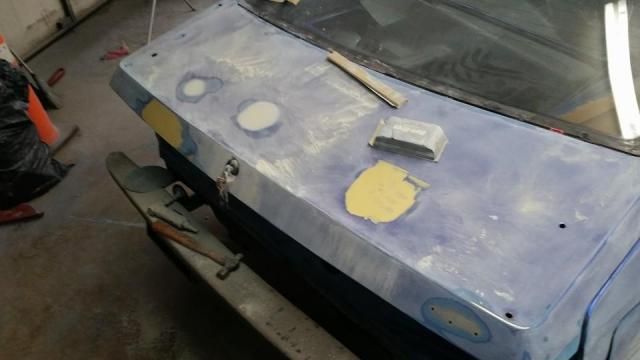

Well, the car is supposed to be going to the paint shop next weekend, depending on how busy they are. Could be the following week. The guy says it should be done in about 2 weeks. After that, I'll have to replace a bunch of trim and weatherstripping. When it's all said and done, I figure I'll be out $3-4,000. Can't help but think I could have built a nice motor for that!
In the shop as of today. I also ordered a bunch of parts, including the belt trim moulding for both doors, new windshield trim, cowl grill and lower windshield moulding kit, door and hatch weatherstripping, side skirt retaining strips and a couple other things I can't remember at the moment. I will be home before it's finished, so I hope to fix the faded moulding on the used quarter glass I picked up a while back. That way, I can replace it as soon as it's out of the paint shop. The moulding on the car was not salvageable. I'll also need to buy all new window rubber and some other parts for around the door glass. Still quite a bit of work to do, so some of it will have to wait till Spring. All of these reproduction trim parts are crazy expensive!

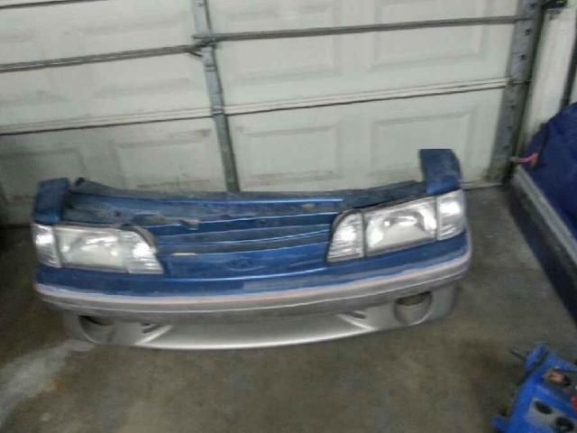

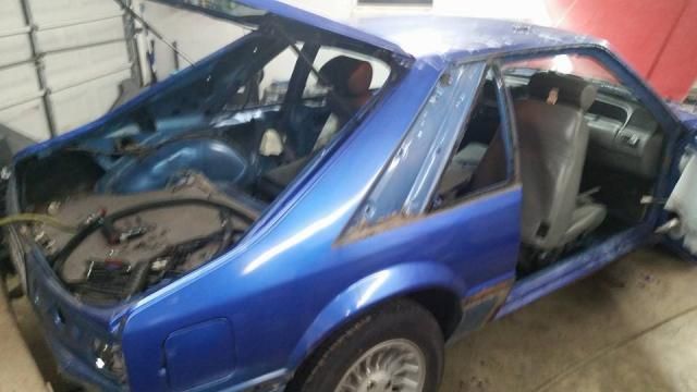

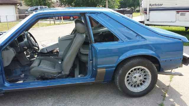

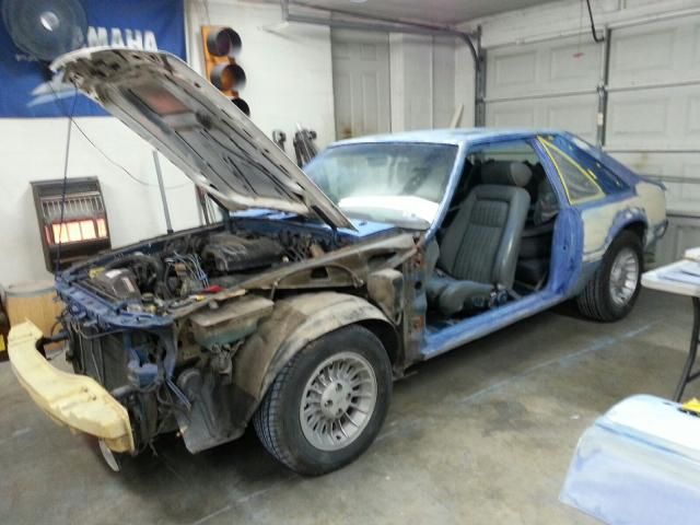

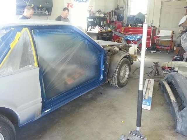

Went and visited her in the body shop today. Got to snap a few pics and check out the progress. I had to drop off some trim parts and stuff and the guy wanted to show me all the rust he found. I wasn't aware, but the passenger side has the dreaded lower shock tower rust. It looks like I had my mind made up for me. Motor will be coming out this year. I was planning on doing a top-end rebuild, cam, etc with the motor in the car...but I need to swap in my freshly rebuilt T5 anyway, so I'll just yank out the motor and transmission, have the strut tower fixed and engine bay painted while I'm doing the motor work.

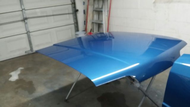

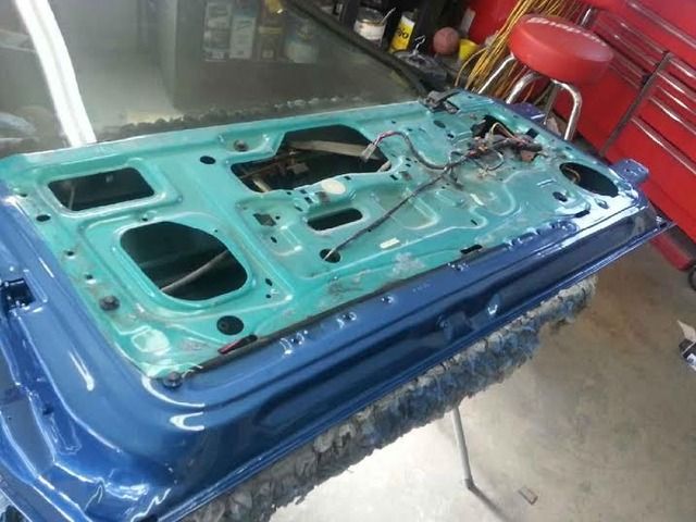

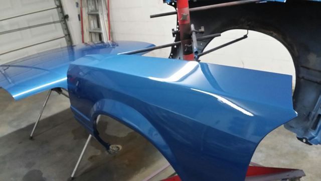

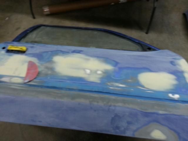

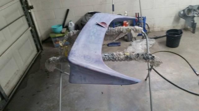

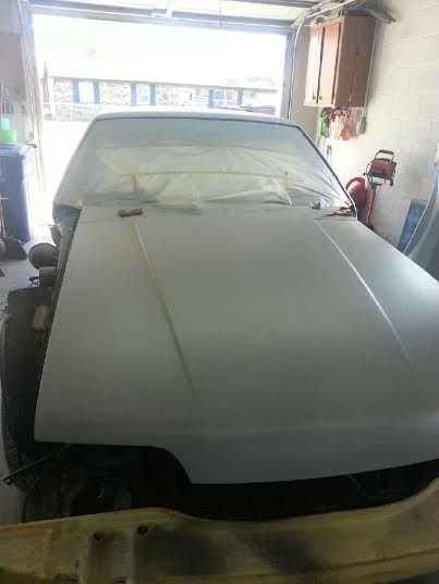

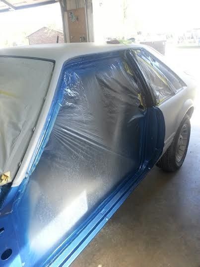

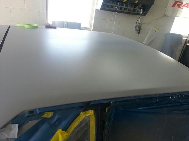

The body guy finally got back to work on my car. It got put on the back burner for a while. I stopped by to see it today and I had started getting a little upset about it not being finished already. But when I got a look at it, I was pretty impressed with the amount of work he's putting into it. Yes, it should have been finished already, but at least he's doing good work on it. That's the main thing. I'd much rather him be slow and do a good job than rush it through just to get paid.
Here's a few pics:

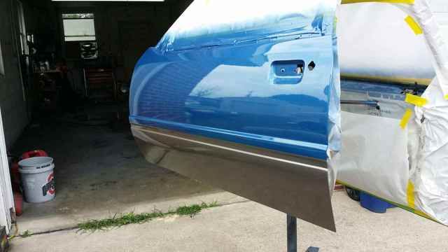

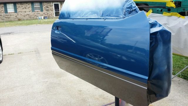

He said he ended up fixing some rust around the door hinges on both sides, and that the hail damage on top was much worse than he thought. It really didn't become apparent till he started block sanding it. He should have all of the jambs on the car and doors (including the hatch) painted by tomorrow. He still has to prep the passenger door and one fender, then I think she'll be ready for paint. The color looks amazing compared to the old blue color it had been painted with.
