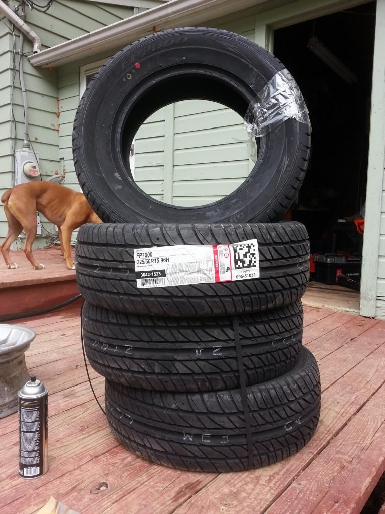

I've never mounted tires by hand before. It really wasn't too bad. I think removing the old ones was the hardest part.

Looking good! You're a brave man mounting your tires that way. As far as the dismount, I just break the bead with a tool I have and then use bolt cutters and a box cutter. Fortunately, I only have to remove them, never mount them.
I may invest in a bead breaker. I took a screw- type jack and placed it under the hitch on my truck. Set the jack on the sidewall of the tire and started cranking. It worked fine, but I got tired of cranking!
Anyway, I now have 4 matching wheels on the 88 and I can put the 10-holes back on the 82, so I'll have matching rims on both. That was bugging me to death. Guess I'm a little ocd.
Oh, and the tires were cheap on eBay. Not sure if they're any good, but they're Ohtsu (made by falken). I paid $280 shipped and mounted them myself. I figure I saved at least $150.

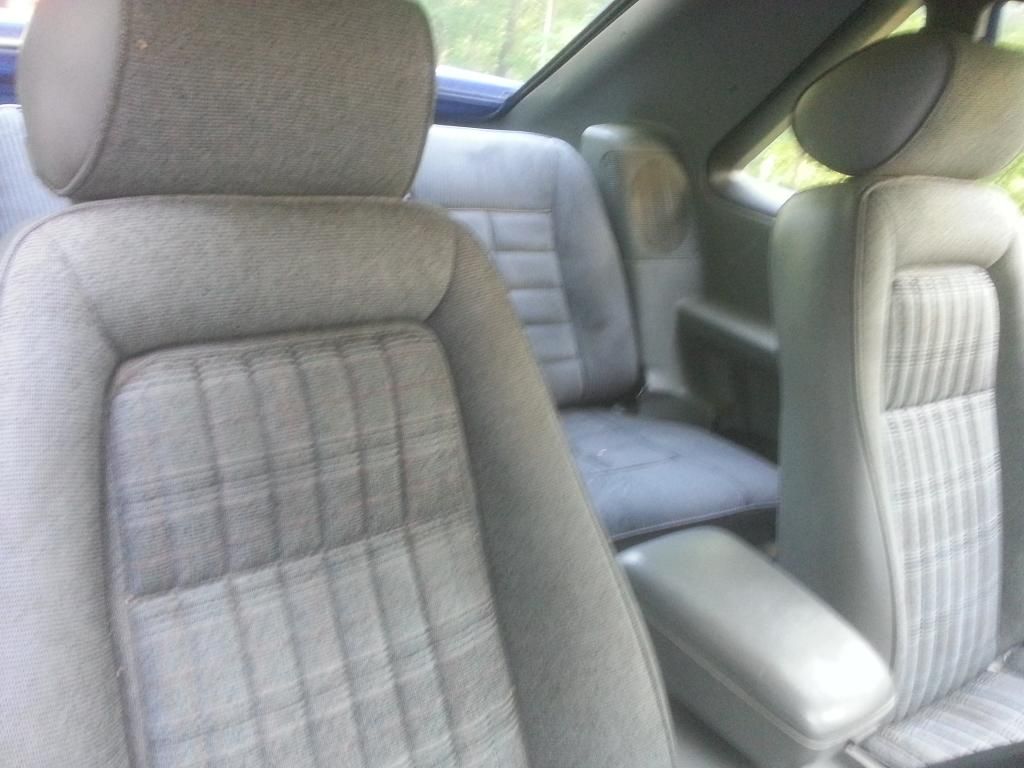

Finished master cylinder up last night and also dropped the tank for replacement of the fuel level sending unit. Finished up and got the tank back in this morning. I spent the afternoon getting the battery moved back up front where it's supposed to be. The battery cable was routed through the interior, which wouldn't allow me to install a back seat (which I picked up used the other day. ) I got the battery hooked up in the engine bay with new cables. Installed the interior plastic quarter panels I ordered online, along with the back seat I picked up from a fellow mustang guy here in town.

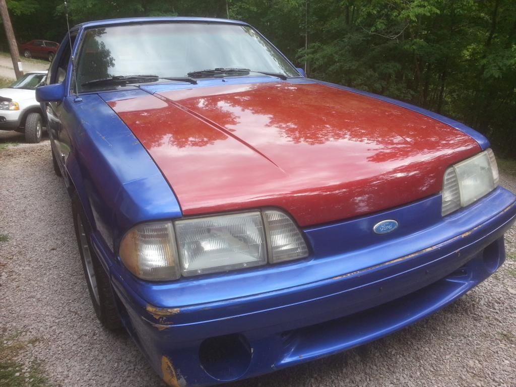

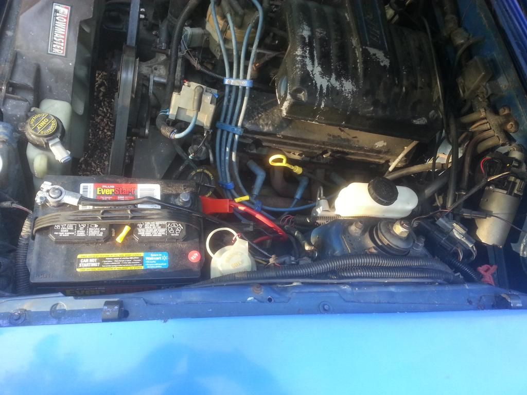

As you can see in the pic, I've got the battery unhooked. That's because I still can't track down a battery drain issue. Any suggestions would be greatly appreciated!

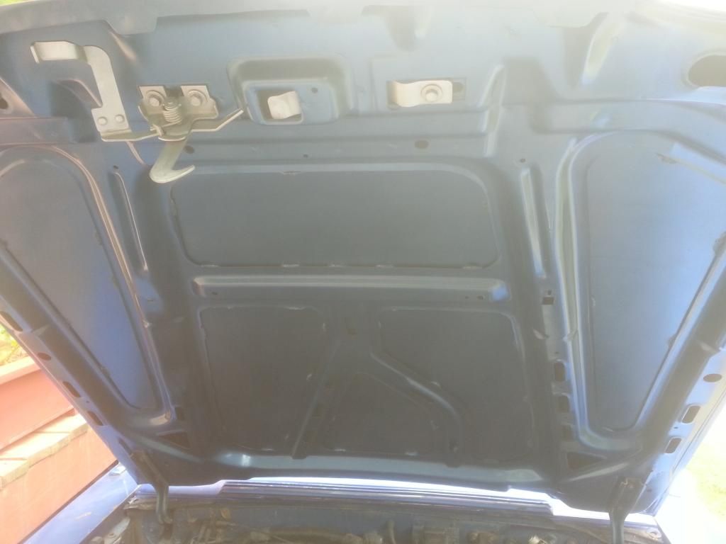

The other day, I replaced the beat up hood with a nice used one. I painted the underside and cleaned up the latch mechanism.
It was hard to get a good pic of the underside in the bright sunlight, but I painted it "Bright Regatta Blue Metallic", which was the original color. This is what she will be painted eventually.

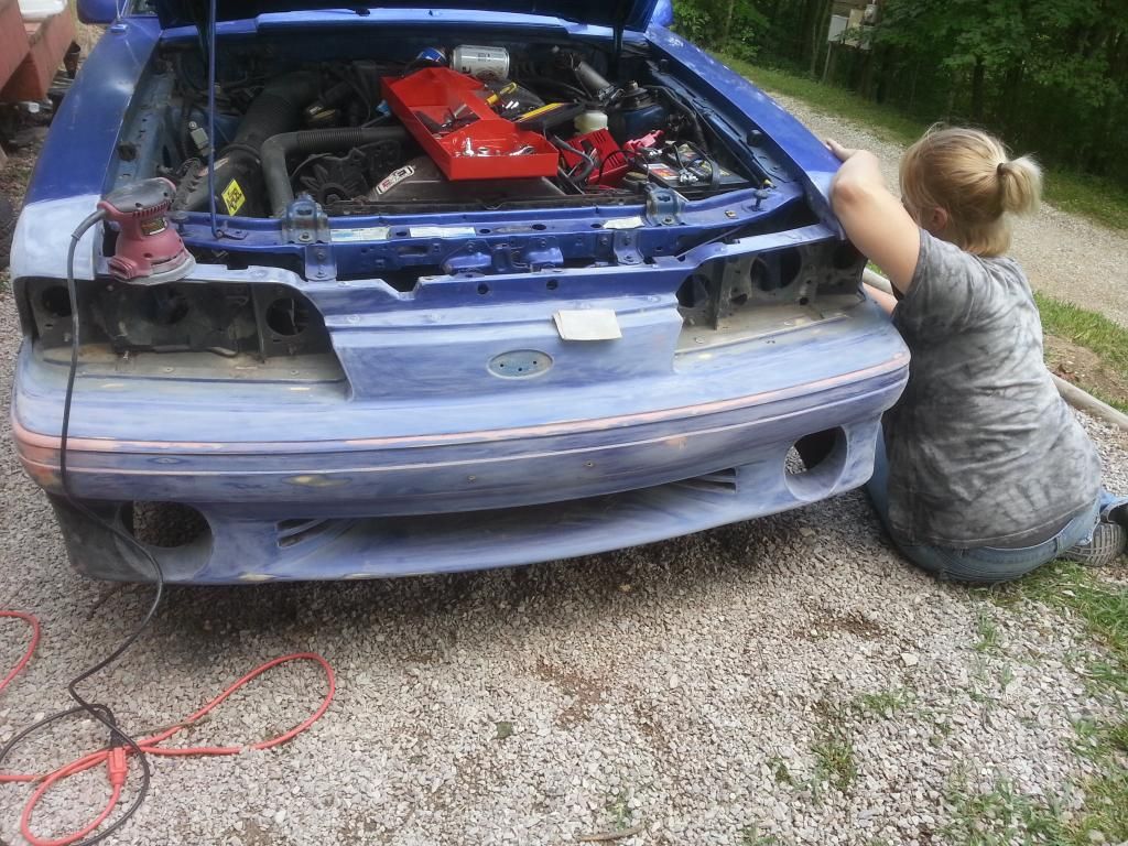

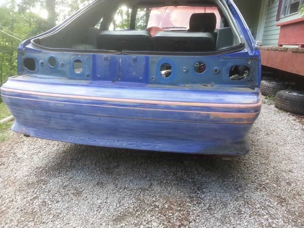

The last few evenings, I've been trying my best to get the bumper covers straightened out. Multiple coats of spot putty, adhesion promoter, primer, plastic paint, and a ton of sanding. It definitely looks a lot better, but not done yet. To be honest, I don't think it will hold up. The plastic bumper covers will eventually need replaced, I think, but I was hoping to save some $ for other needed repairs...such as the clutch cable.
And I had some help...

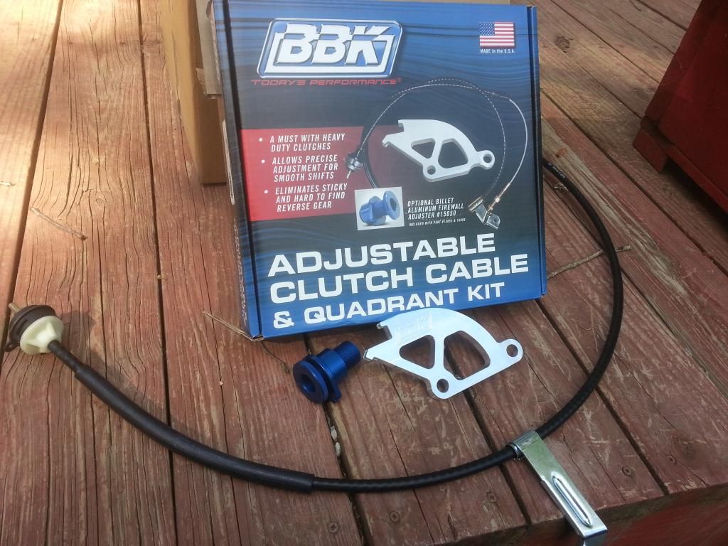

I attempted to adjust the clutch cable the other day, but it was kinda rigged to begin with. I ended up stripping the factory plastic quadrant. So I ordered a BBK adjustable cable with aluminum quadrant and firewall adjuster. The UPS truck showed up with it this afternoon while I was sanding my knuckles off.
I'm going to try and get this thing installed tomorrow.
