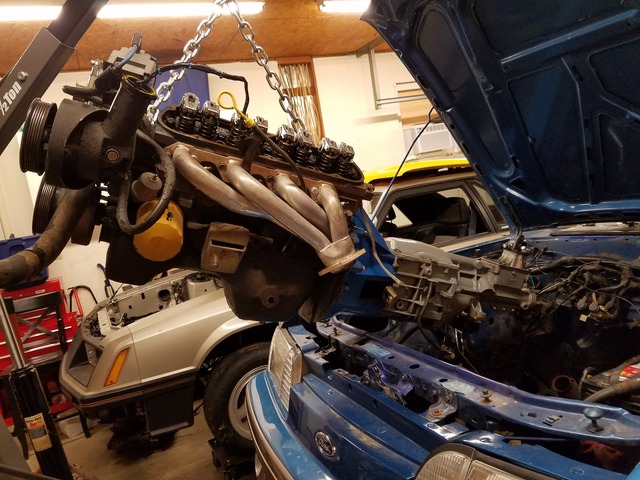

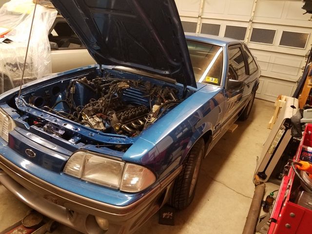

Well, I pulled the car in the garage a few weeks ago to fix a vacuum leak and this ended up happening. One thing led to another so I decided to pull the motor. The plan is to repair the shock tower rust on the passenger side and clean and paint the engine bay to get it looking as good as the rest of the car.
While the motor is out, she'll get freshened up as well. I've got everything to do the maf swap, except for the maf itself. Harness, cold air intake, ecm, etc are all sitting around collecting dust. I also had a few other items I planned on using. Gt40p heads, Explorer intake, b303 cam... So it should run a little better when I'm done.
While I'd love to go all-out with aluminum heads, custom cam, bigger injectors...this car will continue being more of a cruiser. The pace car and 82gt are getting most of the good stuff.

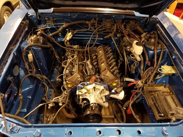

Haven't done too much to the car, really. A little rust repair in the engine bay and dismantling of the motor. I got the heads off last night. Cylinders and pistons both look great, so the plan is to replace the timing set when I do the cam. Throw some gt40p heads on it, explorer intake, clean up the block, replace the oil pump for good measure. I may also put a new water pump on it.

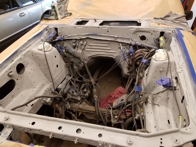

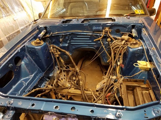

Finally got some paint on the engine bay.

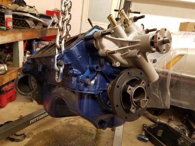

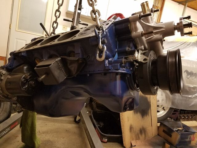

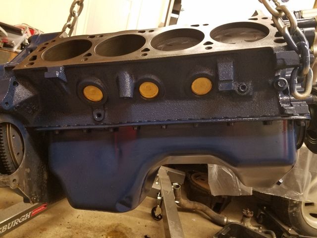

Also started freshening up the motor. It was a good running, healthy motor to begin with, but I went ahead and replaced pretty much everything except the rotating assembly. New timing set, oil pump and pick-up, freeze plugs, harmonic balancer, gaskets, and some other odds and ends.
I'm still weighing my options on heads. I dropped one set off at the machine shop, have another set of gt40p's, but really want some nice aluminum heads. I already need to buy a set of good heads for the pace car, so I don't want to spend the extra cash on two sets. But we'll see what happens. I'd like to get the motor finished up in the next few days.

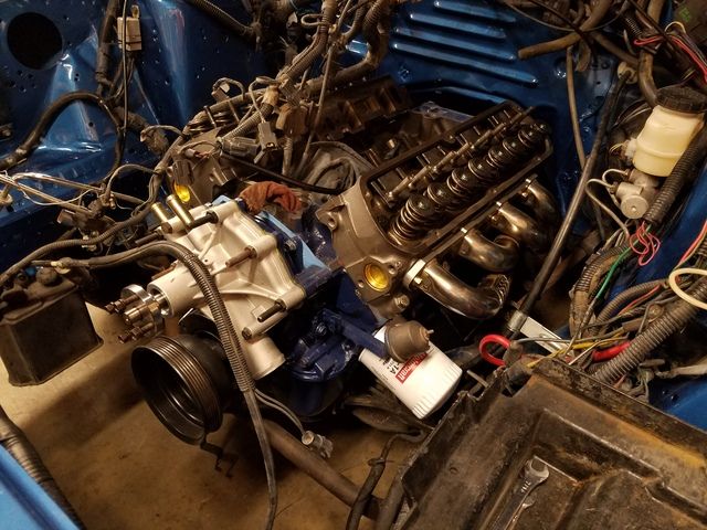

Got a few more parts put on tonight.

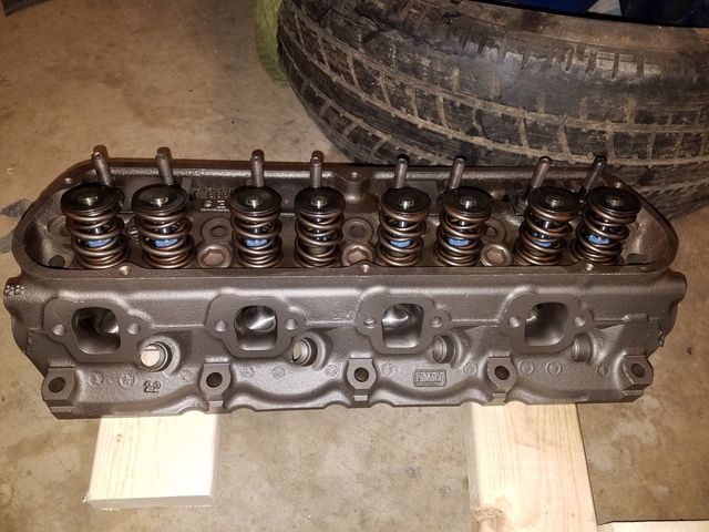

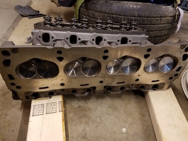

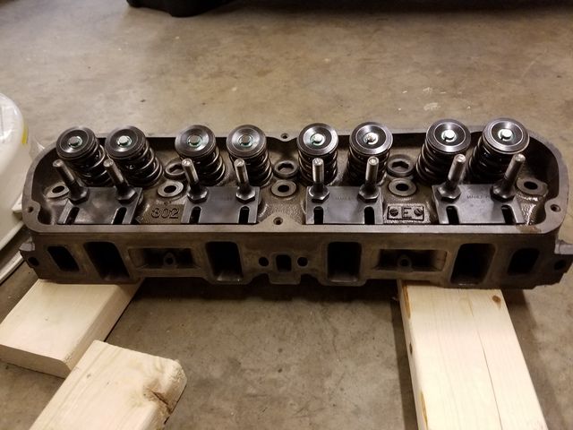

I also made up my mind on some heads. I dropped off an old set of heads at the machine shop the other day. Found out yesterday that they need all new valve guides and valve angle job. Total cost of around $600. The way I see it, for a couple hundred more, I can find a decent set of used aluminum heads or maybe some new Pro Comp (or similar). So I was planning on dumping the old iron heads in favor of some cheaper aluminums. But the more I thought about it, the more I wanted to use the old iron heads. They were given to me by my cousin, who used them on one of his old pace cars. I can remember riding in that car and it was a blast. They've had some port work done...closed-chamber heads from (iirc) a 68 Mustang. So I'm going to stick with them. At some point down the road, they may end up on my old 70 model coupe. But for old time sake, it will be nice to hear these babies come back to life!

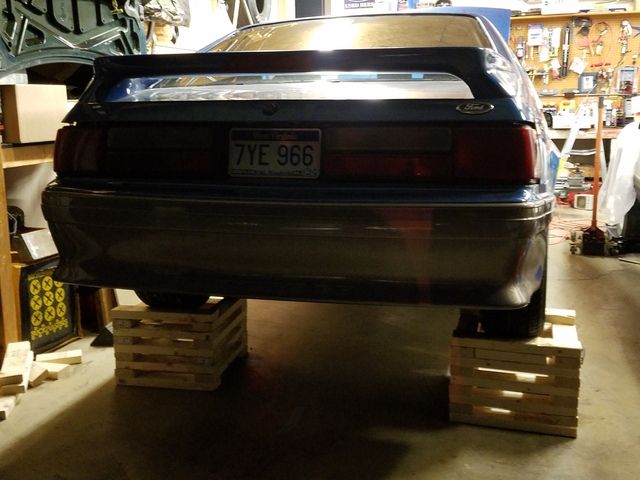

Built some cribbing stands to get the rear up off the floor so everything will clear once I drop the motor and tranny in together...also, so that it will be easier to get to the driveshaft bolts. I was planning to build a couple more for the front wheels, but for now, I think this will work fine for putting the motor back in. I should be able to set everything in place and hook up the driveshaft the way it sits. Then, I can jack up the front so I can get to the motor mounts and install the headers.
Today, I picked up the heads. I still need to pick up a couple head alignment dowels, which I seem to have lost somewhere along the way. No one near me stocks them, so I had to order them.

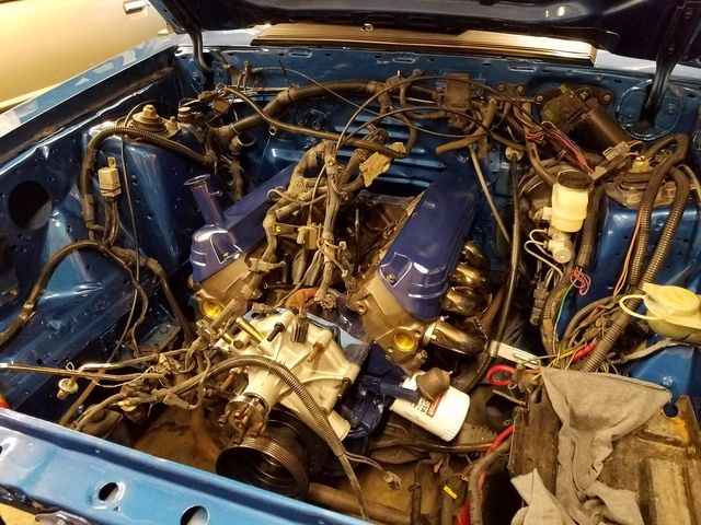

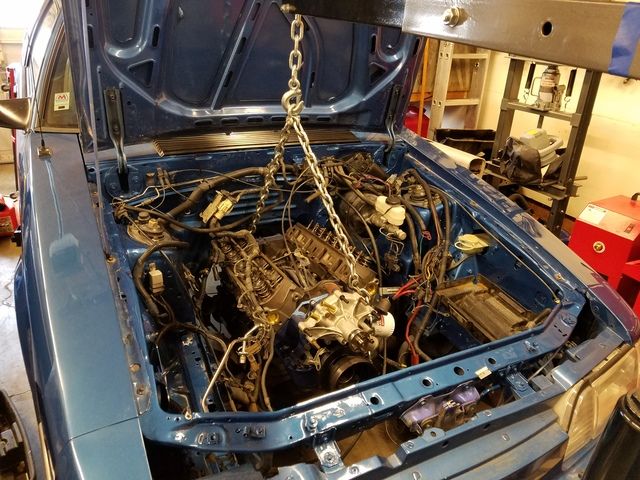

Dropped the motor back in tonight. I decided to take the t5 off and put the motor in with the rear end up and the front tires on the ground. I had it bolted in by myself in about 10 minutes. My brother-in-law (who I bought the car from) came over and we put the tranny back in. It was really easy, with all the room to work underneath. We had it in in about 20 minutes.

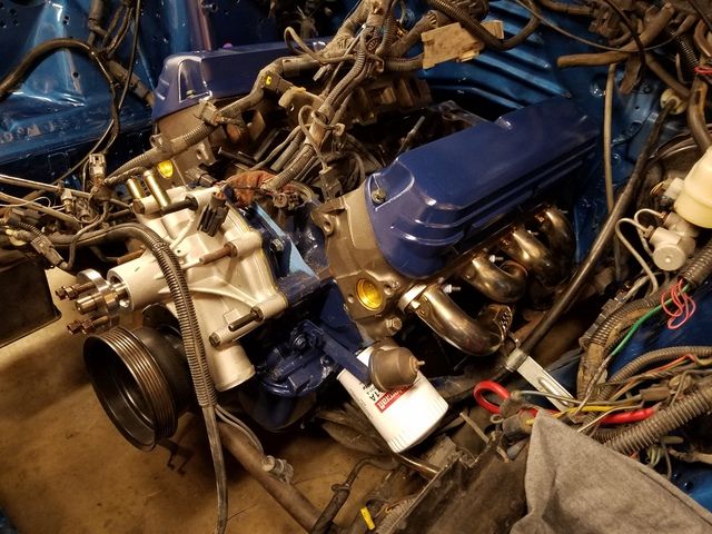

I'm dropping the intake off at my cousin's tomorrow so he can take it to work and clean it up in the blast cabinet. I'm going to try to get the alternator and power steering pump back on, as well as install the driveshaft. I removed the H-pipe, but I think I'm going to plan on replacing the entire system. I have some nice BBK headers to put on it, but everything from there back is just in bad shape. I'm tired of chasing exhaust leaks constantly, so I'm going to bite the bullet and replace everything.

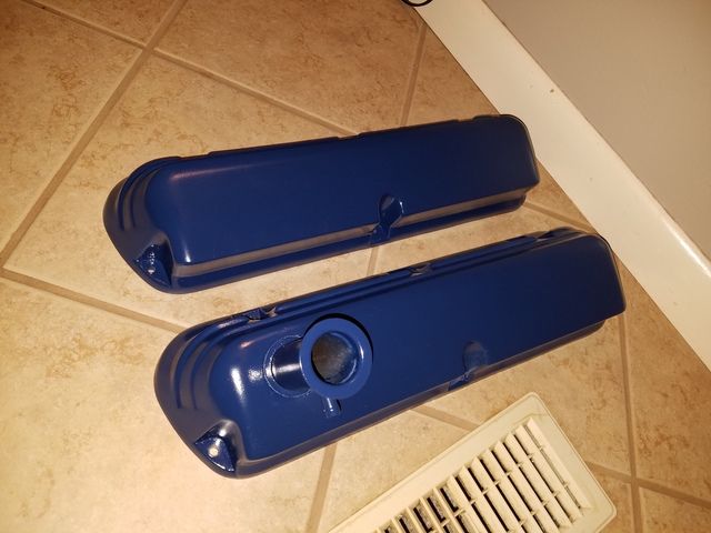

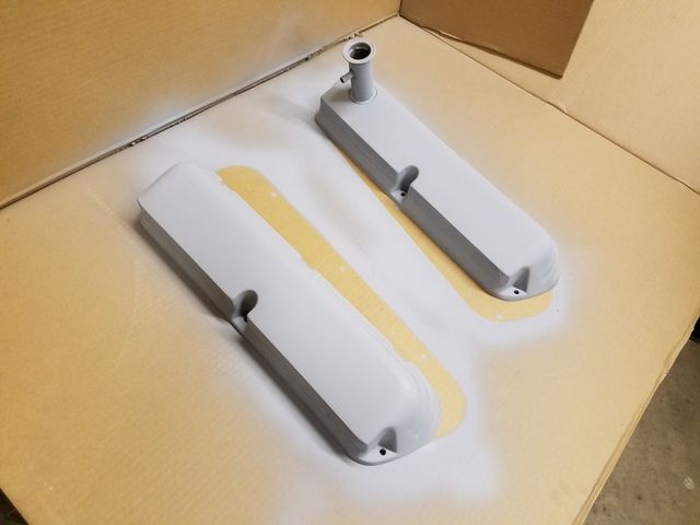

First, me and the wife sanded down and prepped the stock valve covers tonight (for a second time lol...don't ask!). Should be able to get a coat of paint on them tomorrow.

Got quite a bit done to the car today. Clutch cable and speedo cable buttoned up, driveshaft installed, brakes bled (now has working brakes again!), headers on, starter hooked up, and car is back on the ground! I doubt I will be able to get much further on it, since I go back out on the river in a couple days. I can't get the intake on until it's all cleaned up. I'll have to order a few parts too, I'm sure.
