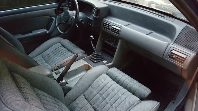

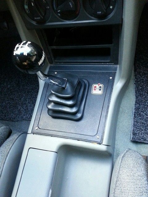

Just a quick update, with no pics. I took the seats and console out, so pretty much the entire interior was stripped (except the dash). I put the new carpet in along with the matching rear seat, which cleaned up great. I ordered some new door belt moldings and the outer weatherstrip (dew wipes). I also had to order a new window run channel for the passenger side. The run channel was a pain, with the window motor in the way. If I ever need to do it again, I'm taking the motor out. In fact, if I were smarter, I would have replaced the window motor gear bushings at the same time. Mine are working ok, but I know they will go, eventually.

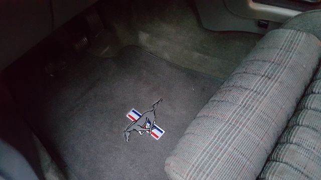

With the doors all fixed up and looking decent, I went ahead and put the interior back in, along with new carpet, seats cleaned up, and a few small details here and there. It's finally looking like a car again. Oh, and I had order some "running pony" logo floor mats a while back from LMR. They look pretty sharp.

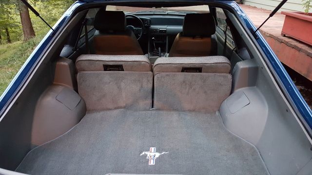

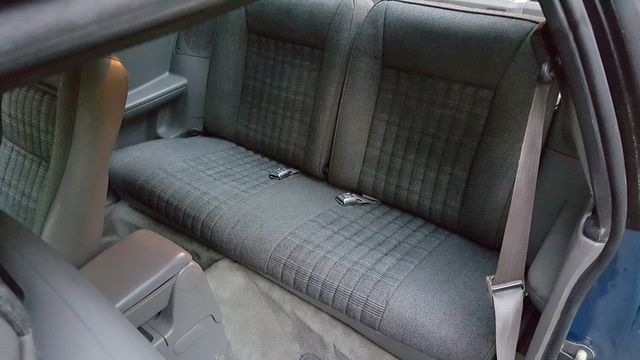

Finished replacing the hatch area and rear seat-back carpet tonight. I've been working on it about 30 minutes a night...after work. Got the back seat in, along with the fold-down mechanism. Touched up some of the metal parts and did some cleaning.
I still have a few interior parts that could use replacing or painting, but it looks like a different car inside now that it's all together.

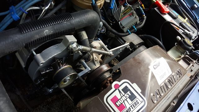

Done very little to the car, here lately. Tracked down the battery drain issue. It was a bad diode or something inside the alternator. I just put a new oem one on it and it appears to be good to go. Unfortunately, the current belt tensioner set-up is a terrible design and has to go. I ordered a new "march" alternator kit, which eliminates the tensioner altogether. I doubt it will get here before Friday, which is when I have to leave.

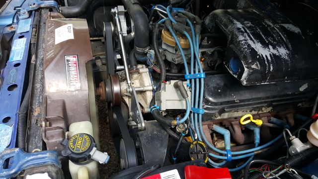

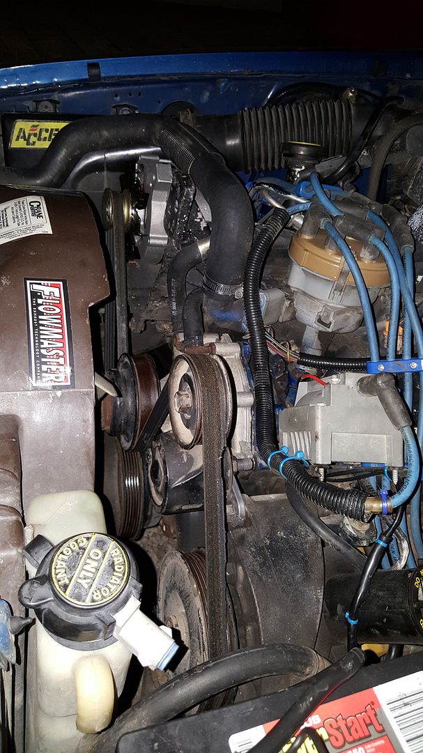

Here's a pic of the tensioner set-up in the car now:
The tensioner is 90 degrees to the belt, which just doesn't work whatsoever. When you crank down on it, there is basically no relief of tension at all. If you look closely, you'll notice the old belt is missing a couple ribs. That's because I damaged it trying to pry it on with a screwdriver.

It's 100% better than it was. It cleans up the front of the motor a little, as well, by getting rid of the original alternator/smog pump bracket. I left the old aftermarket power steering/tensioner bracket in place, because there was otherwise nothing there to support the front of the power steering pump. I may do something about that some day, but it will work fine for now. And again, I have to say this alternator bracket should work perfectly for anyone wanting to do a 3G swap without having to clearance the factory bracket.

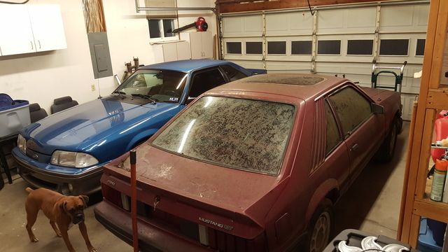

Finally got in the new house. Garage is still a wreck, but got both cars inside safe and sound. I did manage to clean up the 82, since she's been living outside for many years. I hope to pull the motor this winter. Actually, both motors and transmissions. We'll see how it goes. Baby steps lol!
