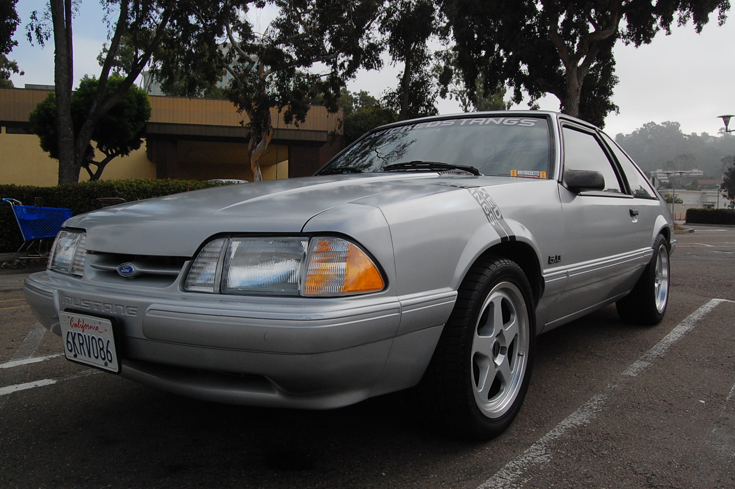

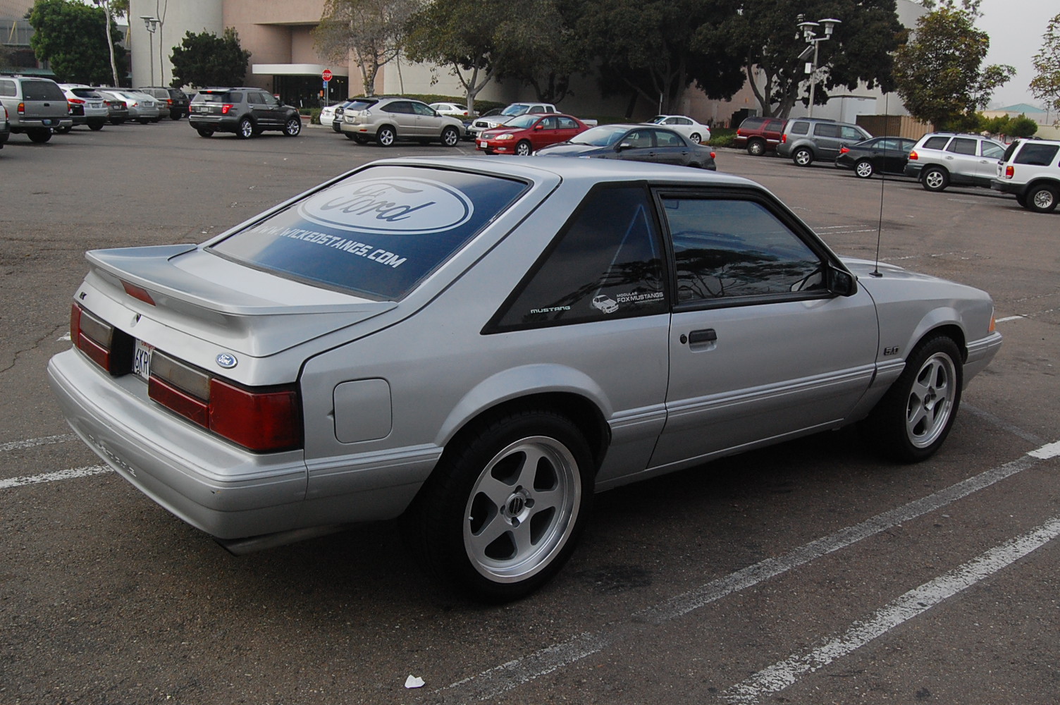

I second the zoom in technique on the LX emblem and plenum, It looks like hollywood work to me lol. Nice job on the changes. The wheels, paint and either cleanup of the H/L's and lenses or replacements really make the car look much brighter. It must be nice to have hoarded/stashed parts around to put it all together that fast. Super Job! I assume the manual rack is the 15.1 ratio? If so, hows the effort on steering? Killer lope and sound. What mufflers are under there? Thanks for the Pic's post! Looking Great!

Flowmasters and stock H-Pipe :) Trying to build a california smog legal car..:)
