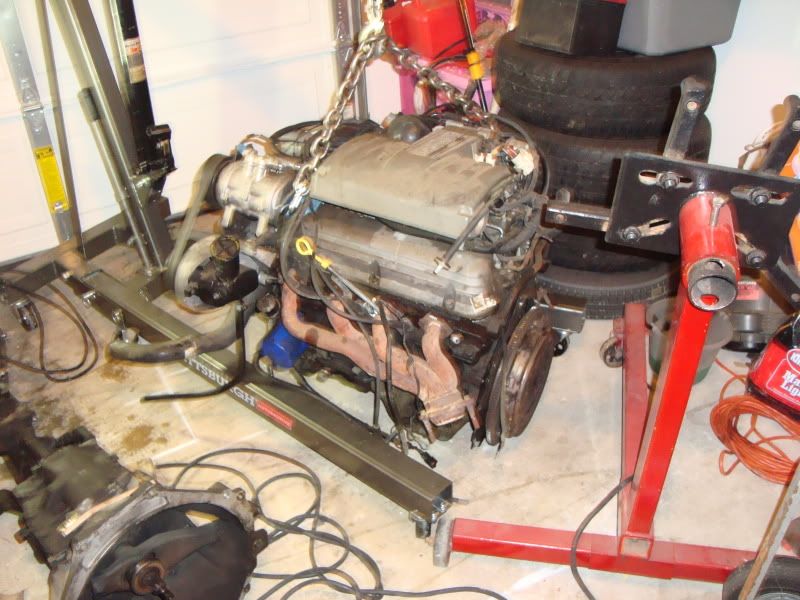

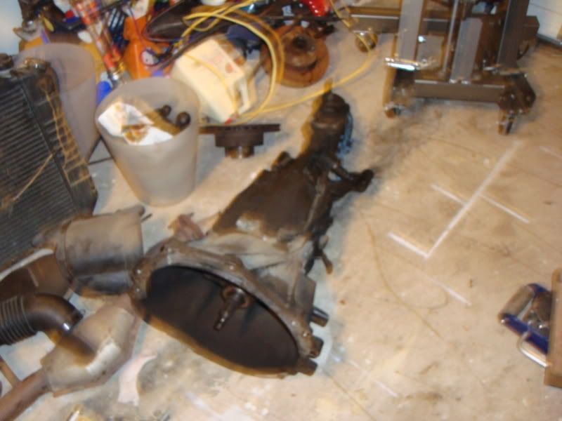

a few pics of the engine and trans...not sure wat to do to the engine before i put it in and the trans asides from cleaning and paint...
I would say freshen it all up since its out of the car. This is the perfect opportunity to give it all new gaskets, even rings and bearings if it needs them (you said it was rebuilt so thats up to you)
But yea i would definitely get a whole gasket set and just do all of them, head gaskets included. it may save you some serious time and effort later on.

all of these things will break the stock transmission, it may hold for a while but it will eventually take a dump. so you need to look into a stronger trans, a t-56, tko-600, or an astro-performance A-5 would all be good stick shift options.

yeah T-5 are notorious for weak 1-2 gears and well they dont hold much power or torque...but its going to be for the wife so she wont really drag it unless i show her how to drive it and she gets enough confidence to handle it like that...but i am not sure if it will be her daily since she might drive our expedition around with the kids...but yeah i thought of the TKO for it because i want a T-56 for my car...but yeah i thought about the hole gas mileage and durability of building something like that...but i thought of maybe a 331 and a girlddle....

I have the astro performance A-5 in mine, and its awesome! the tko's are good too but they wine quite a bit. My T-5 held for a while behind my beast, with heavy track time. so if anything you can leave the T-5 in it for a while and just wait until it breaks. From my experience it's 3rd gear that goes first in the t-5. mine did, but the rest of the gears were intact and untouched with about 600lbft running through it. so just for street use and no launching, it will probably hold for a while.
