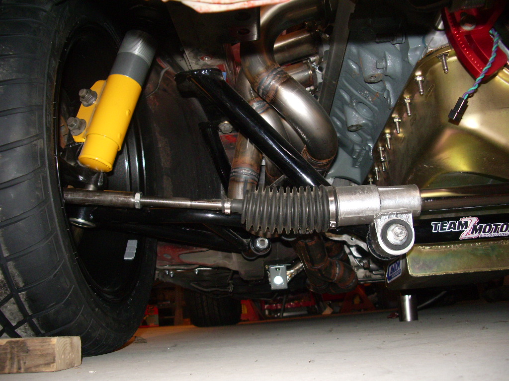

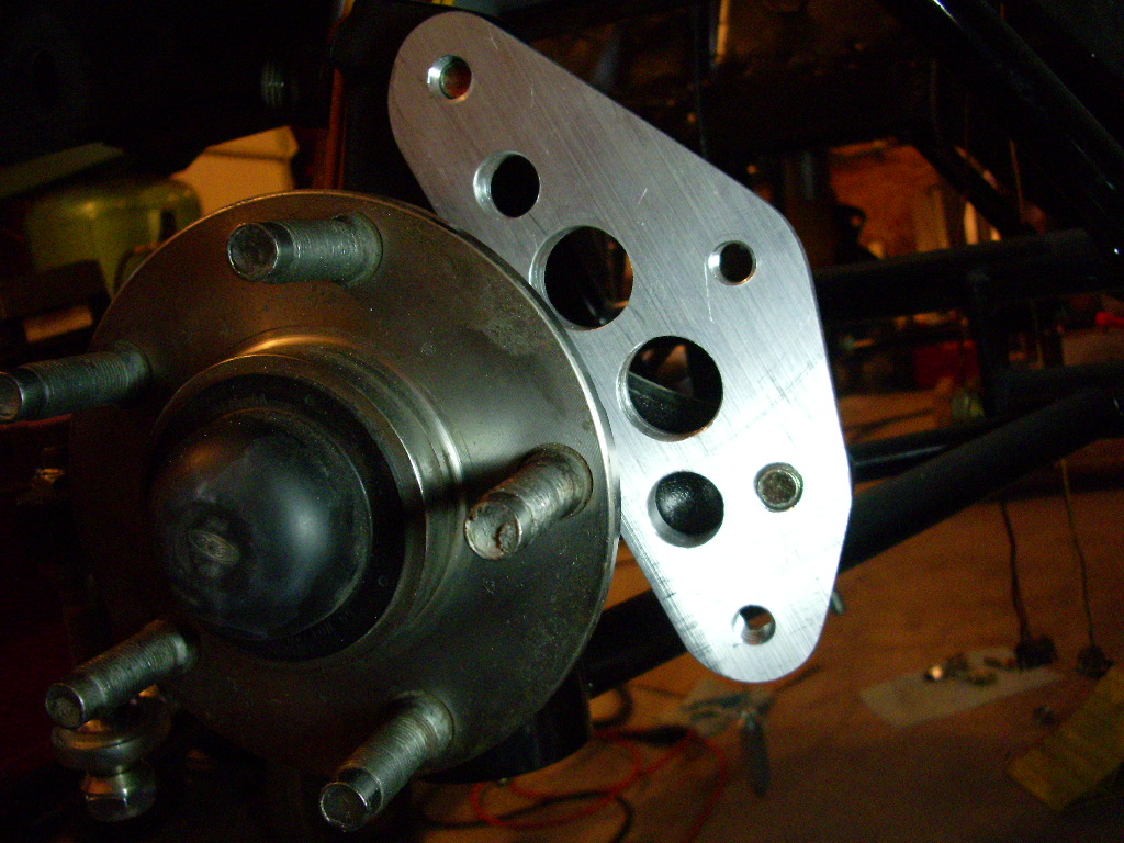

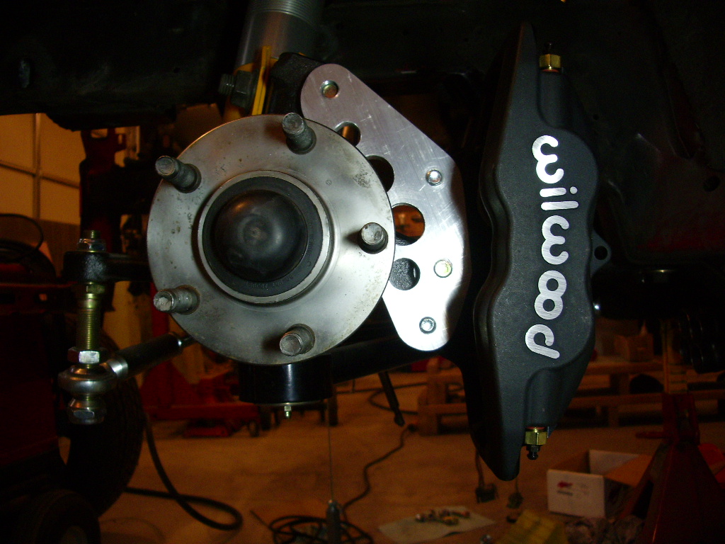

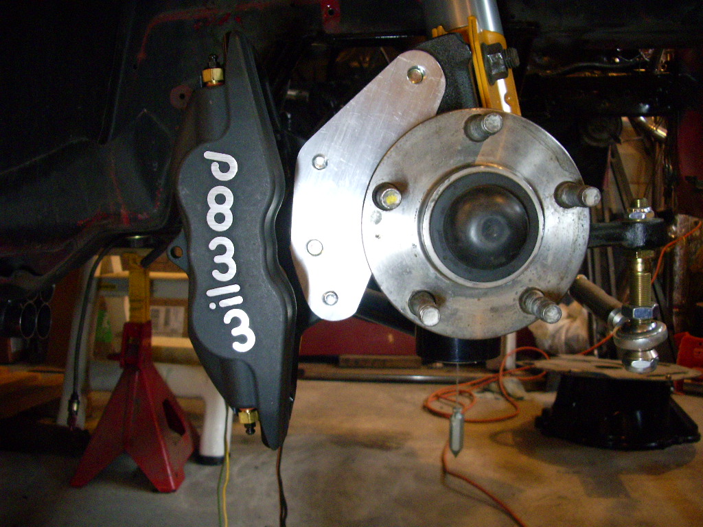

These are some pictures of the front brake brackets I fabricated from .500" T6 aluminum block.
I don't know why I fabricated them... I assume wilwood makes them.
347HO

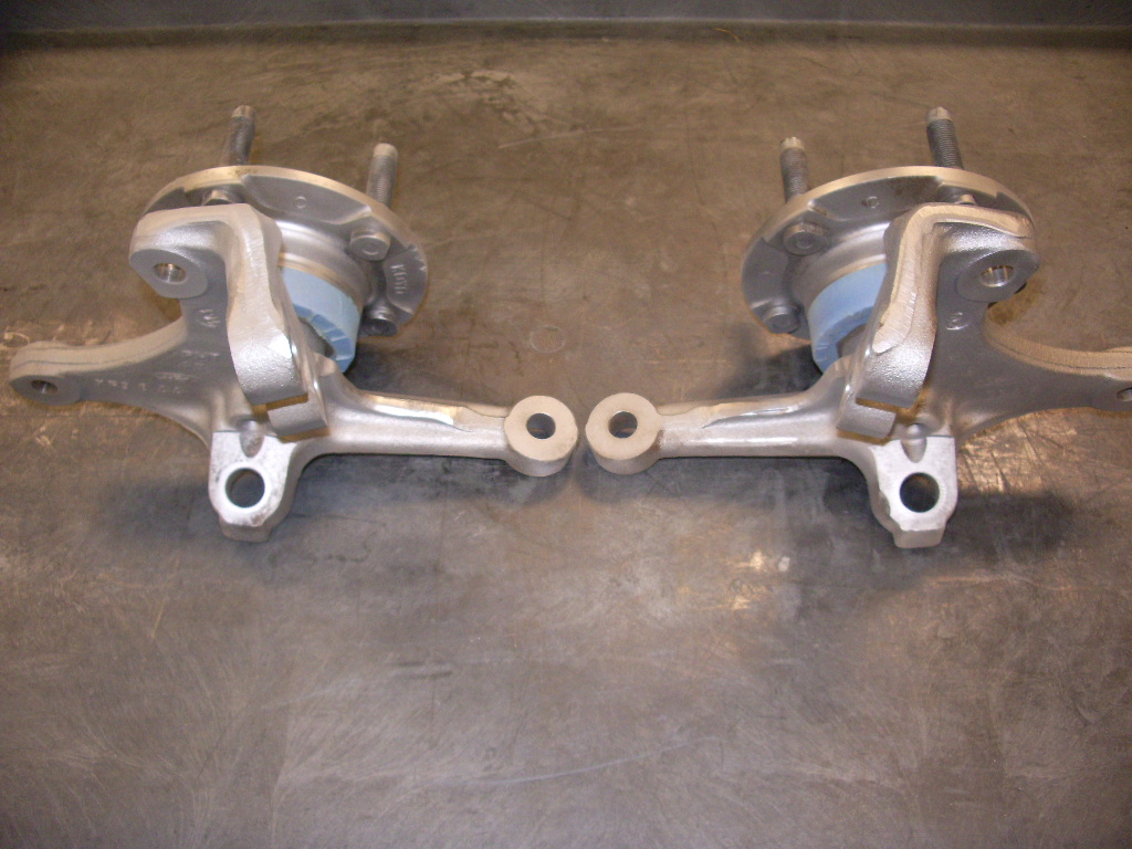

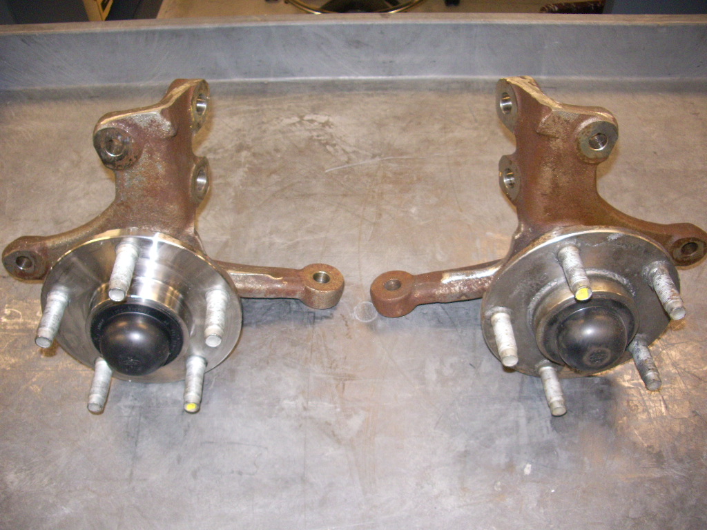

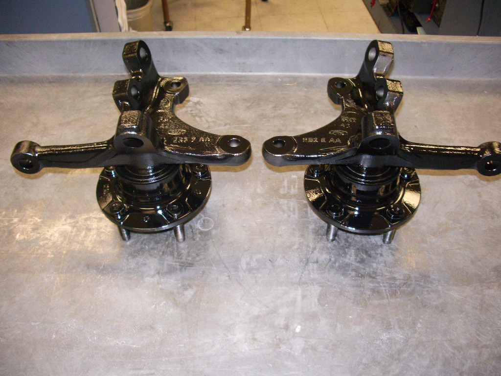

I realized lowering this car, I ran out of camber adjustment. I researched and found 1996 mustang spindles are a tad wider and push the ball joint almost 3\8" outboard. So I purchased a used set, cut the "hall affect" boss off, ground all the cast and sharp edges off and polished smooth. Cleaned, and painted before installation.

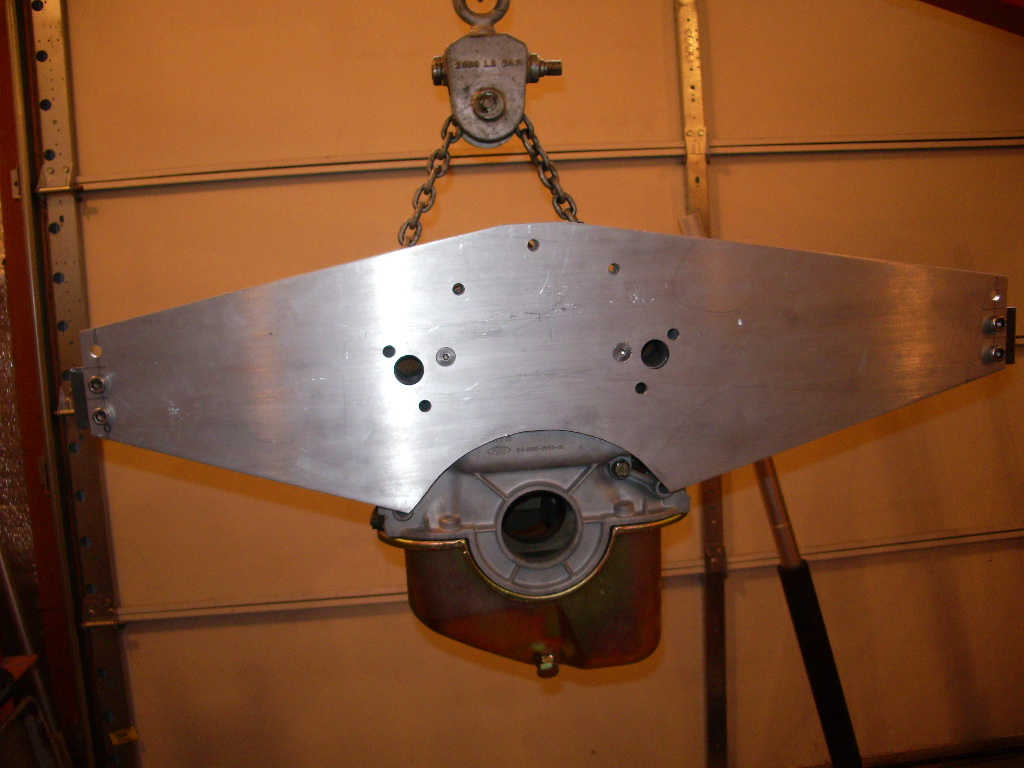

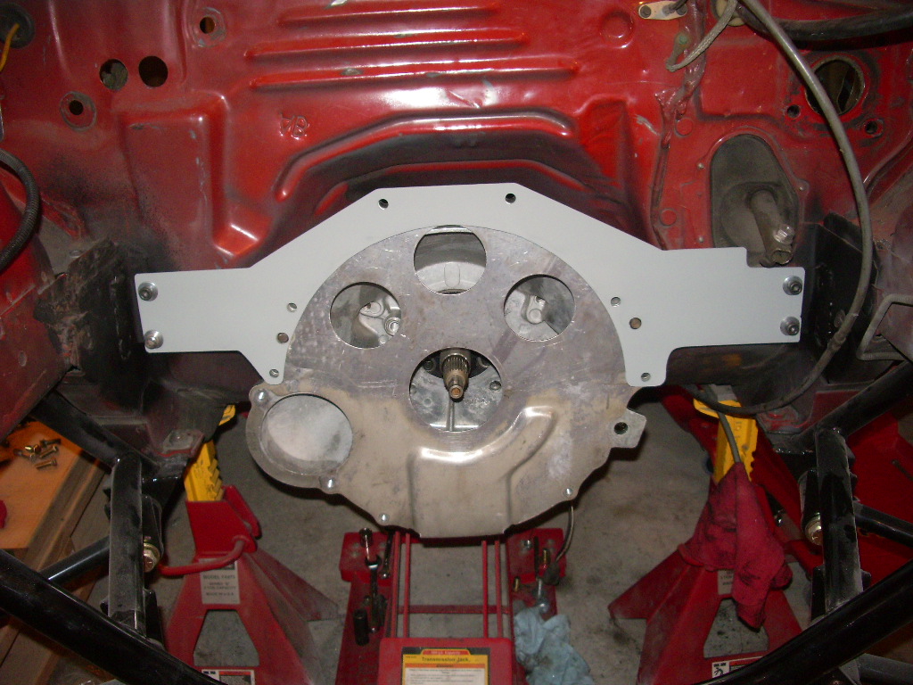

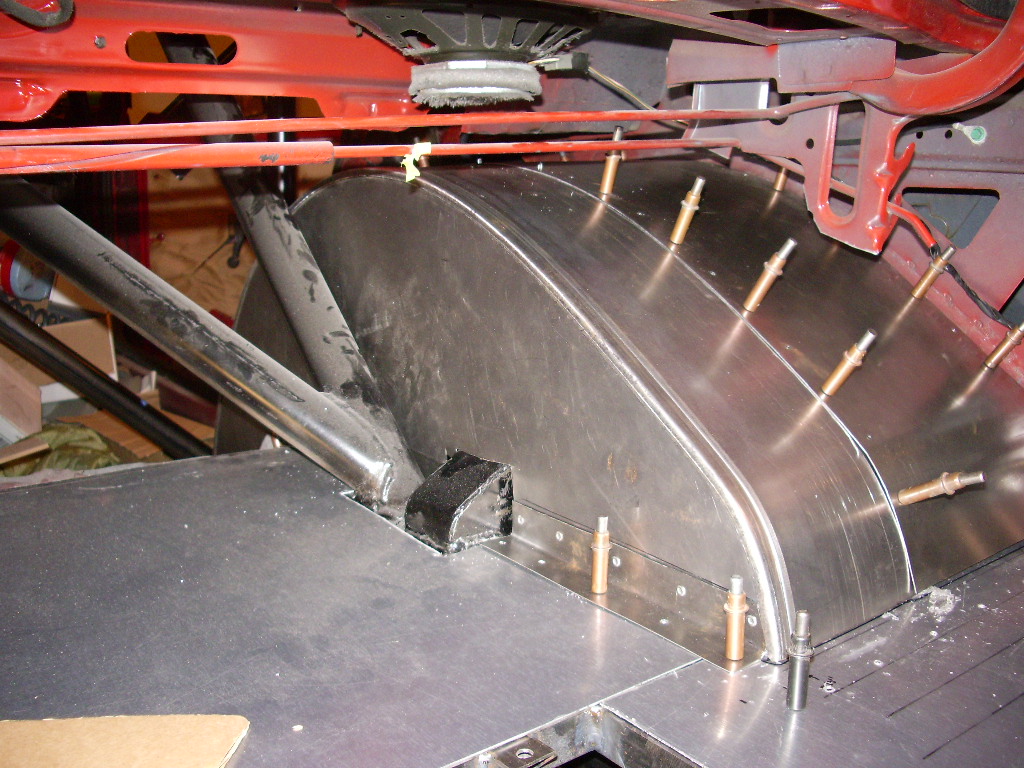

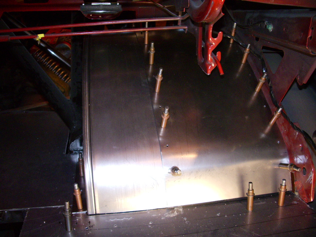

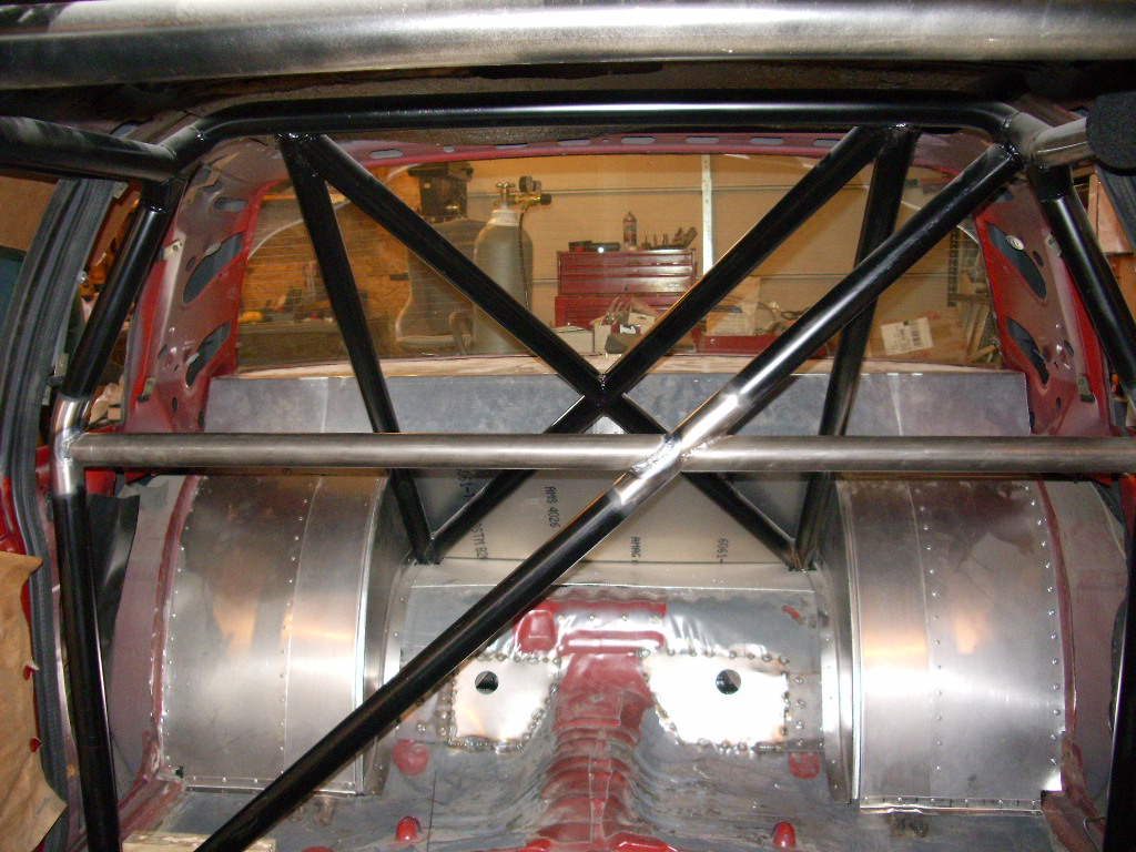

Big tire tubs I fabricated
347HO
I pretty much fabricated everything on the car, so anyone wanting to attempt at making a part for their Mustang, request a picture or ask your question and I should have an answer.

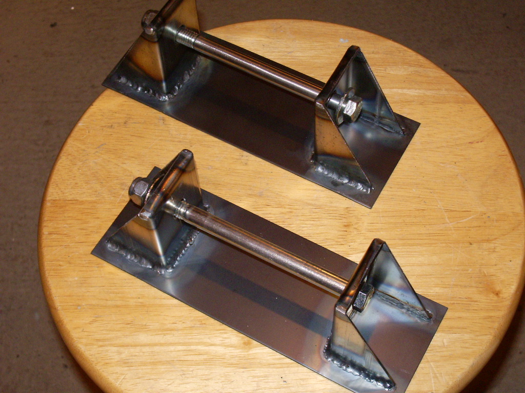

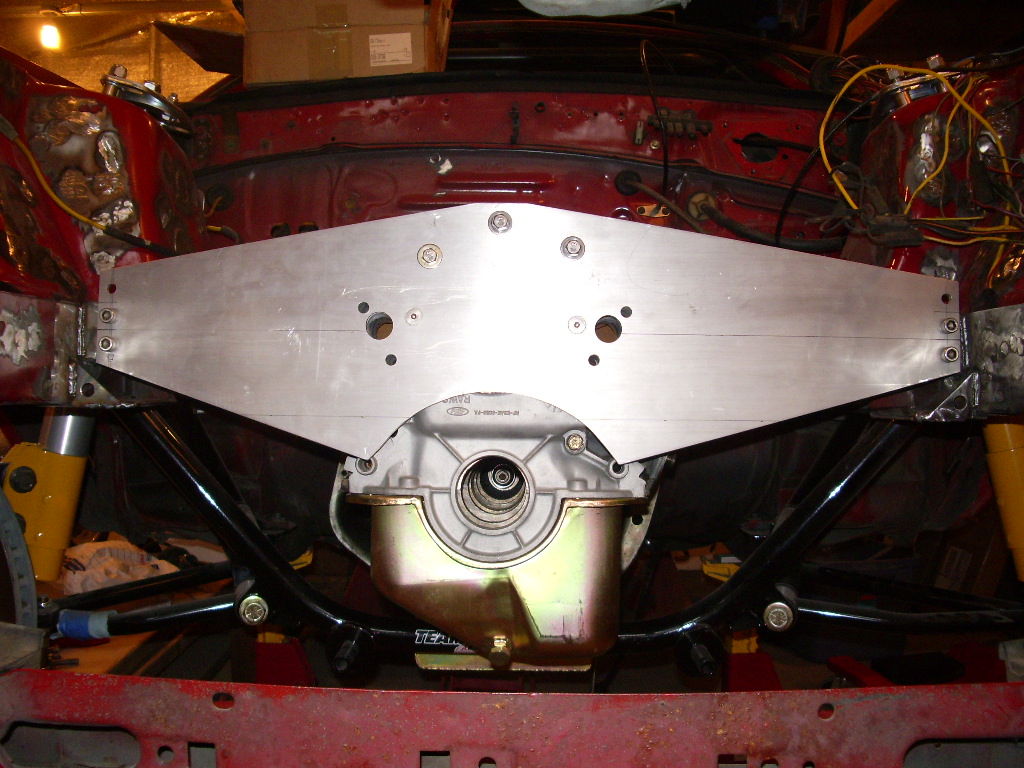

On another note, I love those crossmember mounts. I may have to make me a set, since the early cars are different (smaller) and don't fit the later, more common crossmember.

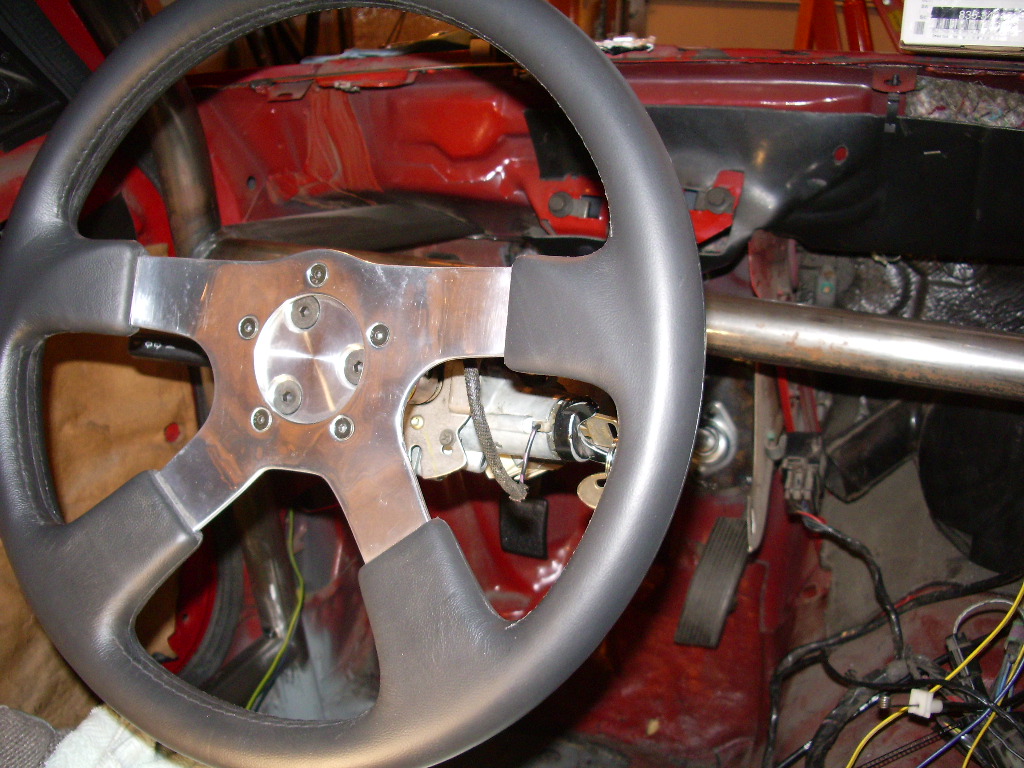

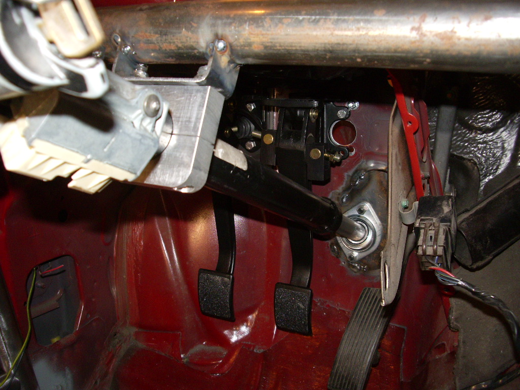

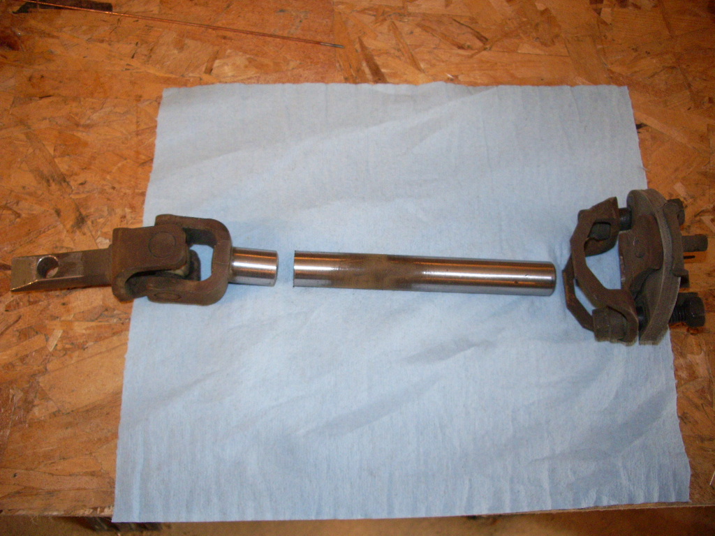

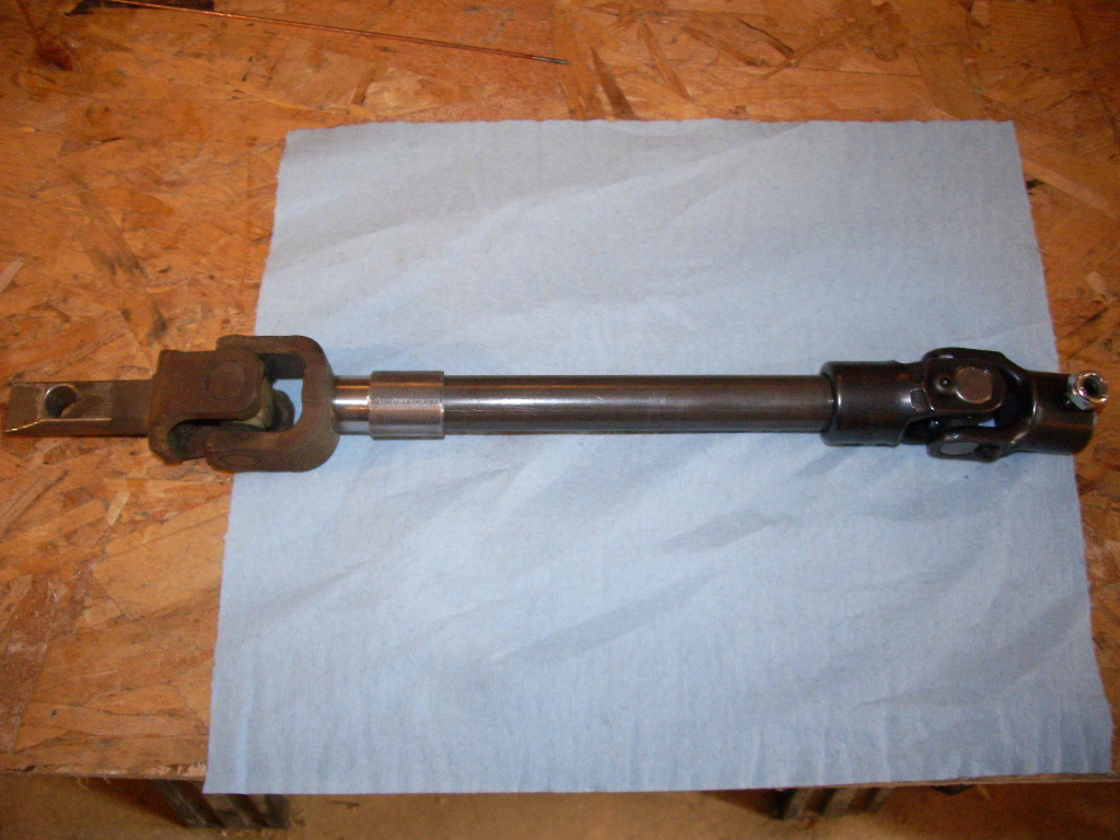

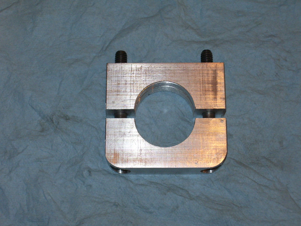

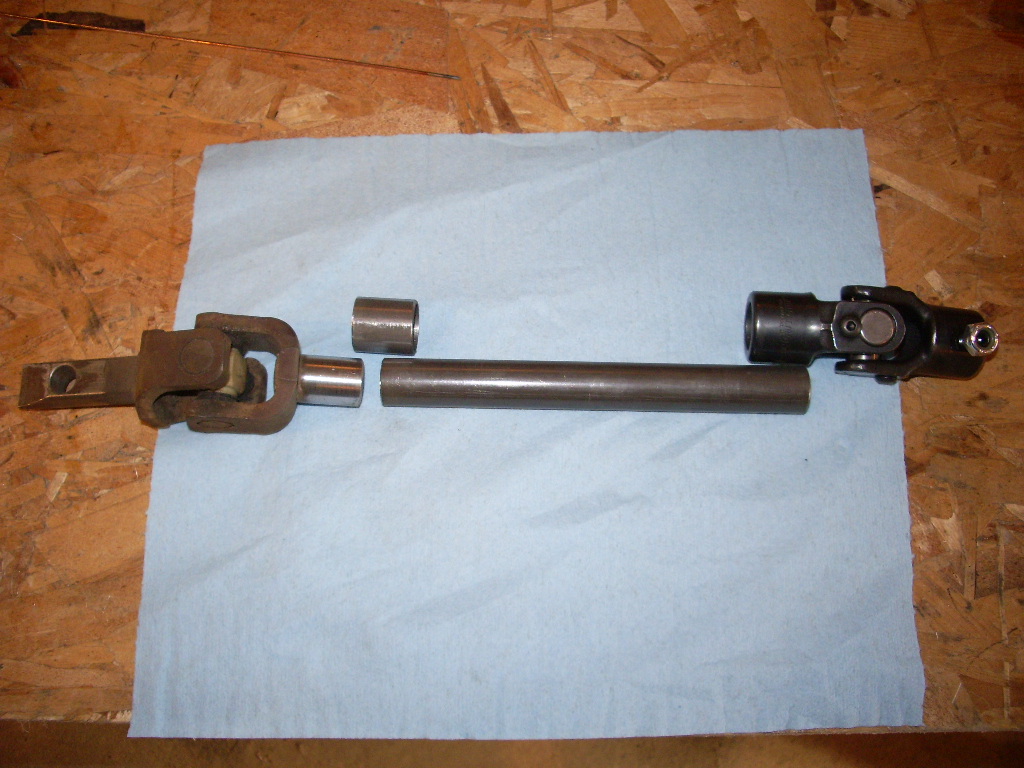

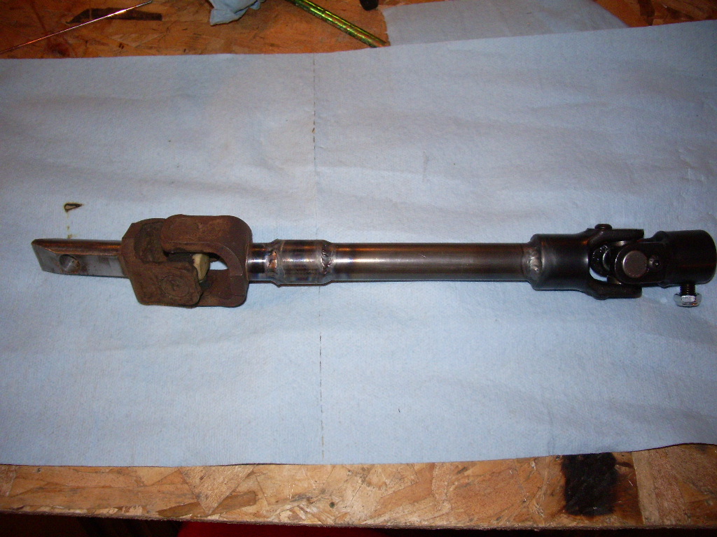

I fabricated my own steering joint and shaft support (pillow block). Bought a severe angle bearing to replace the factory crap at the firewall.
347HO

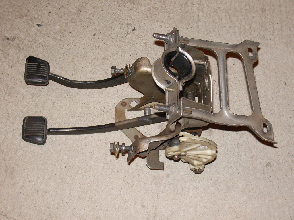

I removed the factory pedel and steering support... was crap, sharp edged, and ugly.
Those are Tilton pedals I bought from Speedway. Awesome quality and looks.
Honestly, I bought a lot of bolt on parts, but they were either crap, or didnt fit, or were ugly.

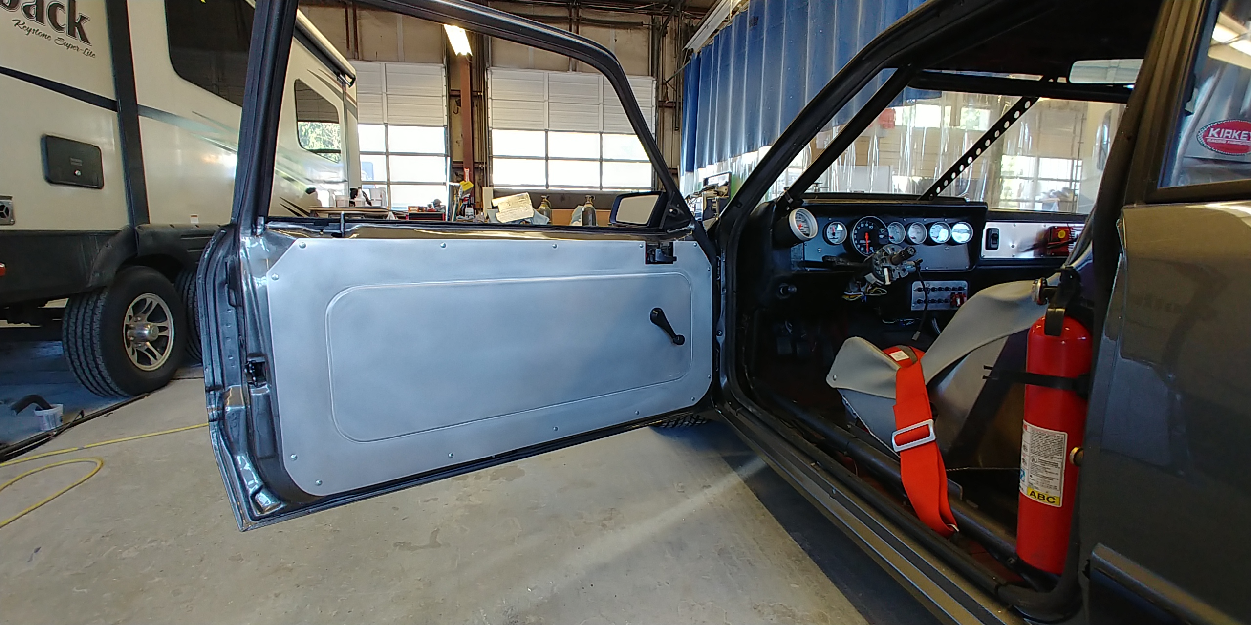

I fabricated some door panels using scrap rv aluminum from the scrap bin.
I guiltily bought a summit bead roller to do the job.
These are version1
I'm thinking ver 3 is gonna be the ones I keep.
I'll make a "ford blue oval" template and bead roll that into the final door panels.
