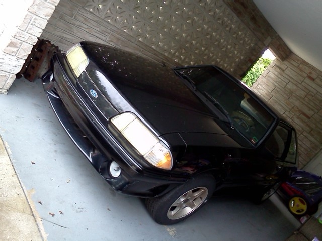

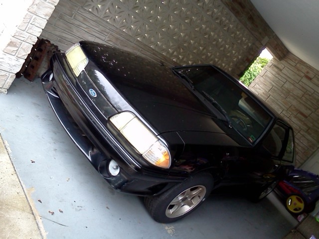

This is my new project it's my Dad's original owner 91 GT he finally passed it down to me. This is the first car I learned to drive manual lol. My dad was always about handling and hiting the corners hard so I've tried to keep the same theme.
I recieved the car with no motor or tranny my dad decided to do a John Force burnout for his buddies at work and blew the 260,000 mile engine.

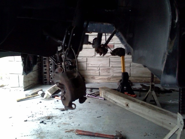

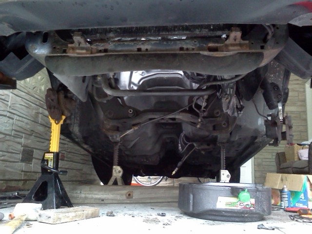

Started taking out the stock K-member for obious reasons lol.

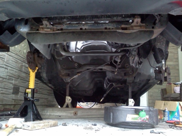

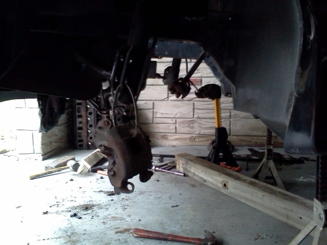

Finally got the K-member out it was a heavy s.o.b.
Here's the new A.J.E. K-member it's really nice I have the U.P.R. complete kit on my coupe and it's pretty crappy no where near the quality of A.J.E.

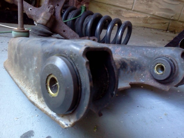

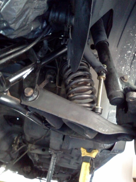

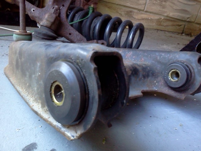

The new energy suspension bushings on the stock A-arms I wanted to have a solid foundation for the car being full weight. I'm not too fond of the tubular A-arms especially when breaking.

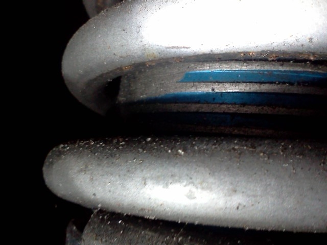

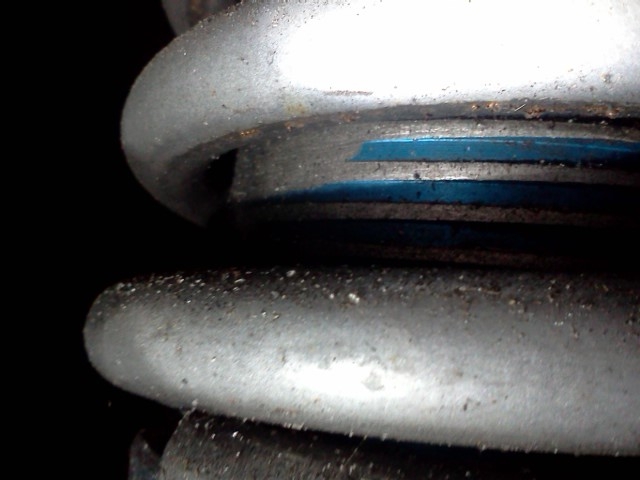

The driver's side all bolted back up I cut a coil off the stock spring I like to keep the stock spring because of all the weight lost on the front end from the k-member and aluminum heads seems to work just fine no need for a progressive spring.
Looks to be a real nice ride you have to start with. Can you tell me what the issue would be when braking with the tubular control arms versus the originals with newer bushings? I am still shopping to what k-member to use on mine. I will have aluminum heads, lighter k-member as well.
Well I shouldn't have compared the two K-members the way I did. The UPR kit was mainly for drag racing it consist of a light weight design and the bushings on the control arms are pretty weak to say the least. Most kits use a coil over design I personaly don't like the ride quality that's not to say others will. If you compare the Maximum Motorsports K-member to a stock unit they're pretty close in weight because of reinforced design for road racing. All I can say from my experiance with UPR products is they're all junk not just K-members the bumpsteer kit the coil over kit and the caster camber kit it's all pretty much crap:(

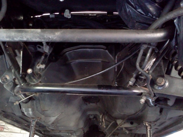

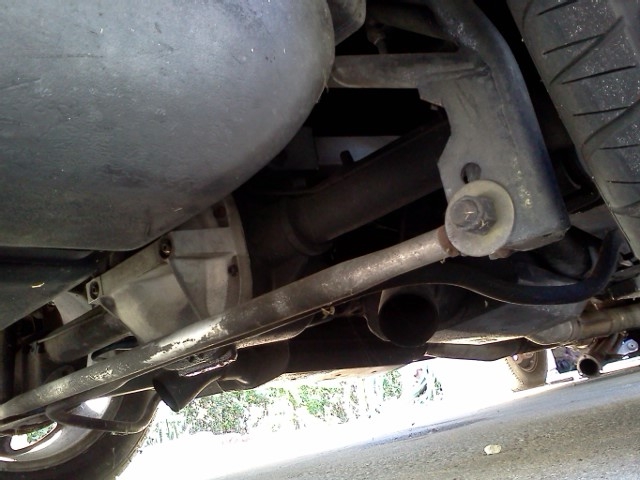

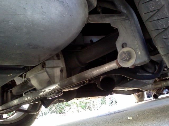

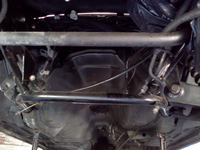

I'm also a firm beleiver in Pan Hard Rods this is my coupe I'm gonna be using one on Dark Horse too. It's made by Kenny Brown you can't use tail pipes with this unit installed. I've changed the end links to solid originally it came with a bushing style. I've never had torque box issues with these installed.
I have looked at those. That sure looks to be the way to go for handling, but unfortunately I will need to use the stock twin tailpipe extension coming out from under the left side of the rear bumper cover for the stock look I am trying to obtain.

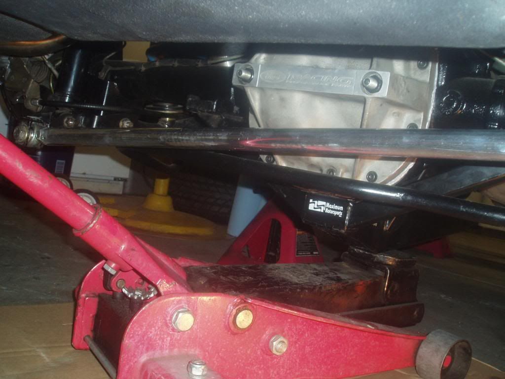

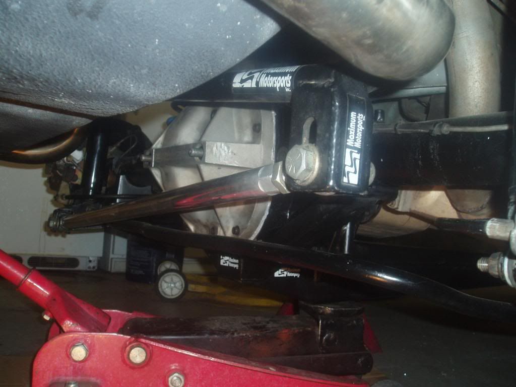

I would like a panhard bar. I met this guy who swears by them. He says they are awesome on a fox. And help out a lot with handling

Wow that MM kit puts the KB one to shame I came across a forum thread from 2008 where the OP actually snapped the Panhard on his KB kit now I'm starting to see why. Awesome pic!!! I also had an issue where my fuel line touched the exhaust and melted the coating. I put some miles on it that way, one day on a drive to work I started smelling fuel really bad I knew it couldn't be that rich so I pulled over to check it out and found Niagara Falls!!! That was the last time I ran tailpipes.
