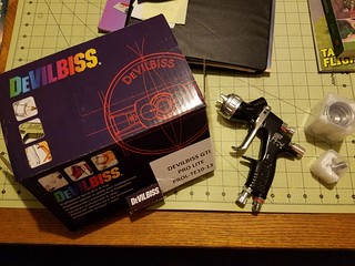

I got a new DeVilbiss GTi Pro-Lite spray gun for when I get around to painting the car.

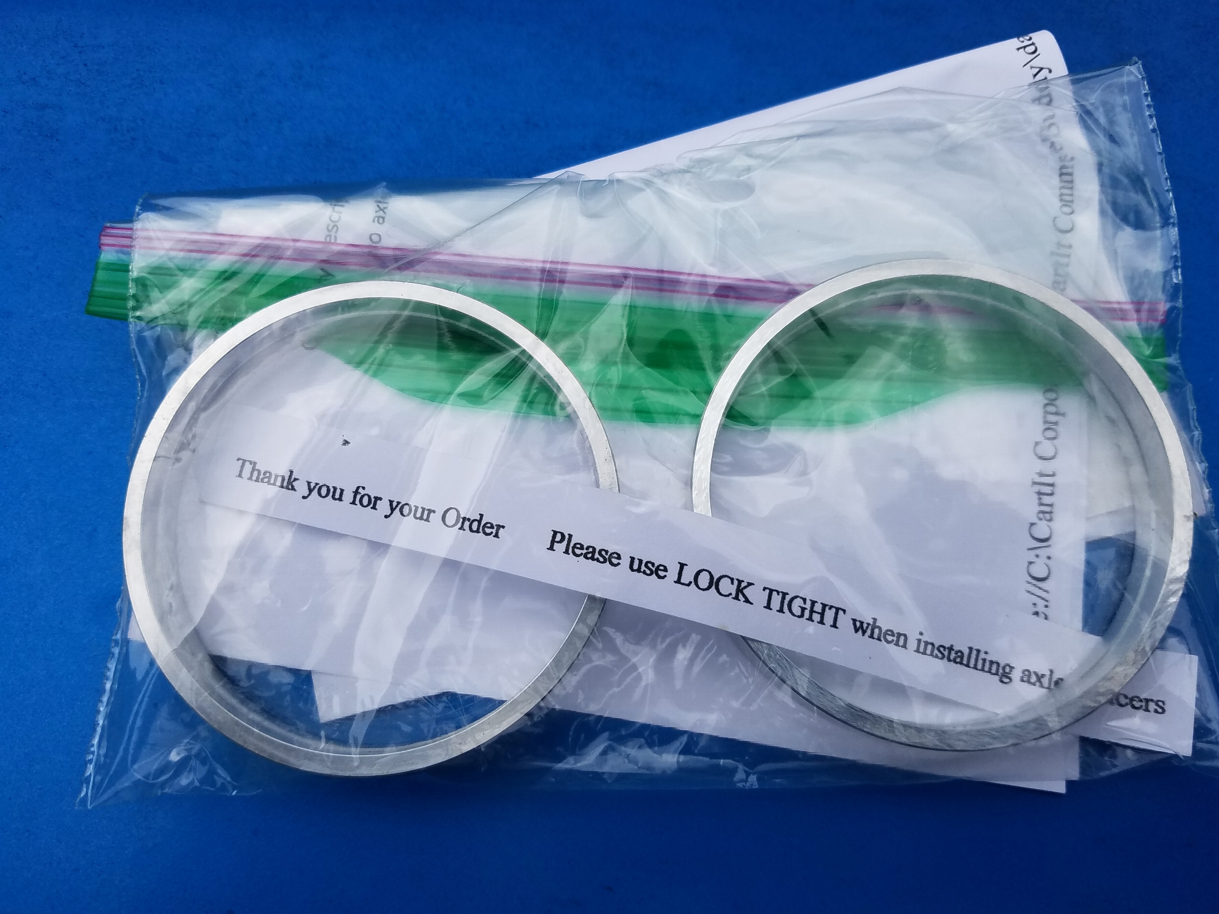

But one more piece arrived for the 5 lug swap. These are the hubcentric rings to allow the rear rotors to sit properly on the rear axle flange.

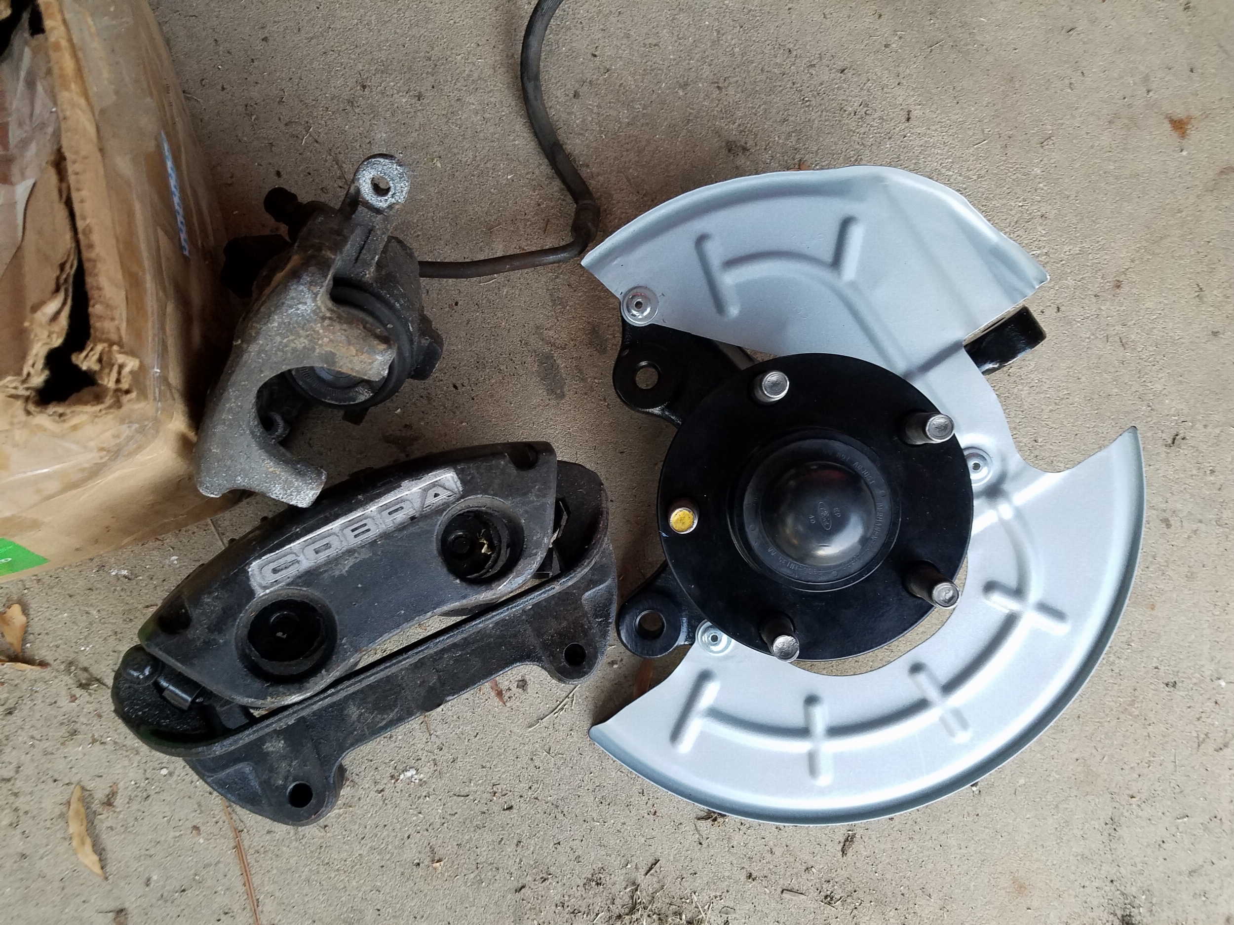

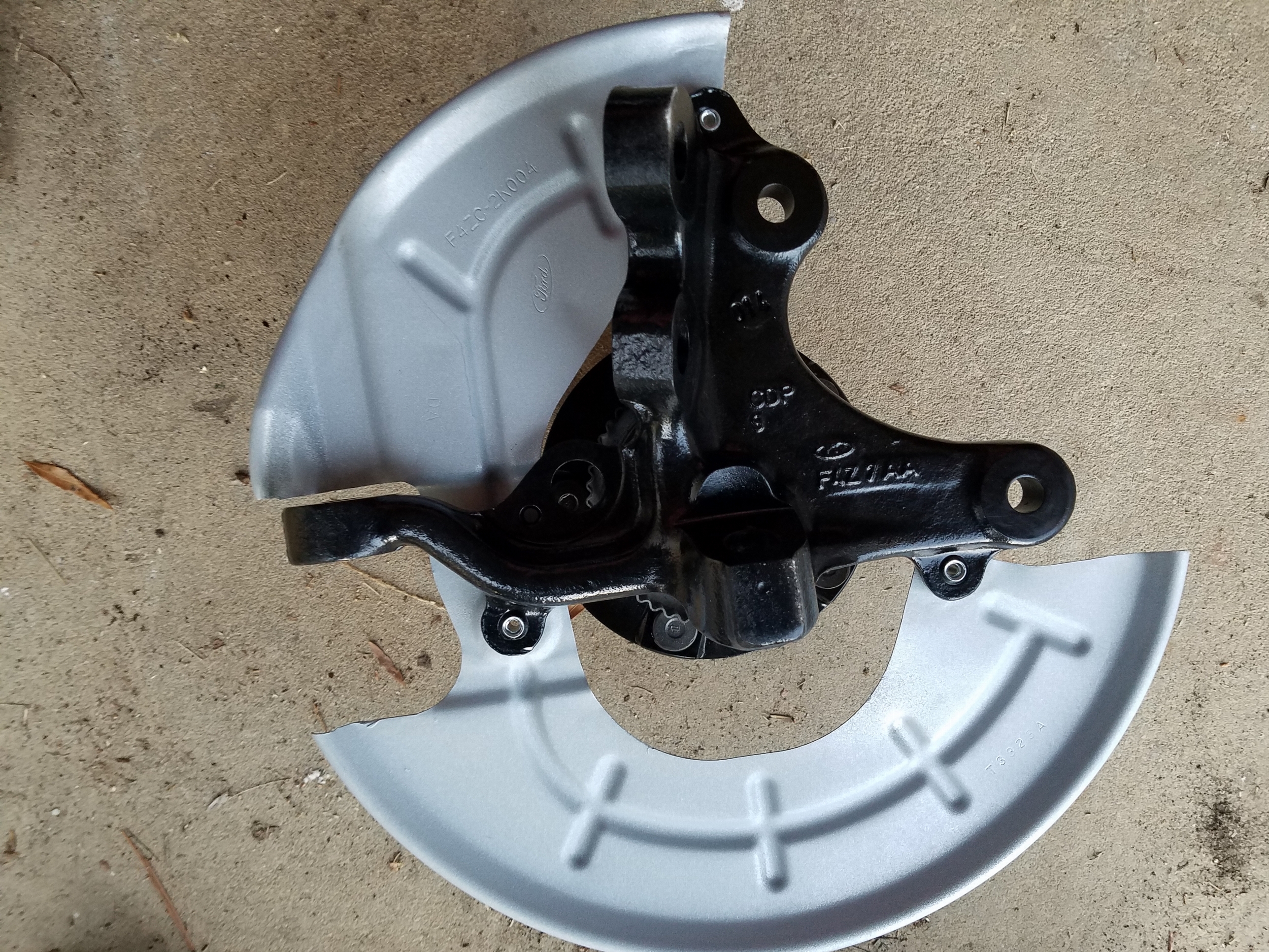

The swap will be utilizing '95 Sn95 Spindles with '94-'98 Cobra 13" / 11.65" brakes.
The front '95 spindles and Cobra front dual piston calipers and rear single piston calipers.

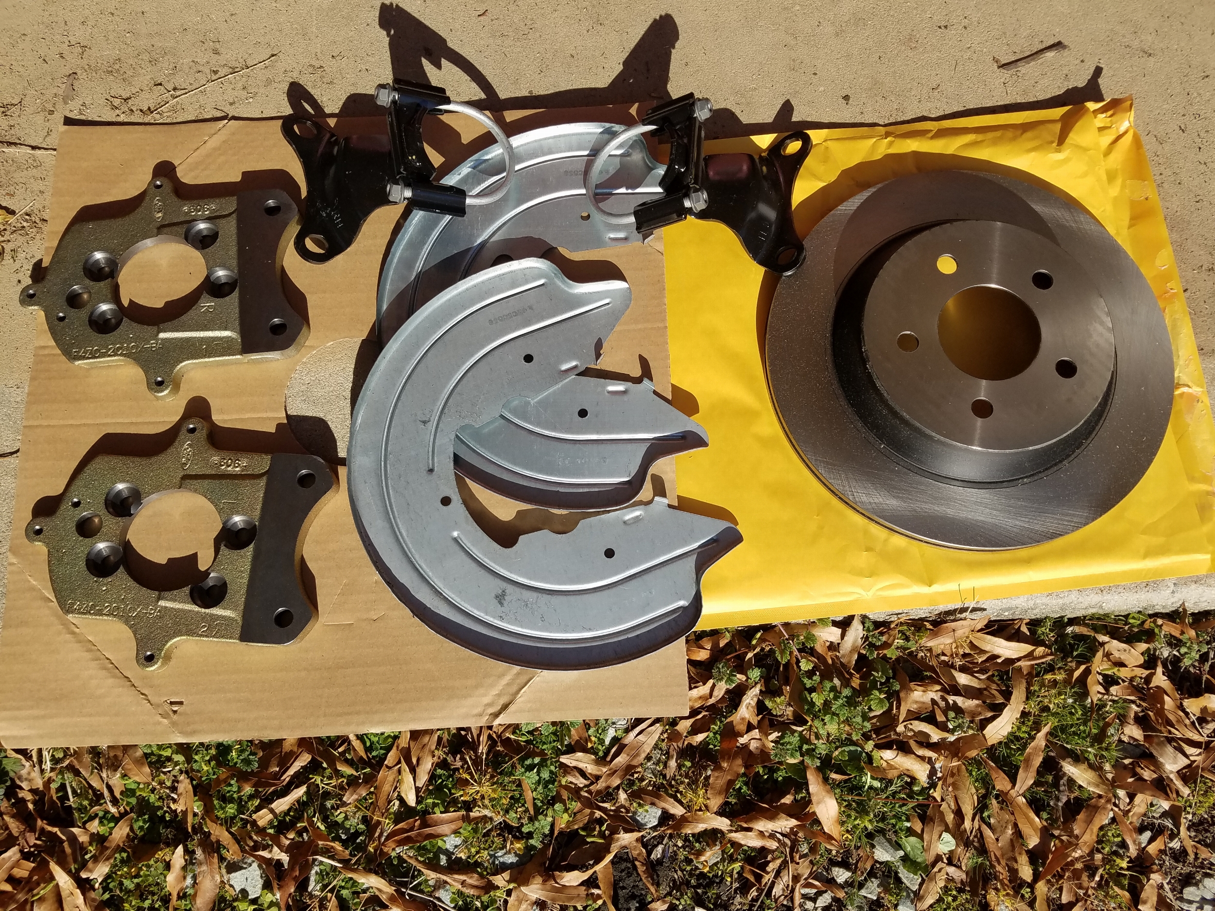

The rear FRPP bracket kit with rotors and dust shields to convert the rear to the 11.65 Cobra disc brakes.

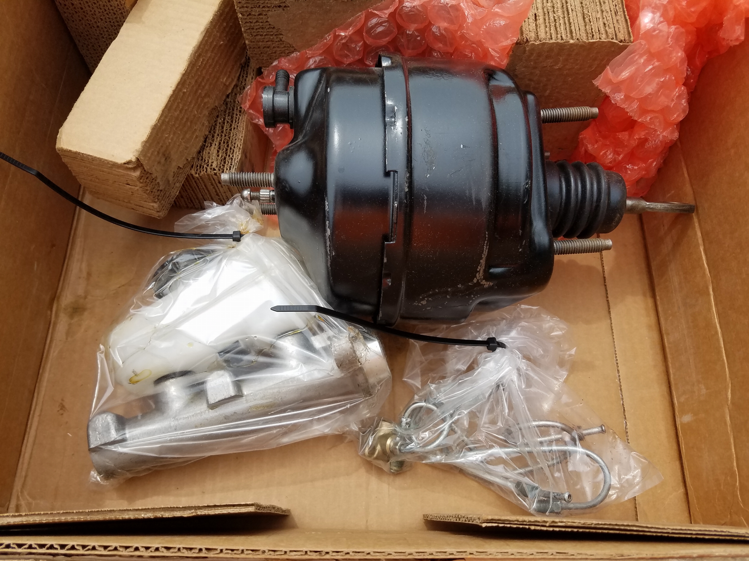

The ever so slightly used '93 Cobra brake booster and Master Cylinder.

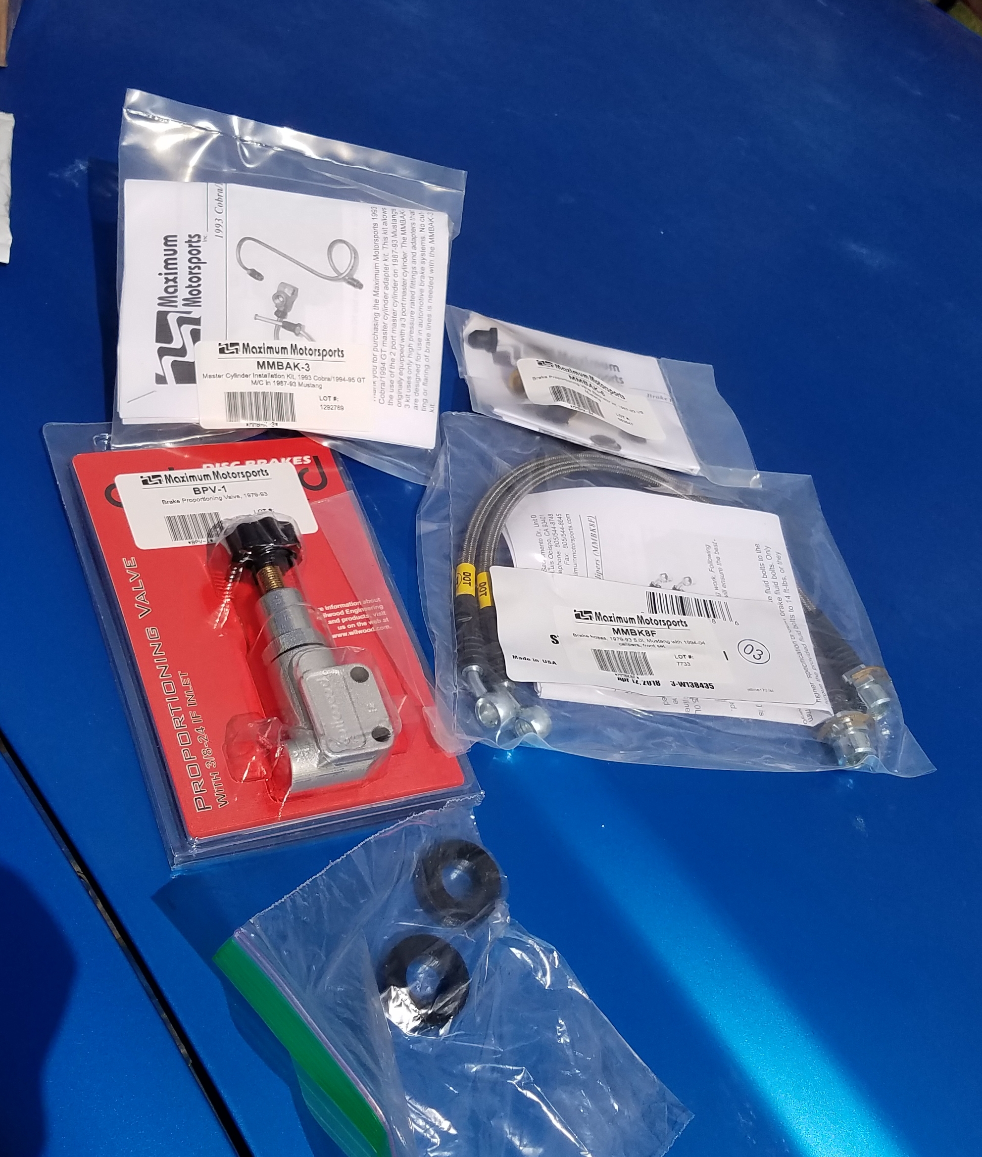

Wilwood manual proportioning valve, Maximum Motorsports braided front brake lines, Maximum Motorsports factory proportioning valve eliminator kit, Maximum Motorsports Fox to 93 Cobra master cylinder lines. Also pictured are spacers for the fox ball joint to SN95 spindles in case I don't change out the still fairly new ball joints at the time of the swap.

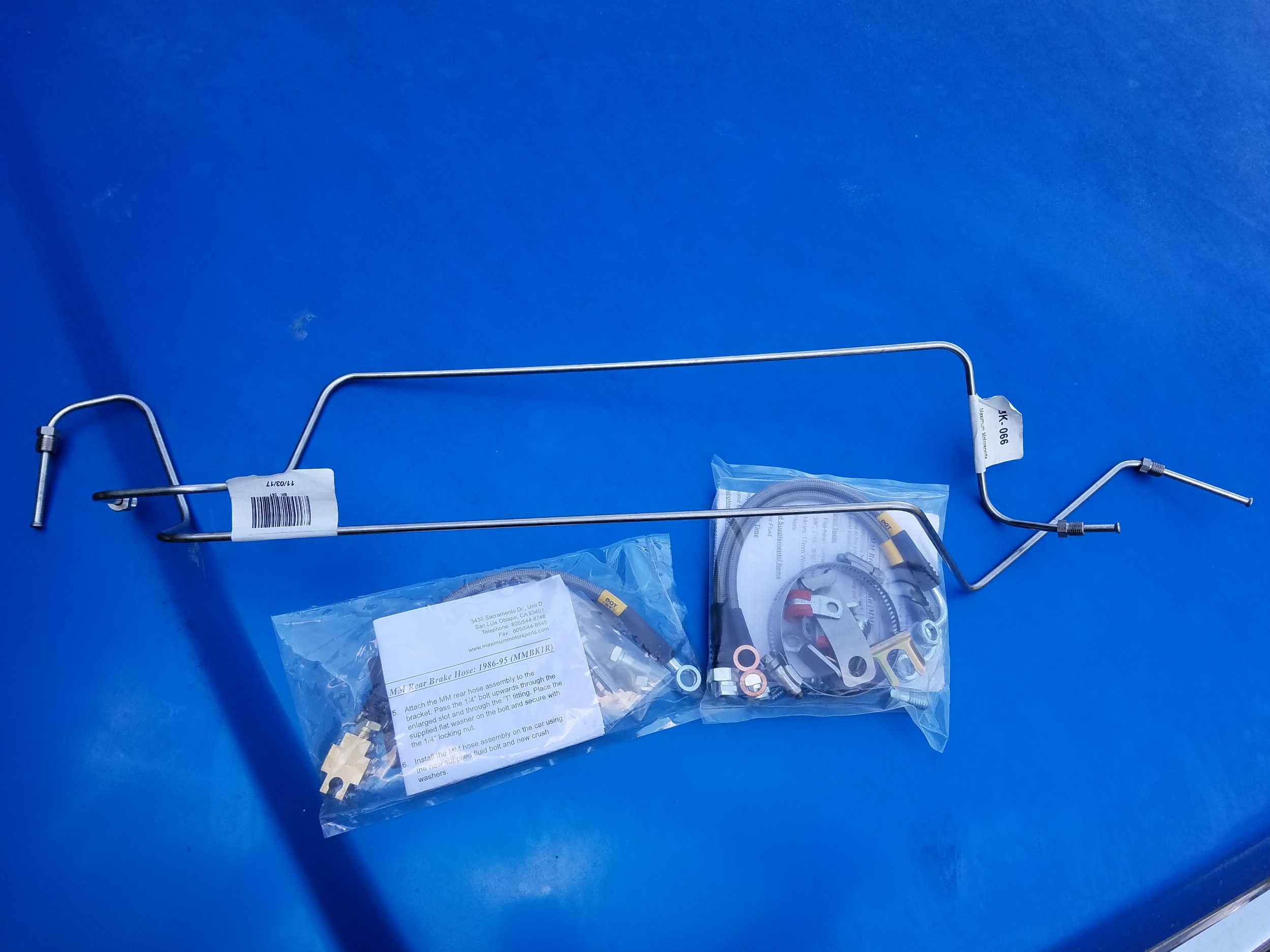

Maximum Motorsports rear hard lines and braided soft lines to convert from Fox to SN95 rear discs.

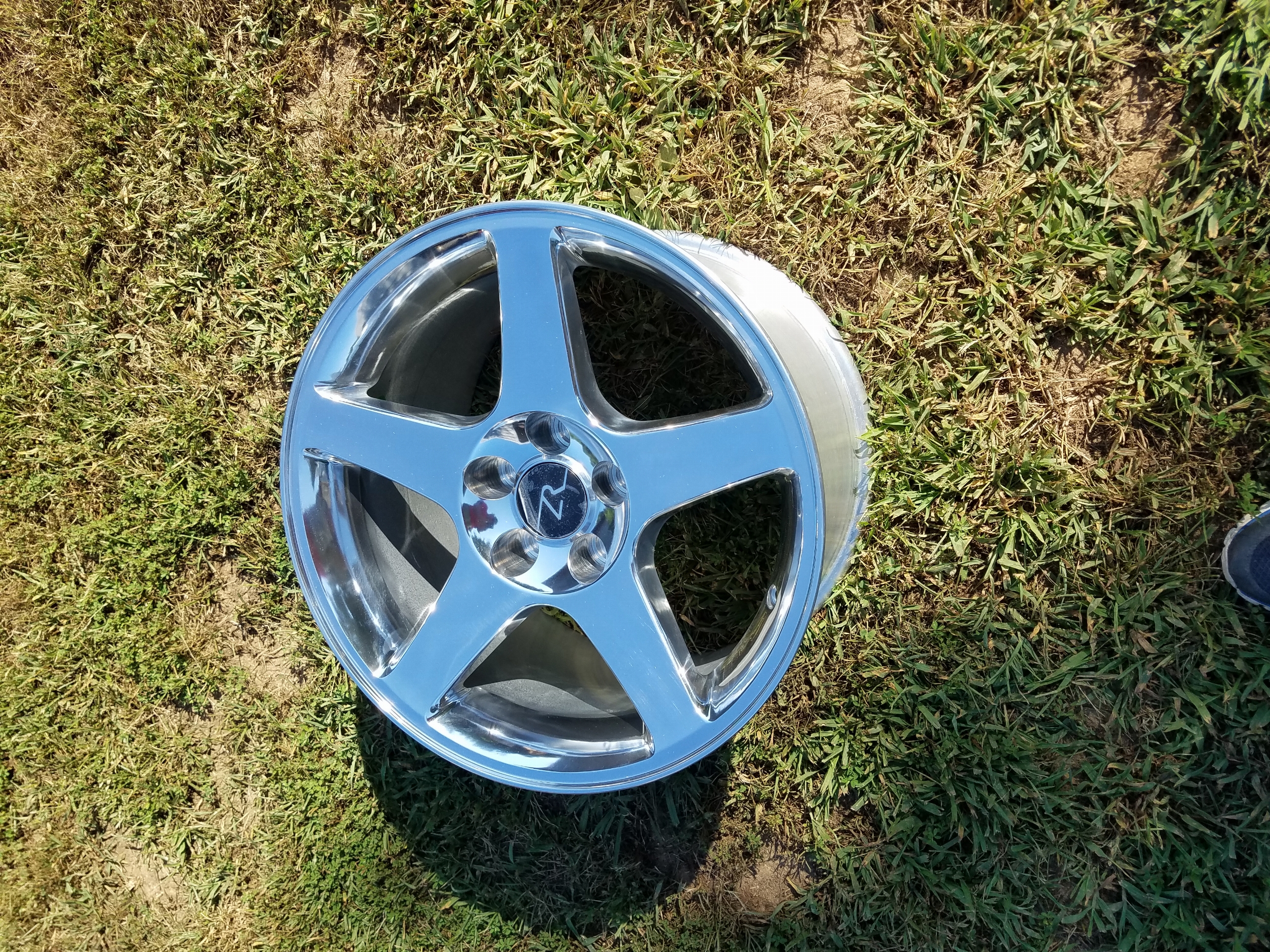

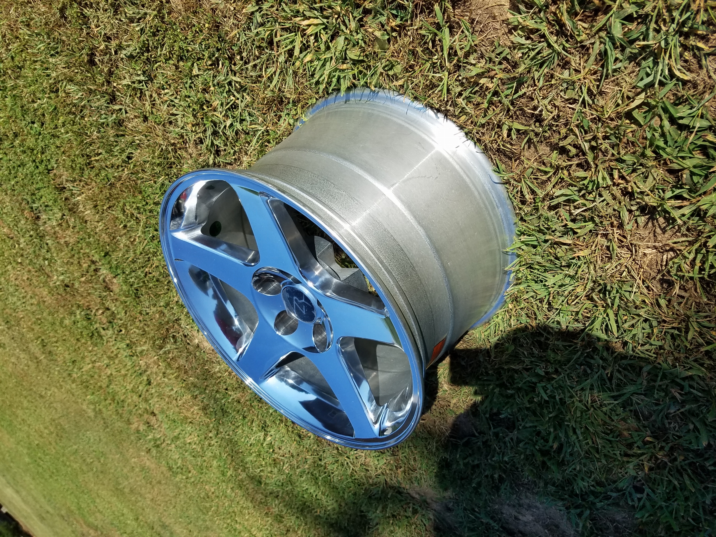

The wheels I will be running on the street.
17x10.5 Polished '03 Cobra rear with 315/35-17 tires
17x9 Polished '03 Cobra front with 234 or 245/45-17 tires

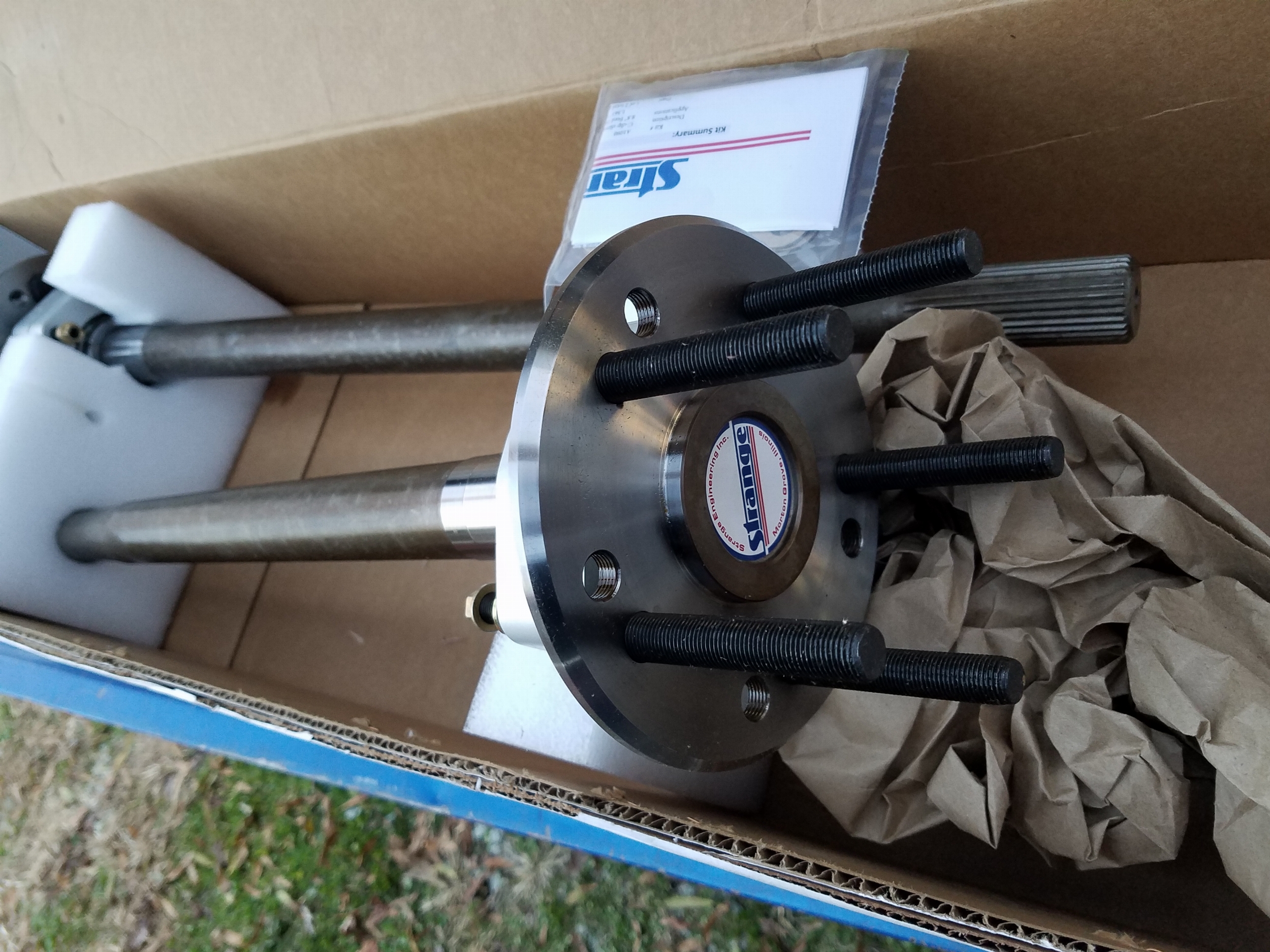

The rear axles will be Fox length Strange 31 spline Hy-Tuff race axles with 5x4.5 lug pattern. I'm still debating on whether or not to upgrade to 5/8x18 x 3" drive lugs. I am currently running the same axles in the 4 lug pattern with 1/2x20 x 3" studs.
I may even change to 33 spline with a spool.

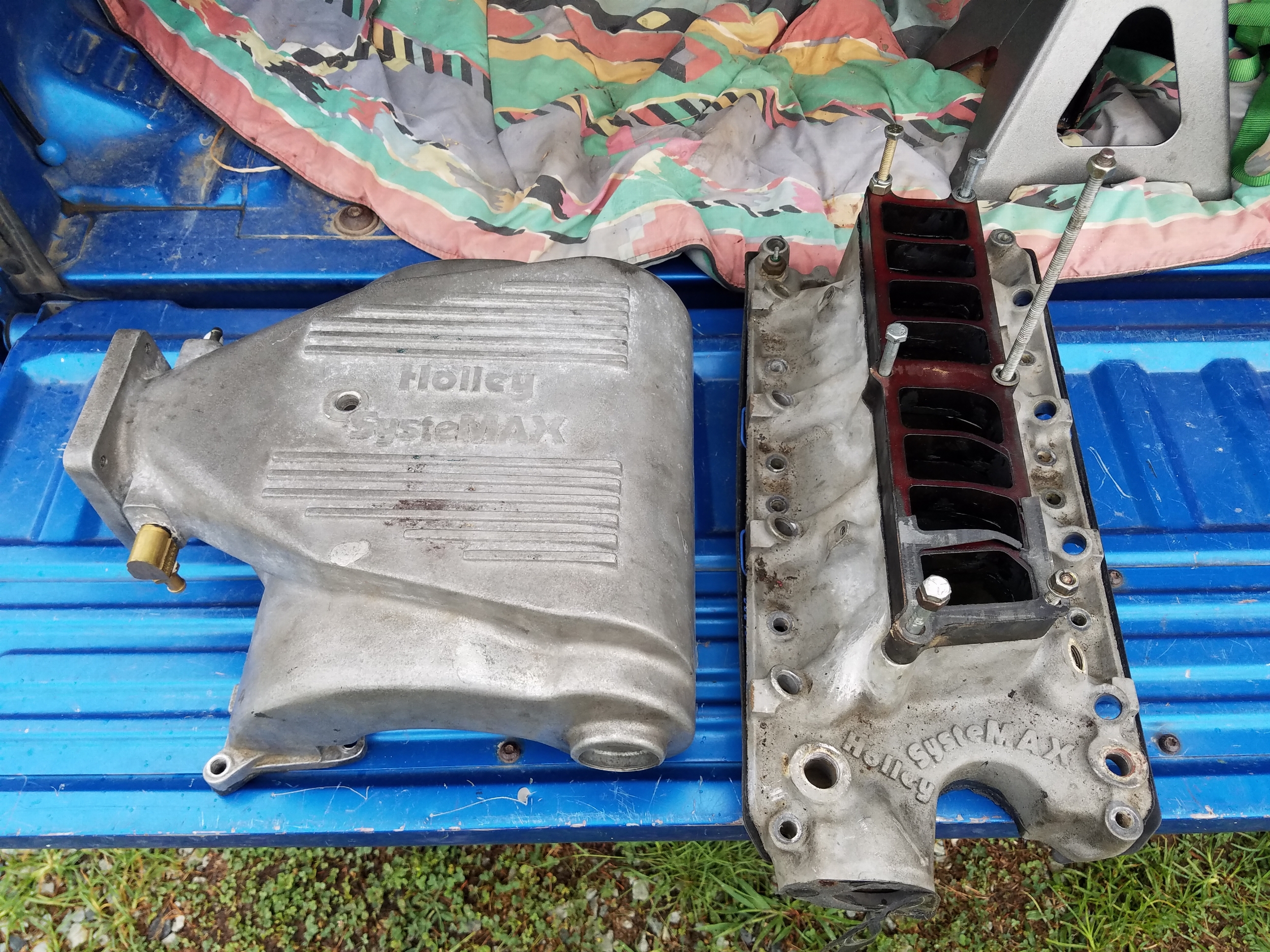

Just picked up a used Holley Systemax II intake with 1" spacer for $300.
I'll clean it and either polish it or paint it later.
It won't be going on anytime soon. I still need to collect a LOT more parts to build the engine up first.

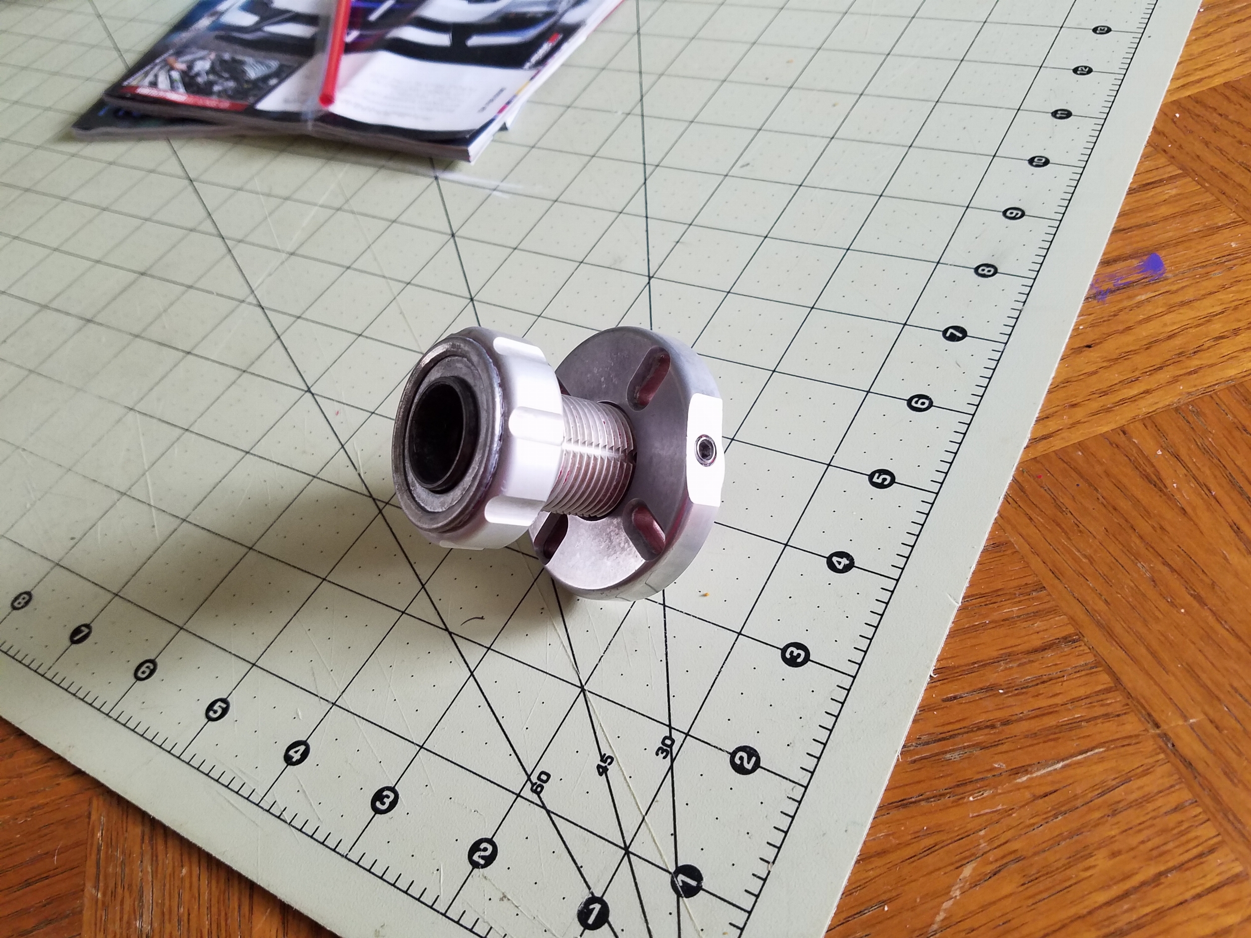

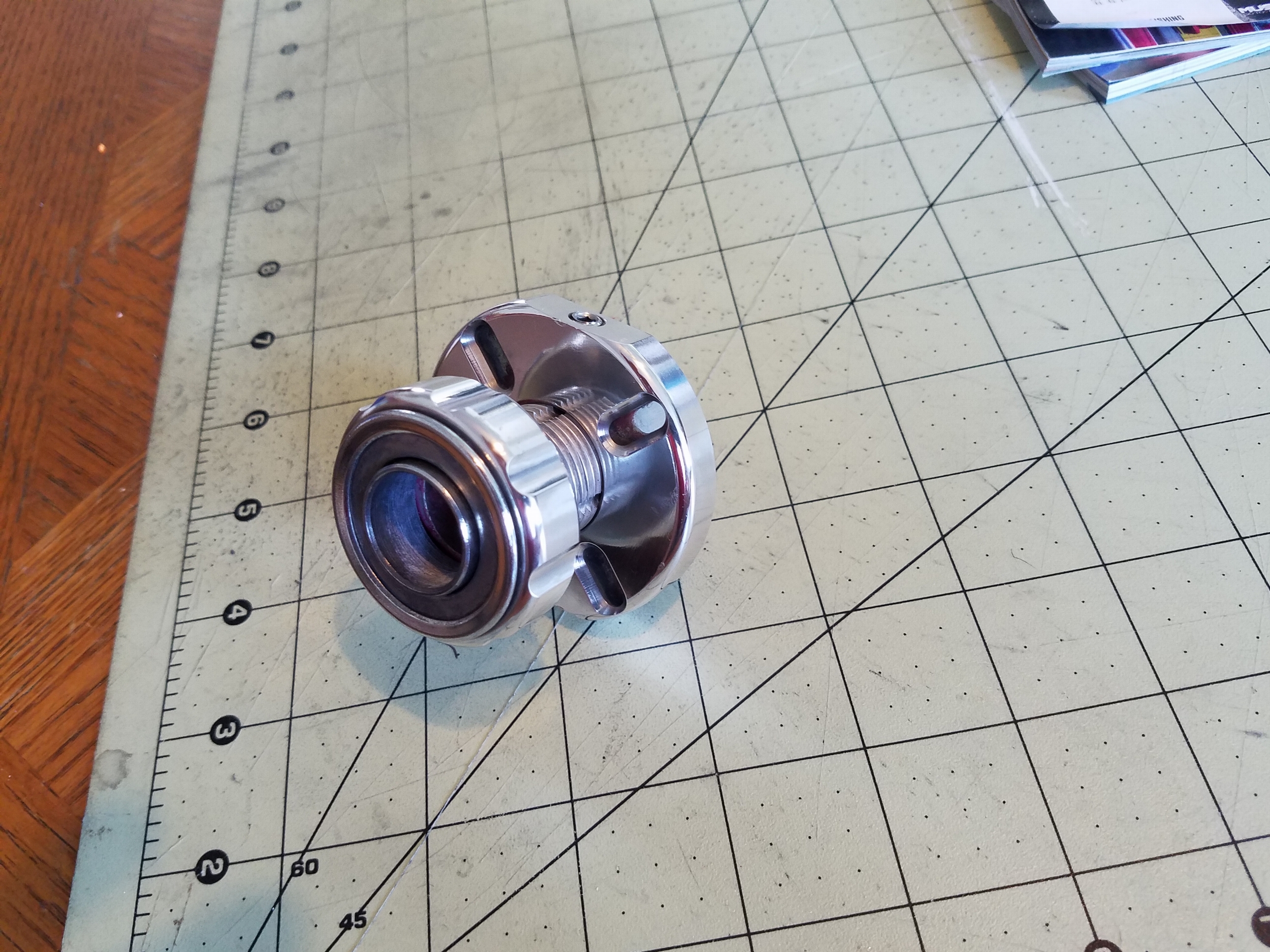

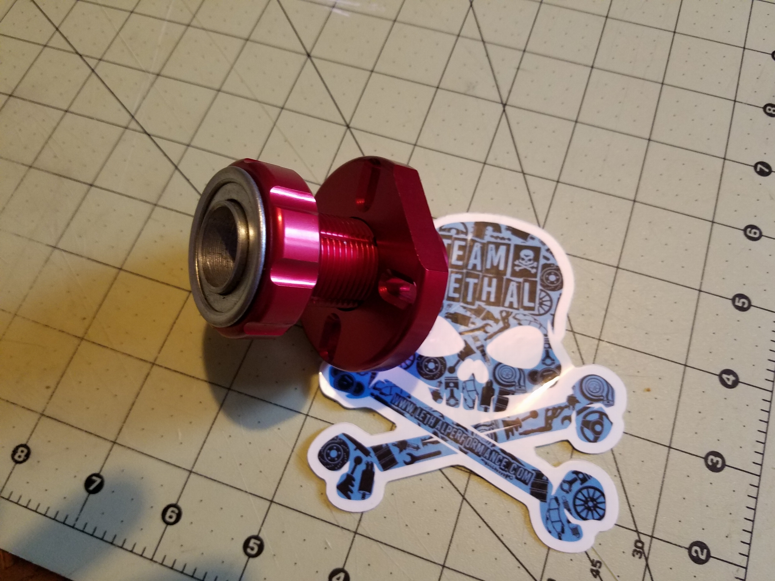

I have also having problems with the cheap clutch cable firewall adjuster loosening and the cable getting slack.
So I ordered a McCleod quik-click firewall adjuster.
The red anodizing will clash with the color I plan to paint the coupe, so I took some Easy-Off oven cleaner and stripped the coating. I will do a quick polish to get the bare aluminum looking a little better.

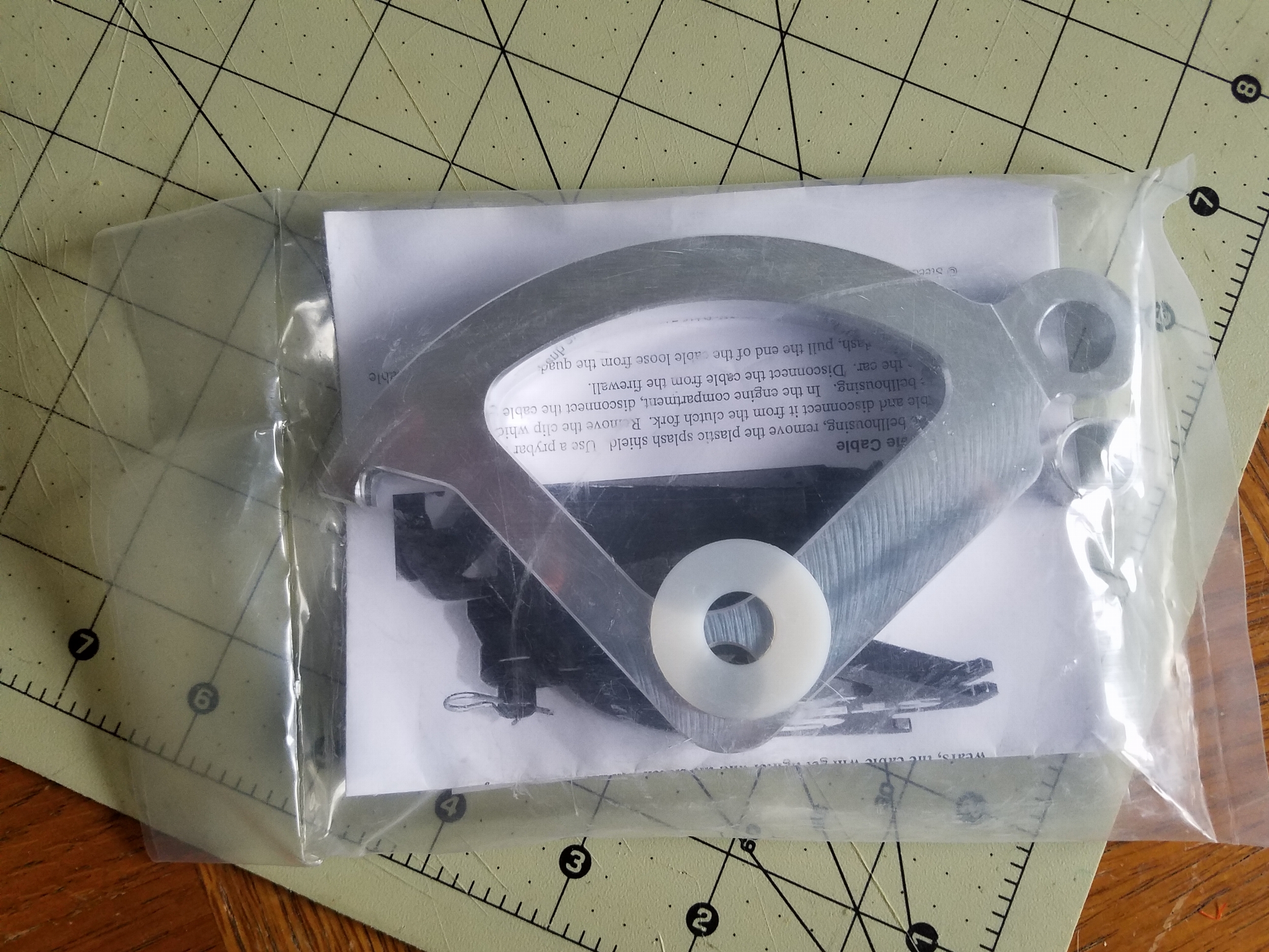

I've also never really happy with the clutch adjustment and feel. So also ordered is a Steeda quick ratio quadrant to replace the cheapo double hook piece that is currently installed.
This Friday I'll be installing the new FW adjuster, quadrant, and a new cable.
Got the new clutch stuff installed, adjusted, and it feels...
AMAZING!
When I first pressed in the clutch I literally thought I didnt hook the cable up to the clutch fork. It was that smooth and easy. I have never felt it that smooth in at least 10 -12 years.

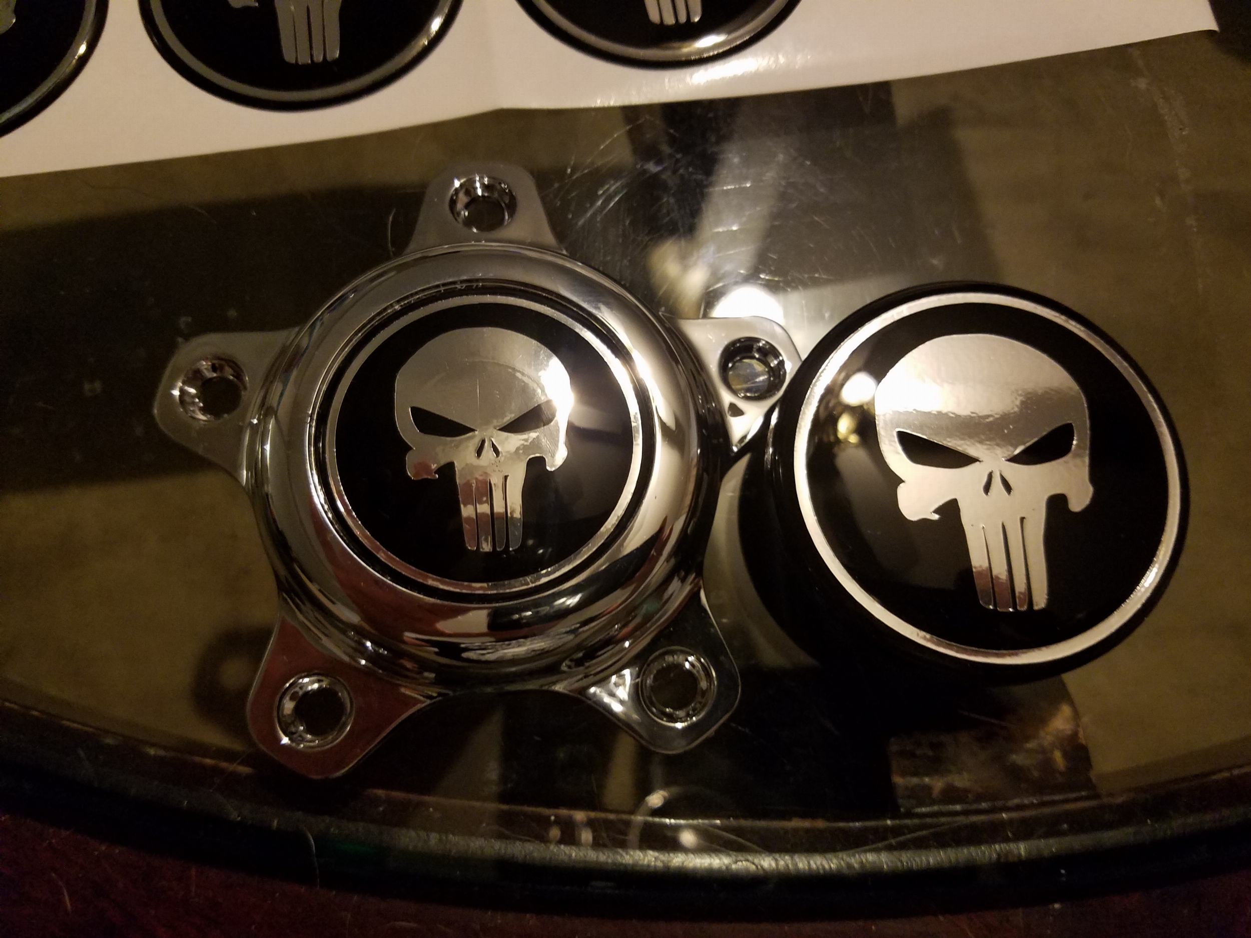

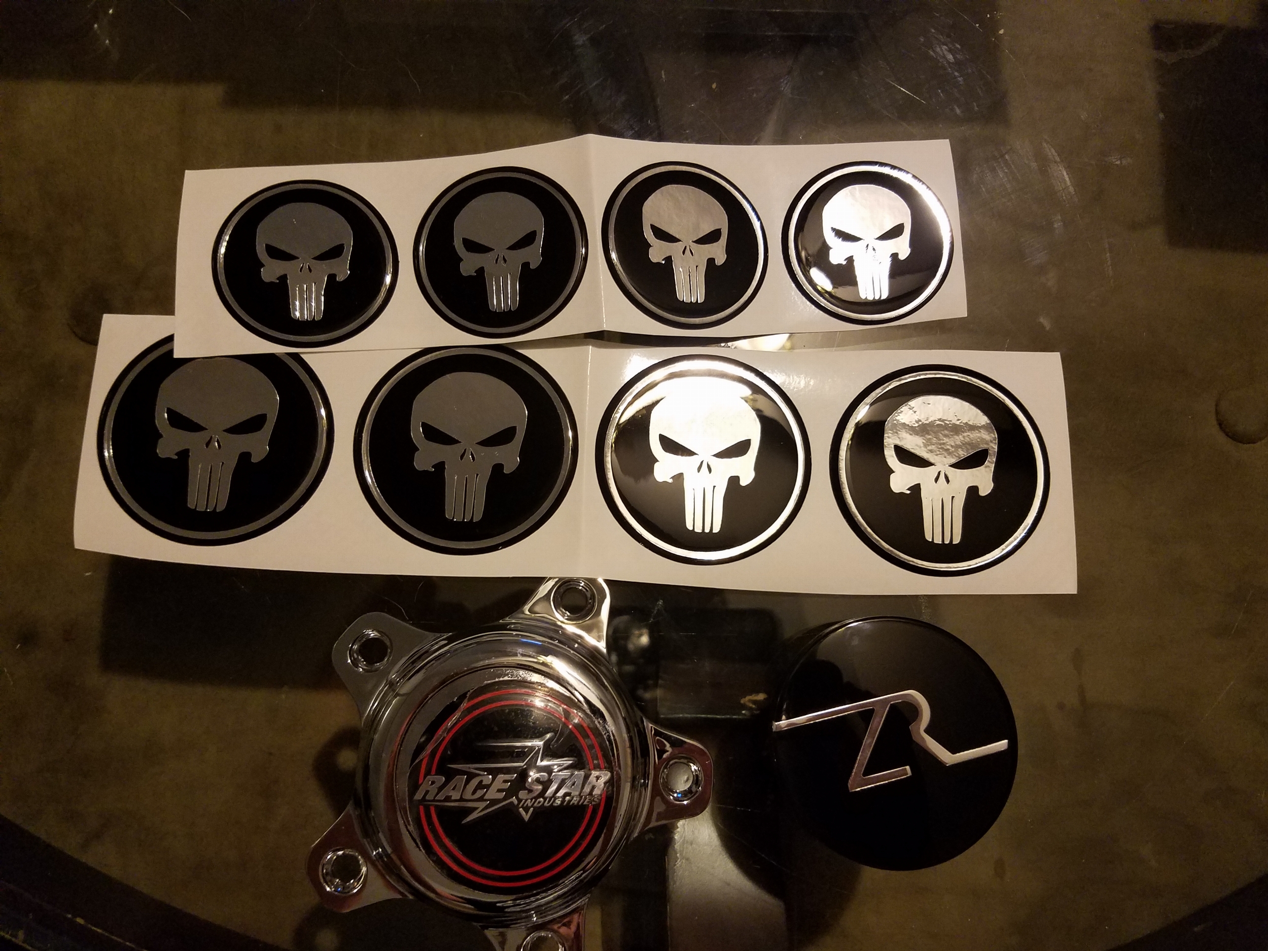

I ordered some new domed wheel center cap decals from Tom Clark (aka sinisbuilt) for the wheels that I will be running after the 5 lug swap.
One set is for the Racestar drag wheels and the other set is for replica polished '03-'04 Cobra wheels for the street.

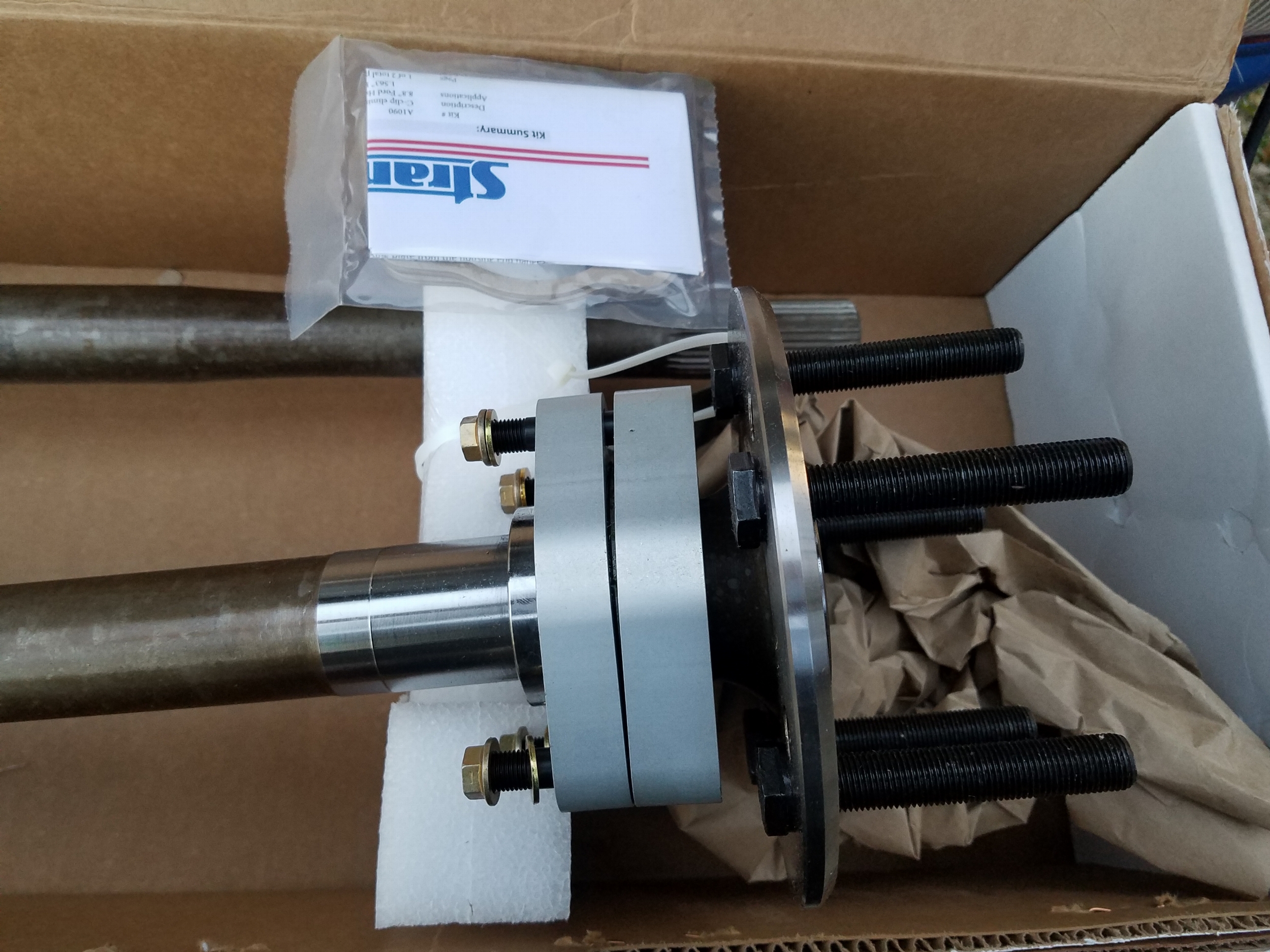

Also I took advantage of the black Friday sales special and ordered a set of Strange Engineering Hy-Tuf 5 lug race axles for when I get to the 5 lug swap.
Well I took advantage of the Black Friday / Cyber Monday deals and got a few more items for the 5 lug swap.
First as mentioned above were the Strange Engineering Hy-Tuf race axles in Fox width with the 2.78" brake rotor register and 5x4.5" lug pattern 1/2"-20 x 3" drive studs. I also got new C-clip eliminators to go with them.

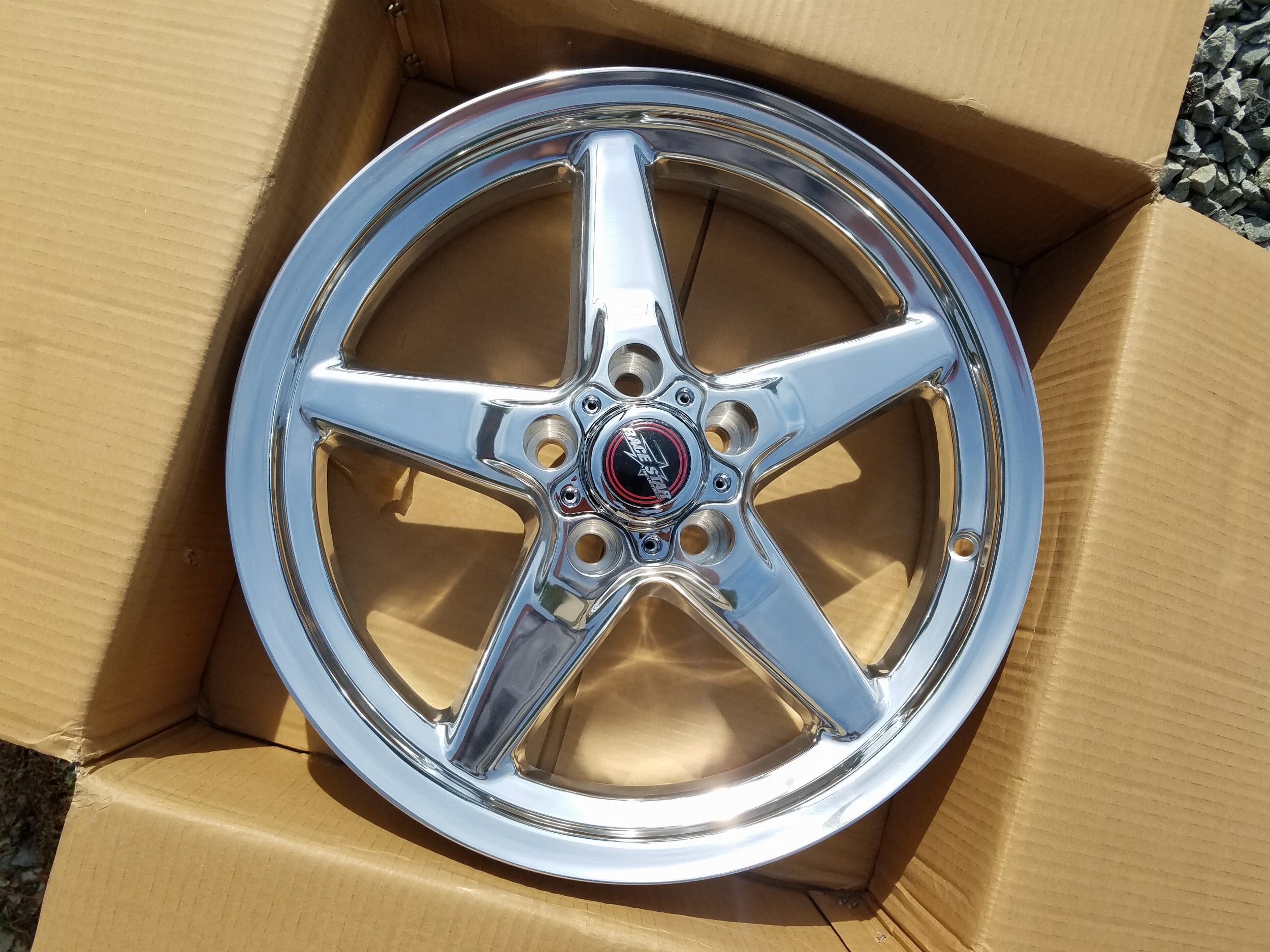

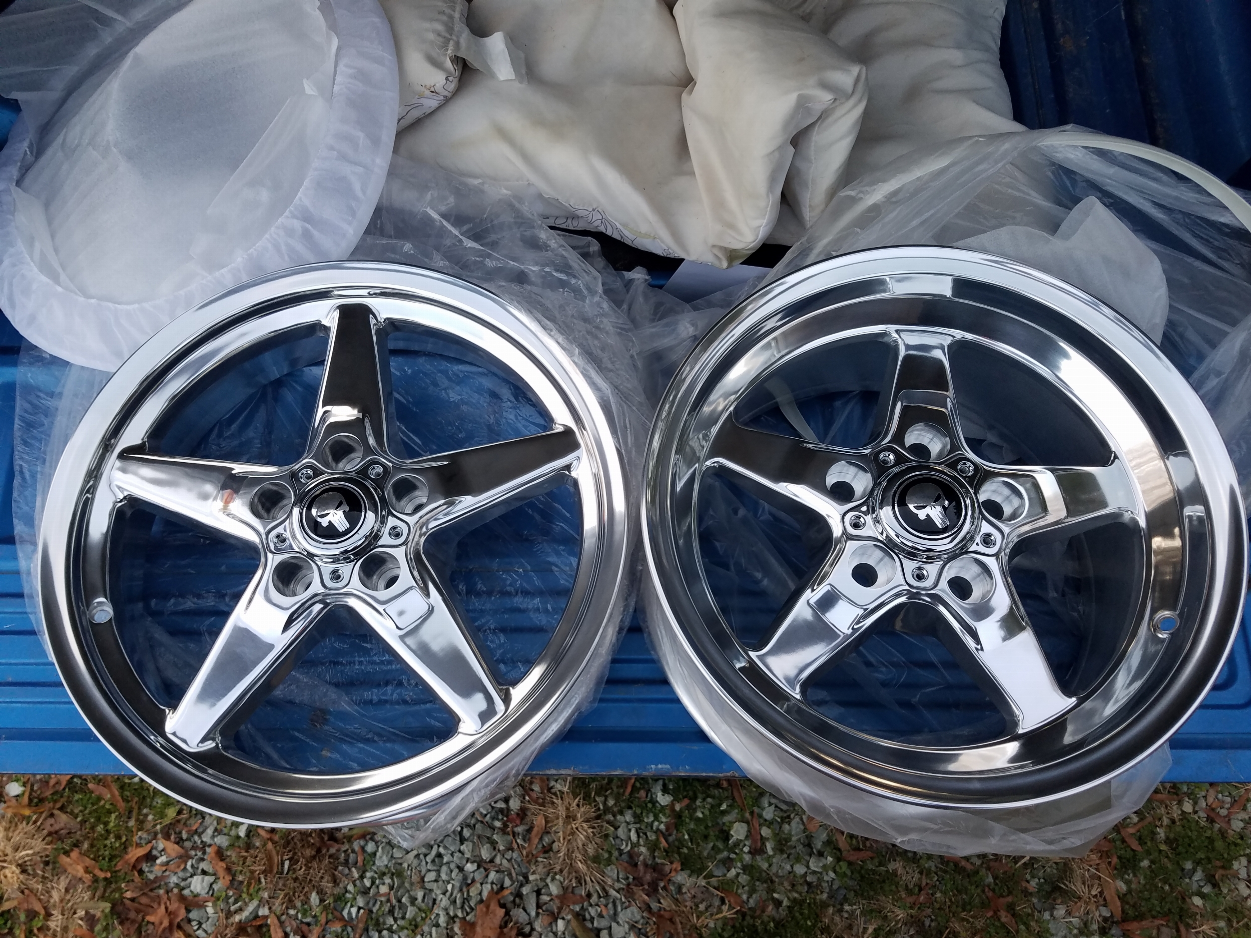

Next was 2 - polished 15x8 Racestar wheels for the rear during the track sessions. I had gotten the matching 17x4.5 fronts back in the summer.
Introducing the "Punishstars"

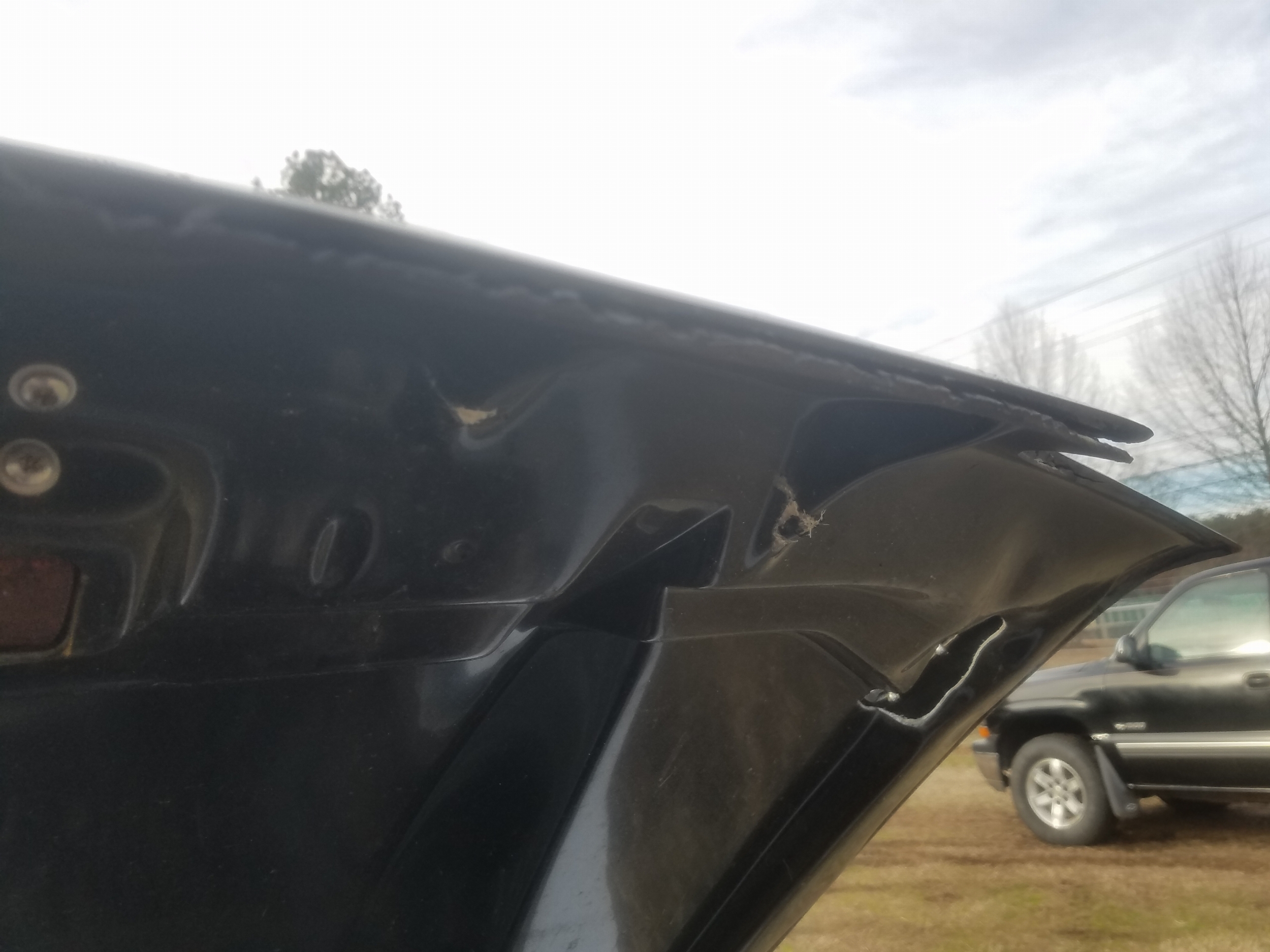

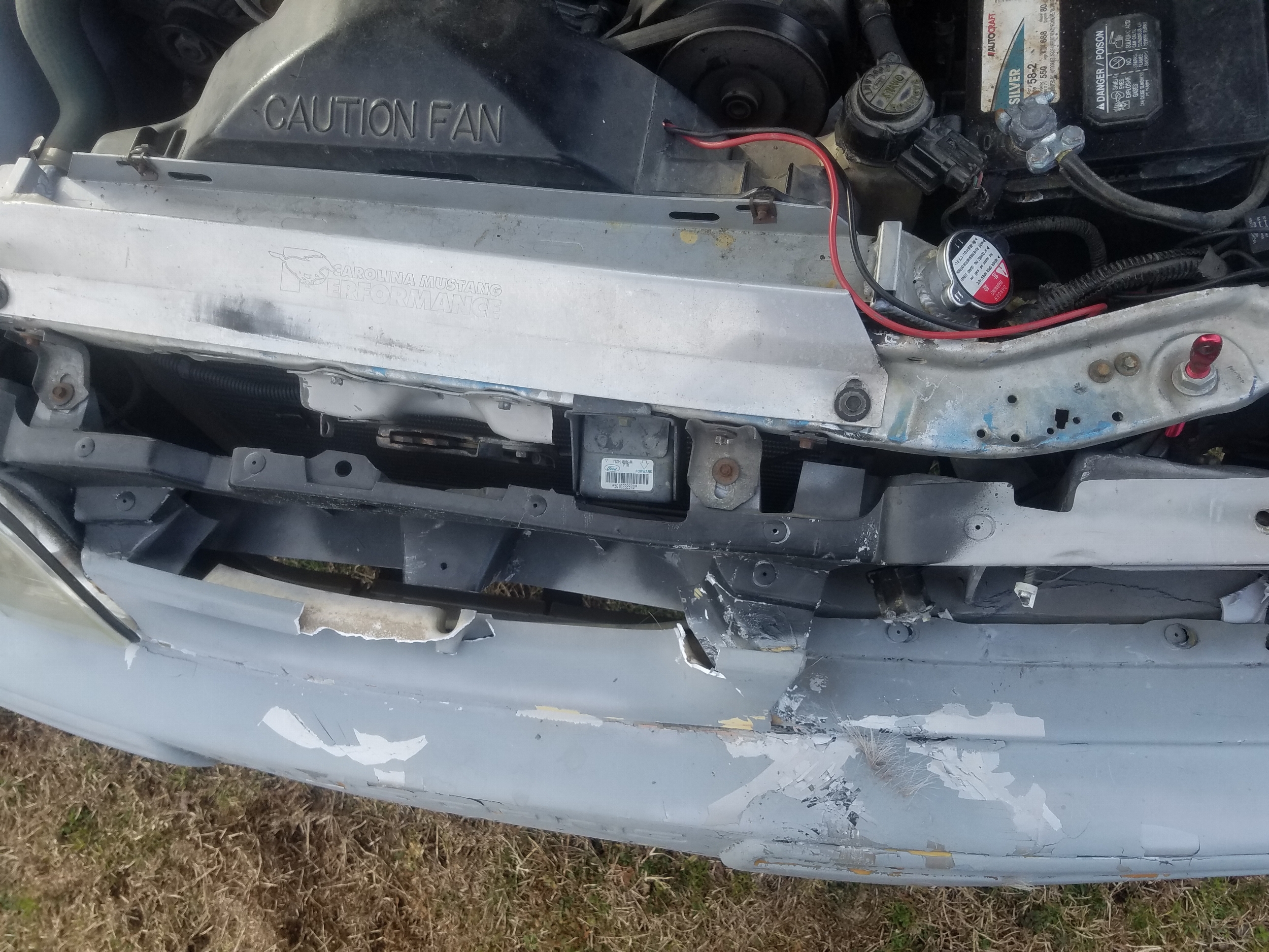

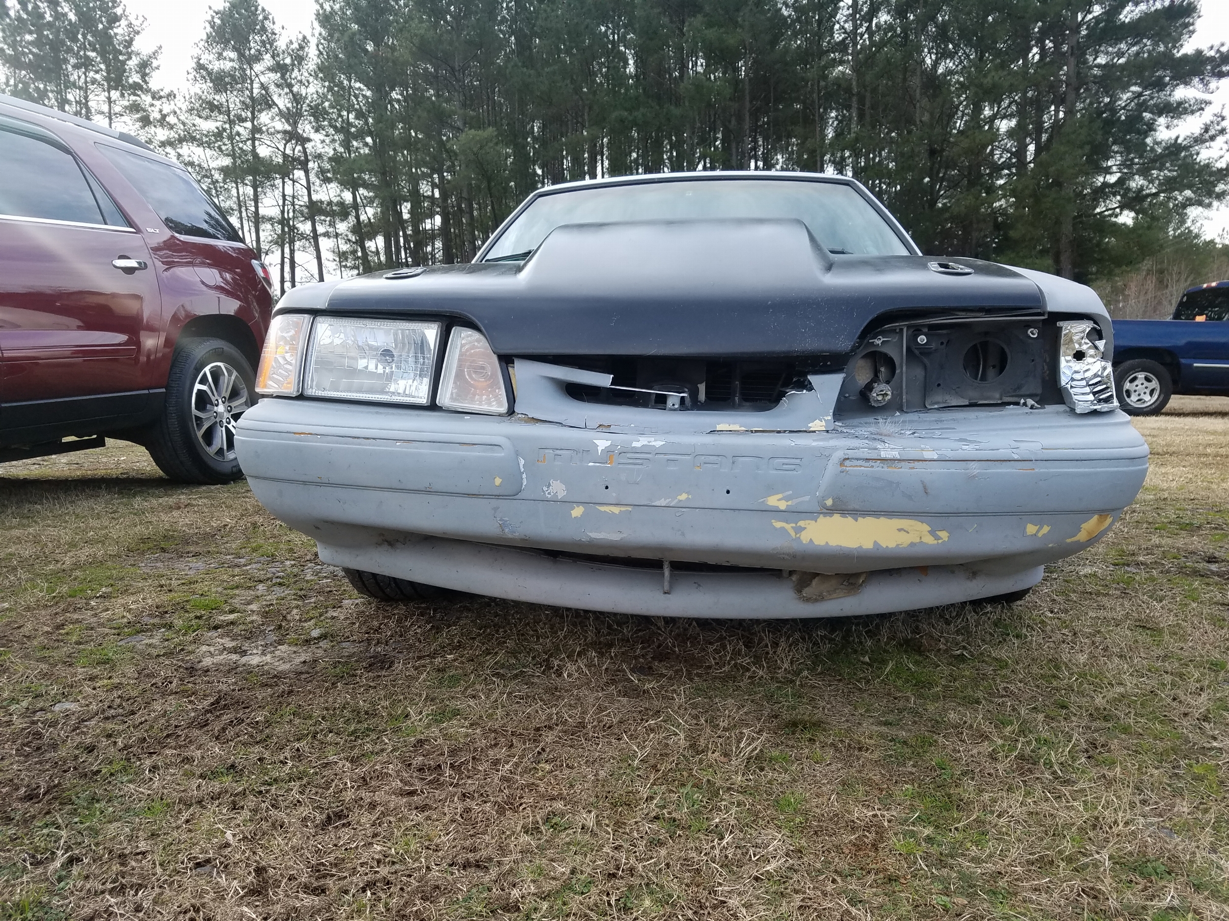

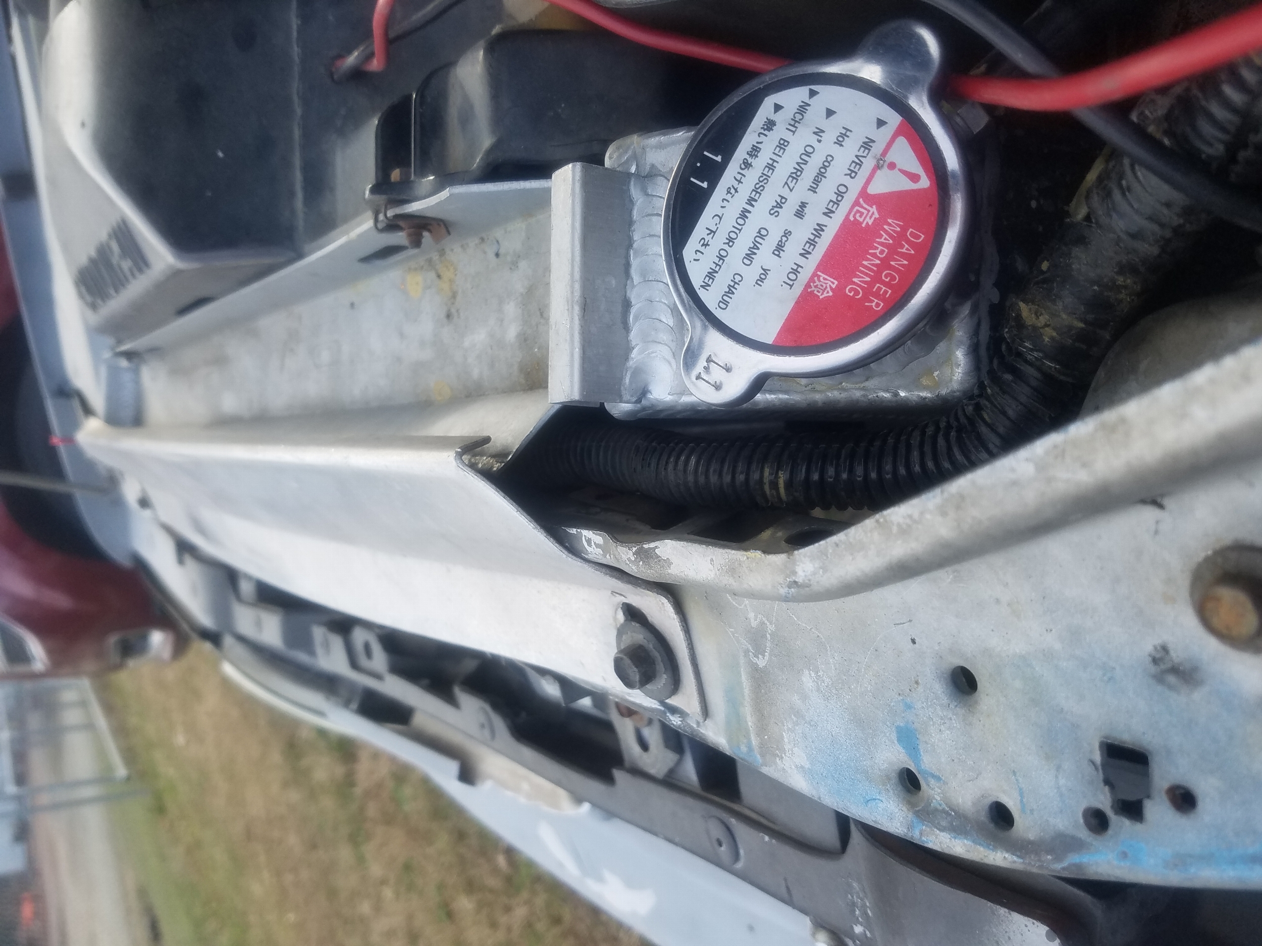

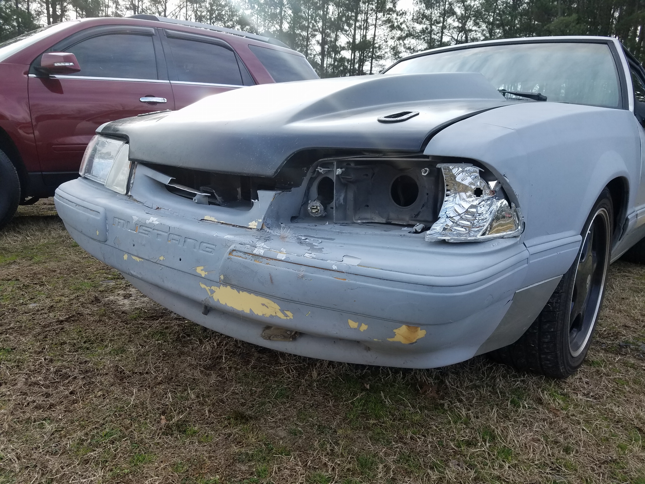

Well, I've had a bit of a set back. Yesterday morning I had an occurrence of trying to occupy the same space as a deer.
So now I'll need a new bumper, headlights, and possibly a new radiator. I'll also need to do some straightening of the core support, driver side fender, and repairs to the hood.
