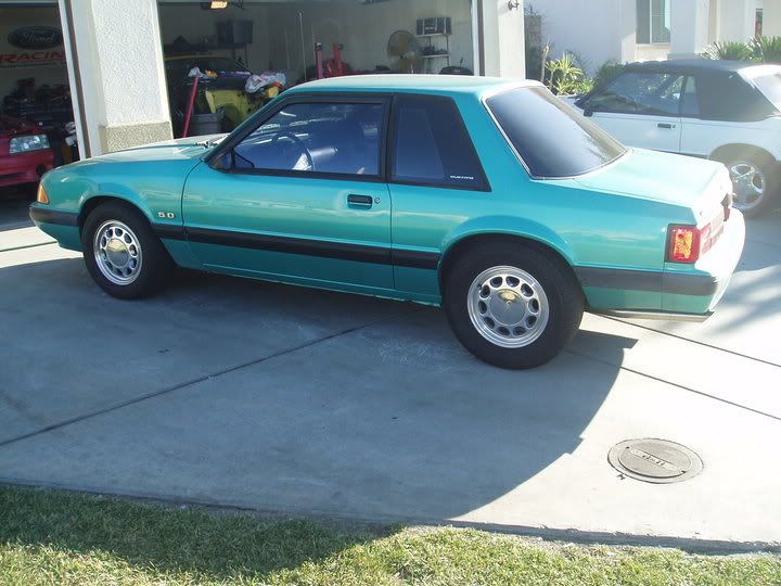

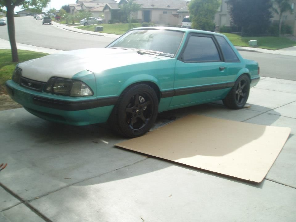

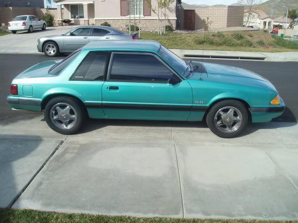

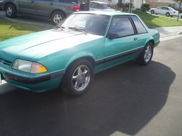

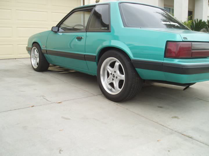

Heres when I got her

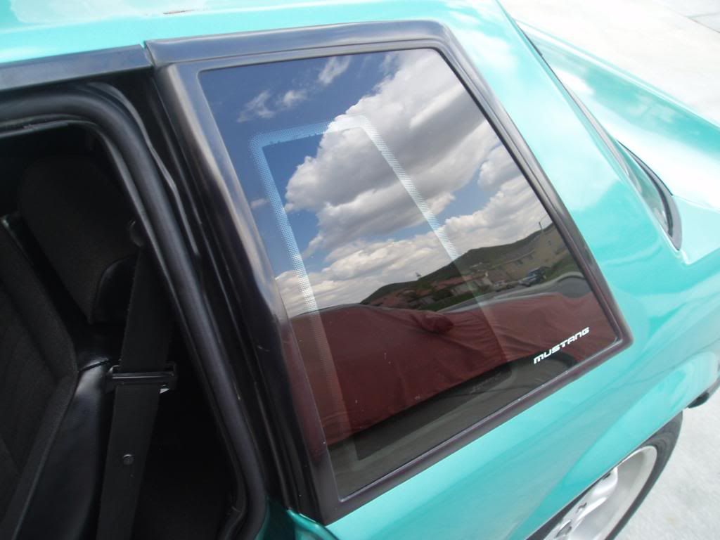

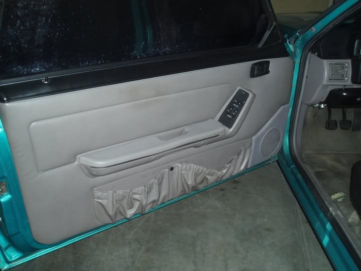

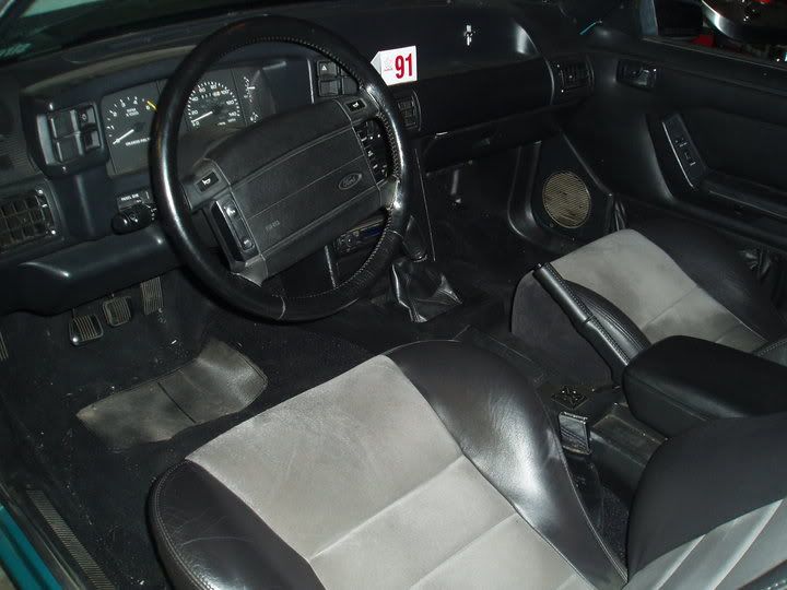

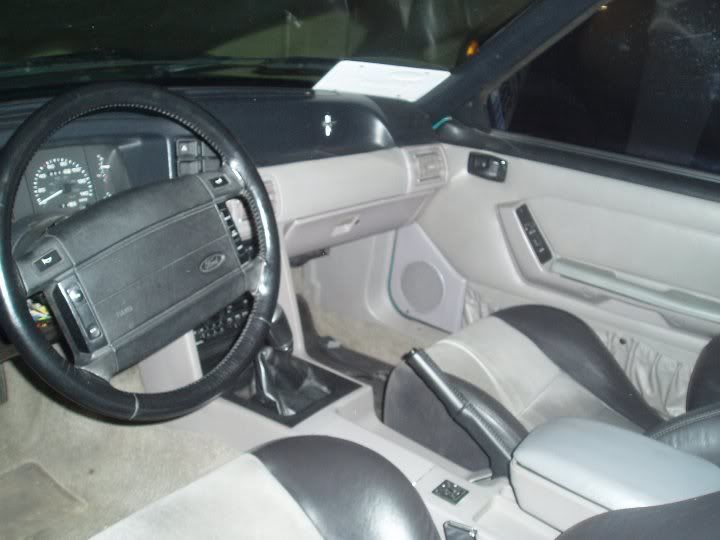

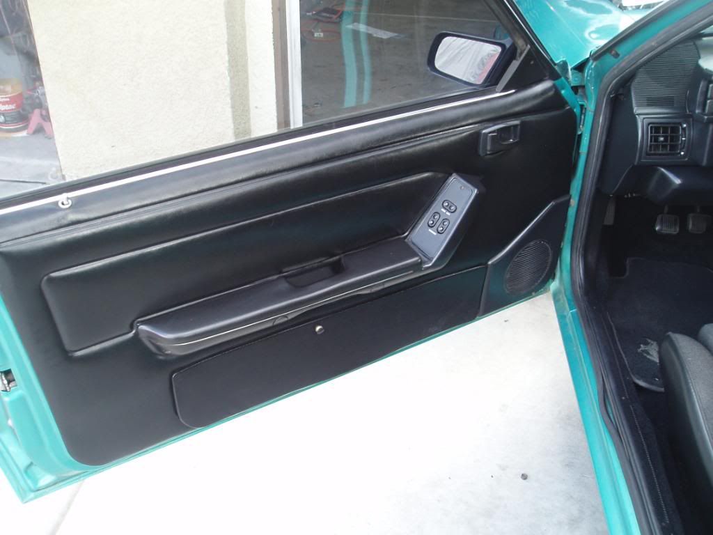

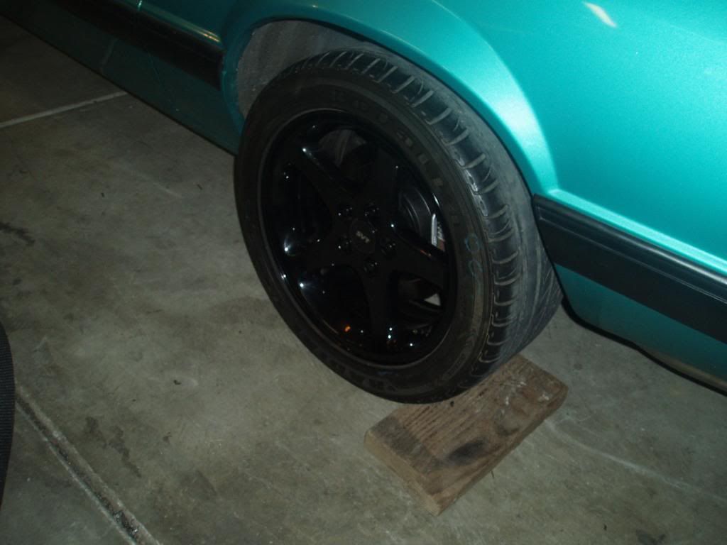

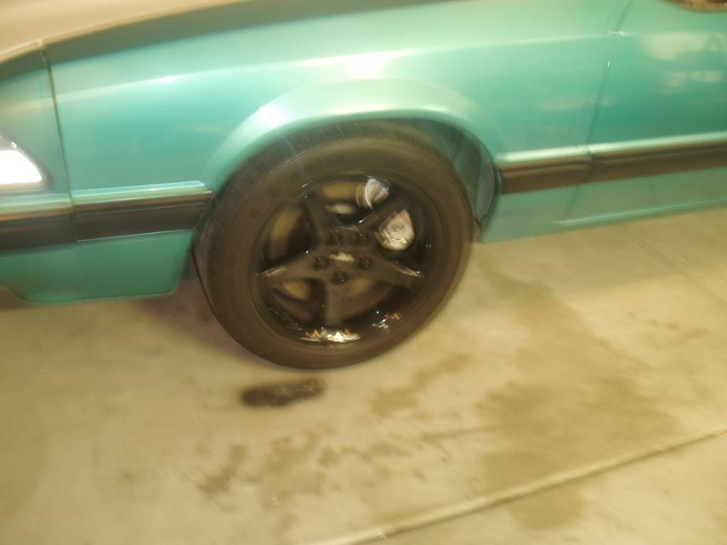

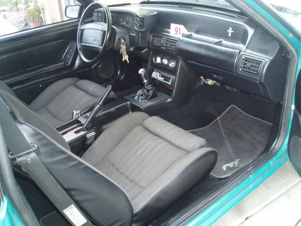

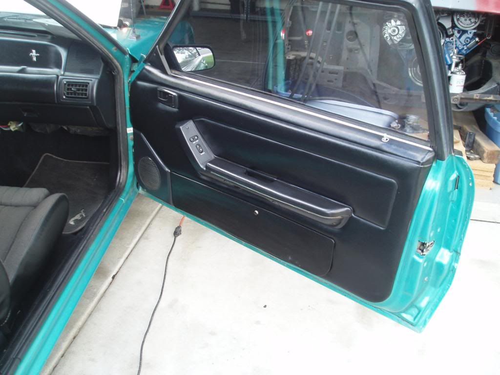

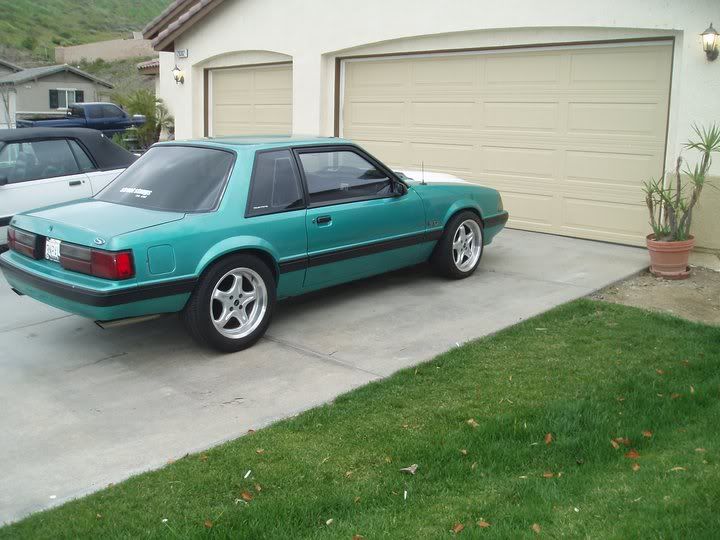

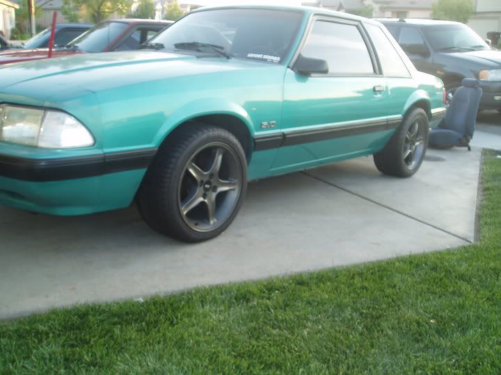

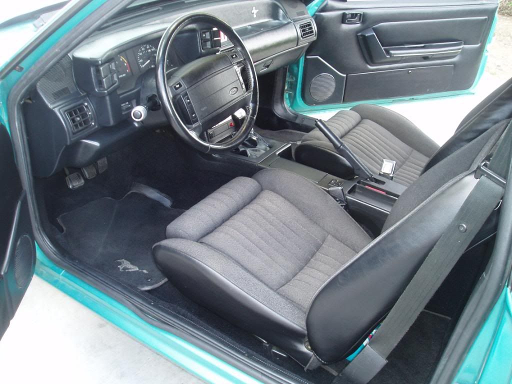

Wheel swap # 1 and black interior conversion early 2010

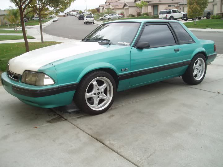

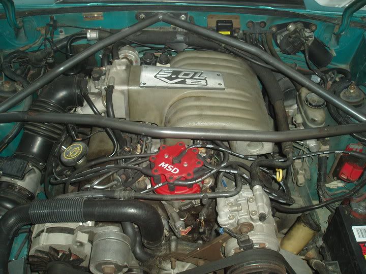

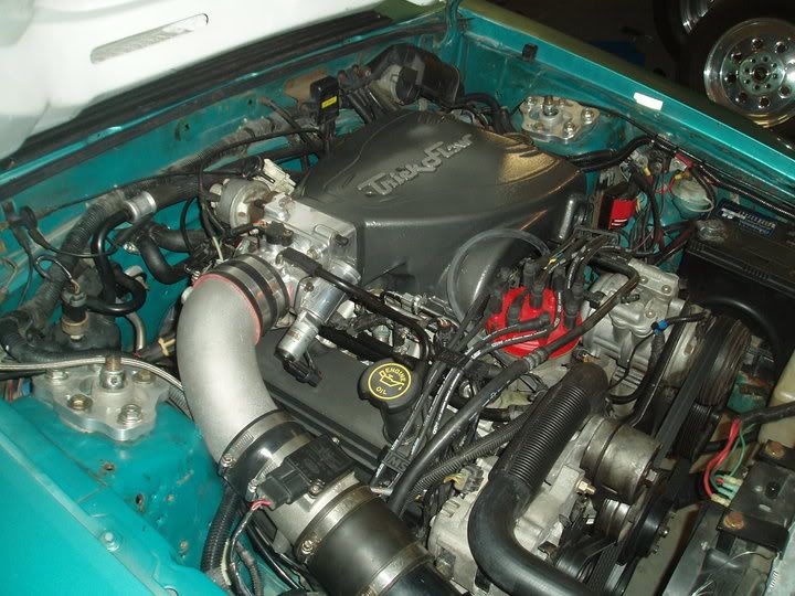

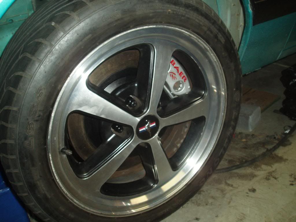

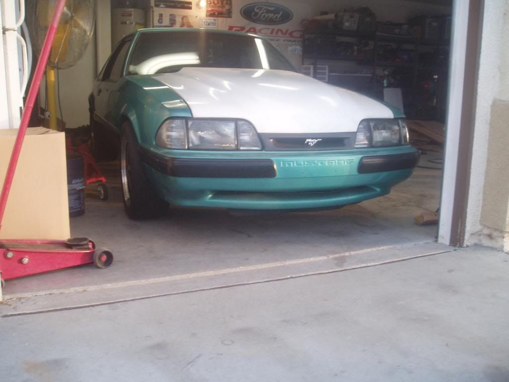

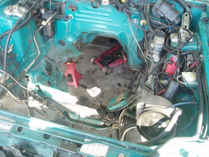

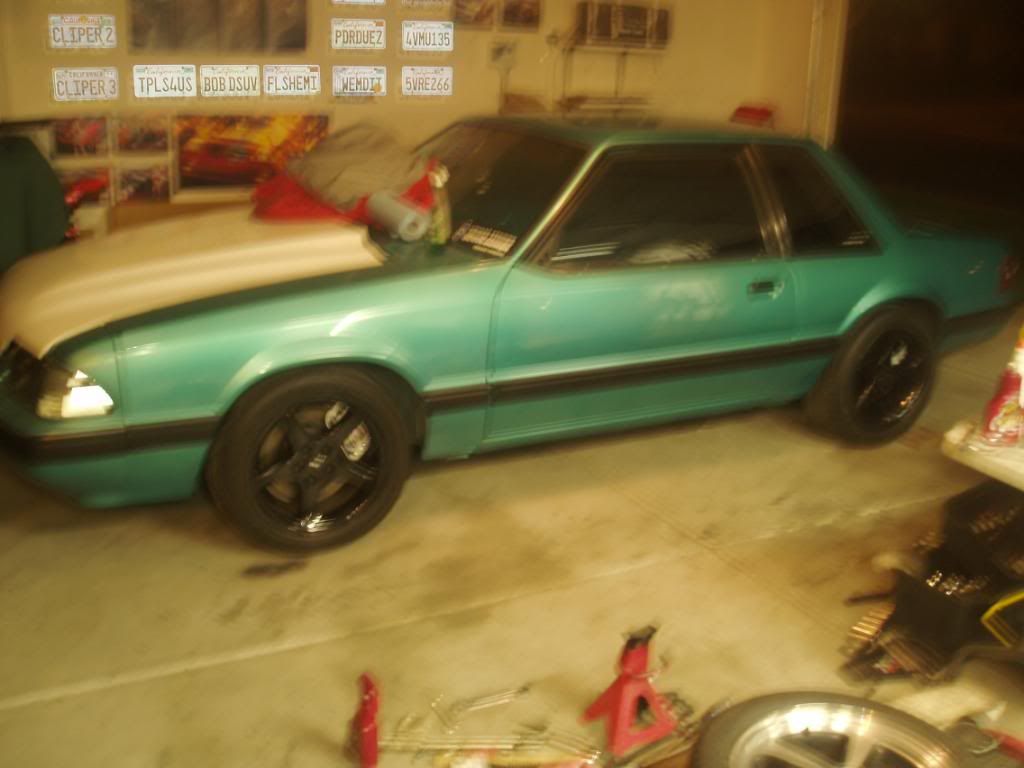

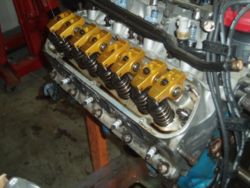

Wheel swap #2 and stock engine pics
Beautiful car. What are the specs on the engine?
.060 over making it a 310ci. Edelbrock performer 170 heads, ARP studs, Crane 1.6 rockers, Custom grind cam I only know the lift is .510 don't have the cam card so not sure of duration. Trickfllow street intake, Accufab 75mm TB, 30lb injectors/FPR, Anderson N/A power pipe, Equal legnth shorty headers off road x with Flowbastards

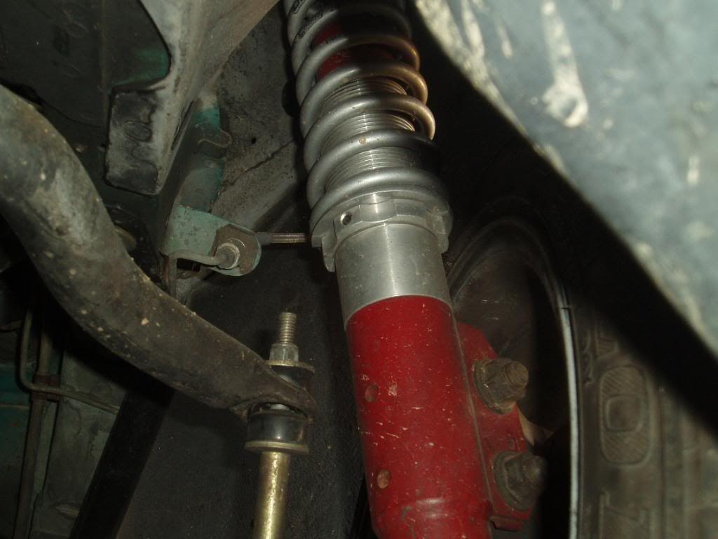

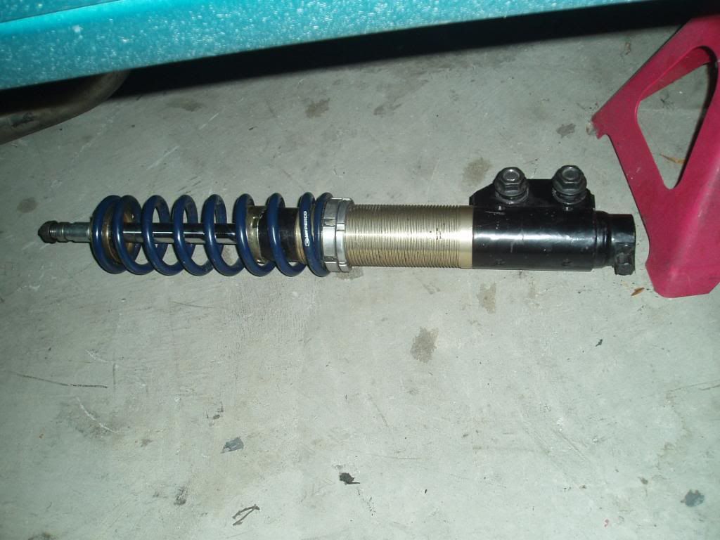

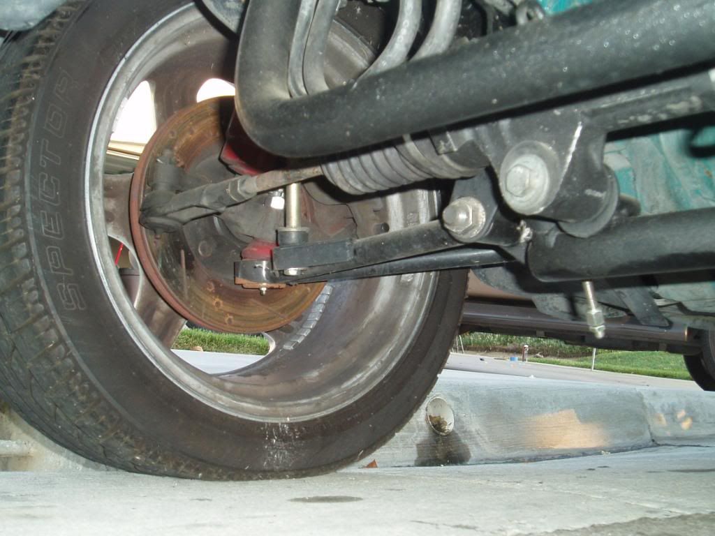

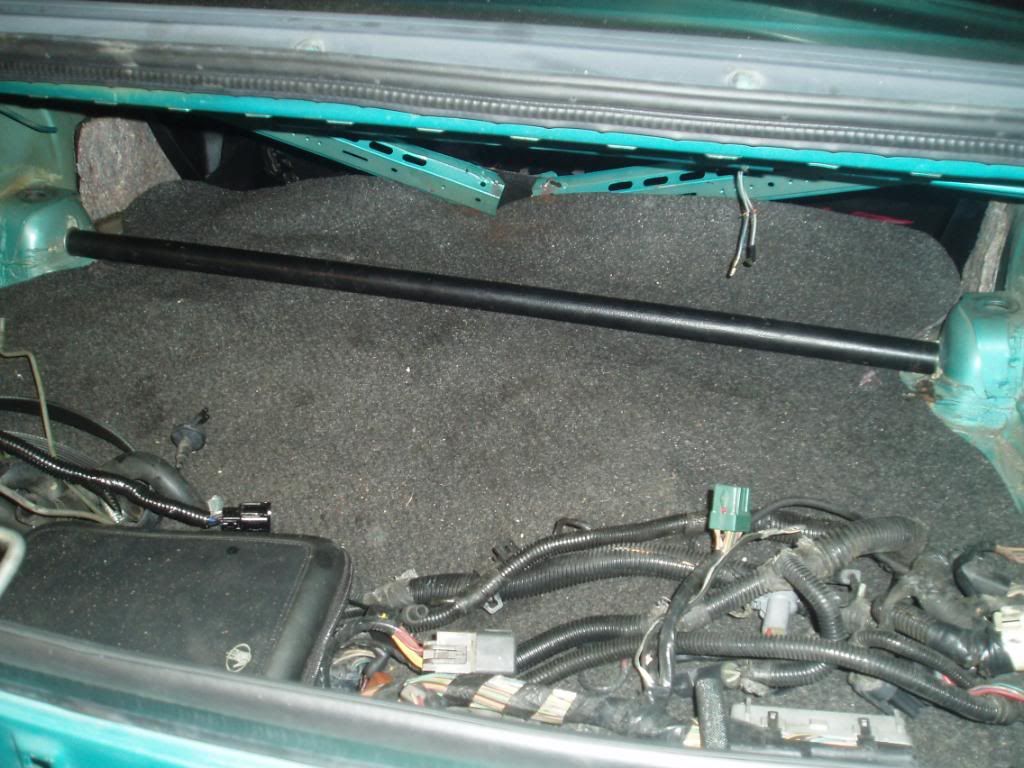

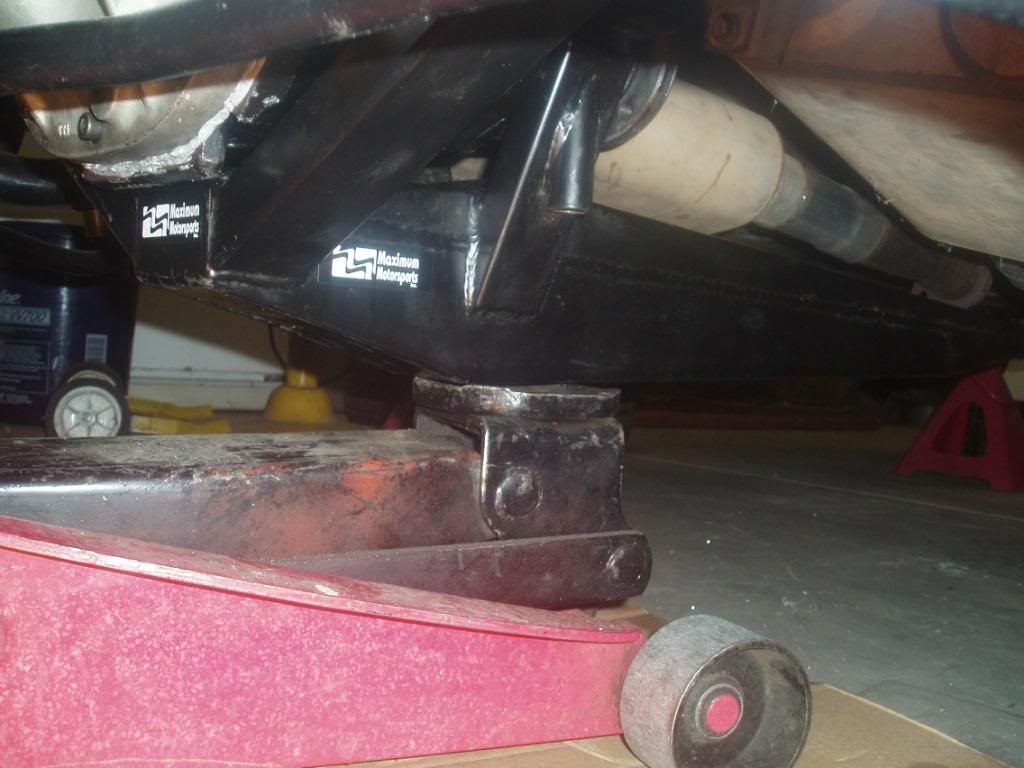

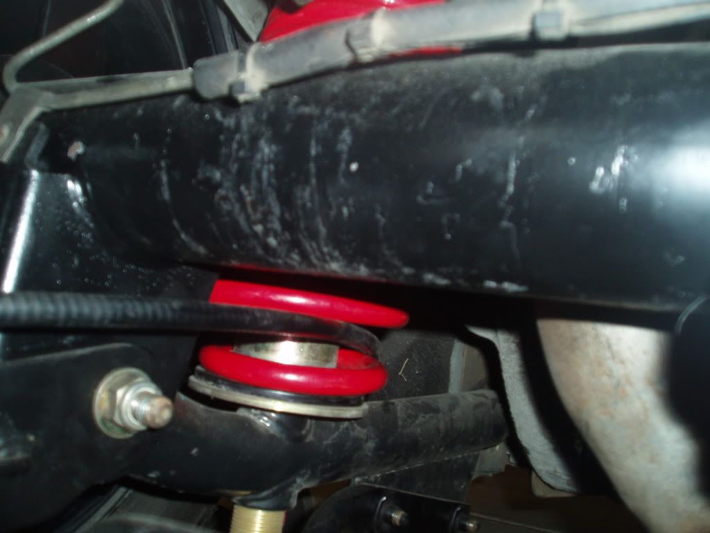

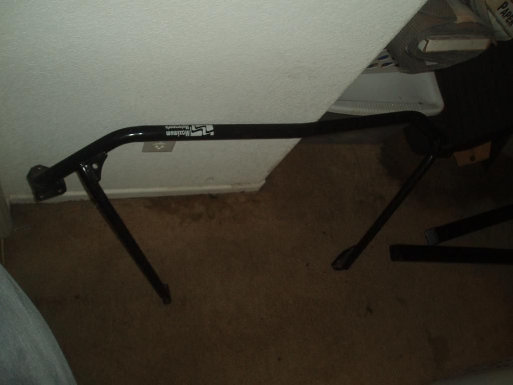

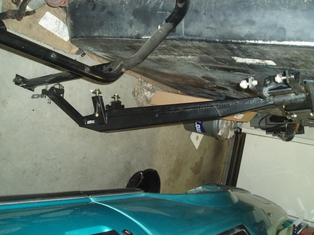

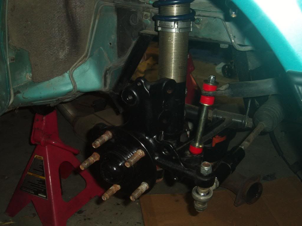

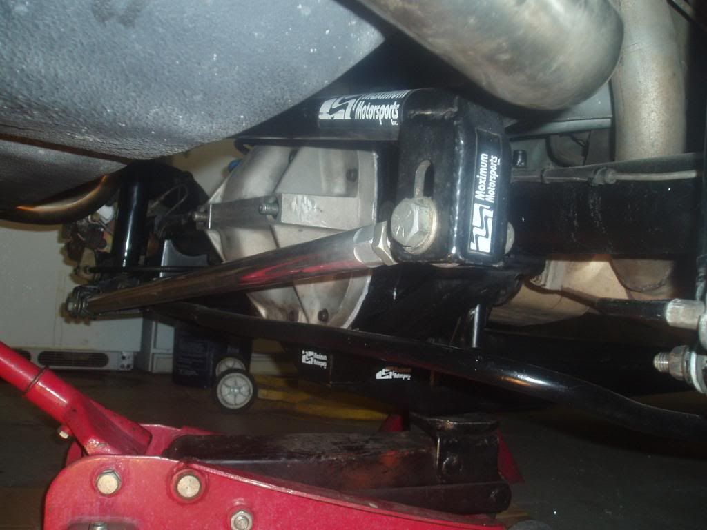

Not much progress on her for awhile but its all good. I picked up a killer deal on some new Maximum Motorsports suspension parts off of CL a few weeks back. 1 part being a strut tower brace. Pretty much the last thing I needed to complete my suspension setup on this car.

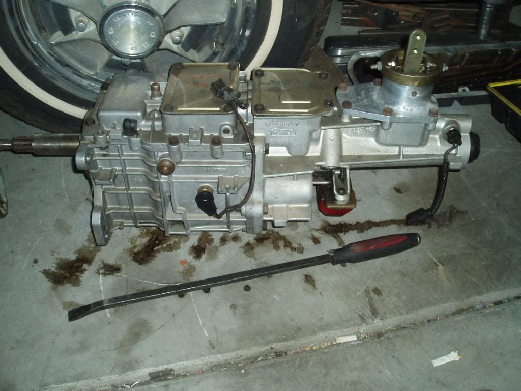

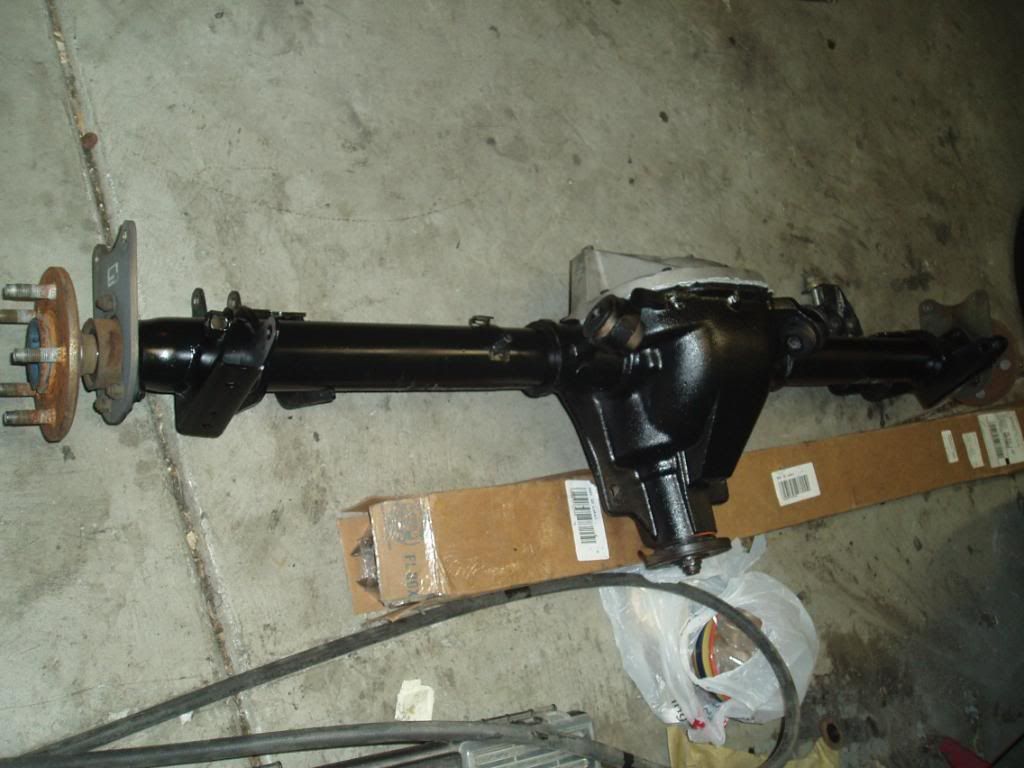

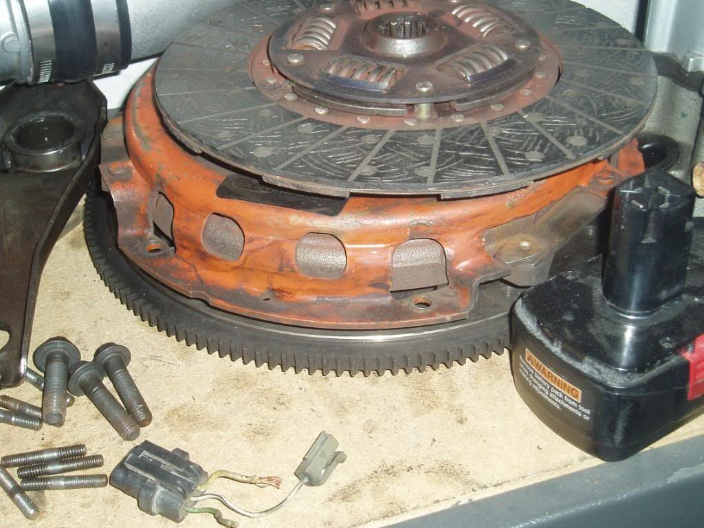

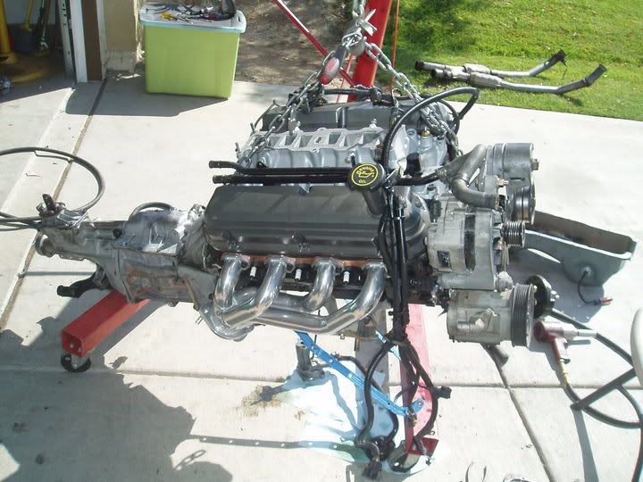

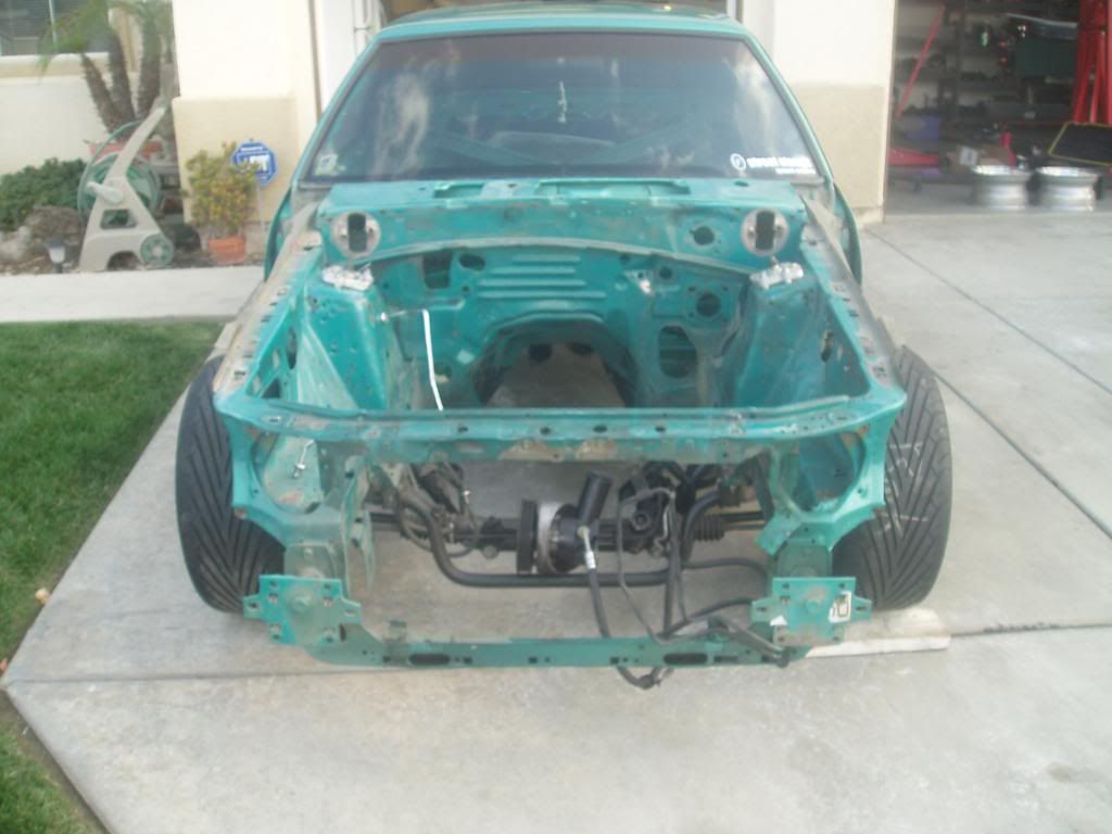

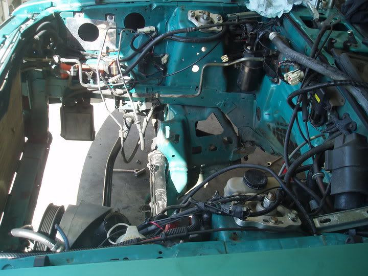

Poor car has just been collecting dust. I was going to order my engine bay paint and the rest of my engine gaskets this week, however came up on a killer deal for a TKO 600 tranny. I already have a 3550 for it but the T-5 in the '86 isnt long for the world with me driving it, so the 3550 is going in. The TKO 600 was a great price but still doesnt mean it was cheap, so it's eating up alot of the budget for the next 2 months of mods lol. But worth it in the end since I will virtually never have to buy another trans period.
Killer score on the TKO!!
