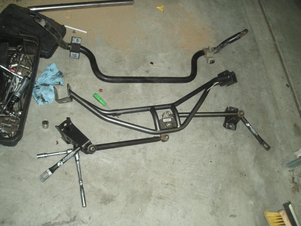

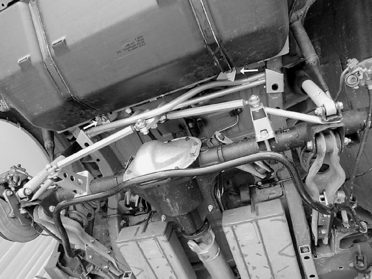

So I have had a little suspension part under wraps. It is a rear watts link setup. Basically does the same as a panhard bar. Looks pretty insense under the car. Also got a set of Hotchkis CC plates so now I can mount up the coilovers and k member. Lastly, GT front swaybar.

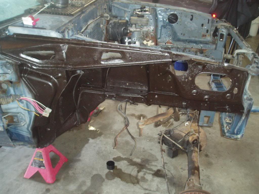

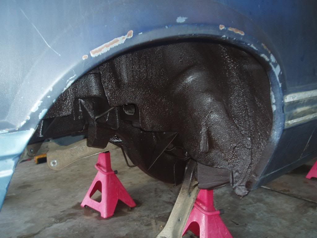

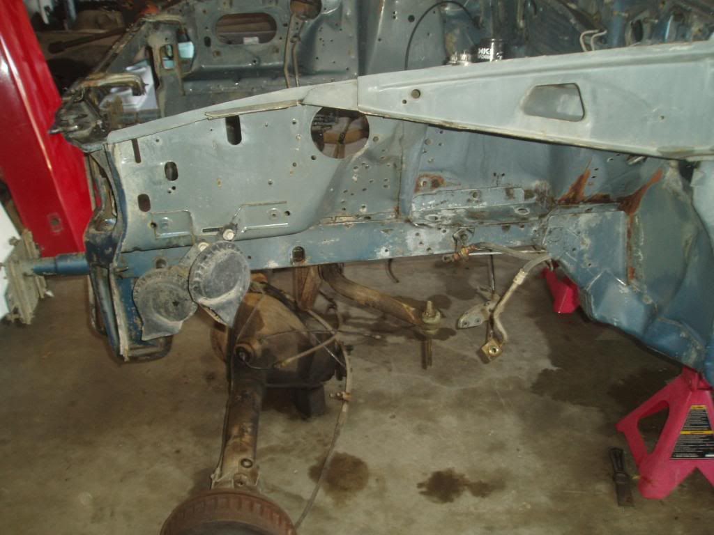

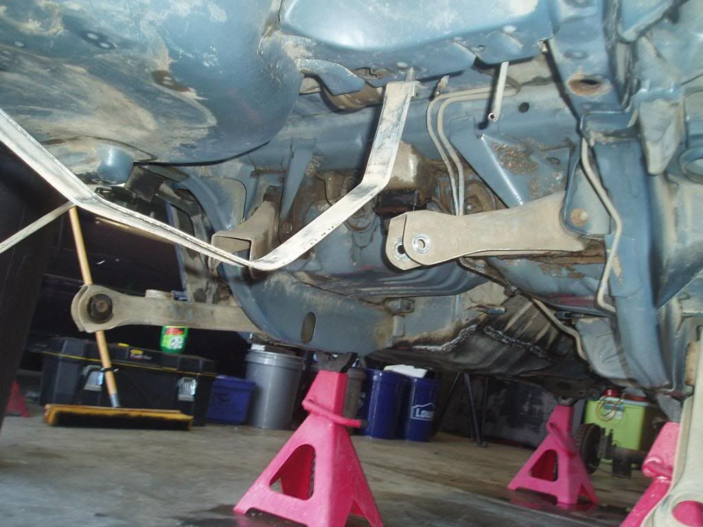

So finally have a weekend off and not doing repairs to the daily driver. Got some time to work on Tina today. Got the entire underside of her cleaned and degreased. Bought some undercoating and now coating everything getting rid of all the blue paint on the bottom side. Enjoy the pics:

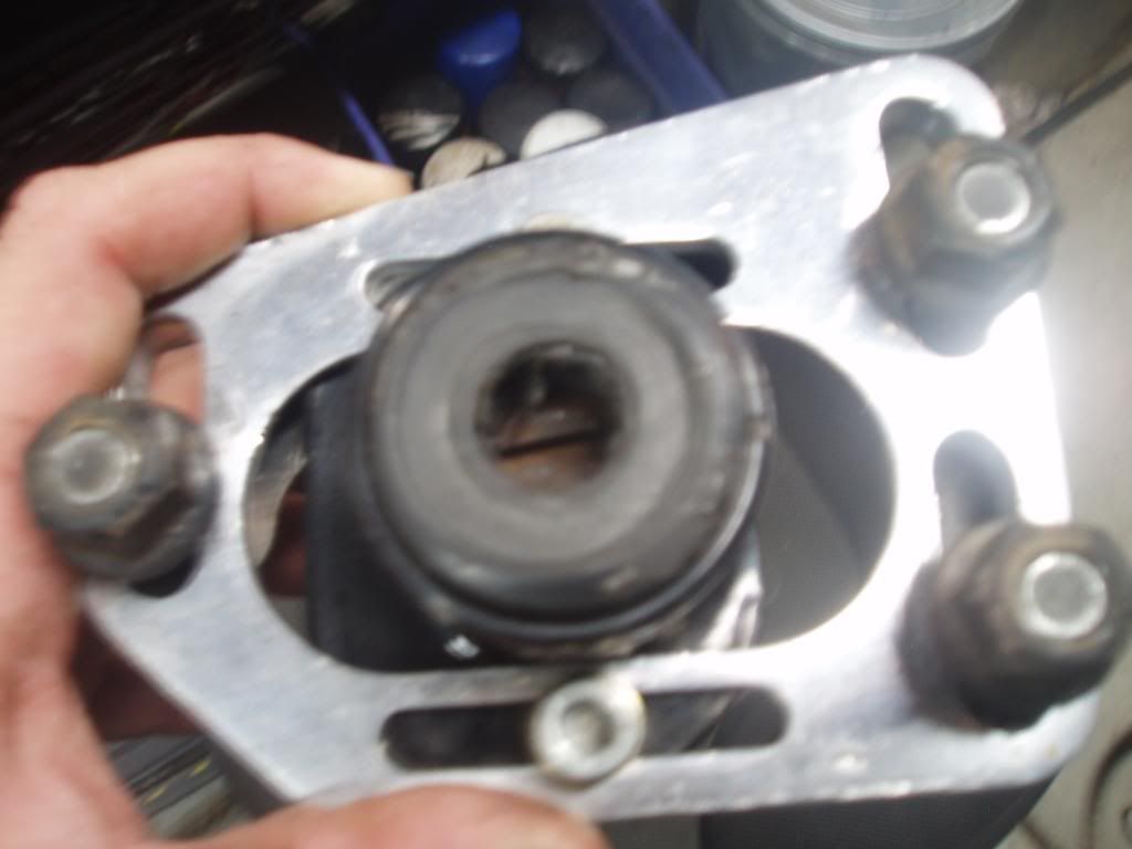

Come to find out with a 12 inch spring and KYB struts, they won't connect to any after market caster camber plate :mad: FML I just need this thing to roll, good thing I kept the stock strut mounts/plates. Rigged for now till I can get my Tokicos for her.
Looking good. Why is that? Is it because the springs are too short with the 12" coils, or do they just not bolt up to any of the A/M Plates?
KYB struts are short like stock struts I need a 10 inch spring or I know for a fact the Tokico blue struts will work. With the shorter strut, there isn't enough of the shank sticking out to be able to slide throught the C/C plate and attatch the nut
Interesting that there taller. I didn't know the 12" coil was too tall for the stock or KYB struts to go through the A/M plates. I was actually looking at the 12s for mine. It helps to know that. Thanks.
Me either until today hahaha. I have Strange 10 ways on Calypso. Same legnth as stock and those coilovers are 10 inch. But 100% sure the 12 inch springs work with Tokico blues since I used to own the 12 inch springs before. They used to be on my old GT hatch and were setup with Tokico blues.
Yeah I wouldn't have thought there would be a difference either, I have learned the hard way many times on swapping aftermaket parts in the (what works or not ) arena. as I'm sure most have. I was leaning on getting Bilsteins for mine with M/M susp. Thanks again for the tip.
Great thanks, I'll do some double checking before going ahead with the set up. Good to know you saved your stock plates and mounts so you can get your car rolling again.

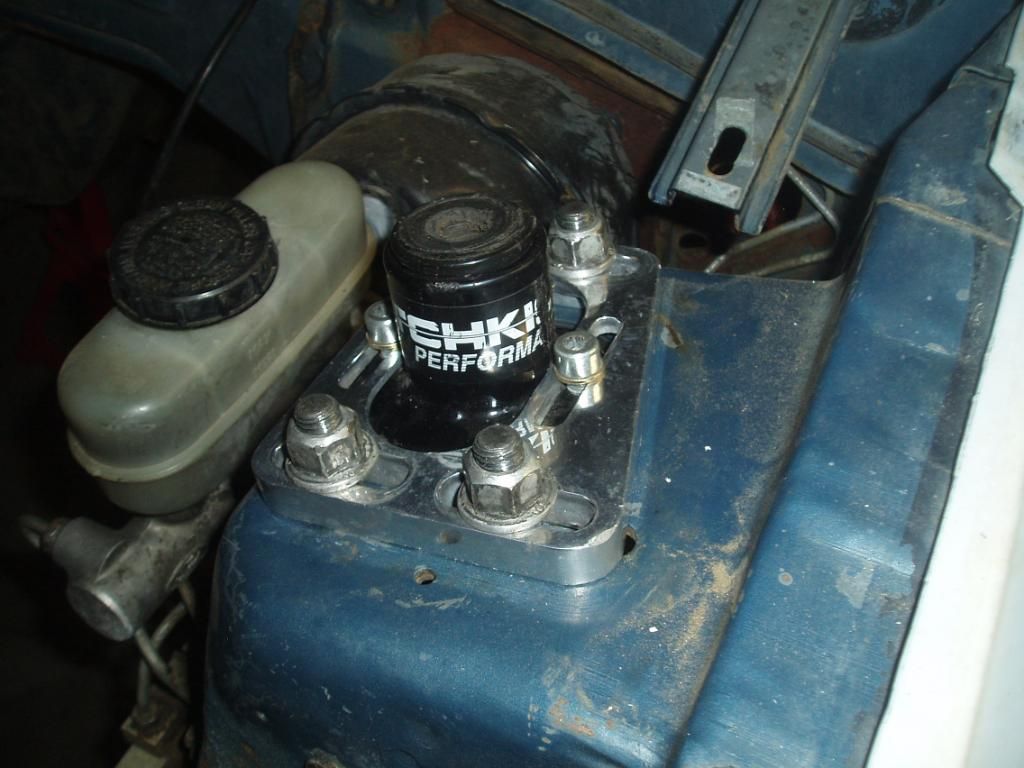

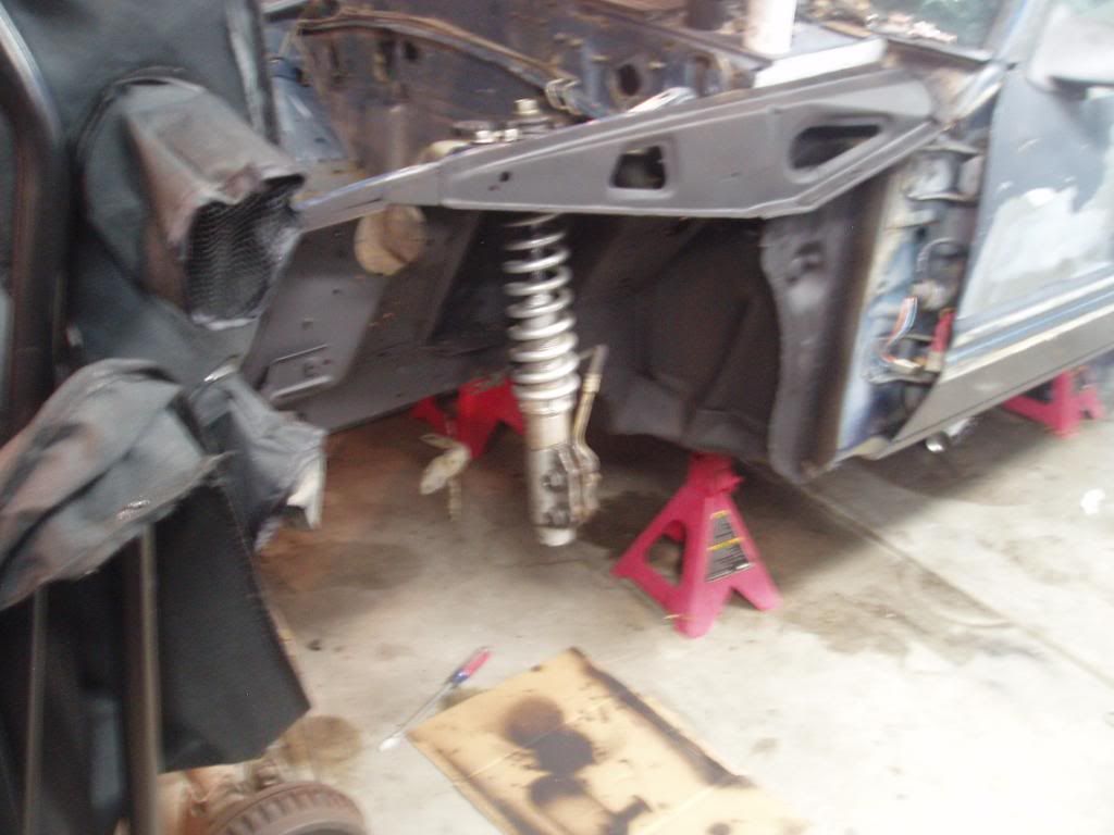

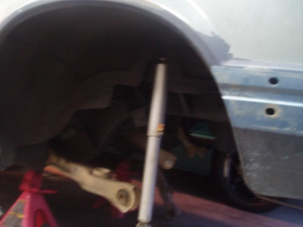

Front coilovers are temporarily in, rear shocks in, and lastly a pic showing my issue with the 12 inch coilover springs. With the coilovers in the lowest position I still cannot bolt the strut up to the Hotchkis plates. This will fit with some Tokico blue struts so once I can pickup a pair Ill be golden
