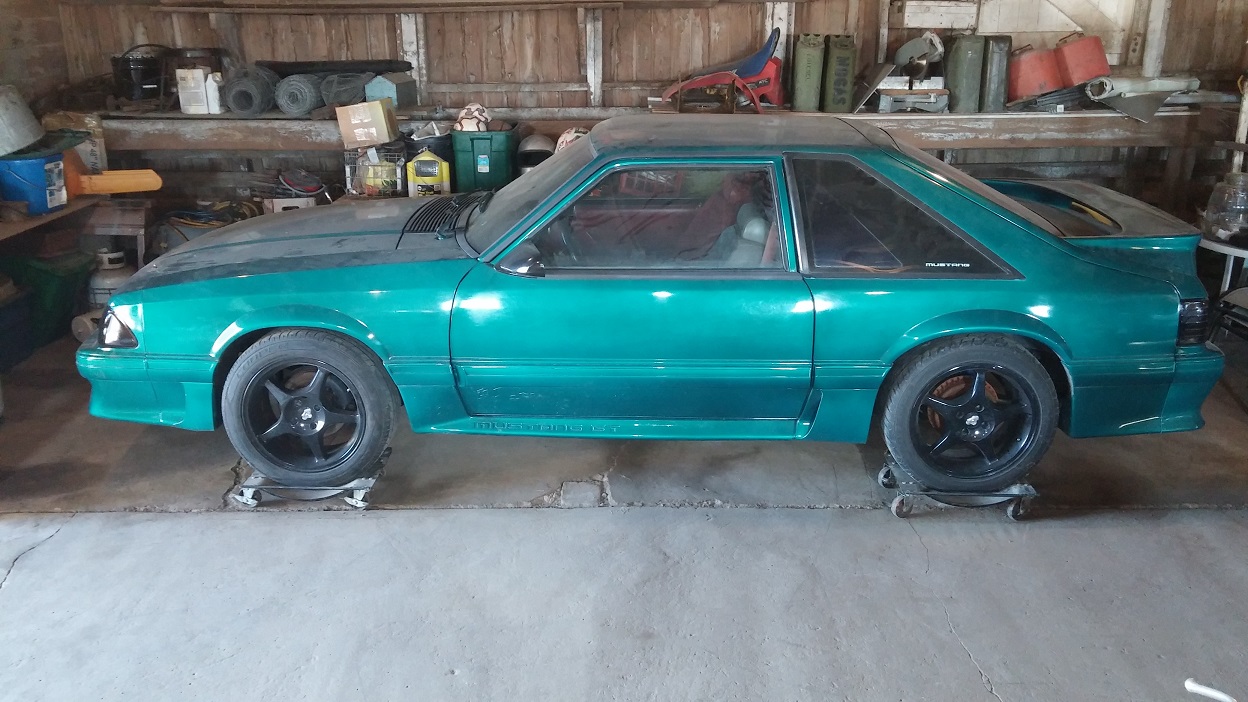

I joined the forum yesterday and per a suggestion, I'm starting a thread regarding my restoration. Eventually I'll post the story how 20 years passed between the first time I bought the car and the second time, pretty cool how I tracked the car down.
Anyways, the previous 18 or so owners (based on Auto Check) did a number on the car and now it's time for a full-blown restoration. As I've always said, if you don't know how to work on a car the right way then don't do it, just causes more headaches for those that need to "undo" your "fixes".
The original motor, trans, turbine wheels, drivers seat, and steering wheel are gone and the car has been painted teal...with red interior! I'll be restoring the car back to red exterior and red interior, starting with interior disassembly today. I expect this to be a lengthy process, especially considering I'm already committed to restoring another car (my fathers old car).

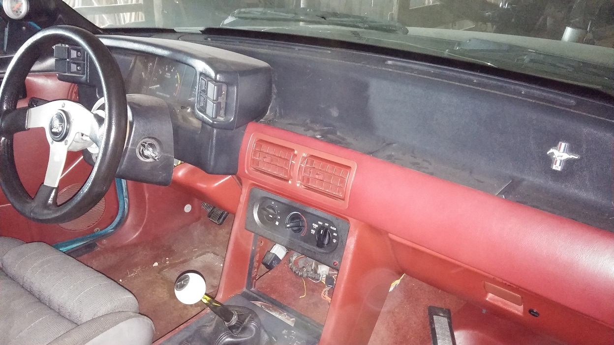

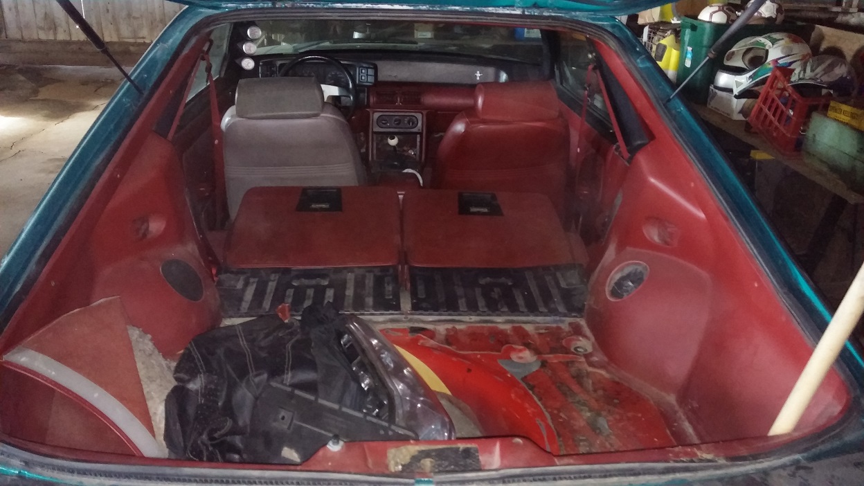

Here are a few pics today:

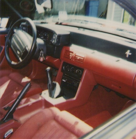

And from 20 years ago:

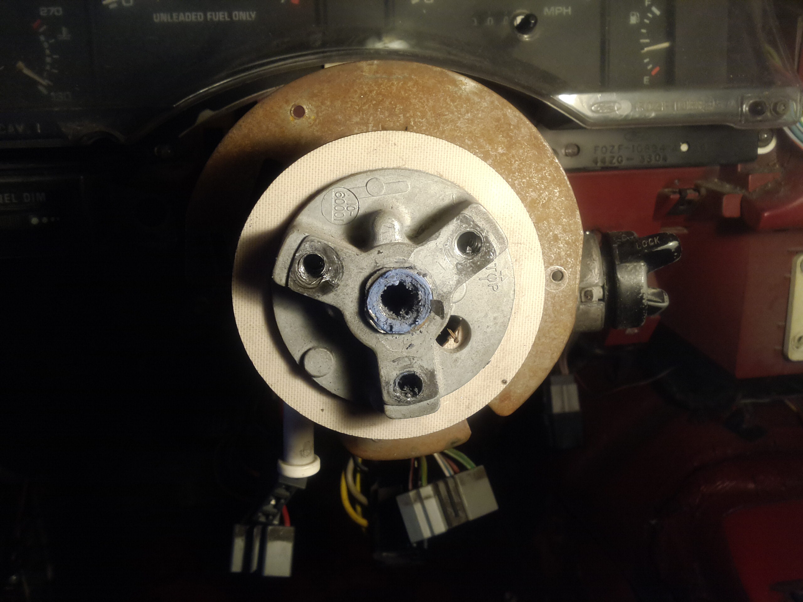

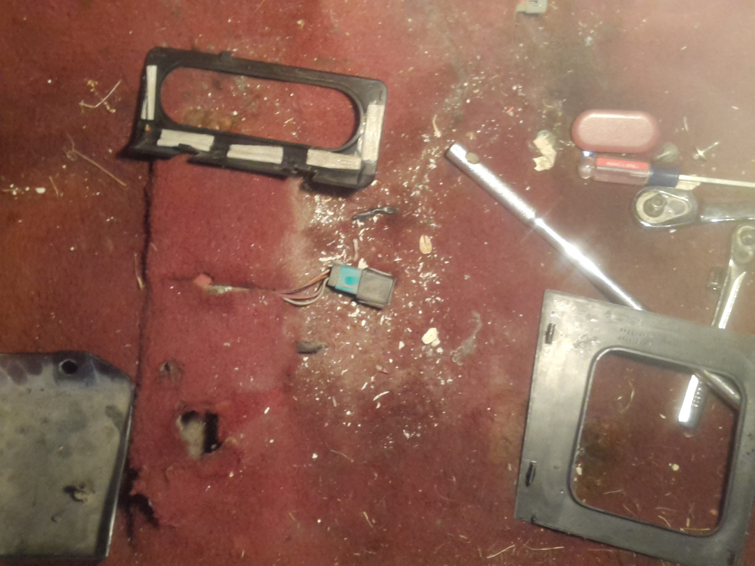

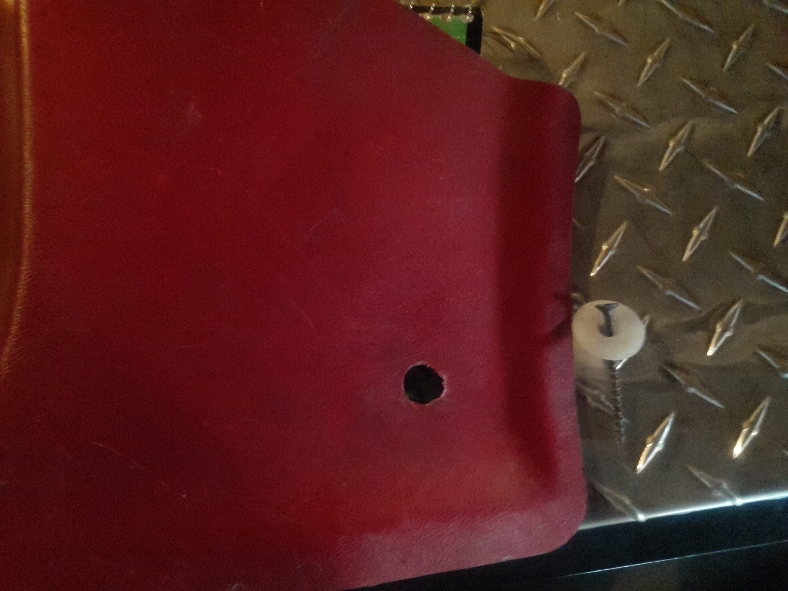

I spent a good part of the day removing the interior. The carpet and padding were damp and looks like I'll need new floor pans. I can't believe how many hack jobs were done to the car. Multiple wires have been cut, melted connectors, burnt carpet from burning wires, etc. Here are a few pictures.
Burnt carpet:
Blue RTV/gasket maker used for steering wheel mount, wrong size bolt used:
Drywall screw used to fasten the driver side kick panel:
Floor pan driver side, too many holes and rust:
They decided to cutoff the wiring to the seats, trim panels using duct tape:
Interior finally gone:
