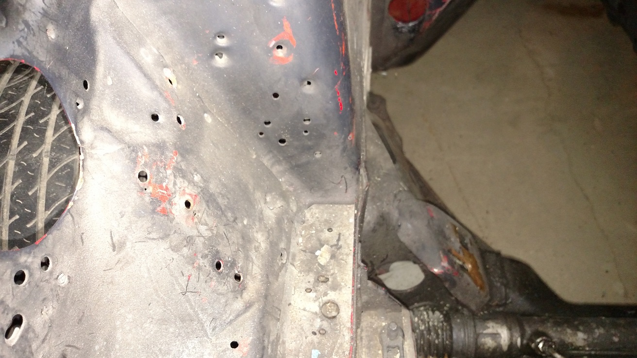

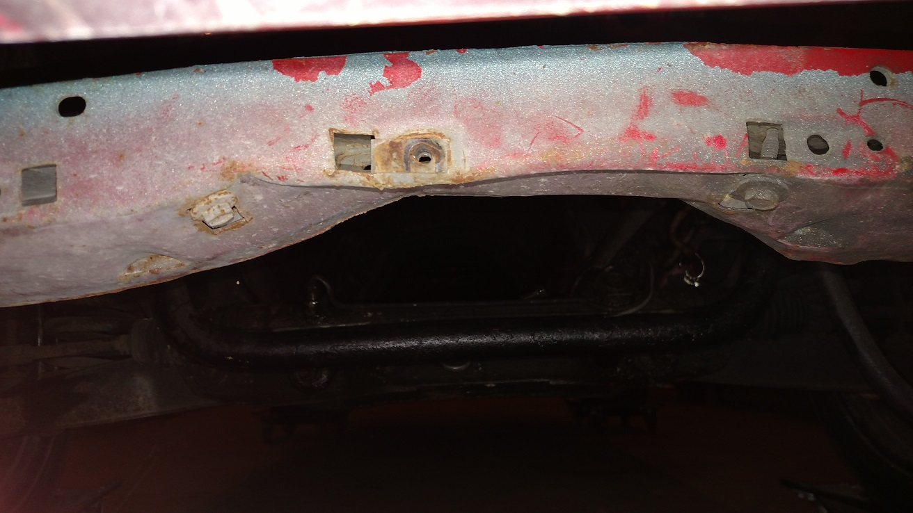

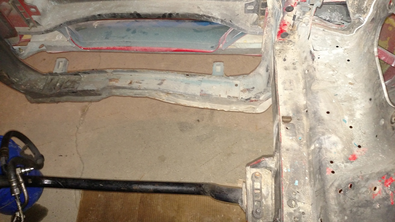

Been about 6 months since I have had time to work on the Mustang. I finally had some time over the past few weeks and finished stripping the car down to a roller. I'm certain the car will require some frame straightening based on measurements I took in the engine compartment and under the car. The radiator core support is bent up and to the front making me think the previous owner either jacked the car up there or it was pulled possibly by a tow truck or something. The upper frame rail along the passenger side strut tower inner apron has a bulge which I believe indicates a collision occurred at some point. I'm planning on getting the frame straightened, new radiator support, new floor pan, subframe connectors, and torque box reinforcements before working on bodywork and paint.
