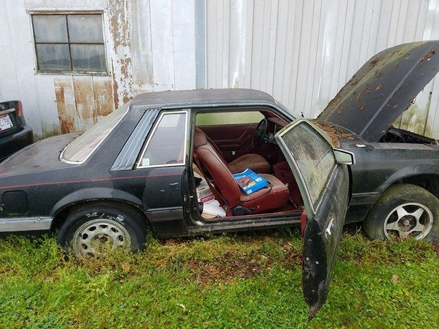

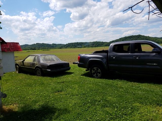

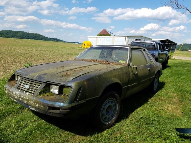

    We'll, I've done it again. I felt motivated to try and save this old coupe. My brother-in-law had it. It has been parked outside for many years. The lower radiator support is rusted, as are both doors and one spot in a lower quarter panel... just in front of the rear driver's side wheel. It's originally a 4 cyl, but has no motor or transmission. The interior is still full of ants, stray cat excrement, trash, and old spare parts. Most of the interior (red) is still there. From what I could see, the floor pans and shock towers are ok.
    First, I had to hook up a tow strap and pull it out of the mud.

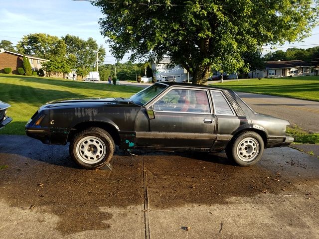

    Next, I put some new shoes on her. I had some 10-hole wheels lying around. I got a couple decent tires off a buddy and 2 new ones from the tire shop. The old tires were absolutely done.
    [​IMG]
    [​IMG]
    [​IMG]
    [​IMG]

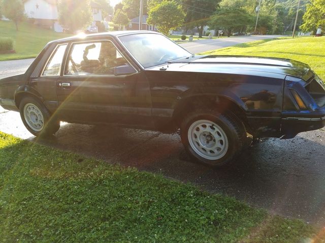

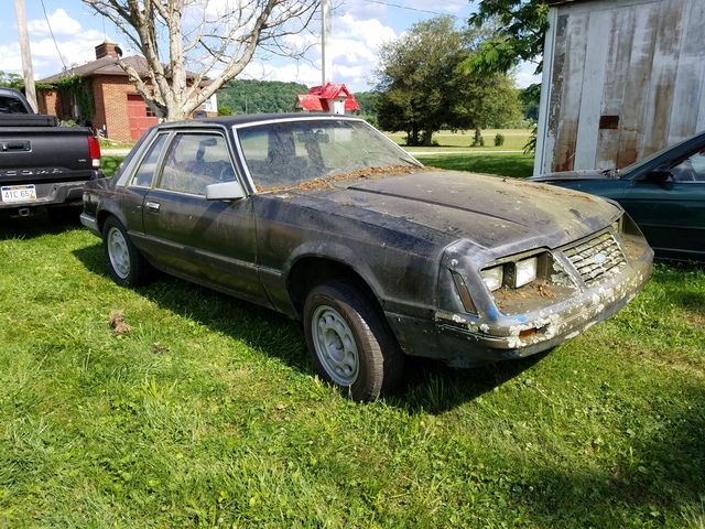

    Got it home later that day. Took the pressure washer to it to remove the years of crud.
    [​IMG]
    [​IMG]
    And that's where I am at this point. I'm back to work for 28 days. I'm hell-bent on getting the pace car on the road when I get home as well as getting the 88 hood painted and 5-lug swap done. However, I'm going to at least tackle stripping the seats and carpet out of this thing so I can get a better look.

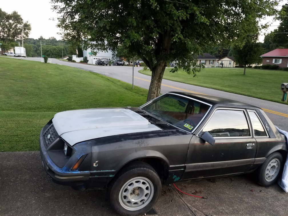

    I managed to score a few parts to get this thing looking like a car again. A set of doors, hood, and front nose/ bumper cover. The hood, although not rusted, is a little beat up. I was really wanting to go with an 82gt-style hood with with the scoop. A buddy decided to sell some of his parts, which included an 82gt hood with scoop and matching bumper cover, complete with lower air dam. I haven't decided whether or not I'll use the nose piece, but I'm definitely going with the hood. The price was just too good to pass up. Plus, you never know when I might need some of this stuff for my 82gt (if I ever get around to starting on it lol).
    mustanggarage likes this.

    Thanks, photobucket, for ruining the internet. Sorry about the pics. I'll eventually post some more. But I thought I would update this with a few minor touches. The car did not come with a set of keys. I ordered a complete nos lock cylinder kit. I drilled out the ignition cylinder and replaced it. Also, I managed to get the trunk open and remove the lock cylinder. I had a locksmith rekey the new trunk lock cylinder to match the new door cylinders. I just have to install them.
    Another thing I did was take the driver's rear brake shoes off. The wheel was completely locked up. I can now roll it and steer it. This is important because I spoke to a neighbor buddy who's going to replace the floor pans and lower core support for me. I've been working way too much lately, so I decided I would farm out some work to keep things moving along.

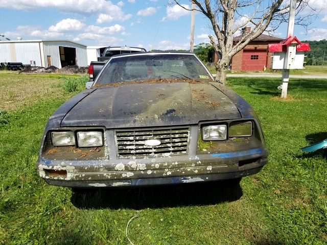

    Is the thread title a typo? Or has the front bumper been previously changed? The pics show an '83-'84 front bumper cover. Not an '85-'86 cover.
  7. broncojunkie
    broncojunkie Active Member
    700
    200
    43
    Good eye! Yes, the front bumper has been changed. Currently, a buddy/neighbor just down the road from me is working on replacing the floor pans. I have a motor in the machine shop now. They did all the machine work and assembled the short block. I have most everything to assemble it (intake, headers, timing cover, etc. I need a gasket set, oil pump, oil pan and heads (that last one is a big one, of course). I hope to start updating this thread more this summer. The motor is a 351w stroked to 408 with forged rotating assembly. Still planning on using a 4 speed toploader transmission. Should be a fun car when it's finished, but it's a slow process with a couple other projects going on.

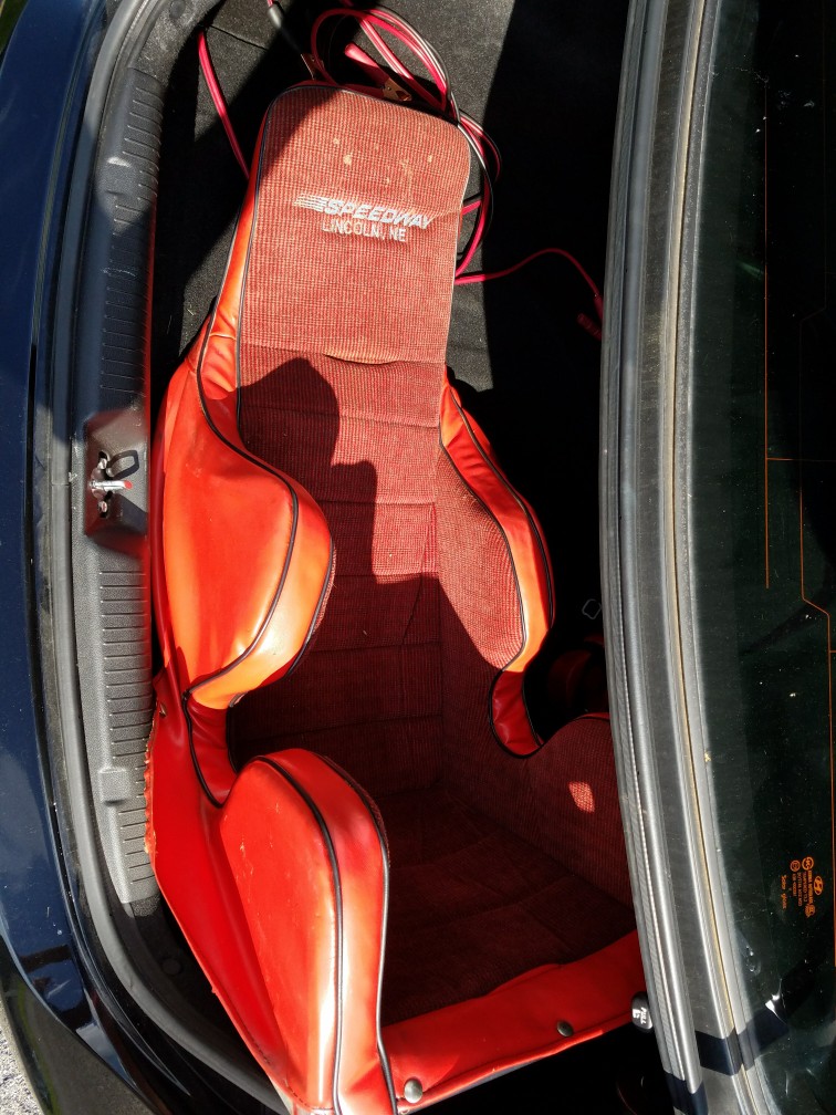

    20180609_170705-756x1008.jpg Here's the aluminum seat I picked up. Nothing special but it's in good shape and should work fine for what I need.

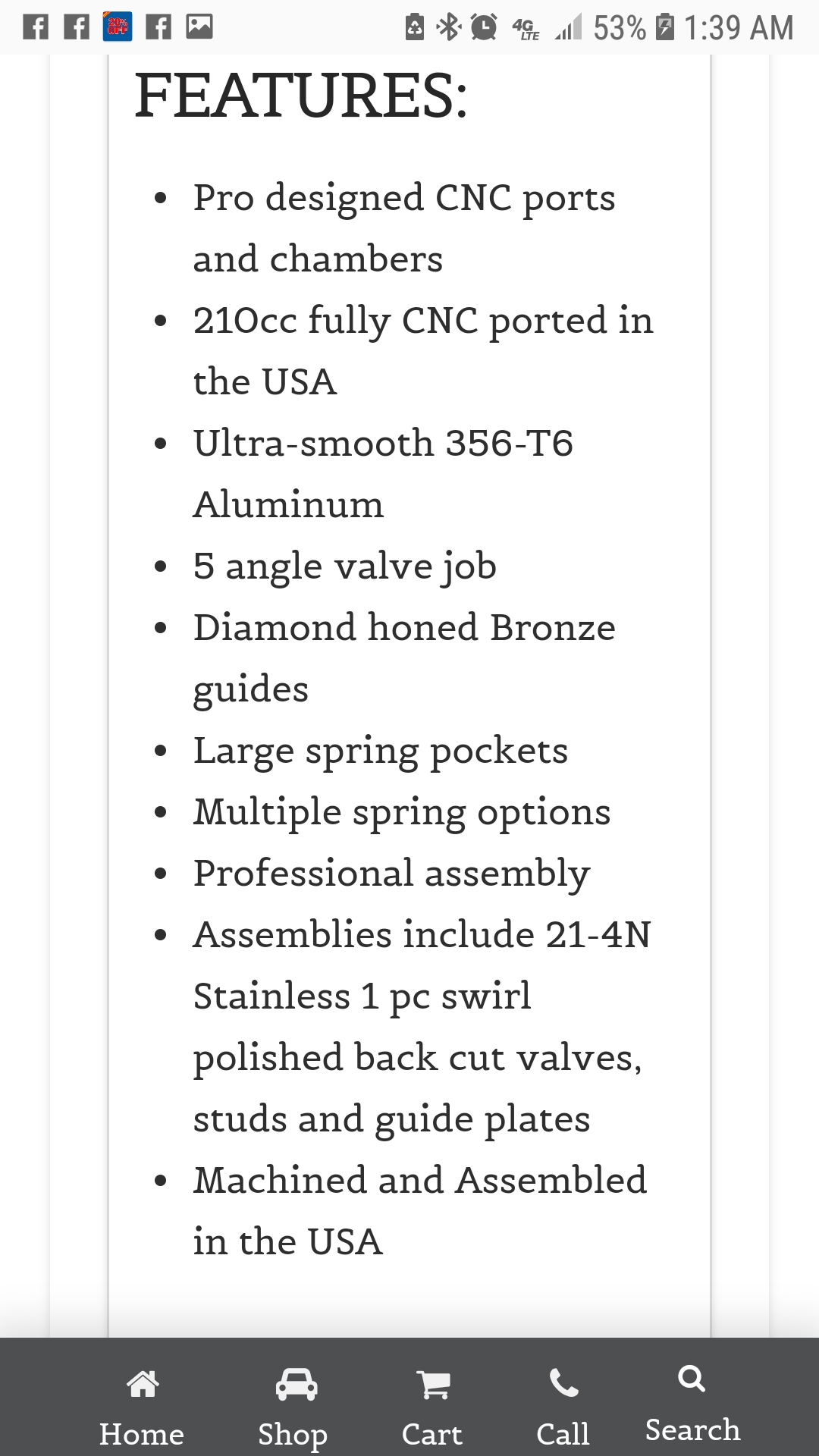

    I bit the bullet and got a bunch of parts to finish up the motor. Heads (Promaxx 60cc 210 intake runners...more on these later), oil pan/pick-up, oil pump, gaskets, water pump. Everything is sitting at the house waiting on me to get back in town and start wrenching.
    More on these heads:
    I did a lot of research here. I planned on going with AFR 205 58cc. I just couldn't justify spending that kind of money ($2100). I was also looking at similar Edelbrock heads...Vic Jr 210, iirc. The price was better at around $1600, but the flow numbers were noticeably worse than the AFR's. I've been looking at these promaxx heads for a while and really wanted to take a chance with them. Although I'm presuming a Chinese casting, Promaxx is located in Alabama and has a great customer service reputation. I believe they are assembled here in the US. Flow numbers appear to be similar to the AFR and same price as the Edelbrock. These are the CNC version (Shocker Series) and are supposed to be nicer than the cheaper "as cast" heads. Promaxx is, I believe, formerly "Patriot". My research on the Patriot heads show some good reviews and it looks like Promaxx is following the same route, with more good reviews concerning performance and quality control.
    Not trying to sell you guys on off-brand heads... just explaining my reasoning here. I feel they're actually a pretty good company. You can check them out on FB, if you're interested.
