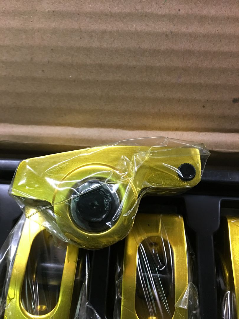

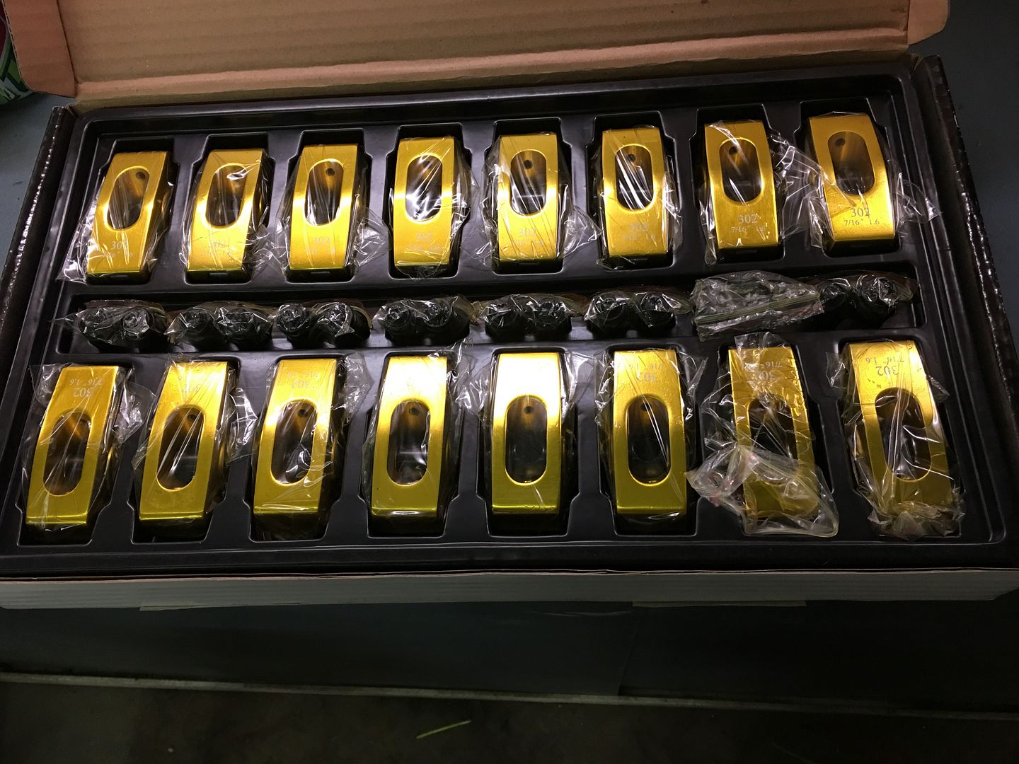

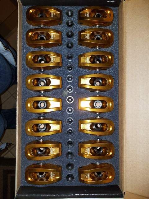

If I could post pics, I would. But Photobucket is still acting up and I only have access to my phone from work. I received my new hood...2" steel cowl. I also found 24# injectors and matching maf, which is also sitting at the house. I sucked it up and ordered some Comp roller rockers, 1.7's for 3/8 stud. I've been putting it off hoping to find some cheaper ones or maybe a good used set, but no luck. I called Jegs and ended up getting them for $350. Still expensive, but about $50 cheaper than Summit. I may sell some spare parts just to offset the cost lol! These cars have a way of $3-500ing you to death!
