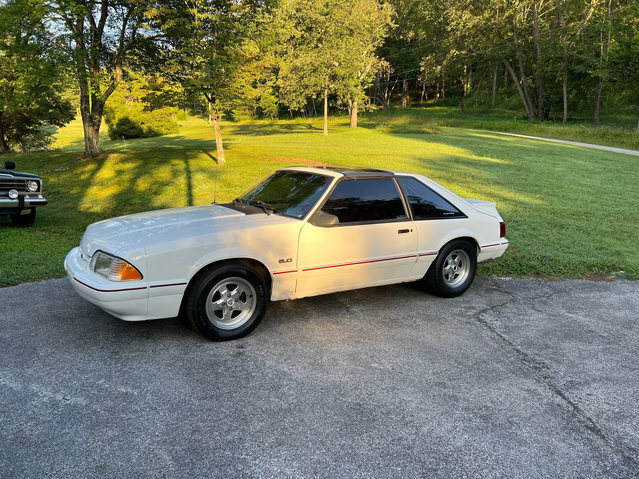

Well, it seems I have been collecting enough parts I thought I should detail my plans and my build.
Last year, I purchased a 1987 LX that had been converted to a 5.0 5-speed. It's a T-Top car with a good body, good paint, and a crap interior.
I have a room full of parts I've been buying, everything from a Cobra IRS to better brakes, etc.
In fact, here is my list of planned modifications...

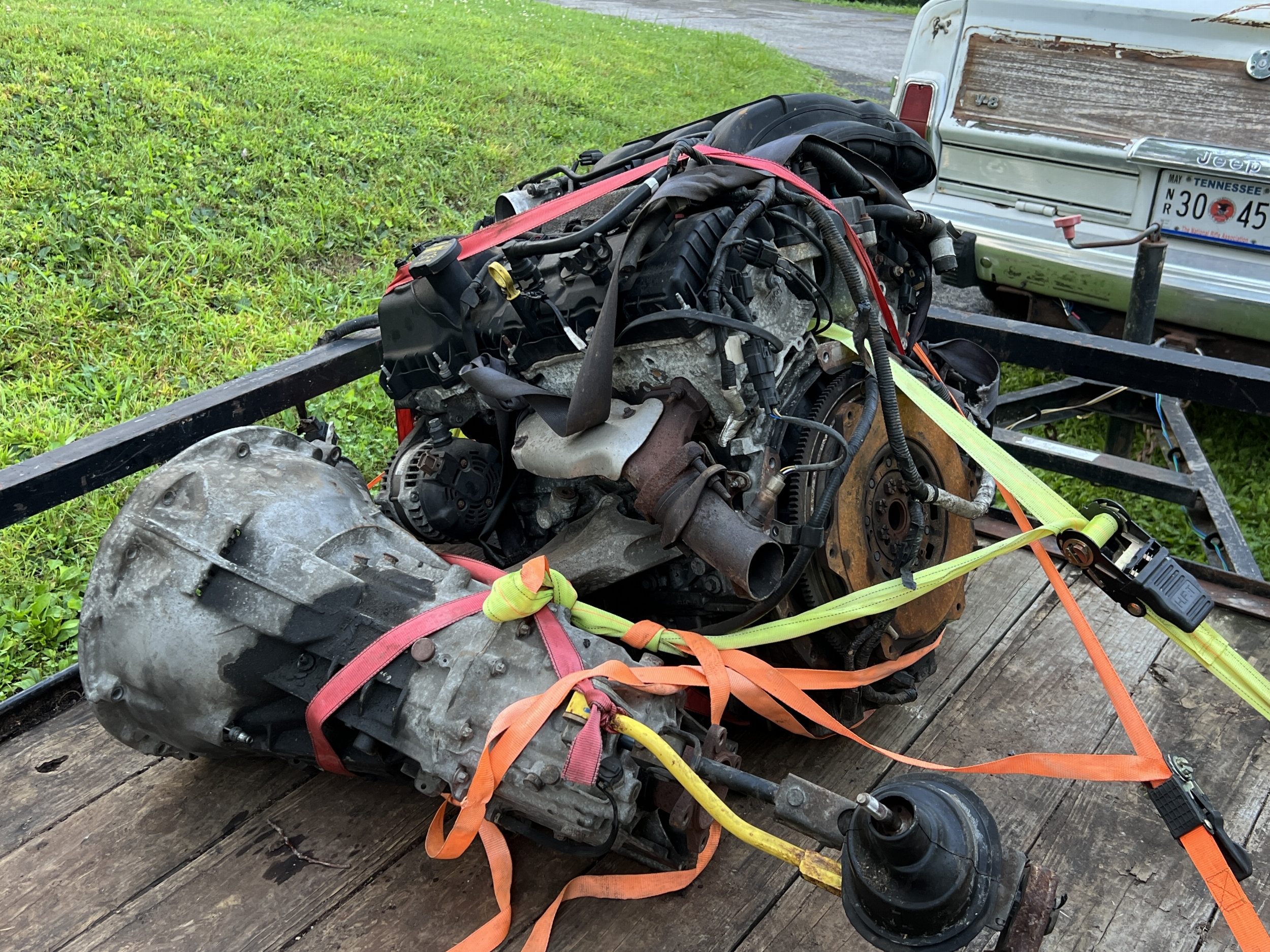

  1. 2011-2017 3.7 V6
  2. Jenvey ITBs
  3. 6-speed

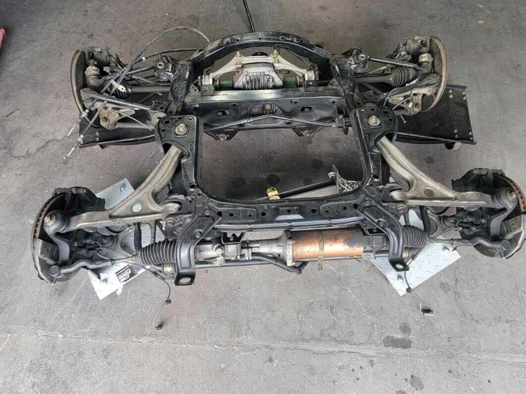

Yesterday we picked up a 2005 Mazda RX8. It has a toasted engine, but I want the suspension.
Both the front and rear (IRS) are mounted on fairly low profile subframes, and the width approximates that of the Foxbody Mustang. With a bit of cutting, welding, and other fun stuff, I'm 99% certain I can use them under the Mustang project.
The front is a SLA set up while the IRS is a multi-link type. The same suspension was used under the RX8 and the NC series Miata, and the RX8 weighs around the same as the Foxbody Mustang (in fact, my mustang might weigh less once the all-aluminum V6 is installed).
Should make a Mustang with a good ride that also handles like it's on rails.
Example of the RX8 suspension and subframes.
