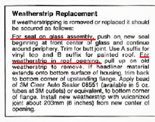

Sunroof weatherstrip doesn't fit tight all the way around the glass. There are spots where it doesn't fit snug. I've watched the video online by LMR and the demonstration show the glass weatherstrip fitting snug all the way around. The demonstrator didn't seem to have any problem with the fit. Is it possible that the lip, which the molding sides over, has become distorted.
Would a solution be to use some kind of sealant to hold the molding in place? Or does the lip need to be straightened?

This is from the Mustang Shop Manual
