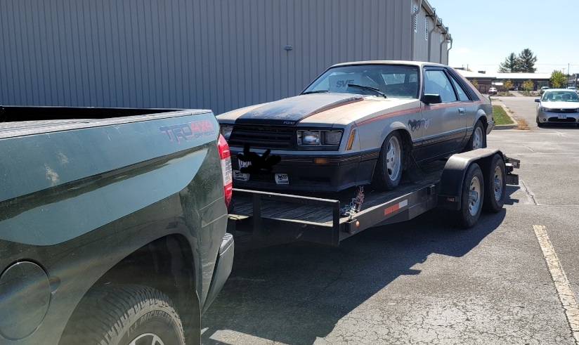

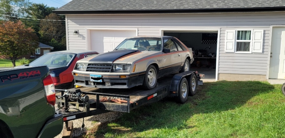

After trying to pull teeth for a couple months, I gave up on transport companies. It's a 14 hr drive for me and had been very busy with some family matters and work. I coaxed a buddy from work into going up north with me. Here's a pic from the trip home.
The car is pretty much stock, other than the engine and transmission. Originally a 2.3 turbo car, it has already been swapped to 302. It had no brakes, steering was not hooked up, and hadn't been running in several yrs, according to the seller. The front coil springs were missing, which made it a joy to get on the trailer lol! The trip home was a mess. 2.5 hrs worth of Chicago rush hour traffic while pulling a trailer in the rain. In fact, it rained most of the way back. Return trip took over 16 hrs. We got us a room in MN, otherwise, I don't think we could have driven straight back.
The last pic of it on the trailer was taken before I installed the new front springs, a new driver's side tie rod end (mia), and connected the steering shaft to the rack. I decided it would be easier to do that before trying to take off the trailer. While working on the front end, I noticed several new parts, including control arms, ball joints, spindles, hardware, rotors, motor mounts, and even a new factory k-member. I don't know where one would purchase a new oem k-member. Is that a thing? The car came with a new set of 4 Eibach Sportline lowering springs, spring isolators, new brake lines, some new (off brand?) Upper and lower rear control arms, offroad x-pipe, and a few other parts.

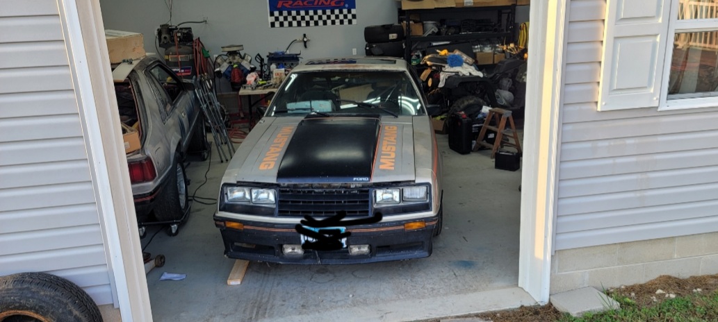

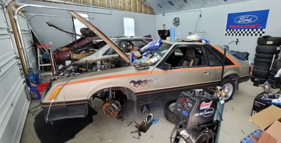

Finally off the trailer and sitting in the garage with the rest of the clunkers. I'm hoping to make this one a running, driving project car. I have enough junk sitting around the shop inoperable, so this will be a welcomed change.

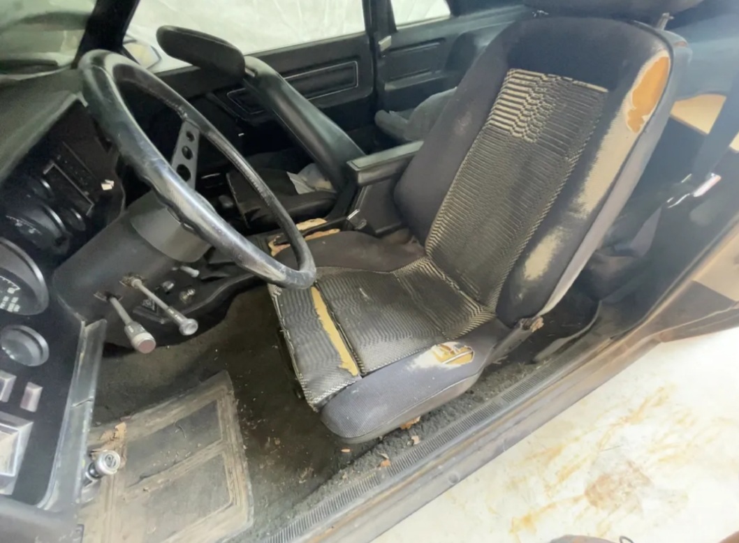

This car is definitely going to need some work. The seats, in normal fox Recaro fashion, are trashed. I'll be biting the bullet and redoing them. The upholstery and foam set for these have gone through the roof. I believe prices are around $600 more than the last ones I did. Materials alone are $2500(ish). I'll save that for last.

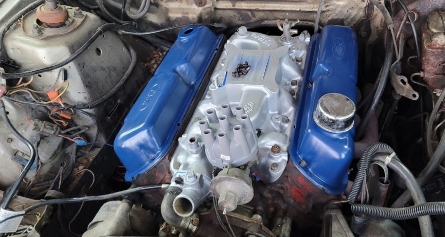

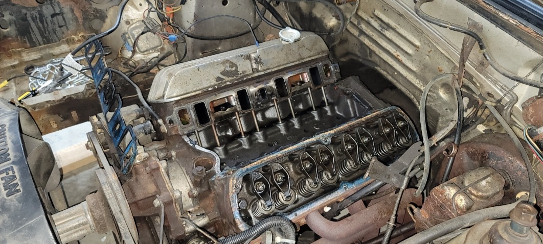

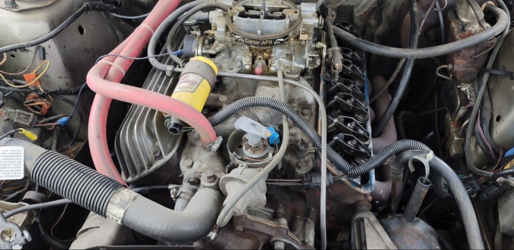

Once in the garage, I had a chance to start messing around under the hood. I pulled off the intake to see what I was working with. Casting date is C9 (1969) and the accessories look the part. Old style power steering pump (not hooked up), v-belts, mechanical fuel pump. Alternator is old, but I'm guessing from a late 70's? I'm not 100% on that. That stuff will be coming out. I ordered some serpentine pulleys and 3g alternator. The C9 casting was a pleasant surprise, though. Better heads than what would have come in 1979 and higher-compression. I have a couple other c9 and D0 casting heads that I can swap over later. They've had hardened exhaust seats installed, extensive port work, screw-in rocker studs, and all that junk. For now, she should be a good runner. I'm not crazy about the flat tappet cam, but I can fix that later.
I did some cleaning up. Painted the intake and put some different valve covers on it that I painted a couple yrs ago. The engine had a really nice old Carter AFB carb on it. I didn't feel much like doing a rebuild, so I slapped on a new carb i had for the other pace car. I had to drill out, weld, and re-tap a valve cover bolt that had broken off. I also fixed some wiring issues, replaced the clutch cable (it had the 4 cyl cable which was too short and had melted on the headers), rigged up my throttle cable (new one on order) and several other small things I'm forgetting. She fired right up. I haven't tuned the carburetor or even touched the timing yet. I just wanted to get it running.

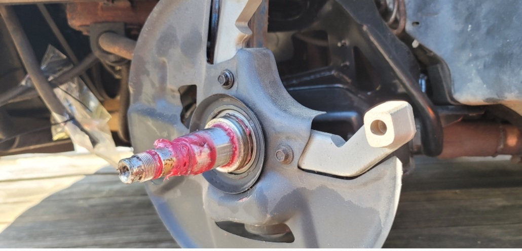

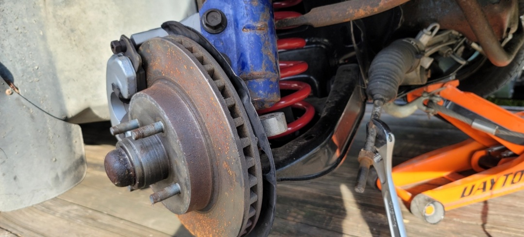

Next, I moved onto the front brakes. It was missing a driver's side caliper and both front hoses had been cut. The threaded ends were completely frozen to the hard lines. The hard lines looked pretty rough, so I used some of the new brake lines that came with the car. They were not meant for the 79, since the 79-80 cars were a beast of their own. I was able to tweak one side to work. The driver's side, I just ended up making a new one. I had some new hoses lying around. The front brakes (spindles and rotors) were for, I believe, an 87-93 v8 car, which came with 11" brakes. At least, that's what I'm assuming. I purchased new calipers and hoses for that model and everything seemed to fit. This spindle/brake swap is common on the older foxes, but the early cars had a couple different setups. Either way, I think I'm in business. I had a new master cylinder lying around already (early stye). I'm leaving the original booster in, too. I know these aren't a good match for the upgraded brakes, but they'll work for now.

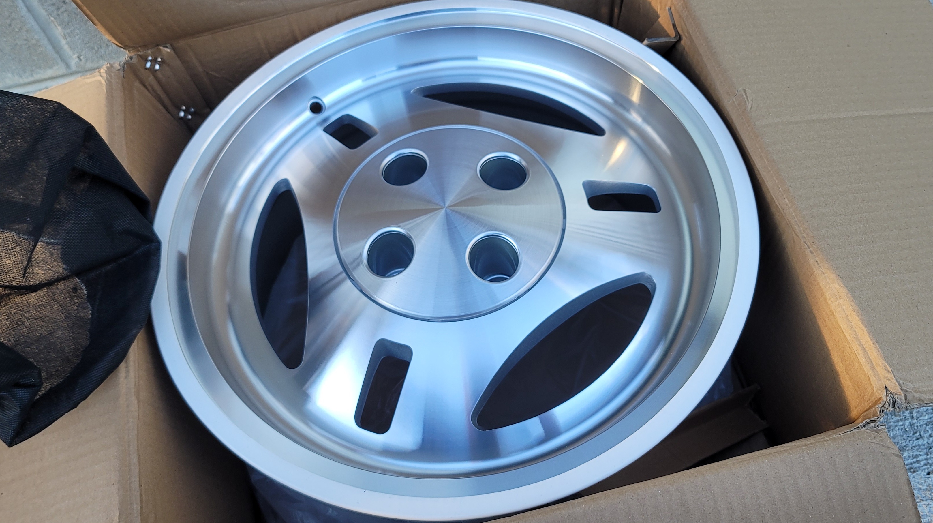

Here's another thing I scored in the deal. The car came with its original metric TRX wheels, but tires are old and dry rotted. Last I checked, new metric tires to fit them cost around $650 each through Coker. The new wheels are aftermarket and in a standard 16" size. The old ones will go to the scrap bin. I don't know how many of the original TRX's have been scrapped over the years, but I know for a fact I've probably sent 20 of them to rest. Good job, Ford. I hope you learned your lesson lol!

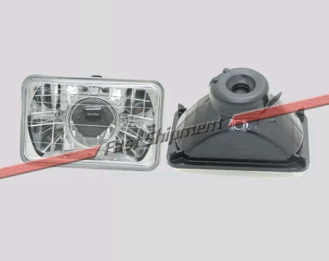

I have some headlight housings on order too. A great alternative to the old sealed beam 4x6 headlights, you can use these housings with H4 lamps. With good led's the difference is unreal.

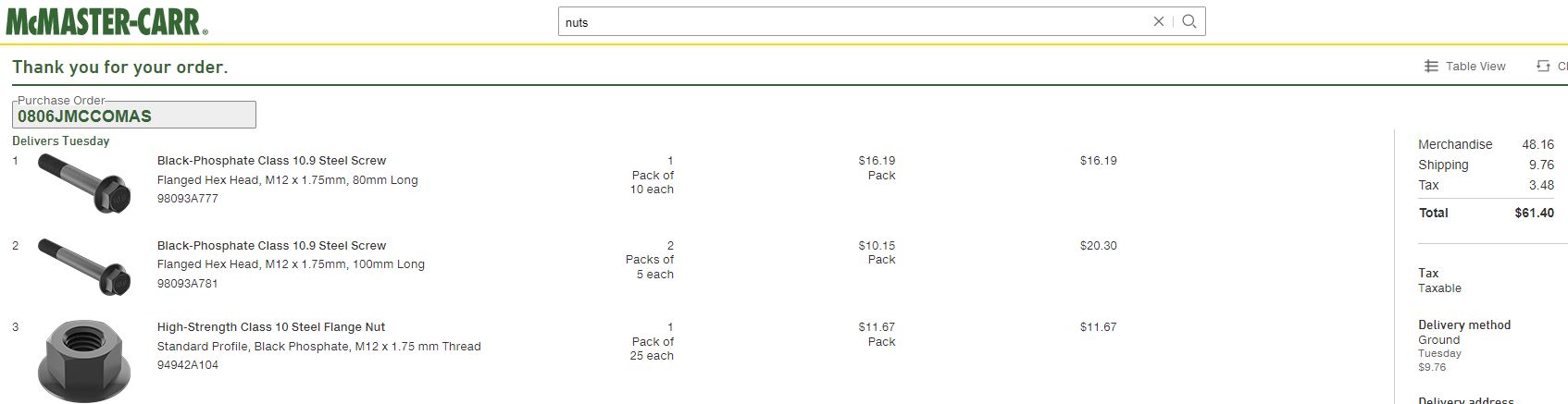

I haven't updated this in a while! Still working on the car. I've been in the middle of some motorcycle projects, but I've made some progress on the car. I ended up rebuilding one of the 8.8 rears I had. I got the undercarriage cleaned up from the torque boxes back. The control arms were an absolute pain to remove, but a buddy helped me with them. I put new rubber upper control arm bushings in and I scored a nice set of factory lowers from another buddy. I had trouble finding new bolts for the control arms, but it turns out McMaster-Carr had what I need. I bought some extras for the other cars I have sitting around.
