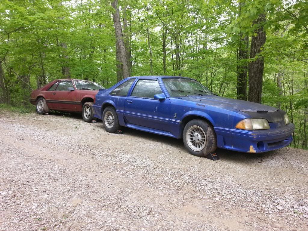

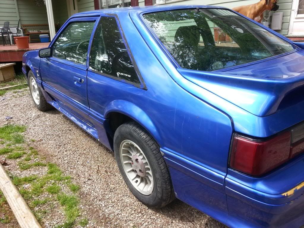

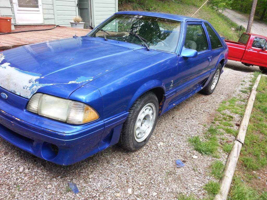

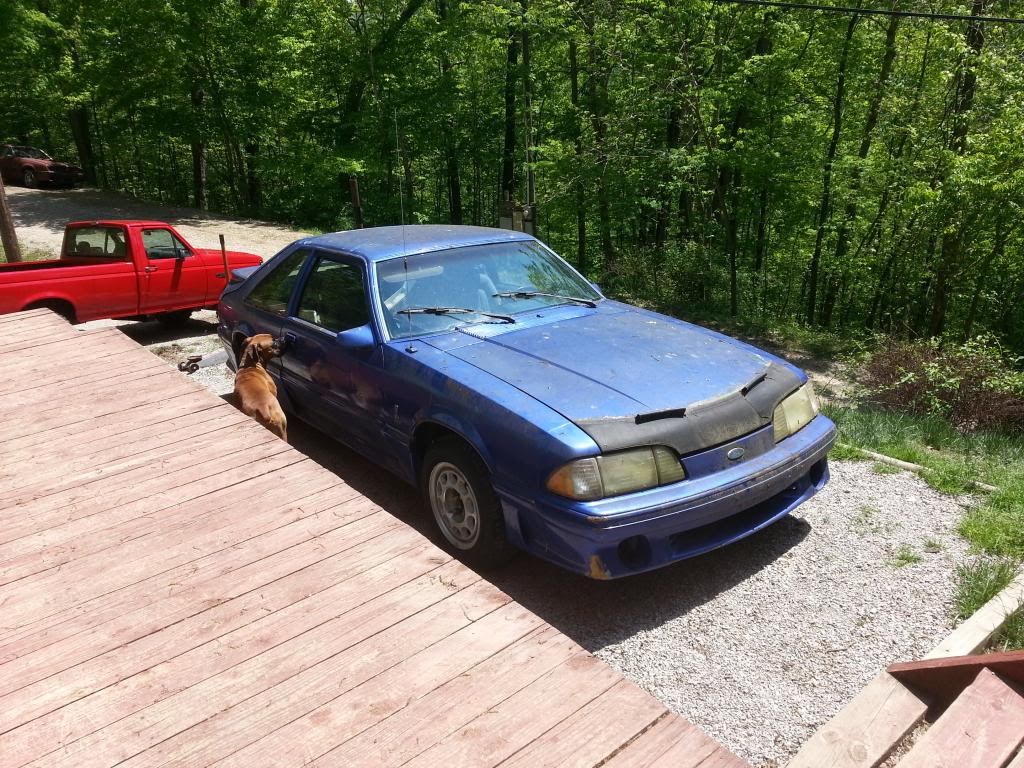

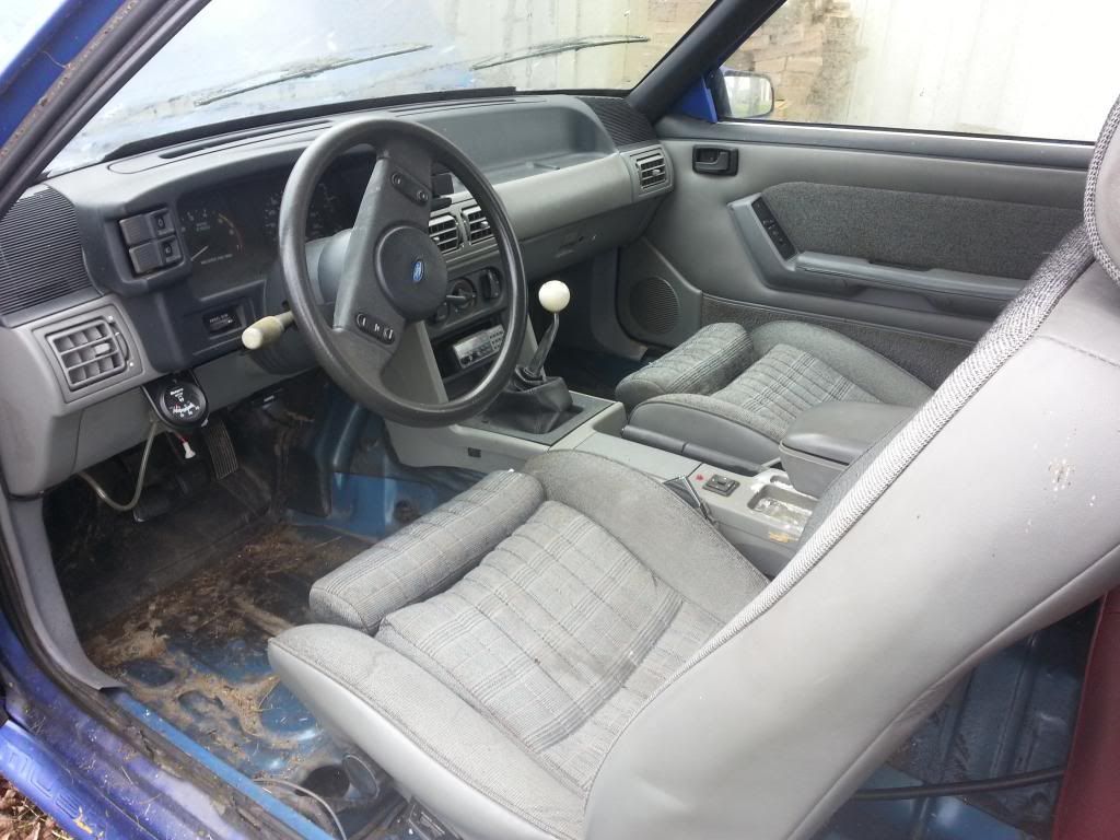

This is what she looked like the day I bought it.

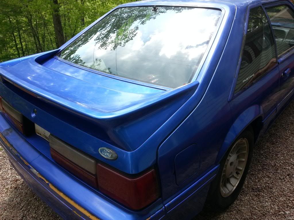

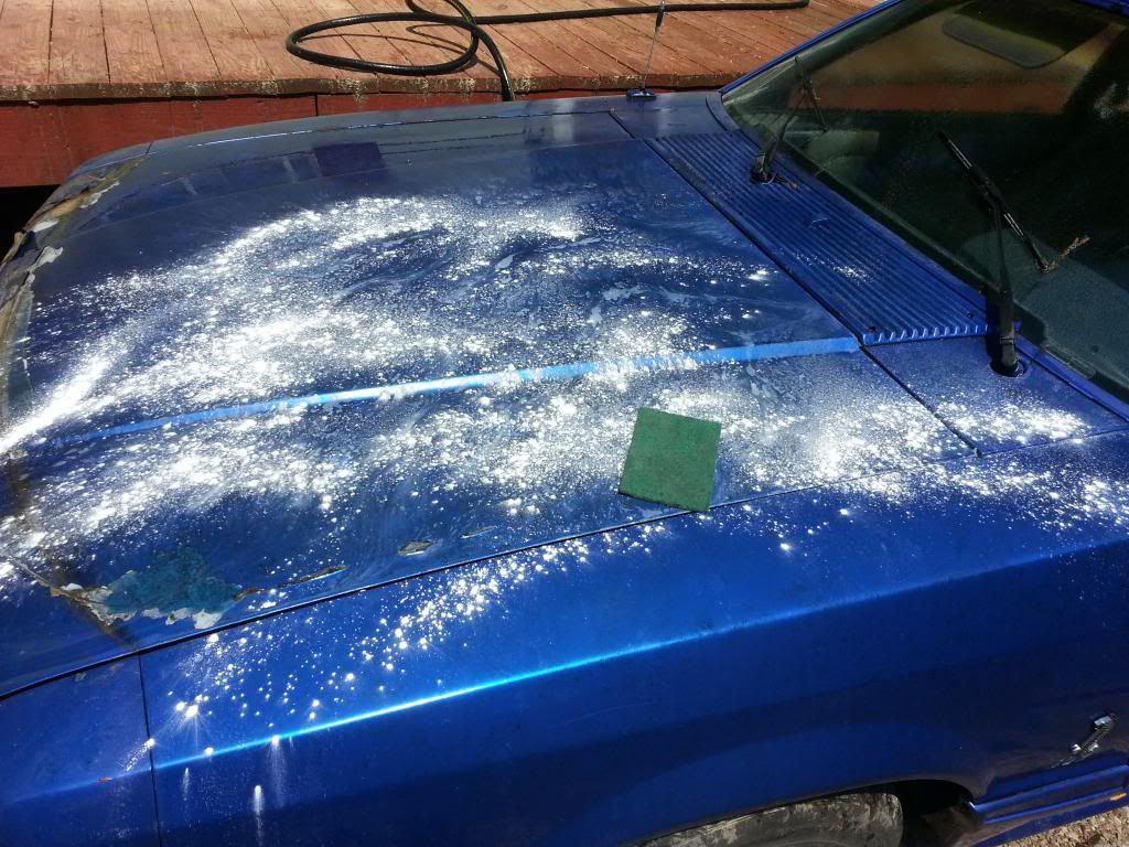

It has been sitting outside for years. There doesn't seem to be much rust on the body, but I'm sure I'll find it somewhere. (In fact, I just found some inside the vehicle...keep reading below).

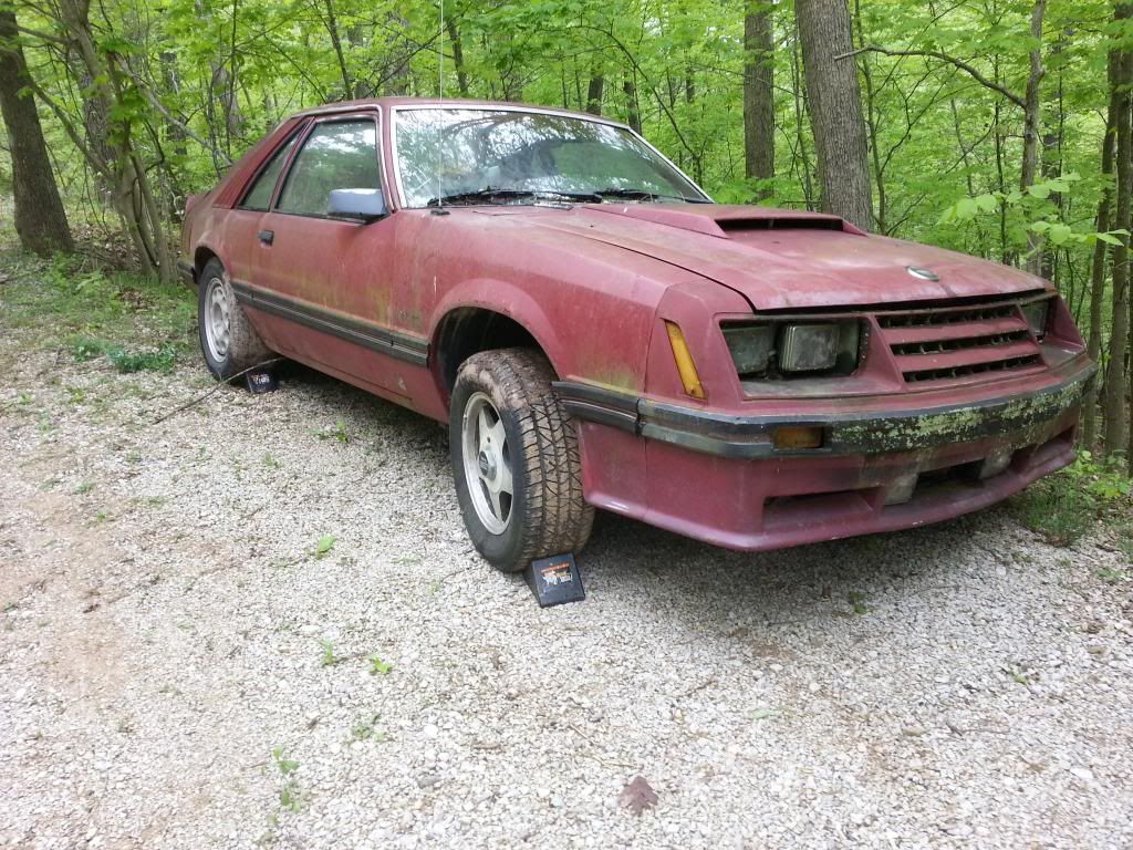

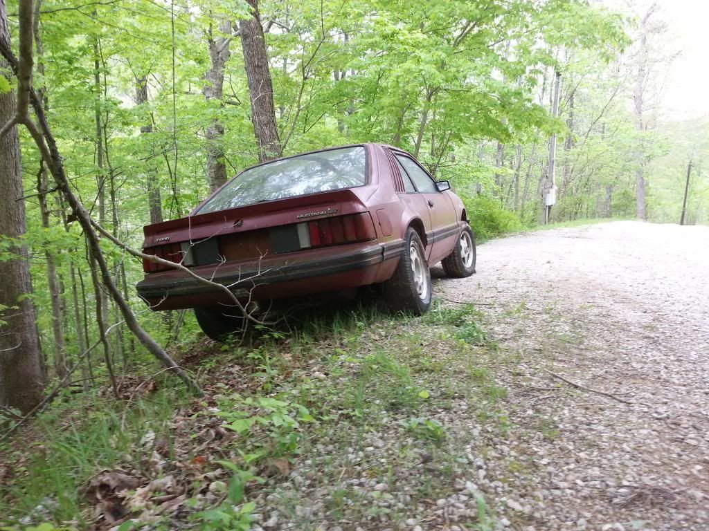

I also bought an 82 GT hatchback, which I will start another build thread, soon.

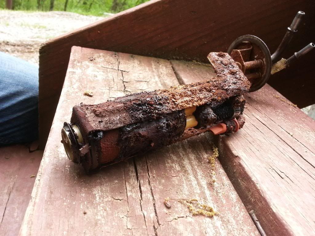

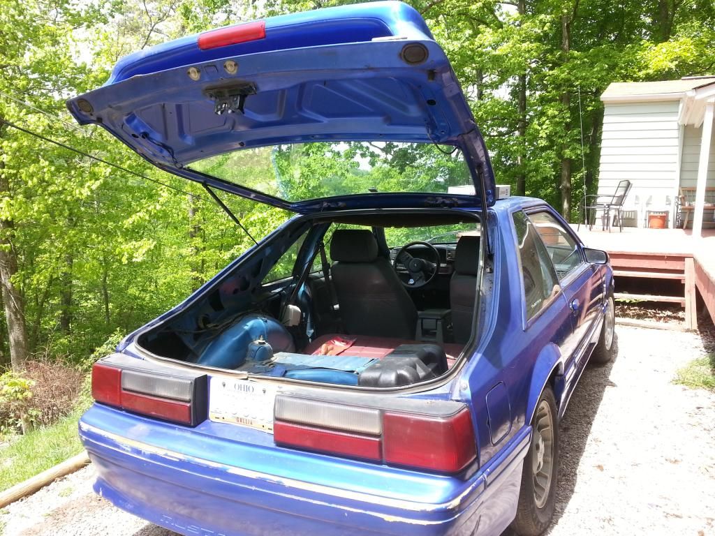

The 88 wouldn't start due to a bad ignition switch, so I replaced it. It started right up with a shot of starting fluid, but had no fuel pressure whatsoever. I tested everything back to the tank and narrowed it down to the pump. Here's what I found:

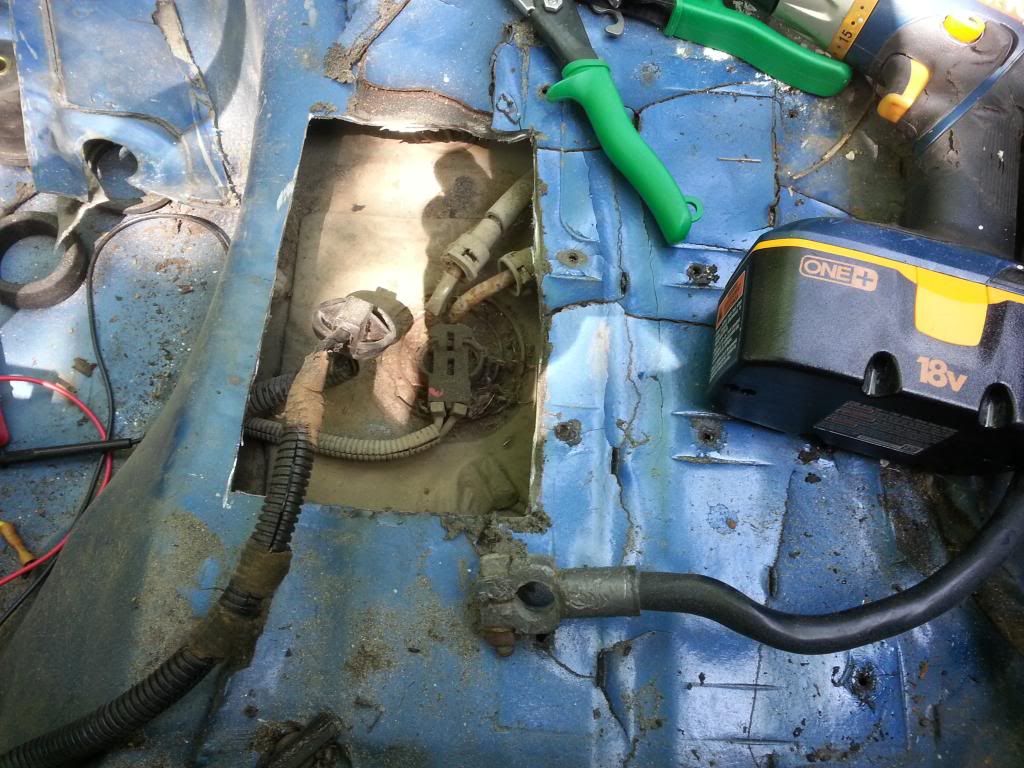

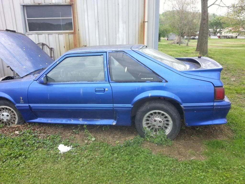

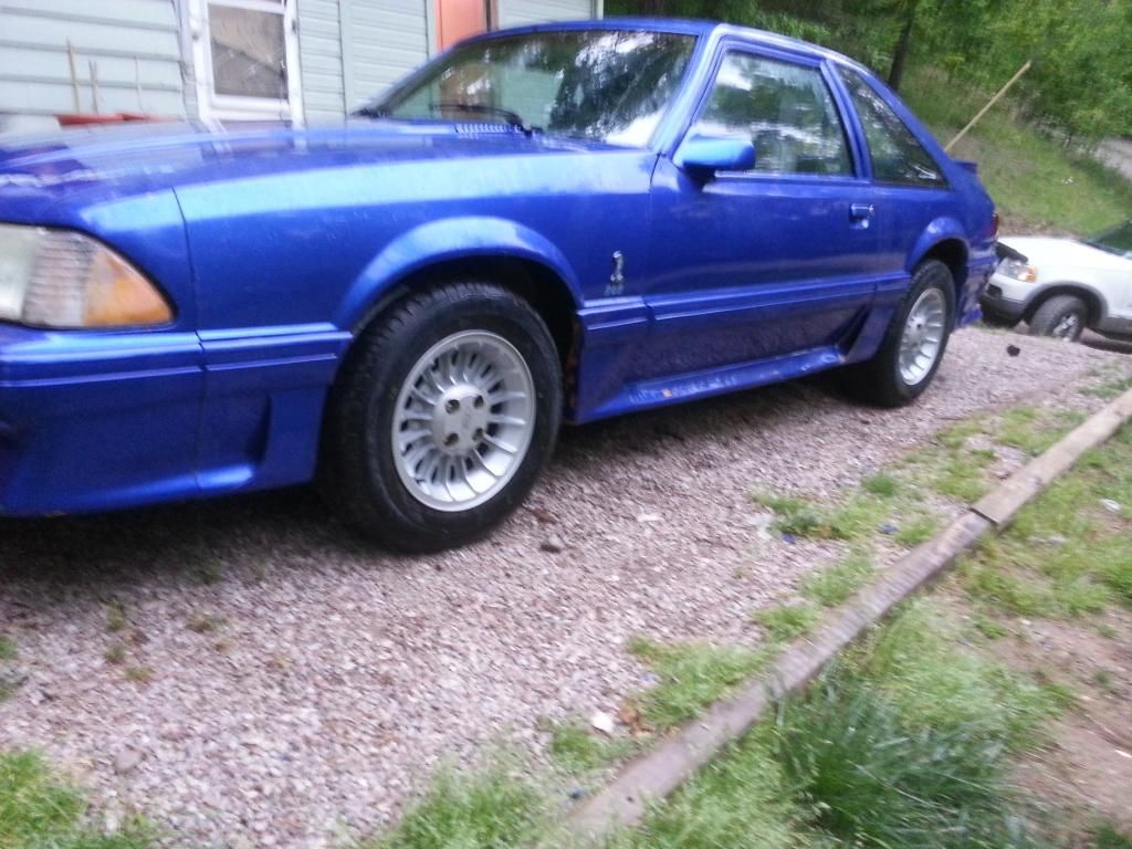

Yep. That was a fuel pump at some point. Anyway, the tank was in pretty good shape, other than this pile of rust sitting down in it. I decided to cut an access panel opening instead of dropping the tank. Yeah, I know the tank isn't hard to drop, but I have my own reasons too extensive to go into here.
After a new fuel pump and hangar assembly, she fired right up and ran perfect. It was a great feeling bringing her back to life! She sounds healthy. All of the above was done in the last week, so now, you're pretty much up to date.
