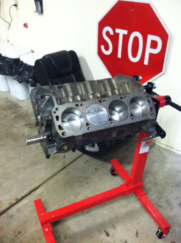

The build is well underway!
I have the short block, manifold, dizzy and a march alternator bracket in the garage for it so far.
Here are the specs on the motor:
69 block
JE flat top pistons
Eagle H beam rods
Eagle forged zero balance crank
clevite bearings, including cam bearings.
ARP hardware throughout
All machine and assembly work done by fordstrokers.
NEW, not used. there are zero miles on this build. only thing in it is assembly lube.
