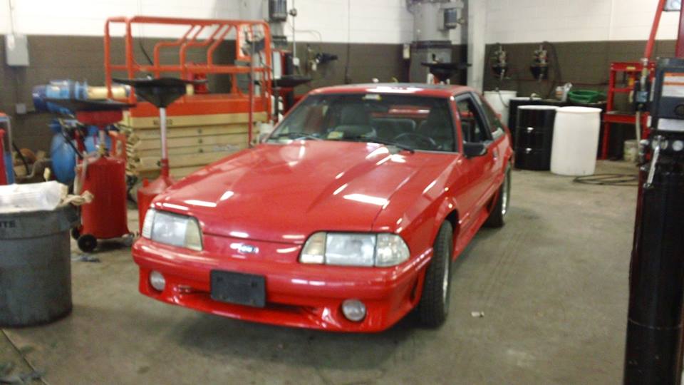

Got this car from work, they tried to get an emission inspection, long story short it is now in my garage:
This is how I got it:
1993 GT
