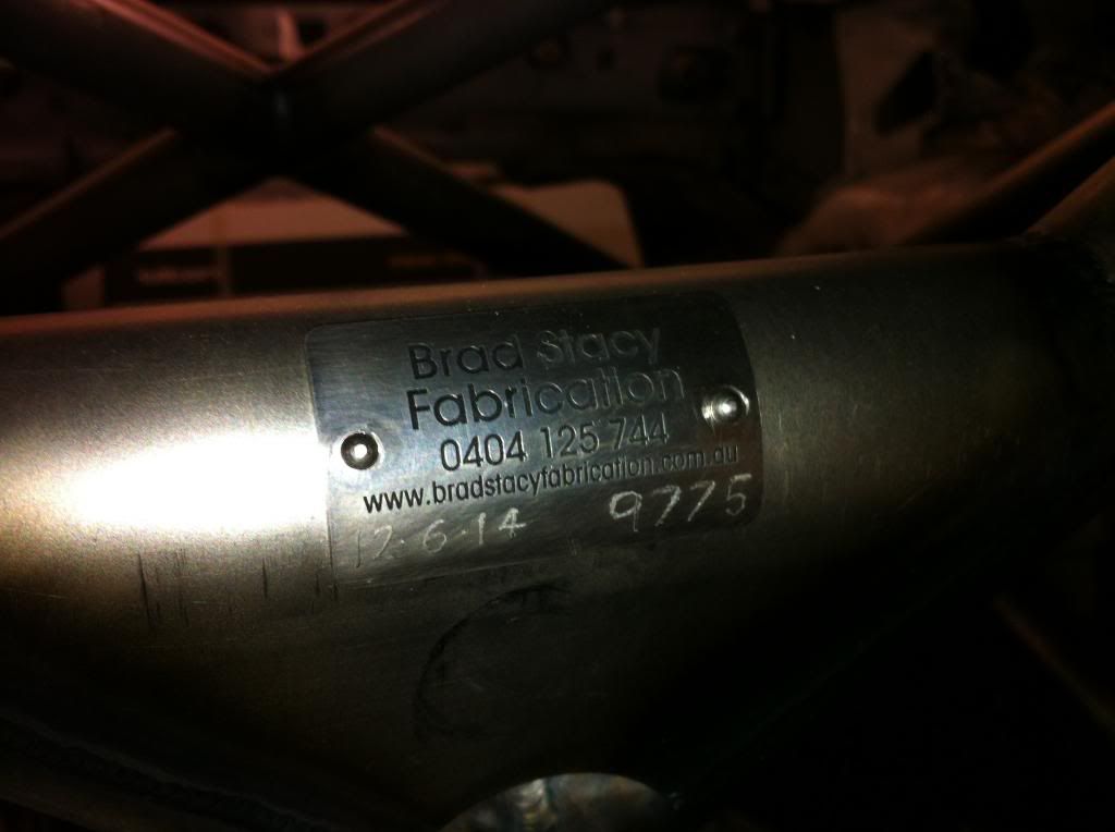

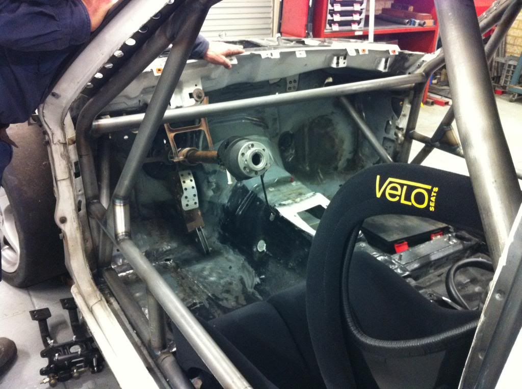

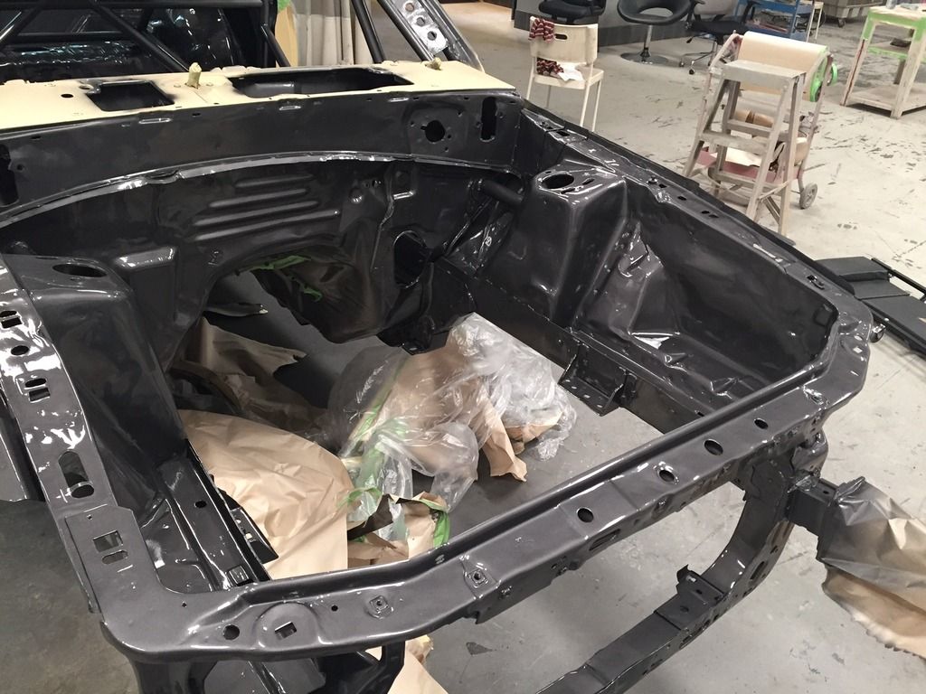

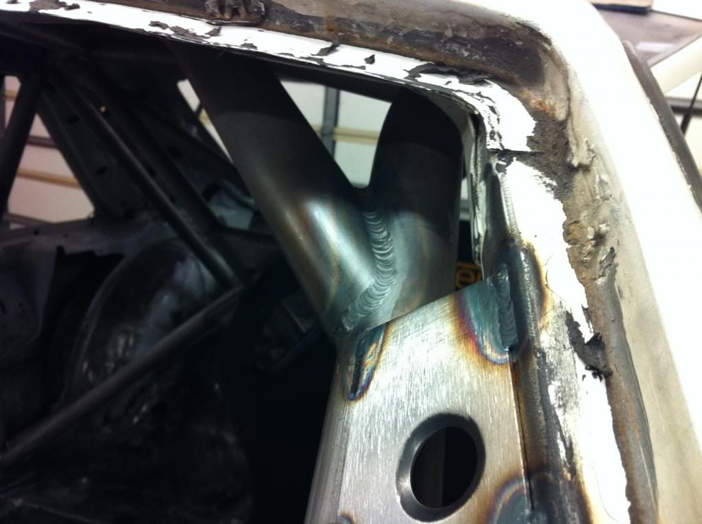

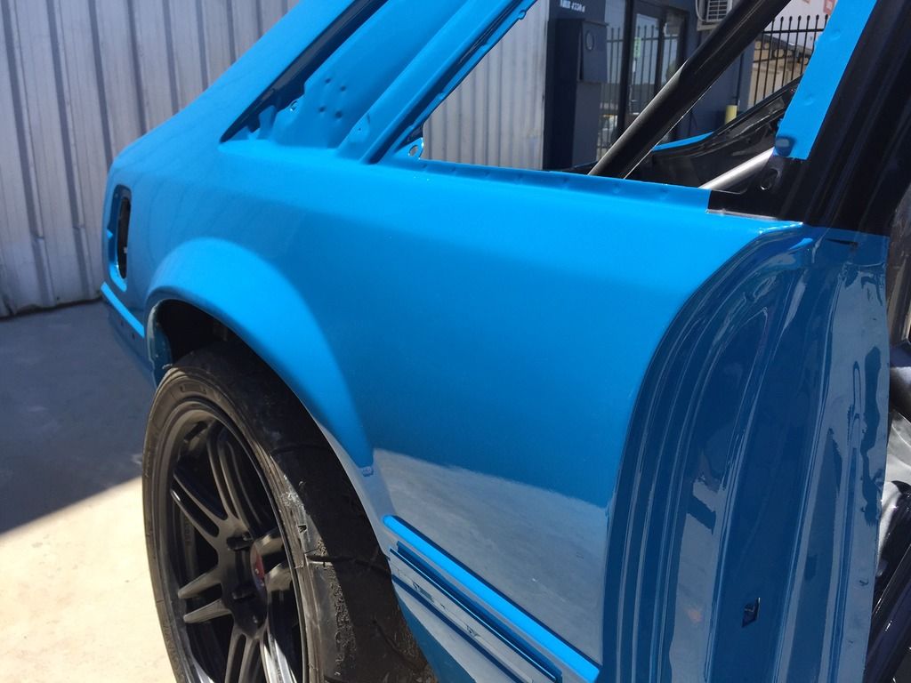

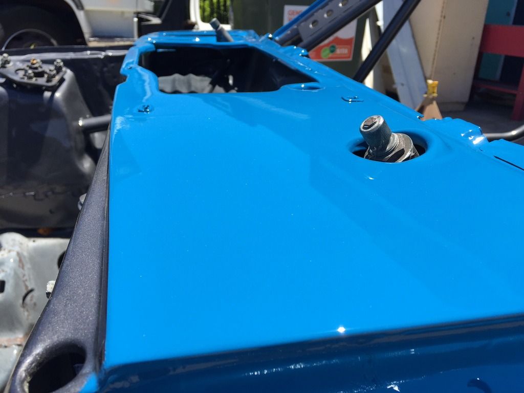

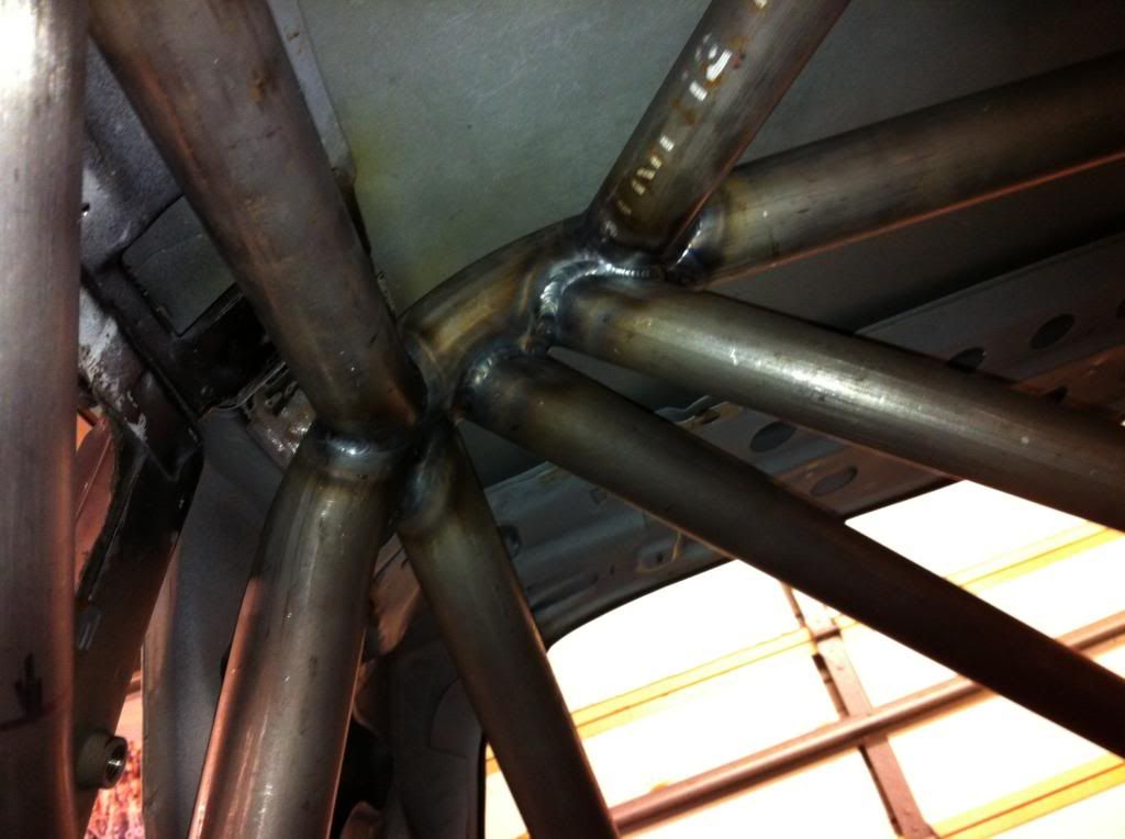

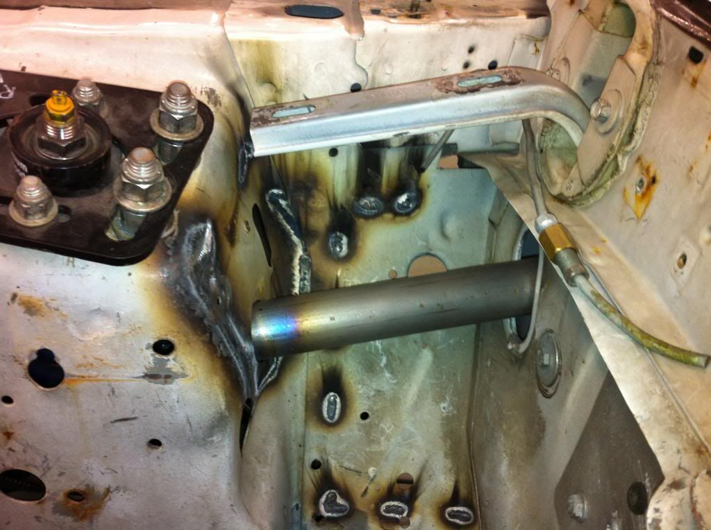

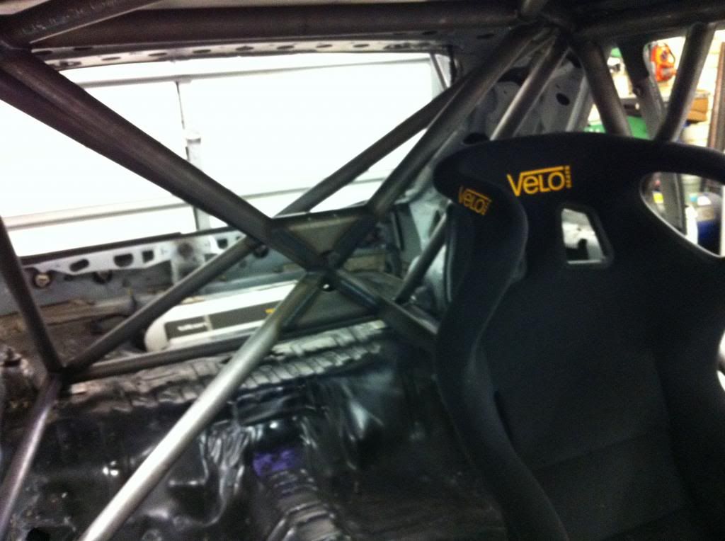

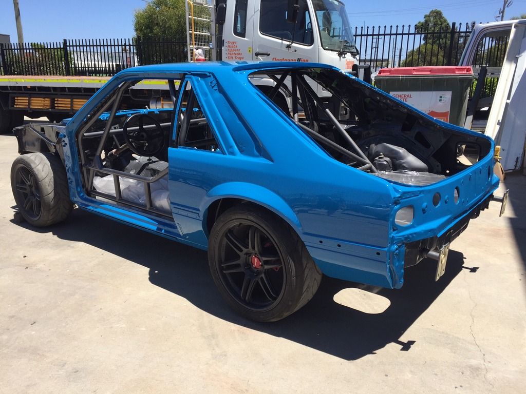

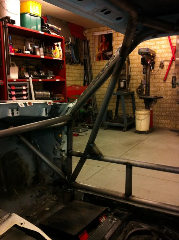

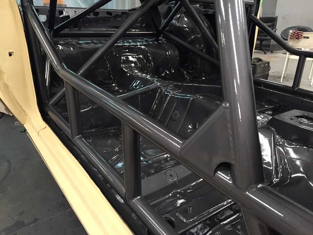

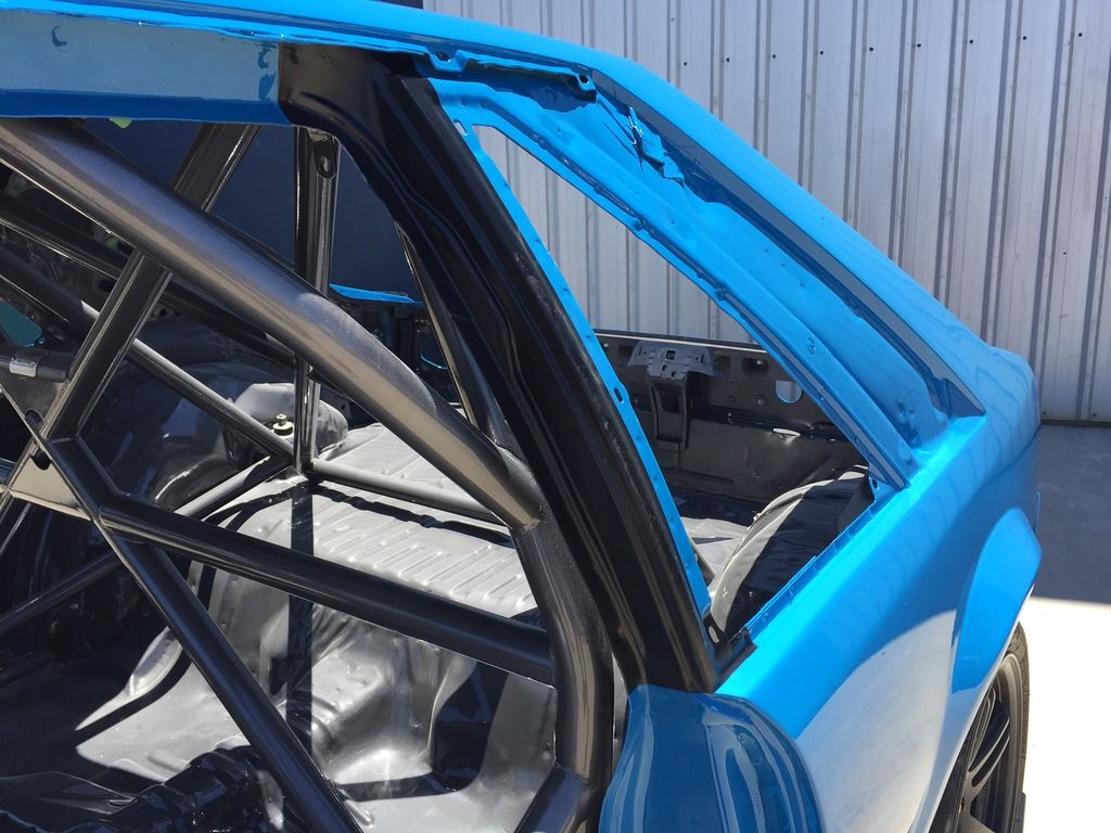

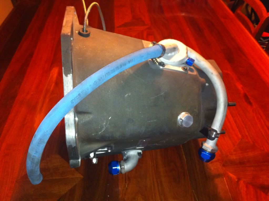

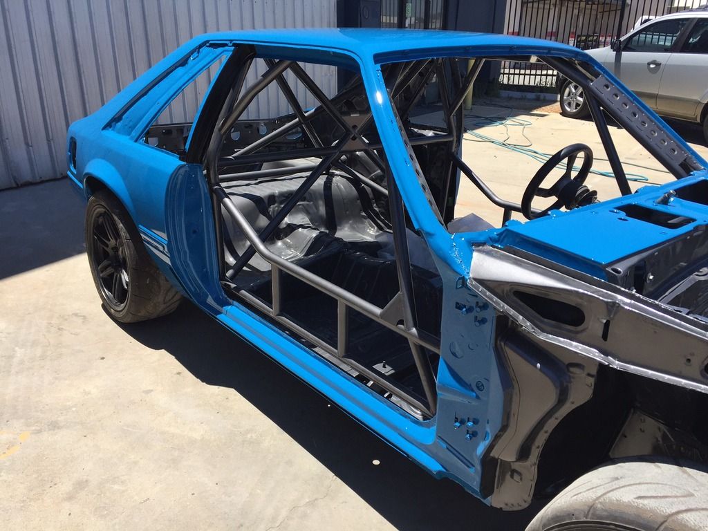

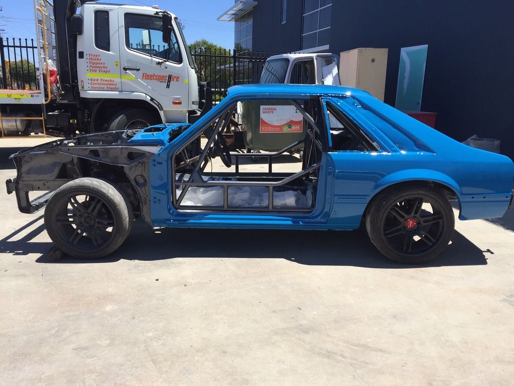

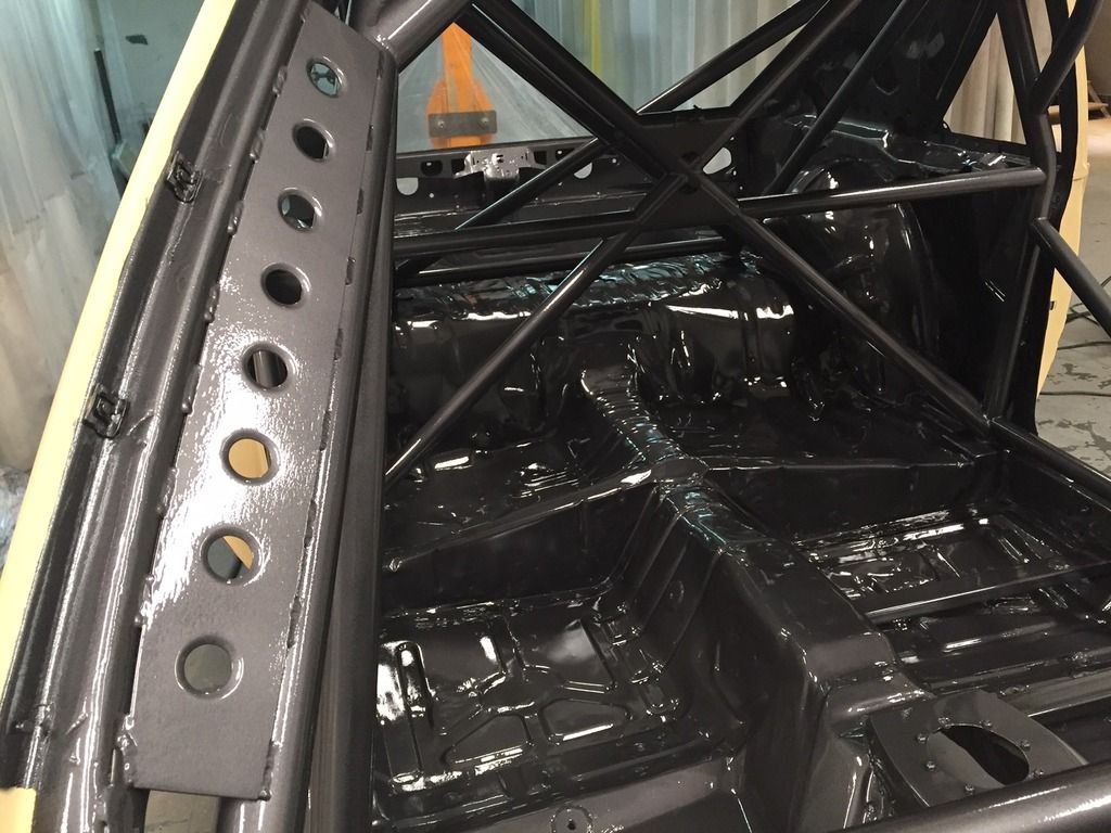

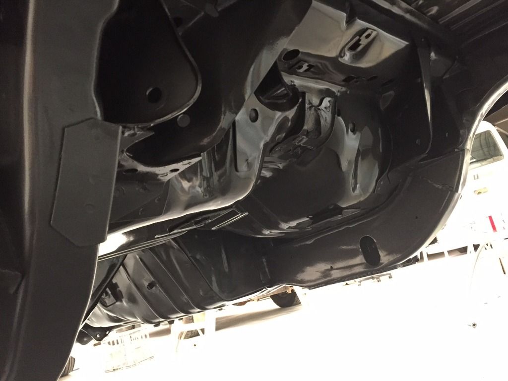

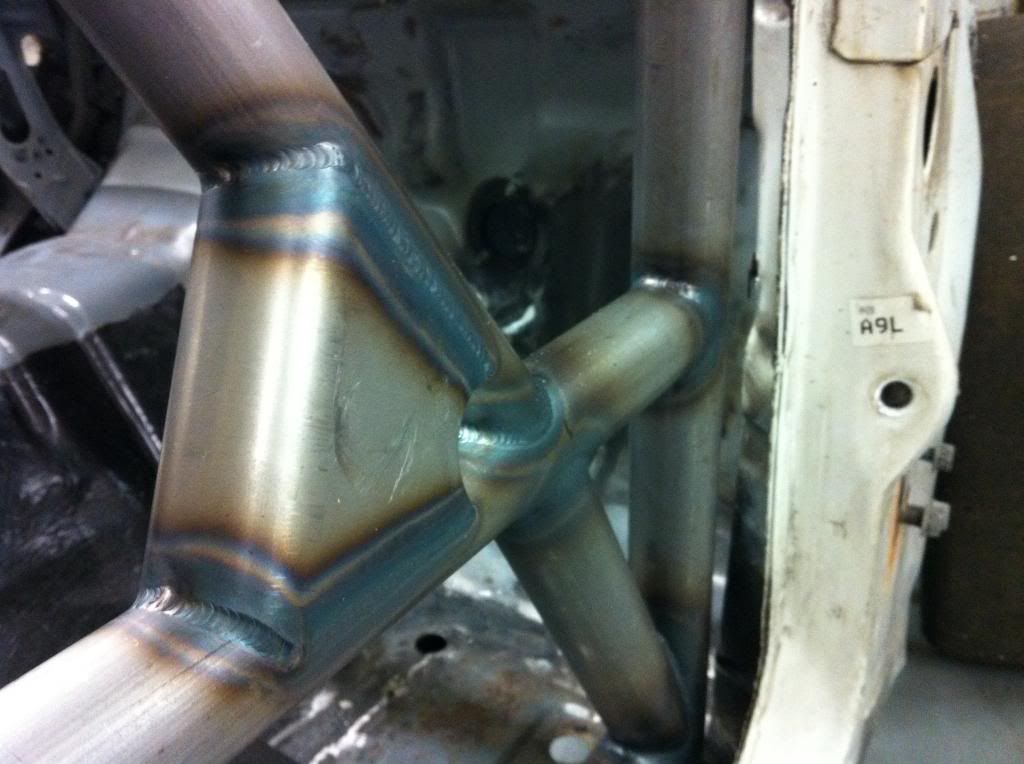

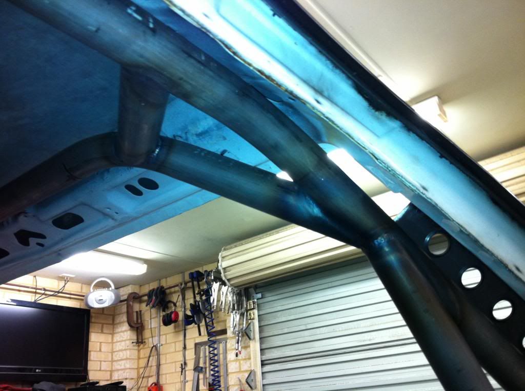

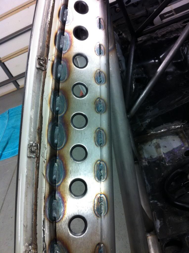

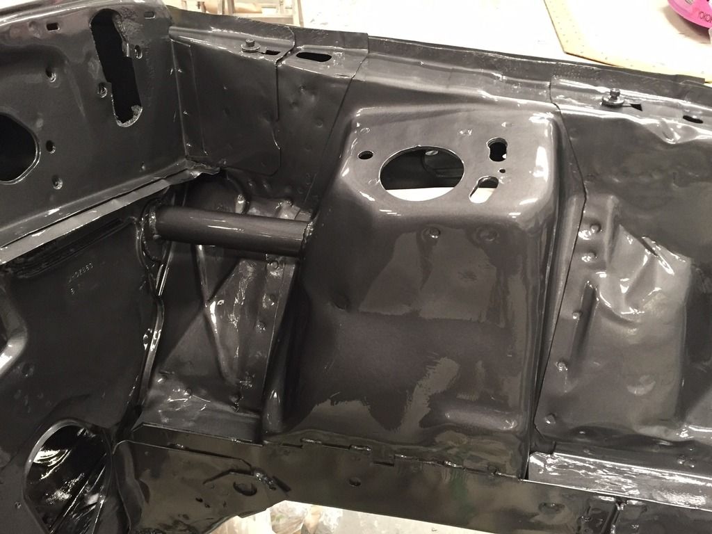

I'm Ashly from Perth, Western Australia and currently building a 1991 Fox into a circuit racing car. Below is some pics of the build so far.

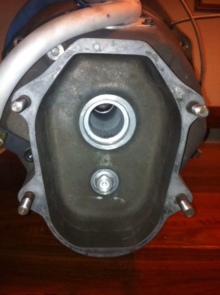

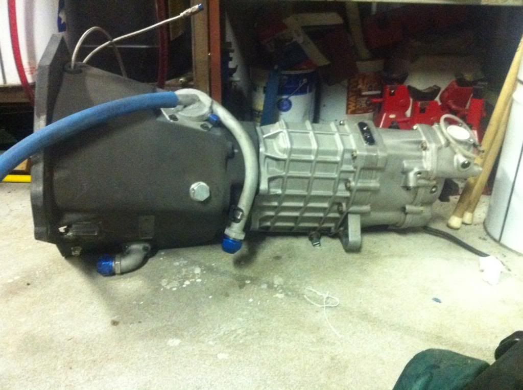

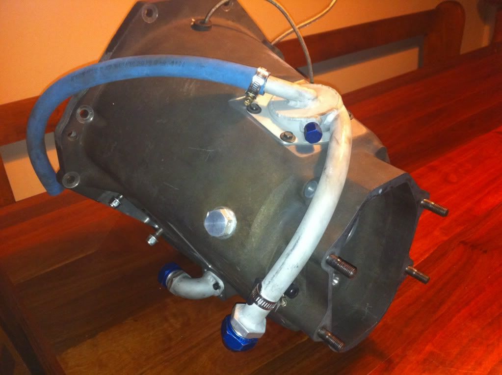

The engine is a SBF 363ci with yates C3 heads and dry sump, gearbox is a V8 Supercar Holinger Dog box with Magnesium Bell, the dry sump for the engine oil is in the bell. The diff is on its way from USA and is a 9" Cambered floater.

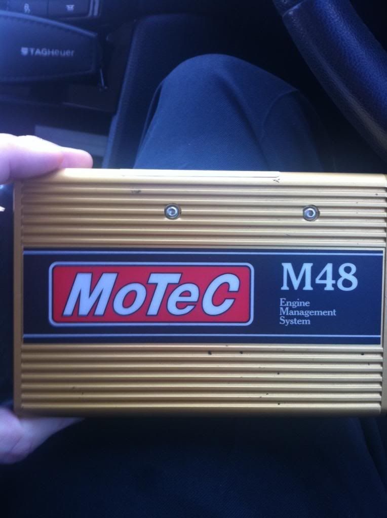

Motec M48 ECU running the injection and timing.

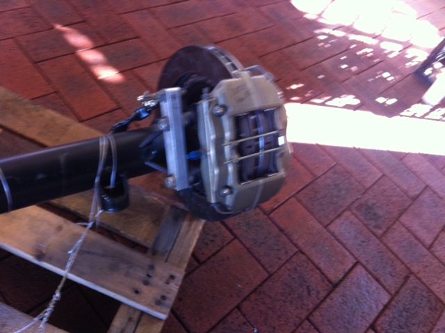

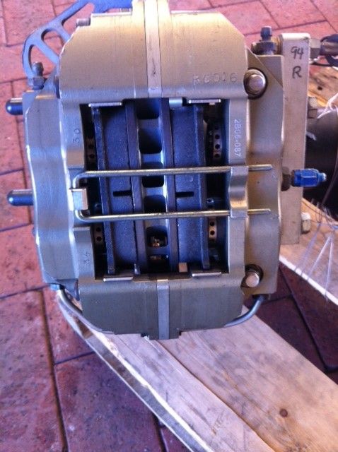

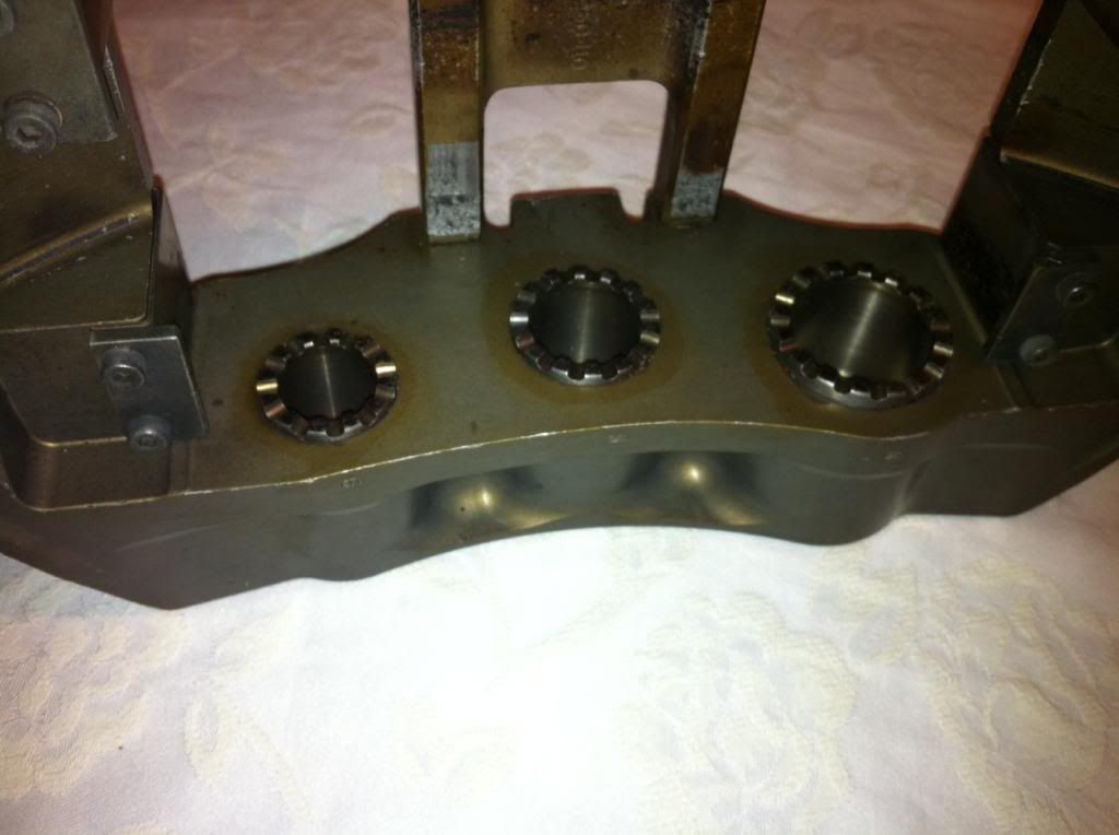

Brakes are

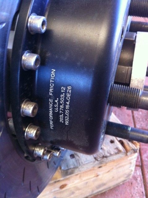

Front: V8 Supercar 6 piston mono block AP Caliper with 380mm x 36mm full floating rotor
Rear: NASCAR Brembo caliper with flull floating Brembo rotor
This thing is no joke!!
