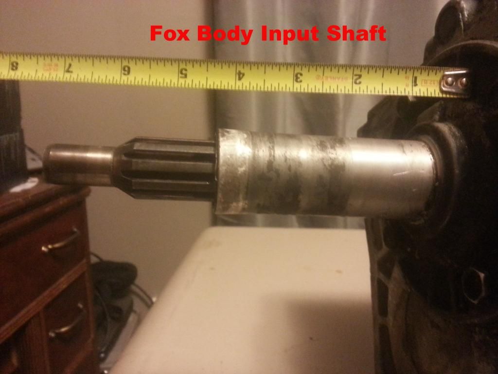

My main issue is with the input shaft. I'm trying to figure out if the shaft has been switched on this, or if the guy used the newer bellhousing. I know the newer mustangs use longer input shafts and bell, to set the shifter back a little. I just don't know how much of a difference I'm looking for. I measured and it looks like this new one has a shaft that is less than half an inch longer. Is this minor difference what they're talking about? I always presumed it would be at least an inch or two, if not more. doesn't seem like a half inch would even be noticeable. I'm hoping I can do this swap without messing with the bellhousing/clutch/etc. If I need to, then I'll consider how bad it will be to change the shaft, instead. I want to be able to swap this out later with another tranny, without having to worry about the bell and clutch assembly.
Had to take a closer look at these for comparison.
Here's what I came up with:
Difference between input shaft length...
So I think my best bet would be to swap input shafts, although I haven't found a definitive answer on whether or not an input shaft from an earlier model World Class tranny will be a direct swap. I'll probably yank the shaft tomorrow (today) and see what I've got. If I can order me a new one that works, I plan on using the fox bellhousing. Might have to swap out the retainer, as well. It looks like these are made differently.
