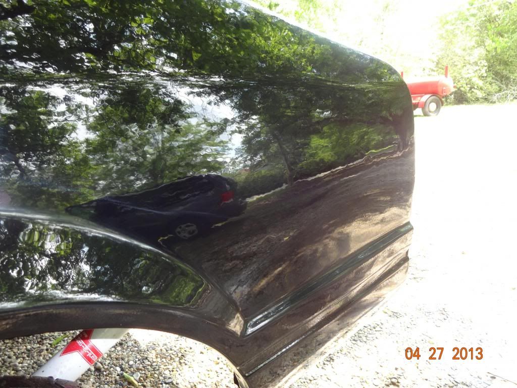

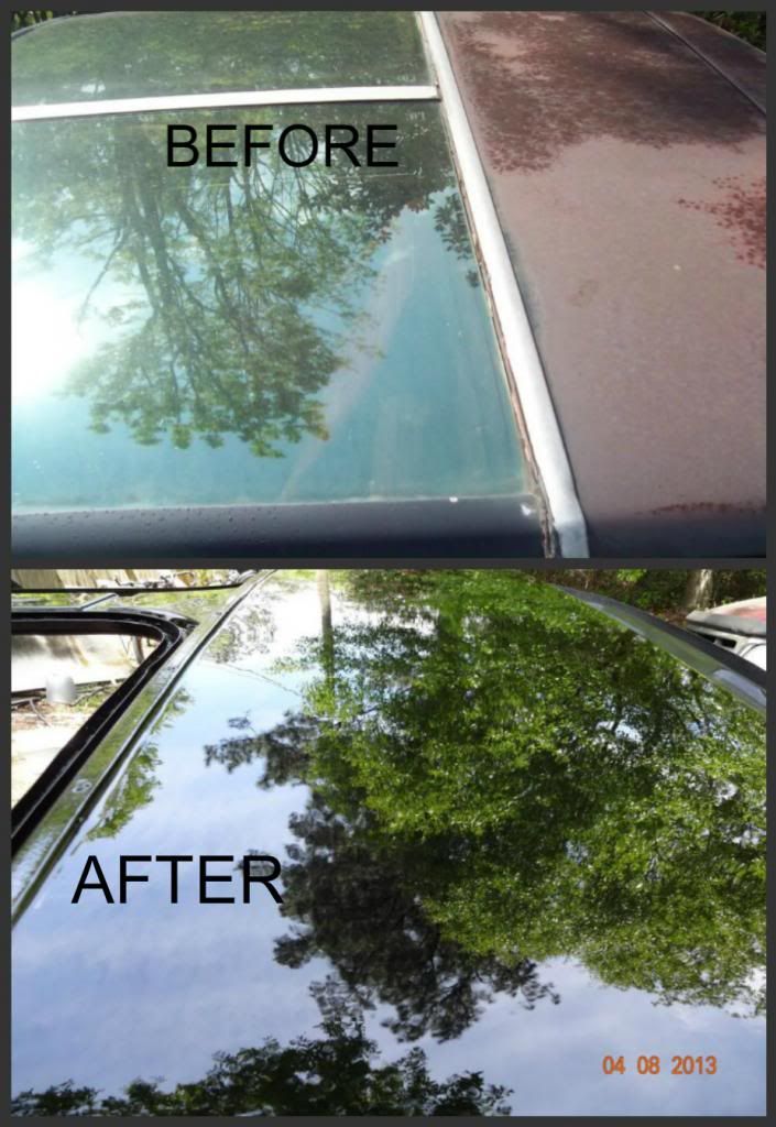

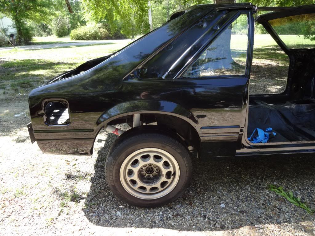

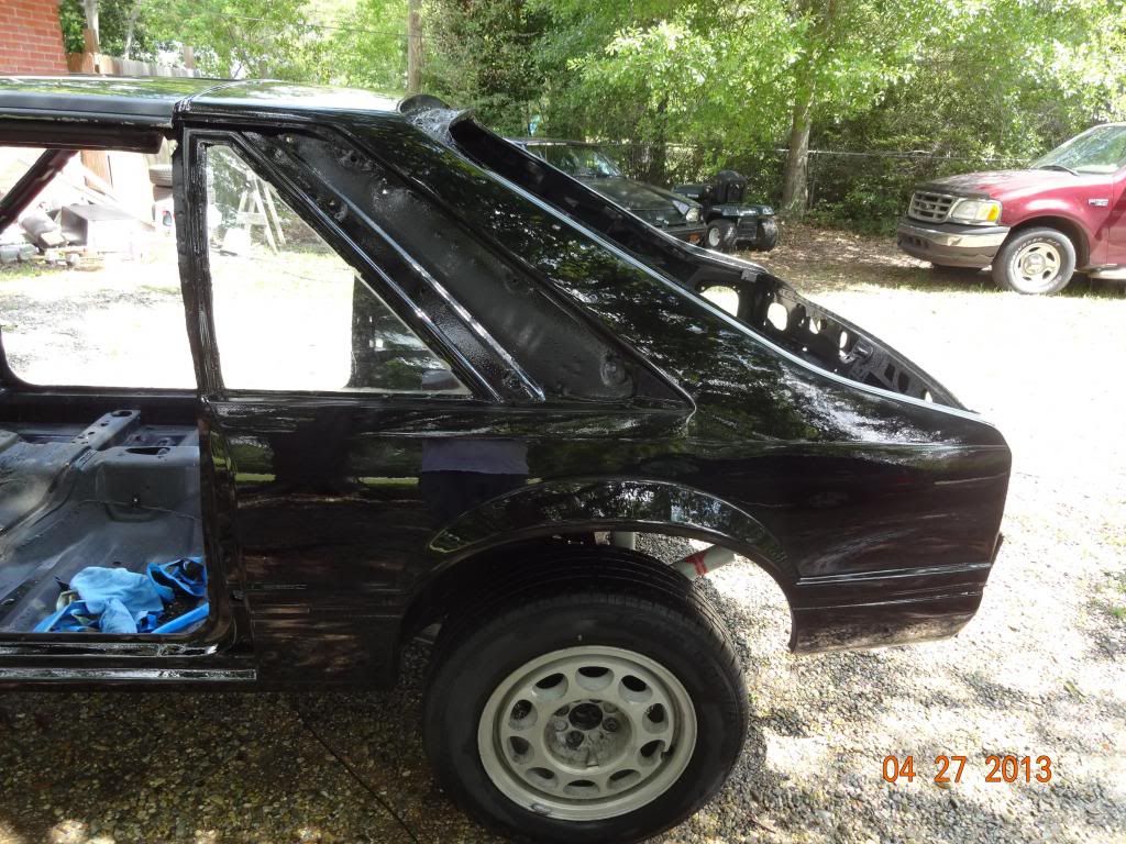

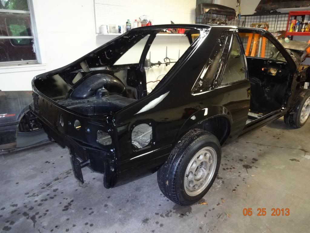

Wow, black is my favorite color. The second pic looks like a pic of the trees not the car. Awesome job, and it will only get better after you wet sand and buff it.

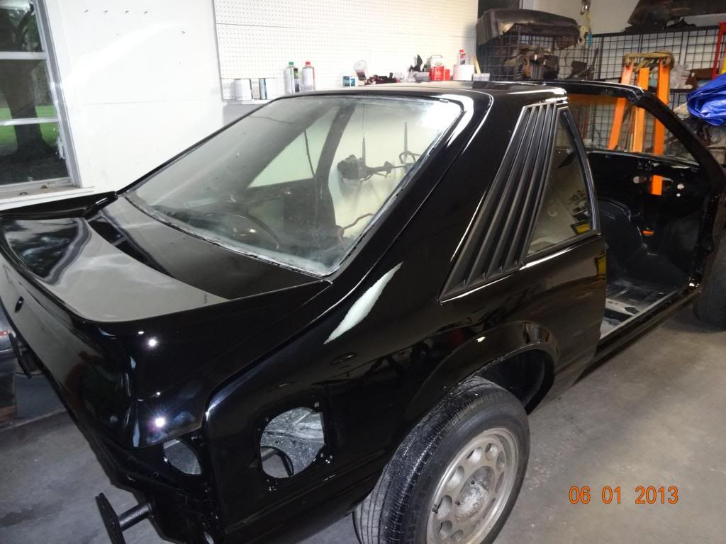

Used a nib file to work out the run then wet sanded with 1500, then 2000 grit and buffed the passenger side. I’m using 3m’s three step buffing compound and this is only the first step!!! Can’t wait to see the rest but I’m out of time for today. I have a wedding to go to. o_O

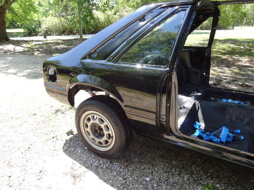

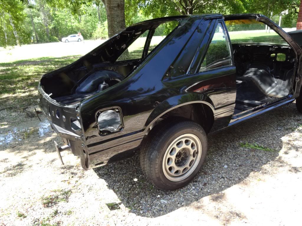

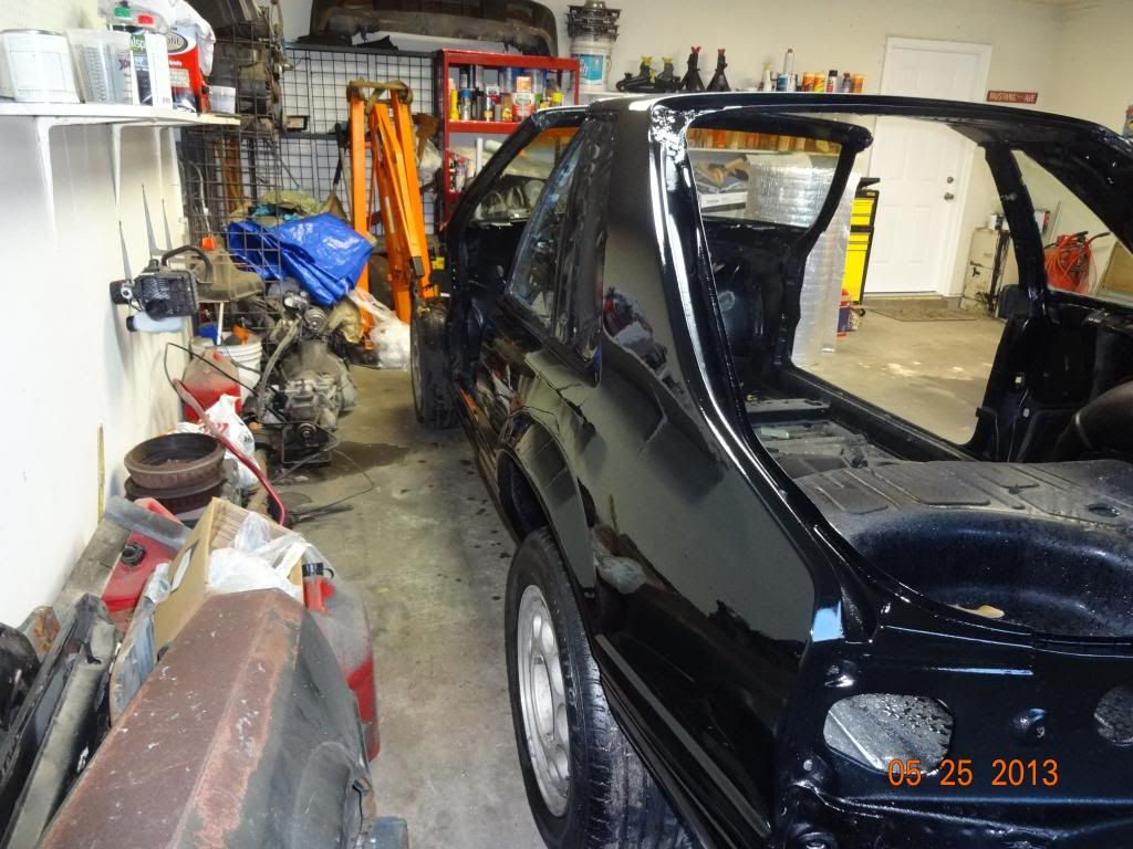

Here is a better picture. The others don't show to well in the sunlight.

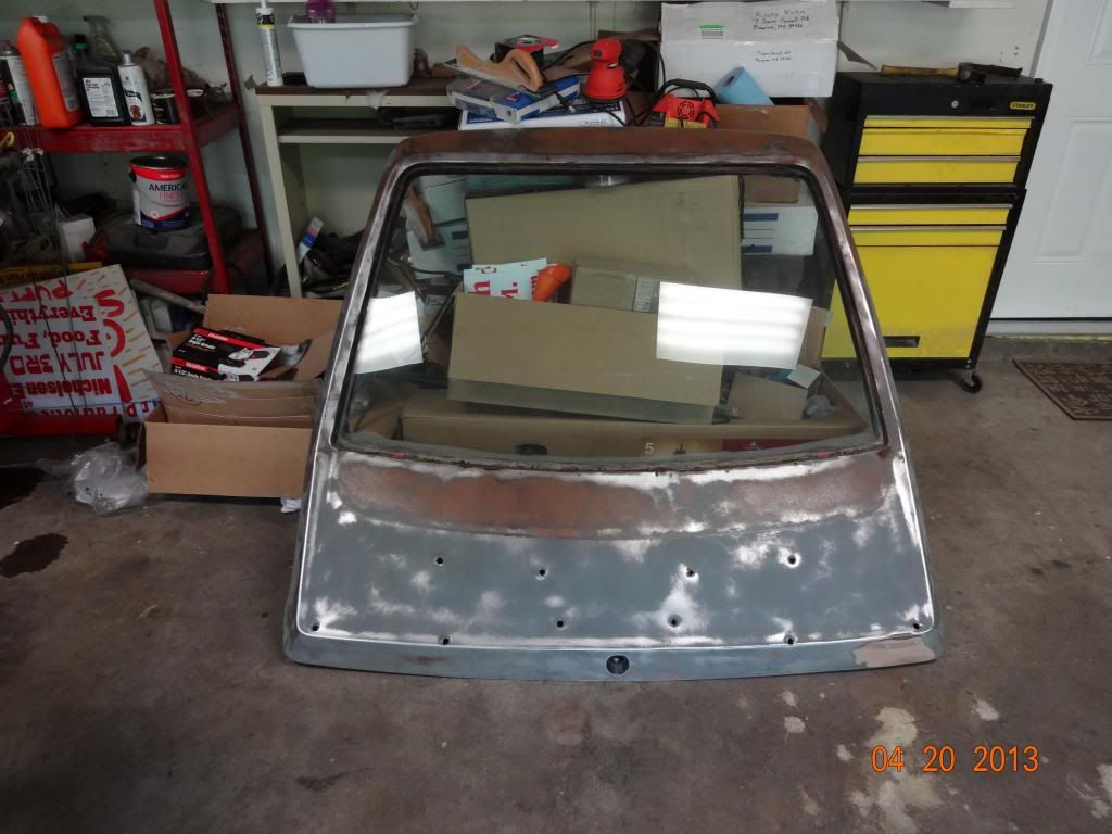

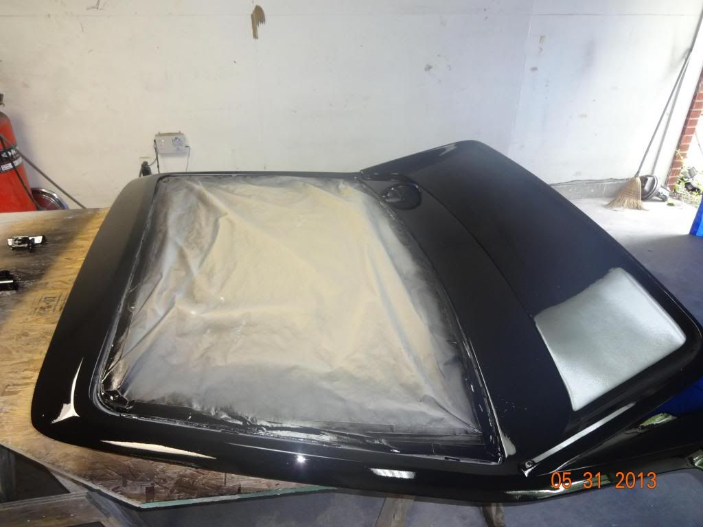

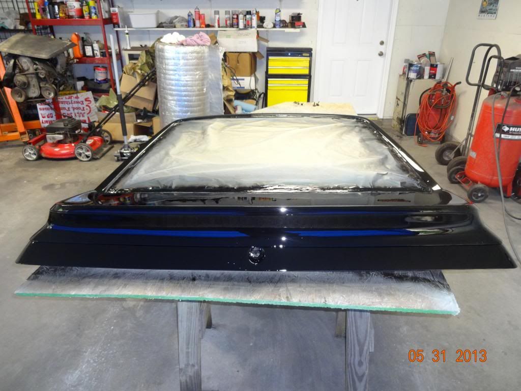

Earlier in the week I sanded the hatch and fixed a little dent in the lower right side. Now it's ready for some primer.

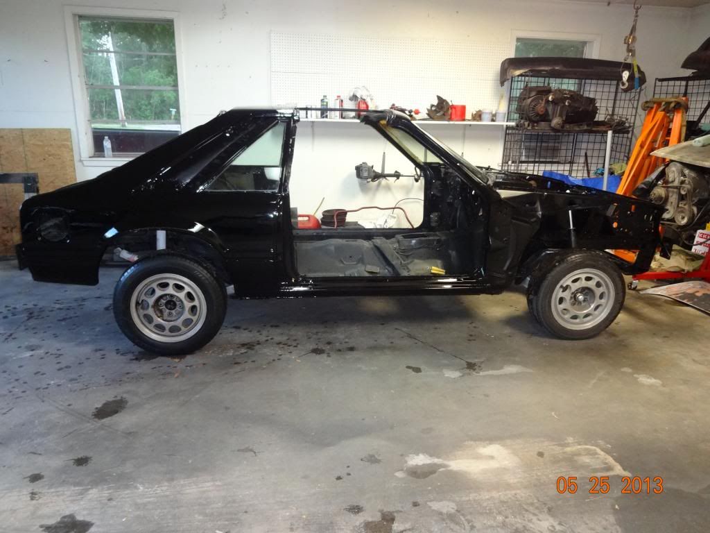

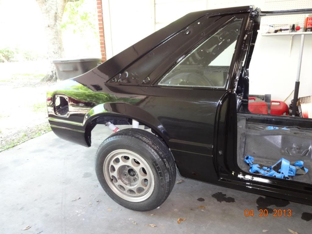

Spent a few hours today going through the wiring harnesses brake lines, and fuel lines cleaning them up and making sure everything is up to par. Also making sure I remember how it all goes. They are in surprisingly good shape! I also have the doors and hatch, almost, ready for some paint. Will share some pics later but not much to see at this time. lol
