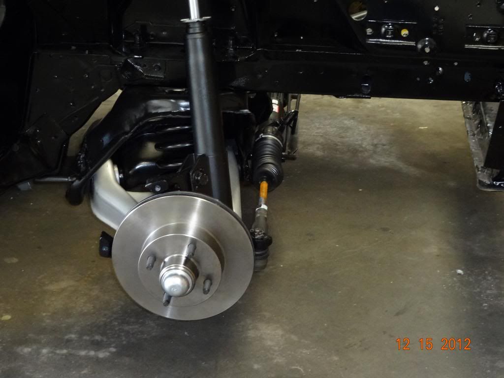

Must have had a hell of a time connecting the strut since there is no weight in the car. Or did u connect it while the spring was still compressed???
rkuhn
The only way I could get the compression tool out was to drop the control arm all the way down, (hoping the spring didn’t pop out and kill me:eek: ), and slide the tool out between the spring and the control arm. When I connected the strut I put my jack under the control arm just under the ball joint and jacked it up as high as I could until the car body started to lift. Then my wife and I had to stand on the K member to get it to go down far enough to get the top bolt on. She wasn’t happy with me. ;)

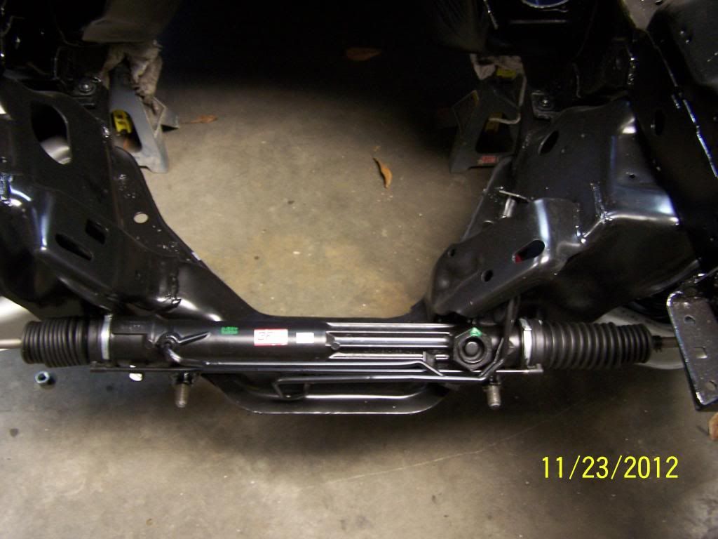

Installed the rack today and will do the outer tie rods in the morning when I get some more time.

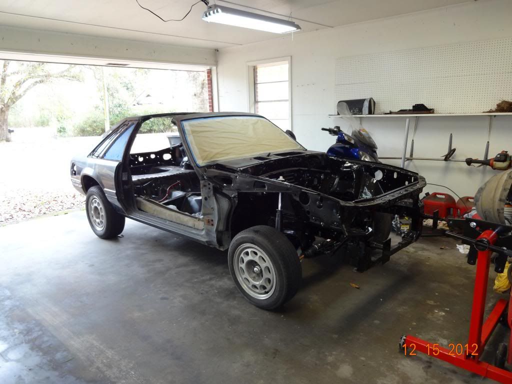

Santa came a little early to my house. My wife asked me what I wanted for Christmas. I said rotors for my Mustang and here they are. I tore my foot up the day after Thanksgiving and haven’t been able to do much but today I hobbled out and got to work. I feel like I have hit my first mile stone with the car now that she is a roller again. I was going to go ahead and start working on the motor but have decided to do the body work first since I am still debating on what I am going to do with the motor. Mild mods or all out!!!
Santa came a little early to my house. My wife asked me what I wanted for Christmas. I said rotors for my Mustang and here they are. I tore my foot up the day after Thanksgiving and haven’t been able to do much but today I hobbled out and got to work. I feel like I have hit my first mile stone with the car now that she is a roller again. I was going to go ahead and start working on the motor but have decided to do the body work first since I am still debating on what I am going to do with the motor. Mild mods or all out!!! It's really coming together. Looks great. Go all out.

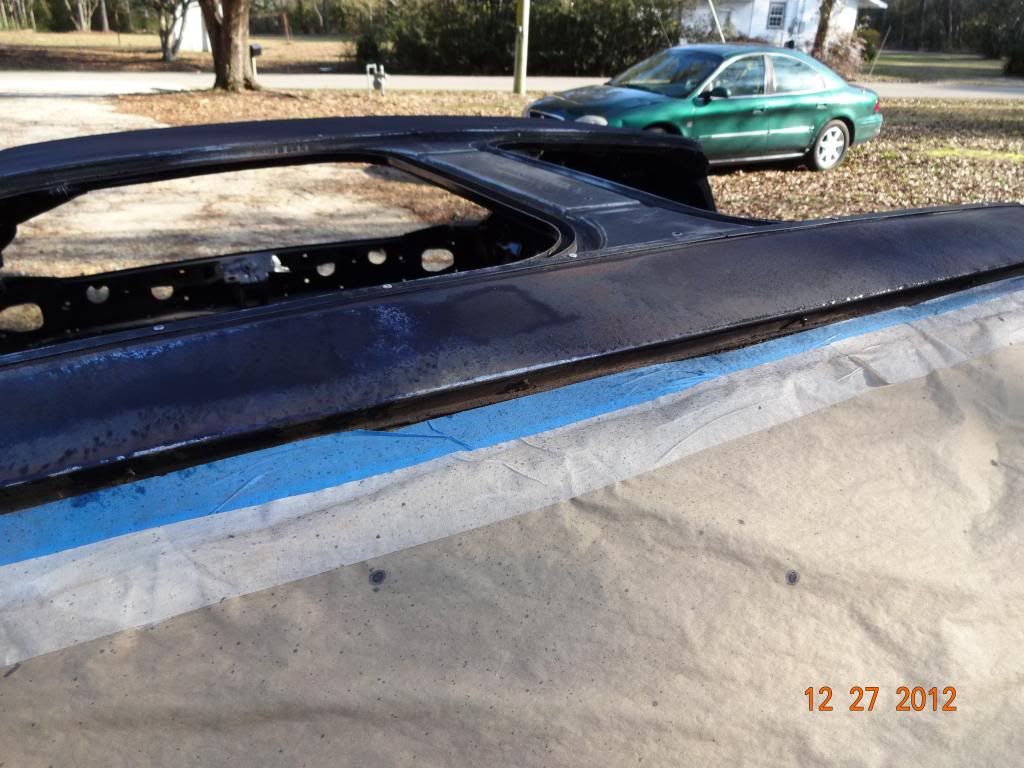

I'll be off work till 1/3 so my plans are to knock out as much body work as I can. Today I will have a sanding party.

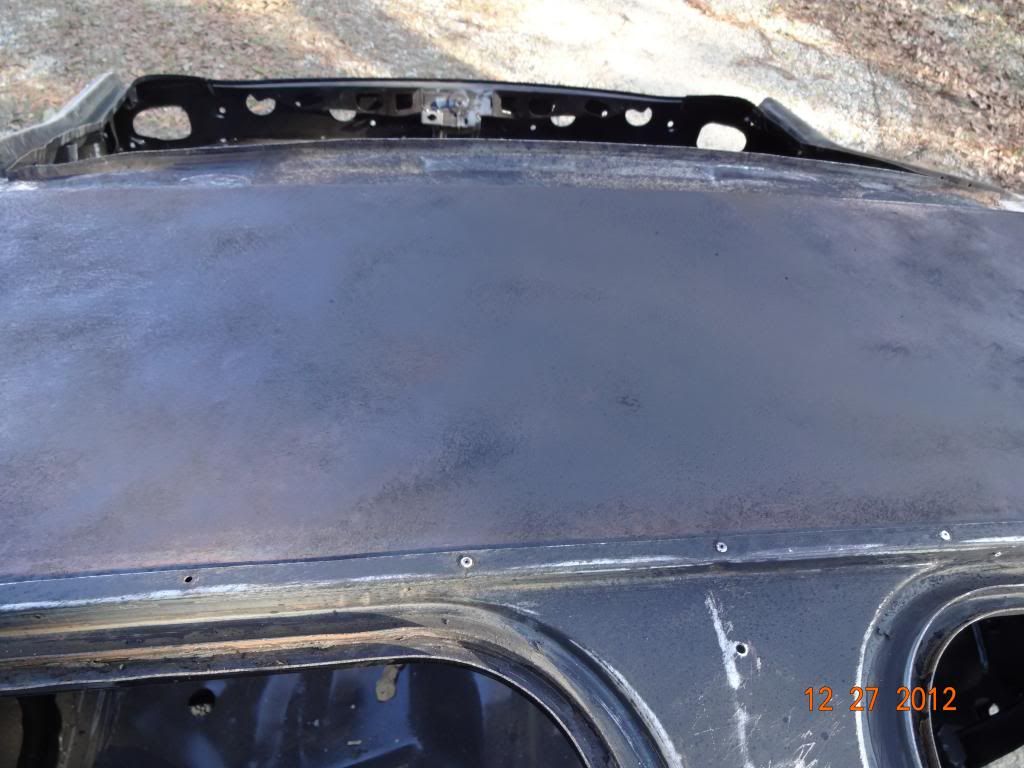

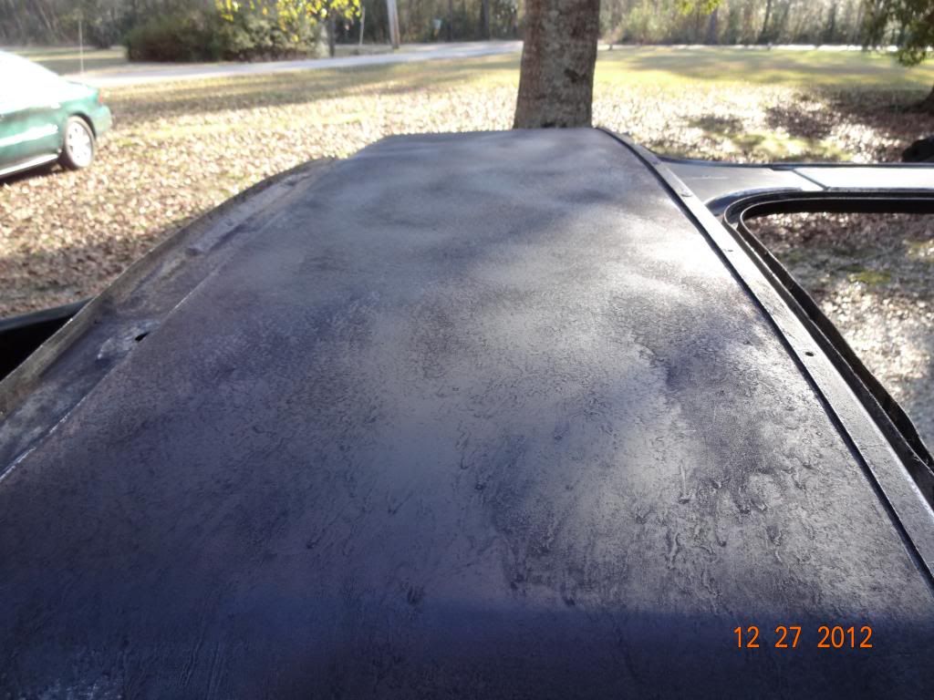

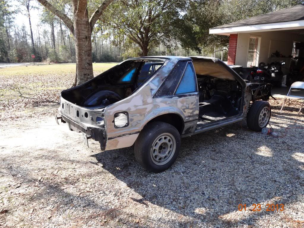

I’m excited about doing the body work even though I hate sanding. I was considering bead blasting some of the surface rust on my car but chickened out. However after putting the D/A sander on it it came out allot better than I expected. I will still have to put some filler over it.
Before
I put some of this on it to help kill some of the rust in the pitted areas. I forgot to take a picture prior to putting it on.

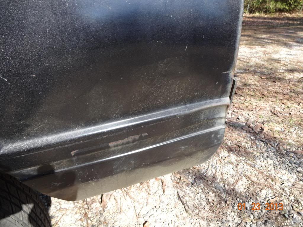

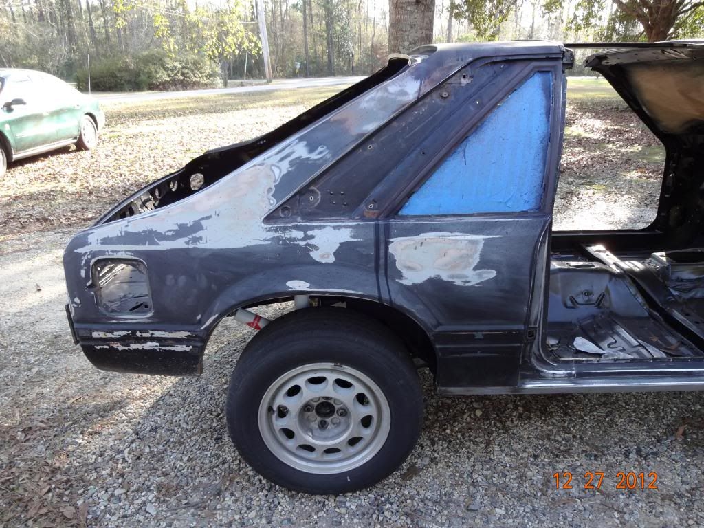

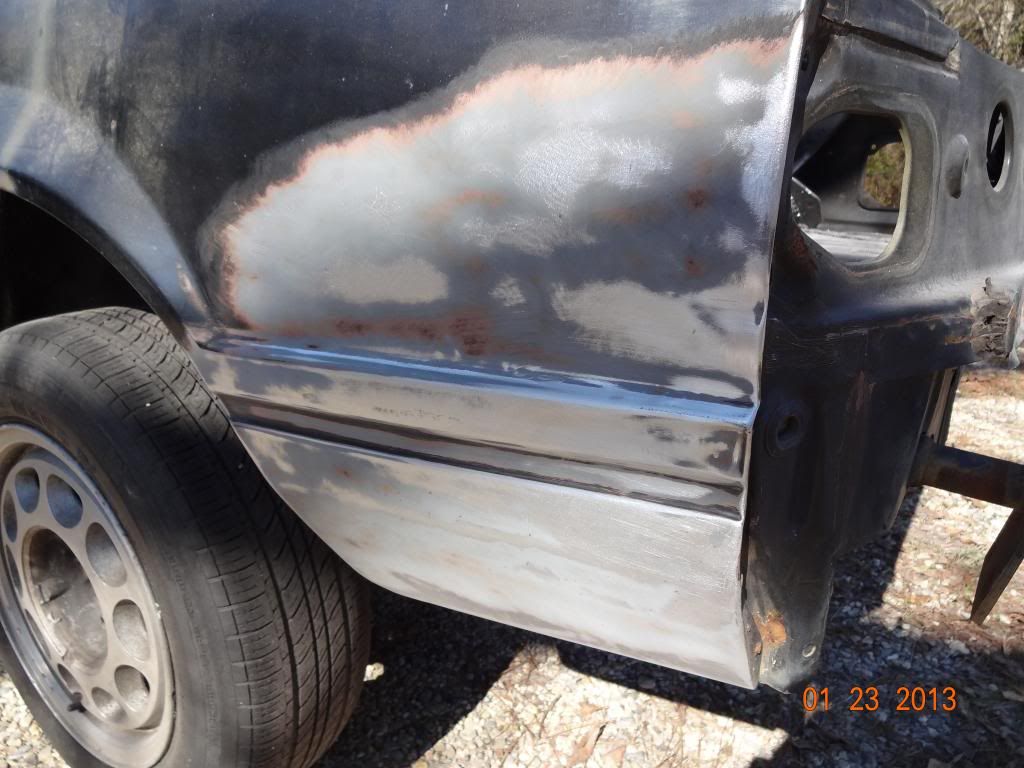

Found a not so welcome surprise on the passenger rear quarter. I knew it had bondo on it from being rear ended before but I didn’t know it had this much. I am going to take it all off to see what the damage is. It doesn’t look bad from inside the car.

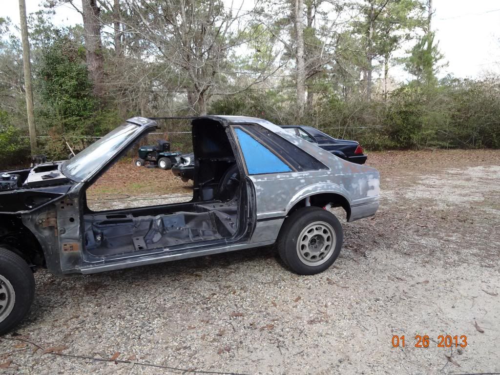

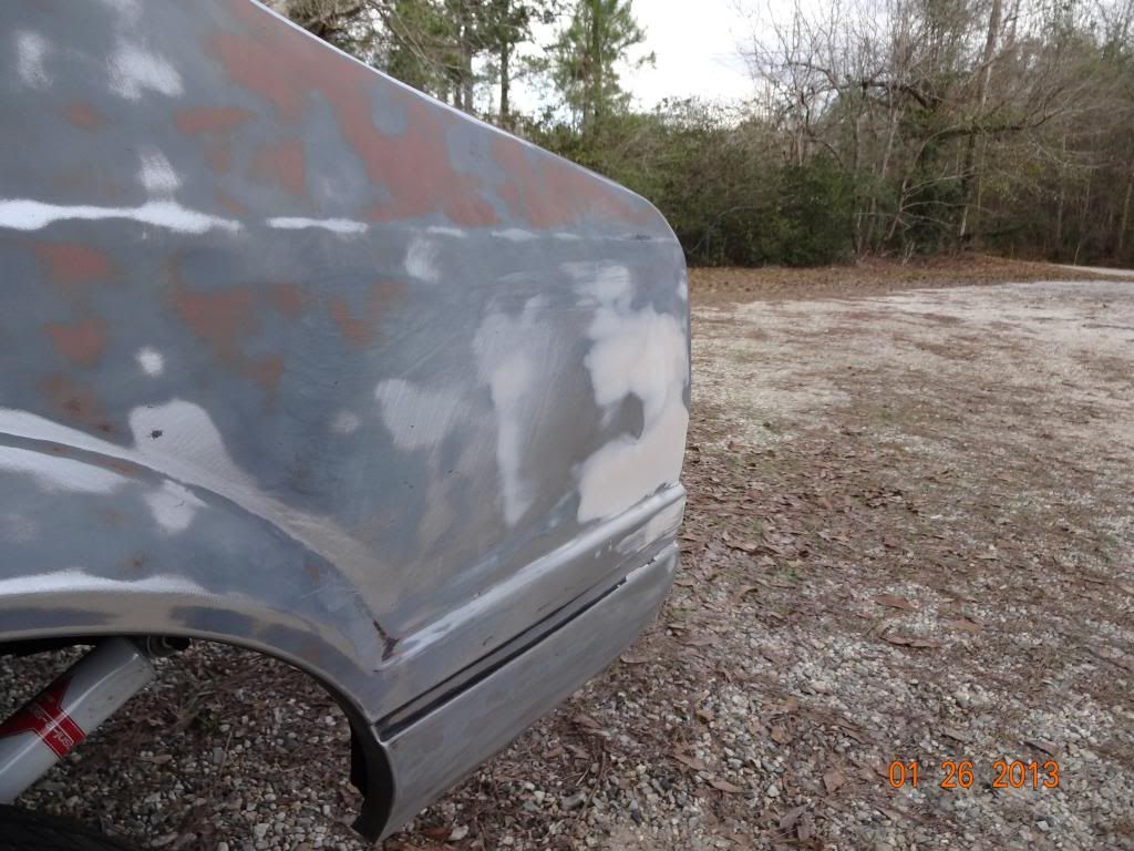

This side is ready for some primer!!!

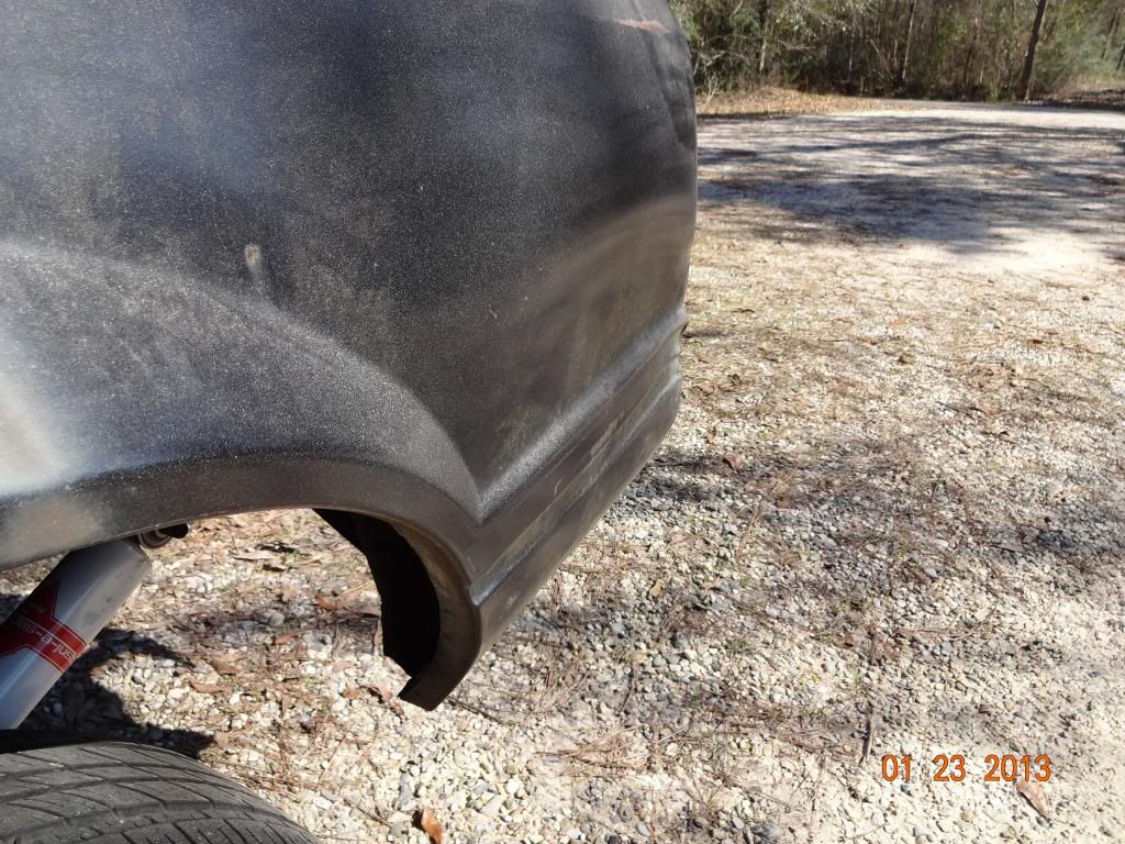

Luckily this is the worst part of the body.
I was able to hammer out most of the damage

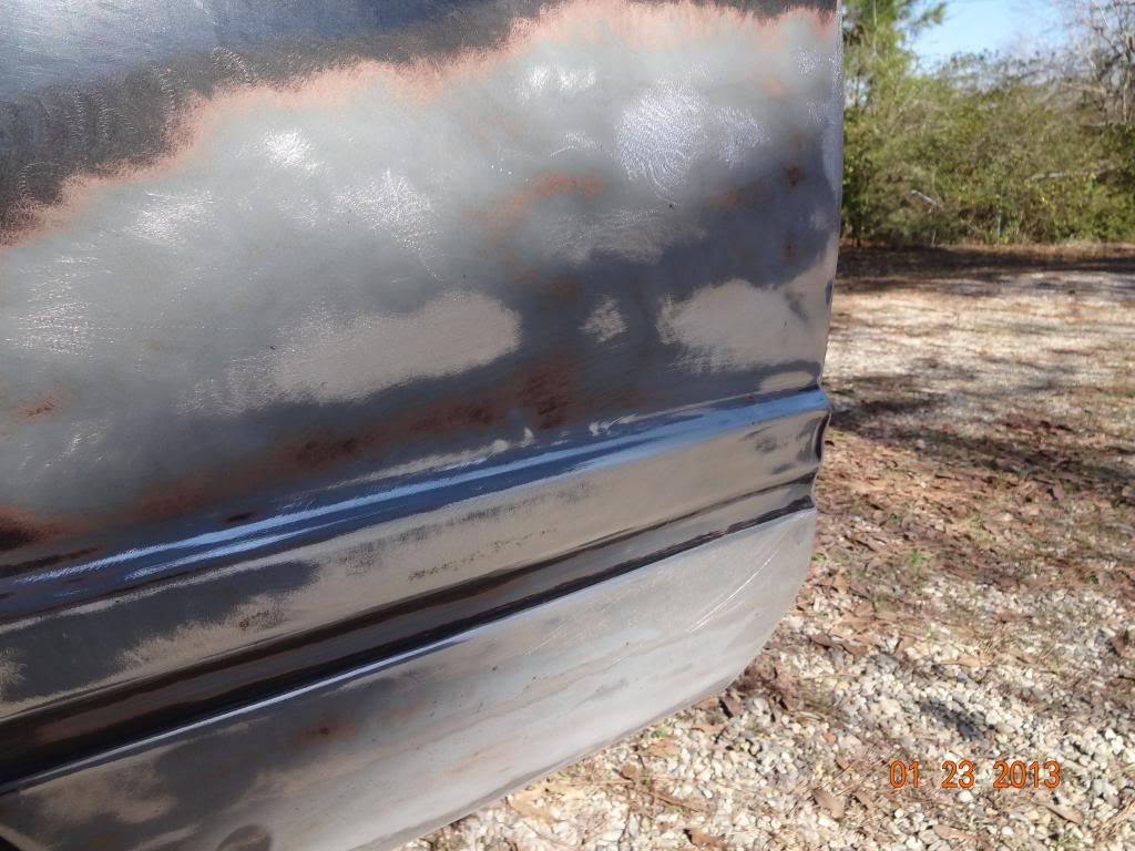

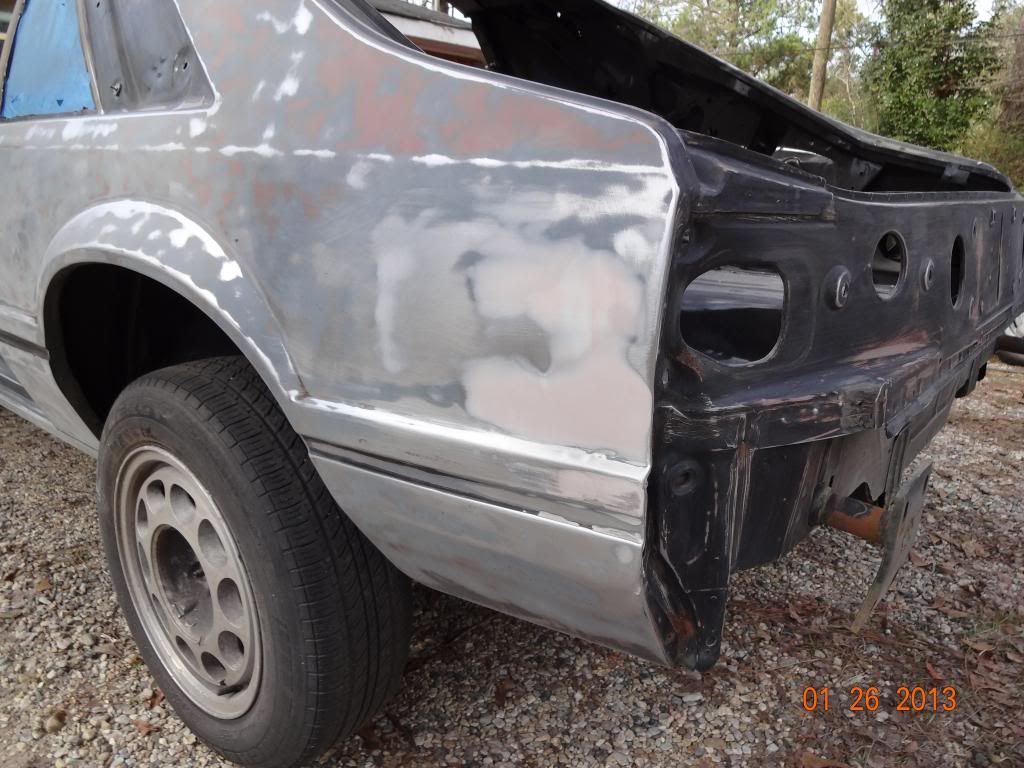

Quarter panel is smooth, flat, and ready to go!!!
She's ready for the sealer

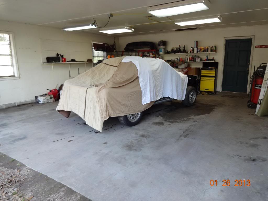

No time today though so I have her ready for first thing Monday morning!!!
