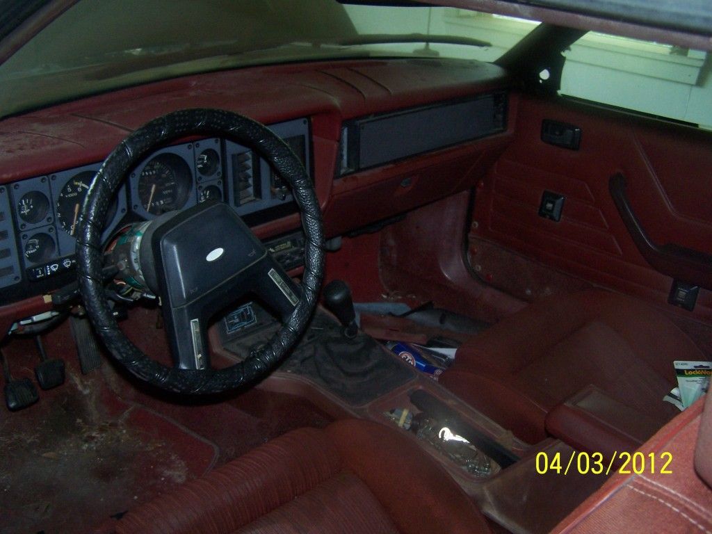

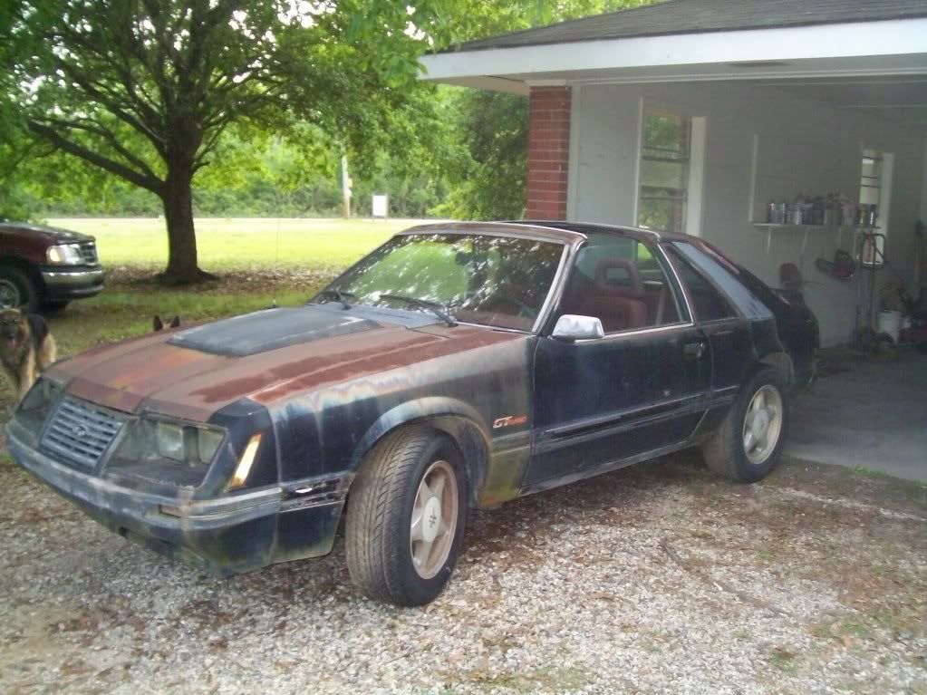

I bought this car back in April of 2011. It had been sitting in a driveway for about 10 years when I went by to ask the man who owned it if he would be interested in selling it. I had passed by this car many times thinking it was a 5.0 car not realizing it was a GT Turbo. When I saw the sticker on the side my heart fluttered and I knew I had to have this car.
I had just finished my 85 Convertible and luckily I was in it when I stopped by. The old man told me that the 77k on the odometer was original miles, (I have no proof of that other than his word) He also told me that he has ran hundreds of young punks away through the years that wanted to by it but seeing what I had done to the Convertible he said he knew the car would be in good hands. So he sold it to me. I didn’t tell him that I was one of those young punks he ran off about twenty years ago when I stopped by and tried to by a 68 fastback he had sitting in his field and eventually rotted away. I figured I better keep my mouth shut.

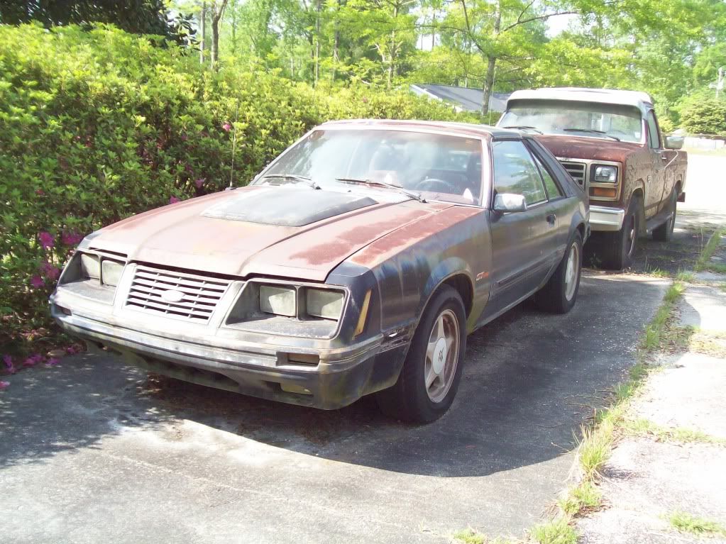

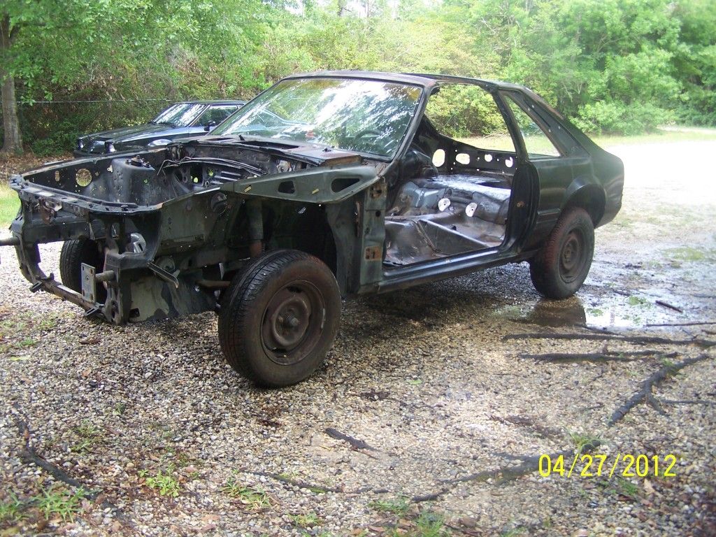

This is what the car looked like when I first bought it. The elements were not kind to it but it was solid and complete. Also discovered it had a blown head gasket thus the reason for it sitting up. This is where it sat for 10 years.
It's new home

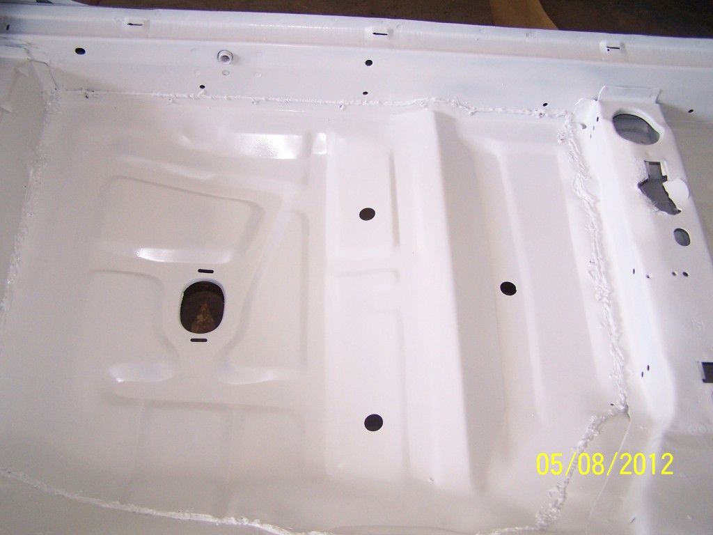

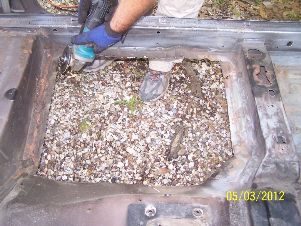

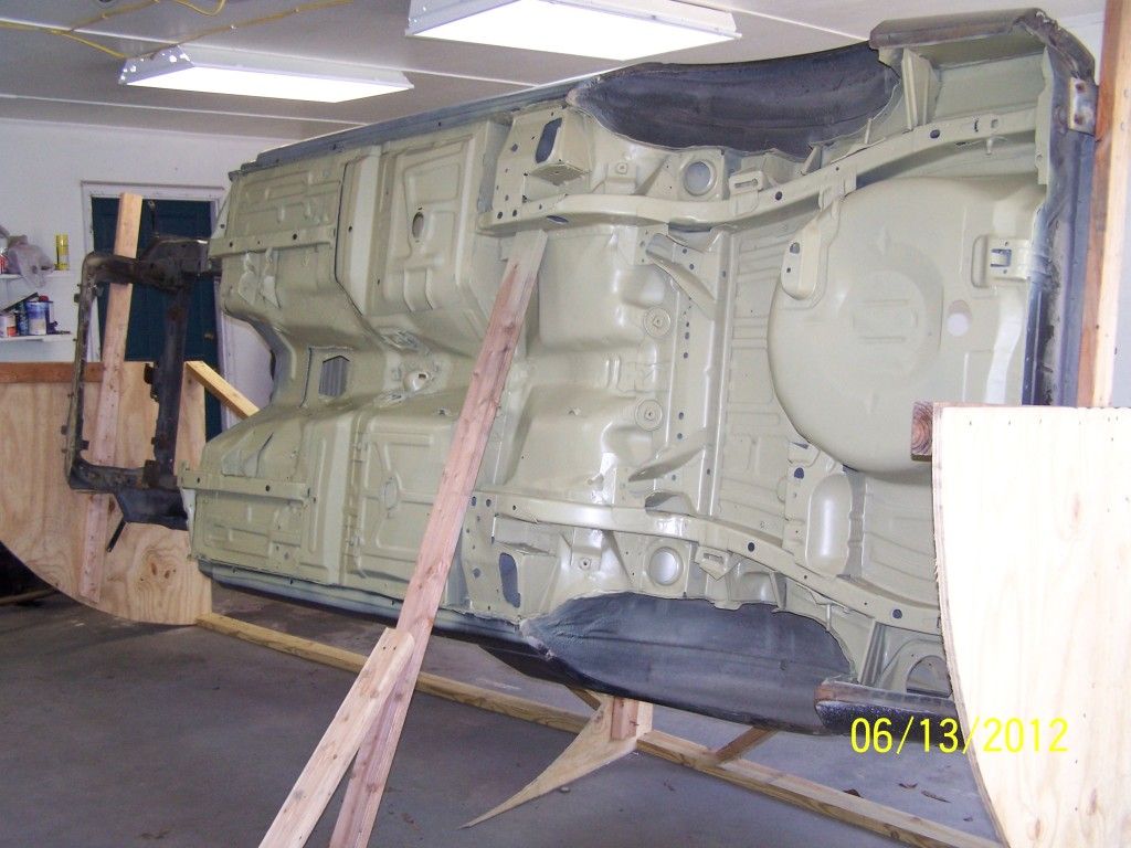

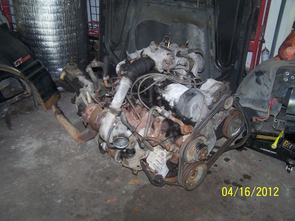

In April of this year I tore the car down

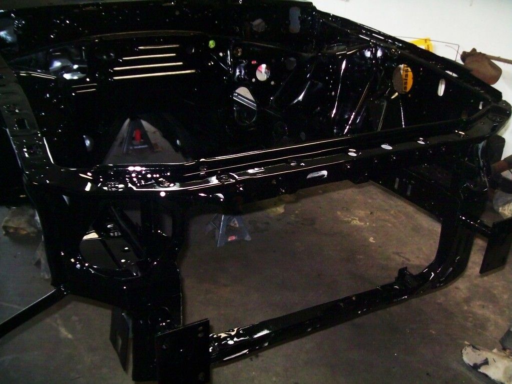

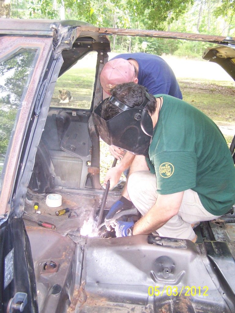

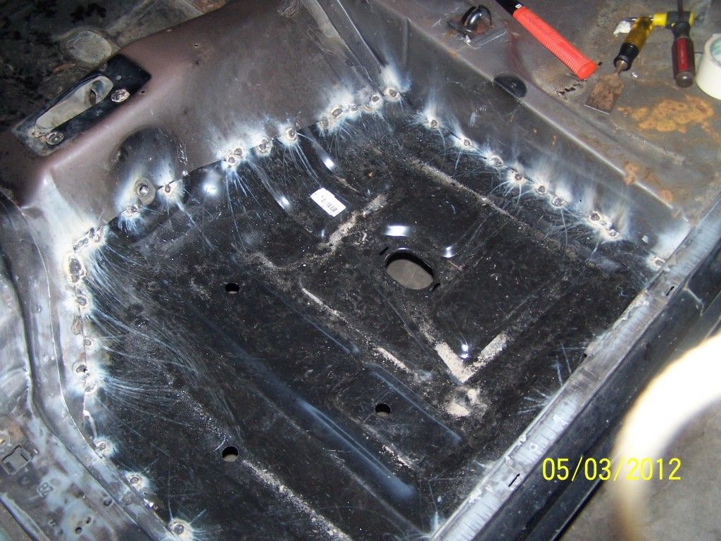

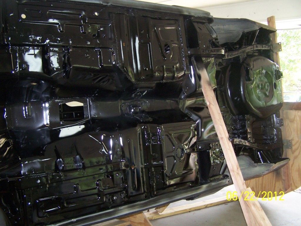

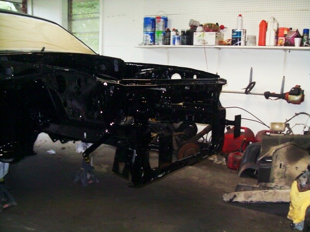

Cut out the old put in the new

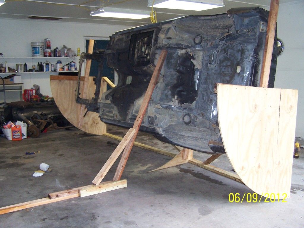

Then me and a couple buddies made a redneck rotisserie and flipped her over onto the side
Glad you started your resto thread. Your EFI Turbo is looking great. Super pic's on the restoration process. The rotisserie looks interesting. It looks to work well.

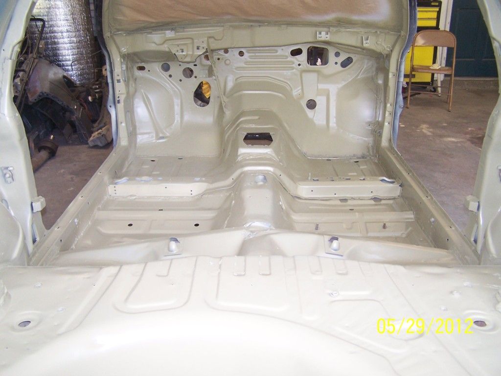

May I ask what type of primer or primer surfacer you used on the floors? It looks to be 2-part?

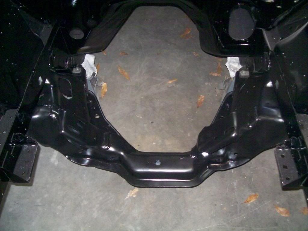

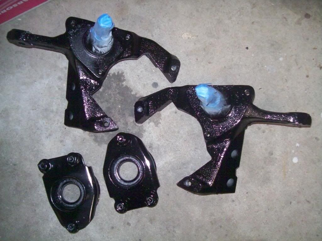

Now to the suspention

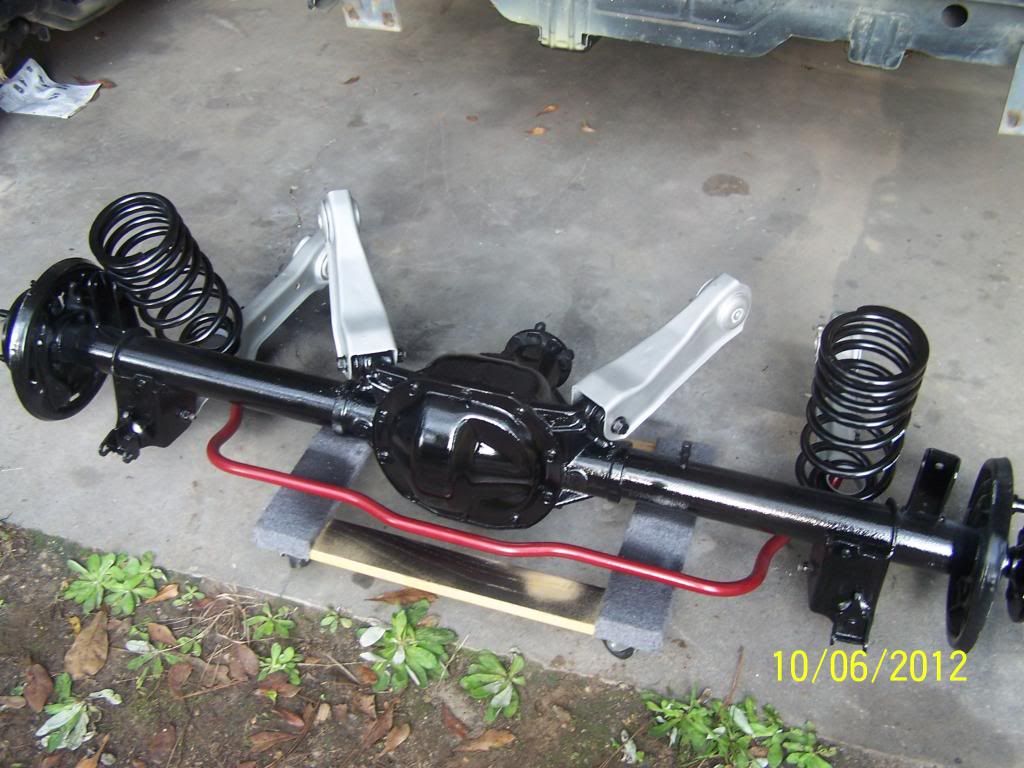

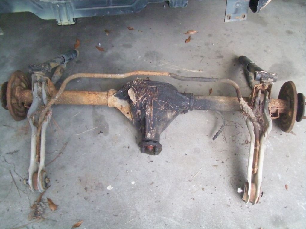

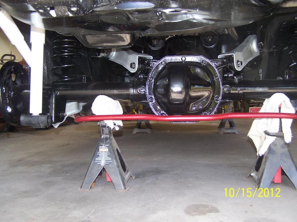

Stock 7.5 3.45 gear rear

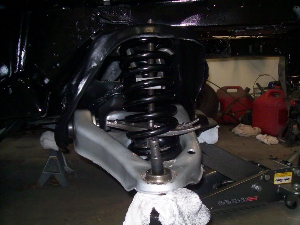

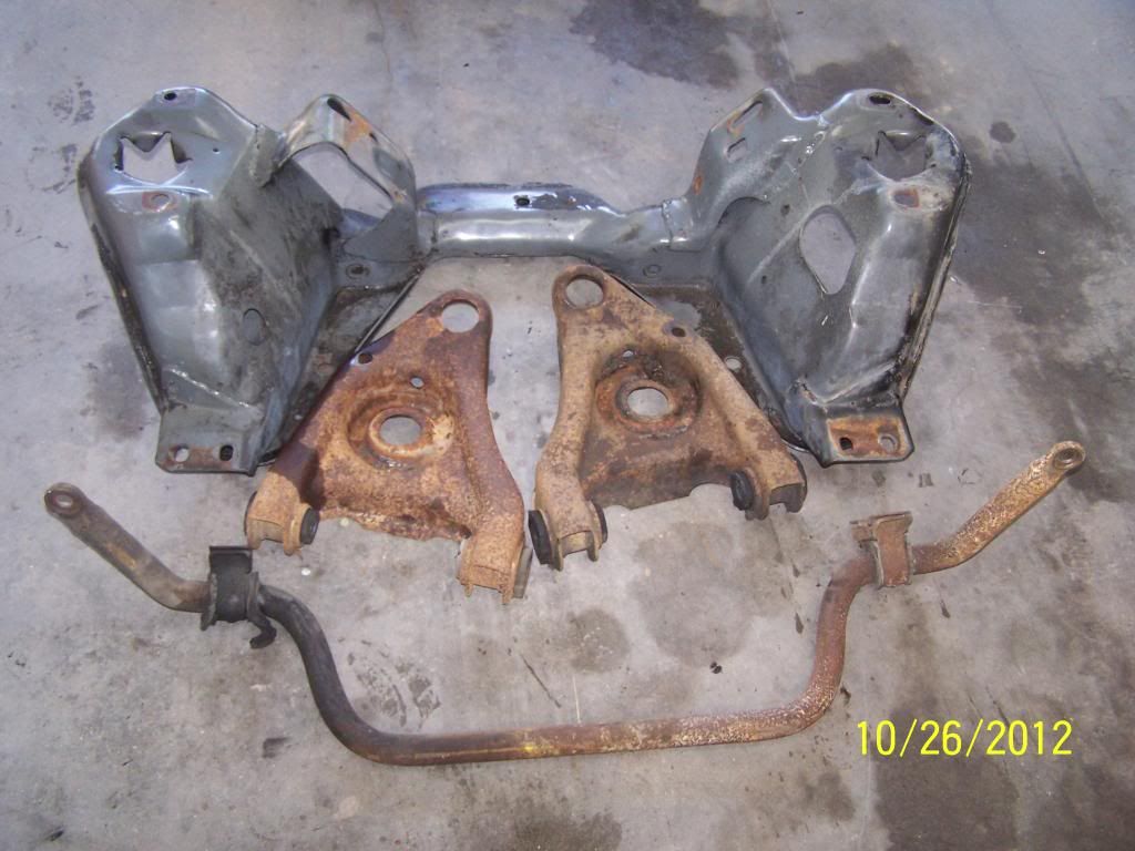

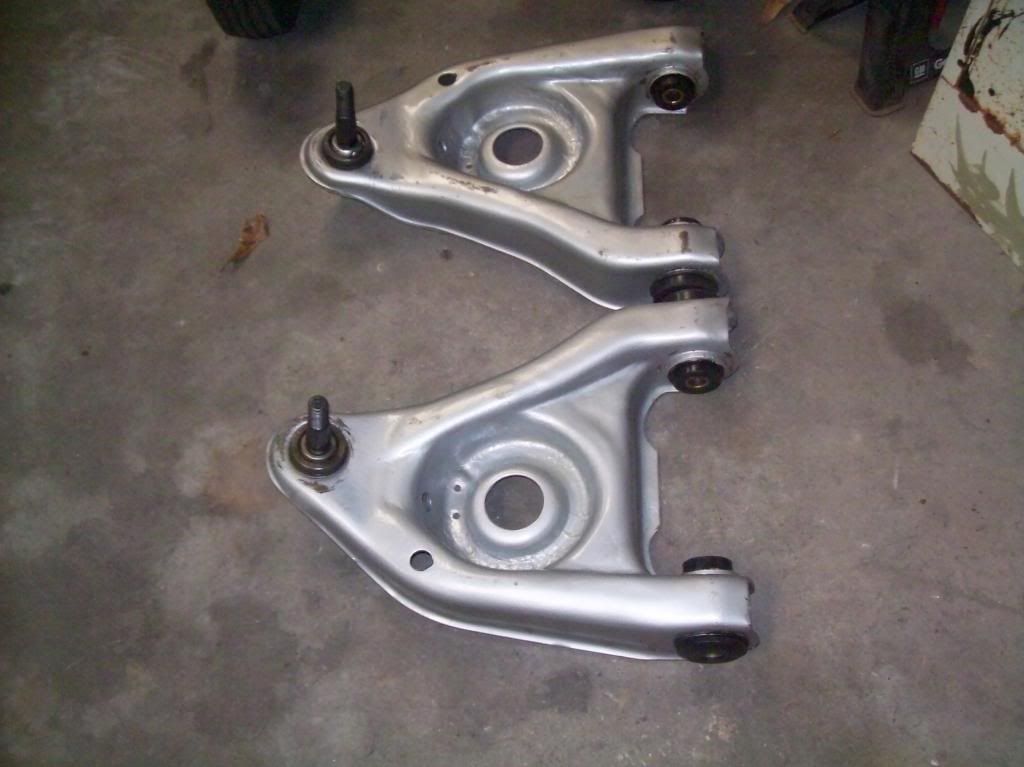

Old rear made new again with my FMS B springs. I kept the old upper bushings and replaced the lower ones.
My bushings and ball joints for the front end
The front end is now ready to go back together. This is where I am to this point. I will keep you up to date.

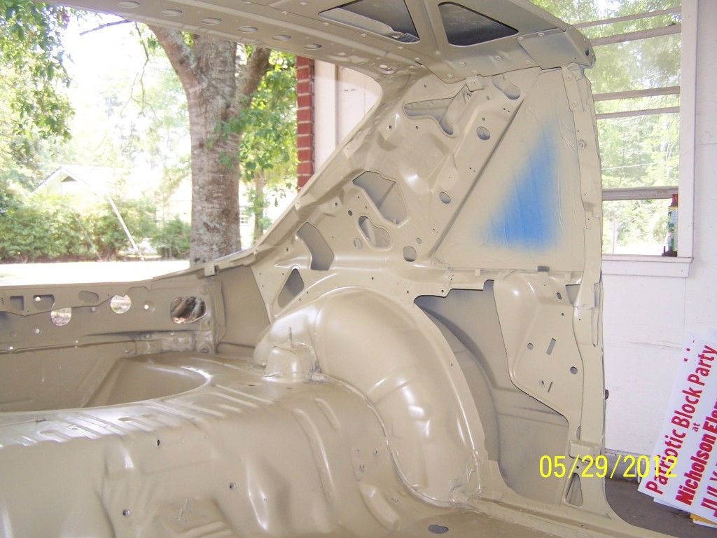

Thanks!!! I used self etching primer and single stage lacquer finish on the underside, inside and engine bay.

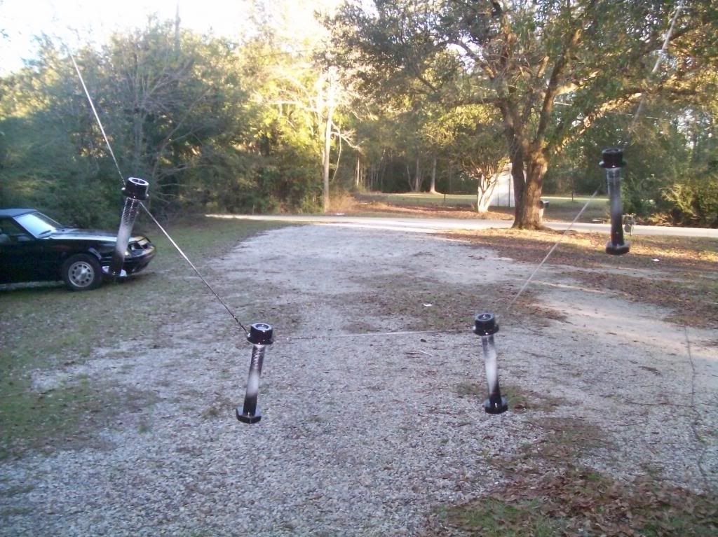

This is how I paint my bolts. I know there are many ways to do this but this way works best for me. I try not to get any paint on the threads and take a wire brush and clean any overspray that gets on them after they are dry.

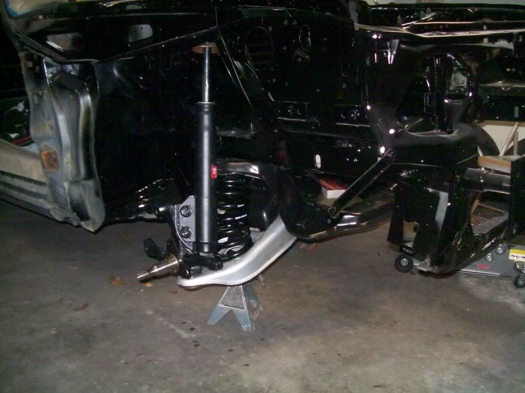

I ordered my steering rack today and it should be in Monday. Once I put it on my suspension will be done. All I have to do now is put my rotors on and I will have a roller again. This is the rack I ordered. http://www.latemodelrestoration.com/item/LRS-3504A-KIT/85-93-Mustang-Power-Steering-Rack-Kit-50L

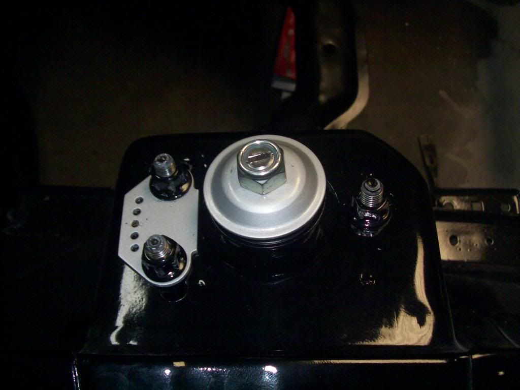

I have to say installing the springs was a major job. I rented a spring compressor from Autozone but getting it out once the springs were in was a little tricky. As you can see I chose not to put the dust covers back on the struts. My new struts didn’t come with any and my old ones were in bad shape. I won’t be putting allot of miles on the car and will be very particular as to where I drive so it should matter.
