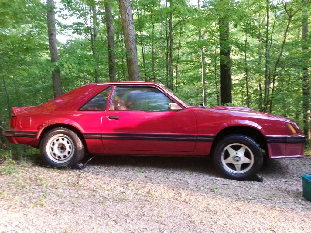

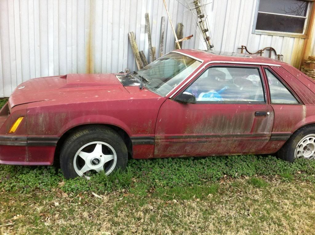

This is what it looked like the day I bought it:
It has a 302 and c4, although, it was originally a 4spd. I will eventually switch it back to manual, but that will be a while. It appears to be mostly complete. The interior is all there and not completely trashed. The body is surprisingly rust-free, from what I can tell. It has been parked outside for many years...not sure exactly how many, but the exterior is covered in moss and mildew. Mechanically, I know that it needs the drive shaft installed and the ignition hooked up. The previous owner was in the middle of working on it when it was parked, I guess. Hard to say what else it will need, but I'll find out eventually.

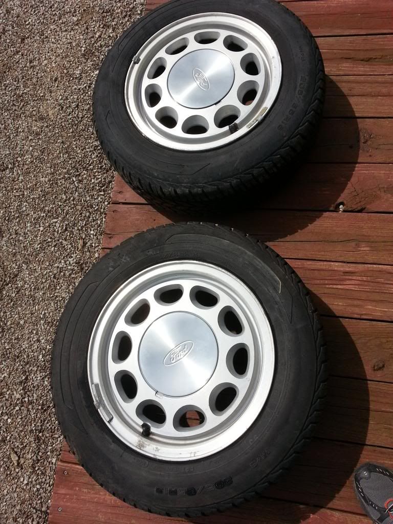

I found a couple 10-hole rims to match the rear at a local junkyard. I haven't put them on yet because I'm using them temporarily on my '88 project.

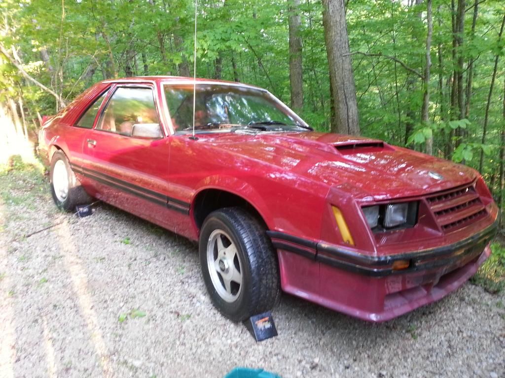

Here's another view of her parked at my house. I need to get it running so i can pull it up into my upper driveway spot, where it's flat. Until then, I can't do much.

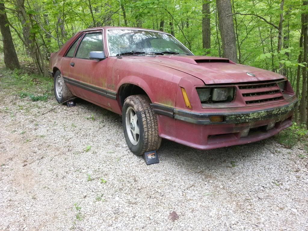

But I did stretch a couple hoses out today so I could start cleaning her up a bit.
After getting most of the years of crud off of her, I was pleasantly surprised to find the original paint really wasn't in as bad of shape as I thought.

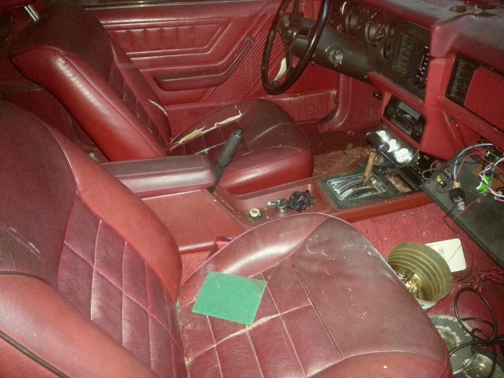

Took a couple pics of the interior this evening.

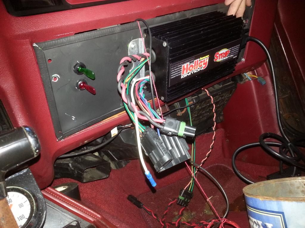

And the Holley Strip Annihilator setup. I don't know anything about this, but I don't think I like it. I spoke to the previous owner today and he said the car was parked around 2003, as far as he could remember.
The two switches you see are the fuel pumps. Can anyone tell me if i can just bypass the system and run a regular fuel pump? I know nothing about this motor, other than it's supposed to be the original motor that came in the car. The glove box is unmolested and lying in the back seat. I'd love to get rid of all this junk.

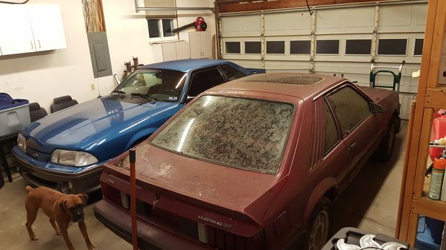

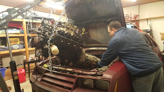

If anyone has been following along on my 88gt build, you know that I recently moved it and this 82 into the garage at our new house.

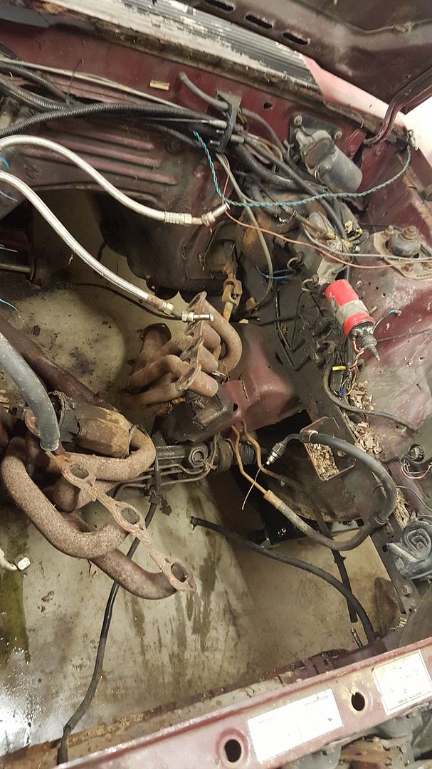

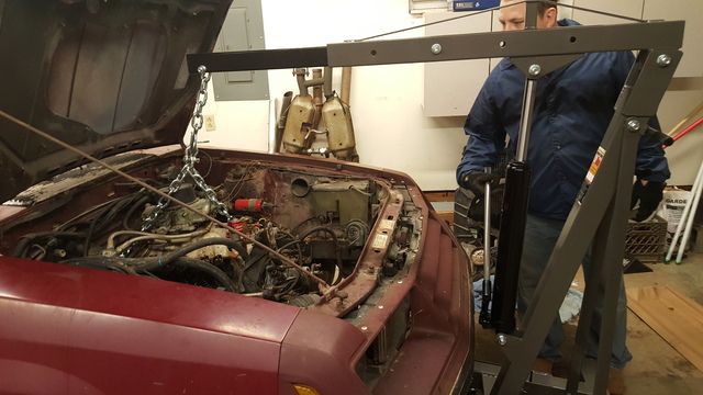

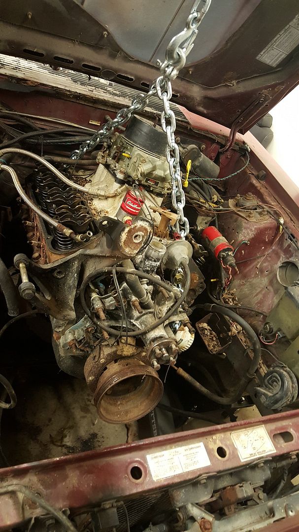

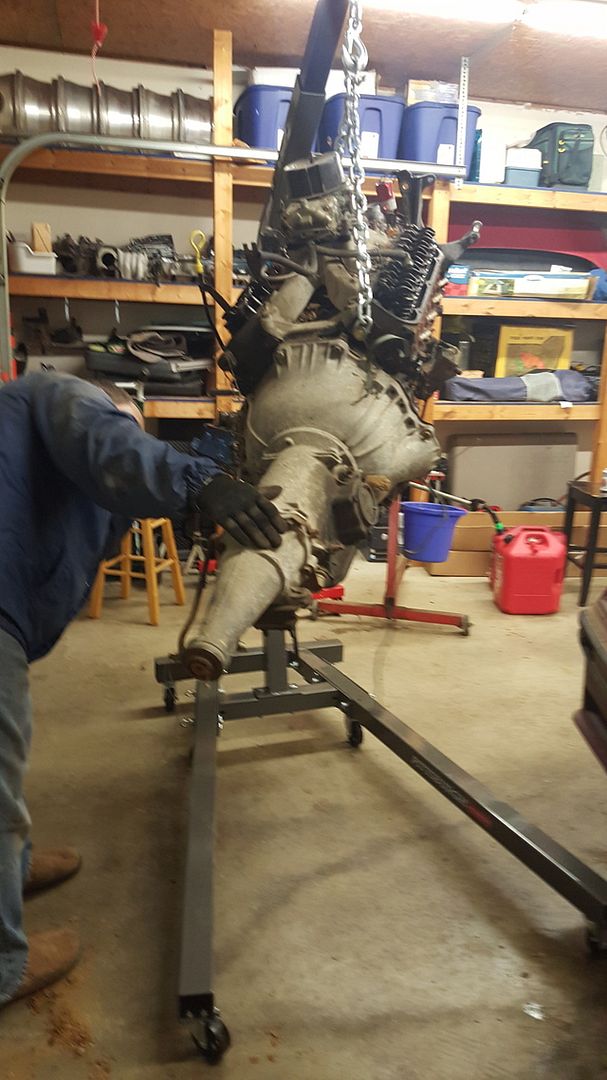

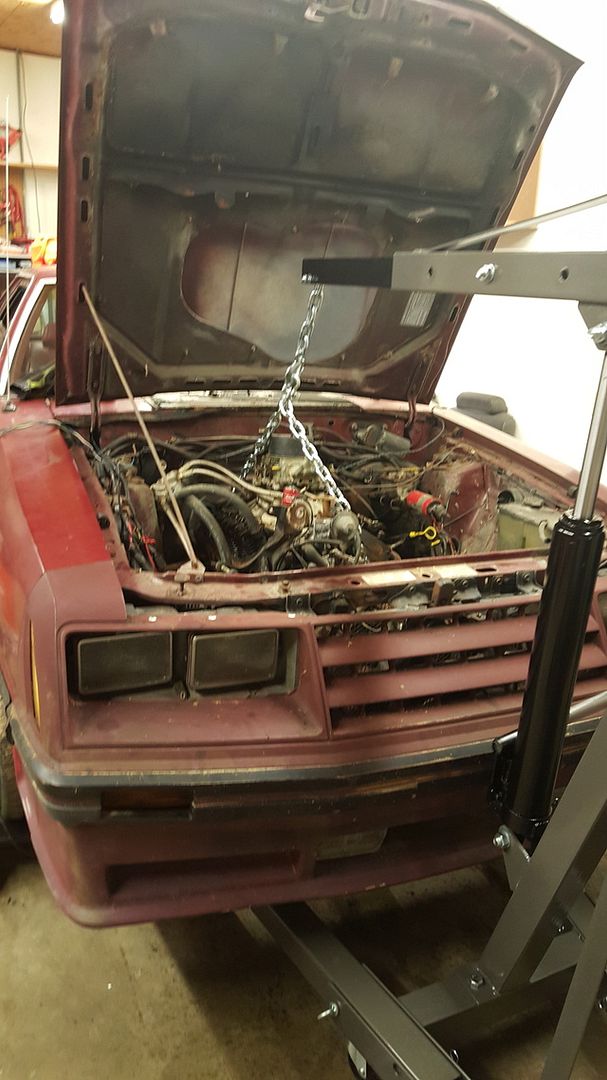

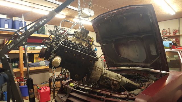

Got the crud cleaned off the outside and it sat around for a couple months while we were getting settled in. Finally started working on her a couple days ago. Got the motor and transmission out tonight.

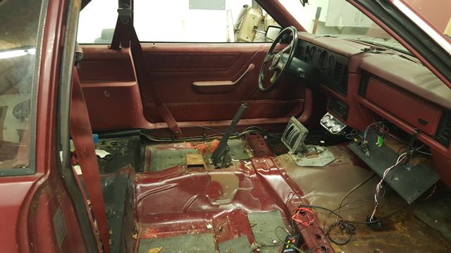

So that's where I'm at now. Next, I plan on stripping the interior. While working on the car, I've come to the conclusion that the hood and hatch both need replaced. They have a little rust. Not a lot, but just in bad areas. Hard to repair, so replacements make more sense. The shock towers look pretty good. Only the slightest amount of rust on the passenger side, but I don't think it will take much at all to repair. I did, however, find I soft spot on the passenger floor board. Looks like I get to try my hand at either patching it or replacing the pan. I'm really looking forward to pulling the interior, so I can get a better look at it.

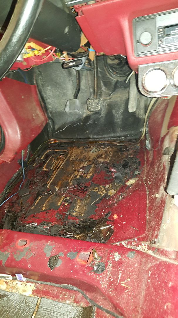

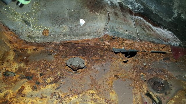

Got the interior pulled today. No more rust to speak of, really, but the floor pan rust is a bit iffy. It looks like it is rusted at the front edge of the pan. No big deal, but the rust extends up an inch or so into the slanted area. Replacement floor pans don't appear to include this area. I guess I'll have to piece in a little metal when I replace the pan. I really may just end up patching in some sheet metal pieces altogether. The rest of the floor pan looks perfect. It's just the leading edge that's bad.

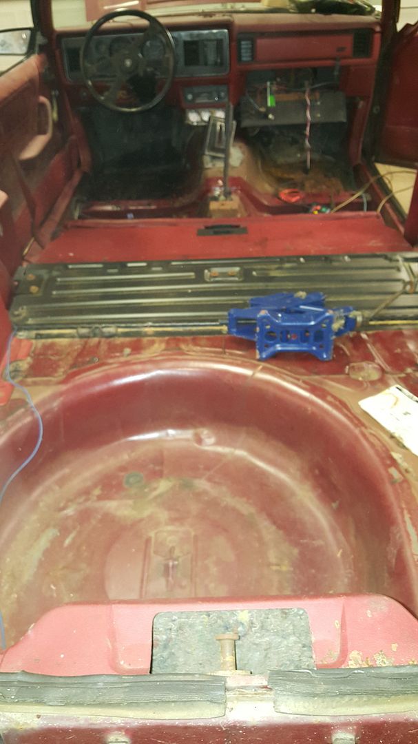

A few more pics of the stripped interior:
Here's a pic of the drivers side floor. I was concerned about this side, because it was pretty wet. I scraped away the soft material to get a good look at the metal and it looked fine. Surprisingly, the passenger side (which was rusted) was bone dry. Go figure.

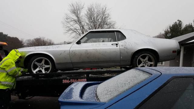

Another set-back on the 82. I, being the king of "too many irons in the fire", couldn't pass up a deal on another project car. This time, it runs and drives. Plenty of rust, of course, but I think I'm going to focus on getting some work done to it first. It makes it go a lot quicker when you have a running vehicle. I can move it around as needed. The 82 is just slow to get going, since it isn't mobile. I did buy a cheap welder and started practicing a little. If I can get it down, I'll try my hand at a little more in-depth body work. There's plenty of that stuff needed around here lol.
Anyway, here's the new project:
1970 Mustang Coupe. It's a 302 car, auto...but I'd like to put in a 4spd toploader at some point. Needs floor pans, trunk floor, rear frame rails, and a few other spots repaired. This is the heart of the rust belt, so all things considered, I've seen much worse.

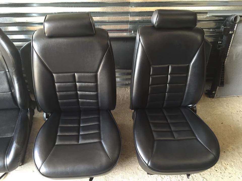

The 82 is still on the back burner, although, I'm always keeping an eye out for good deals on parts. For instance, I picked up this set of front seats last week for $125.
Looks like I'll be changing the interior color, after all! I had been contemplating it anyway, since the seats, carpet, dash pad, and headliner all need to be replaced. Plastics really need refinished, too. So basically, that leaves the dash hull and and door panels I'll need to figure out.

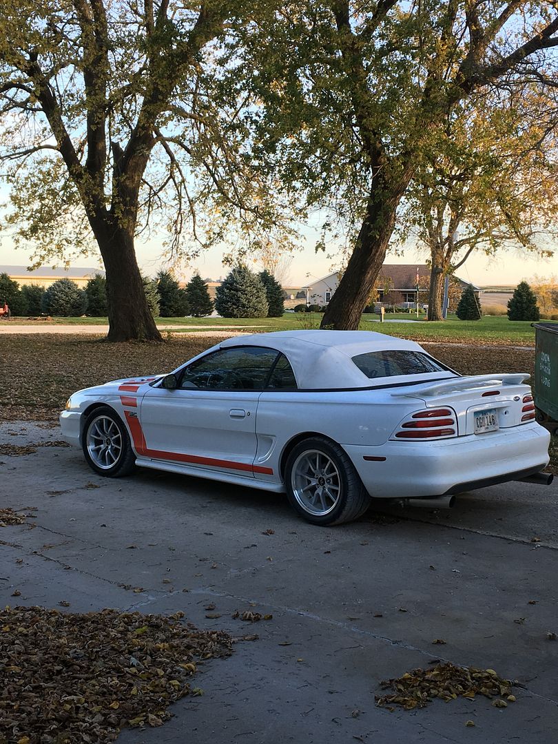

you sound like me, too many irons in the fire lol. My Dad decided to move into the nursing home this summer so I bought his 94 gt convertible, and 94 gt coupe. I have not been on this forum for a while because I have been working on the convertible. I plan to start on the coupe this winter.
but I just decided I want to supercharge my 89. When I built my 331 stroker I built it with the idea that I would supercharge it some day, and hopefully this summer it will actually happen.
