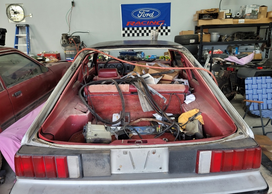

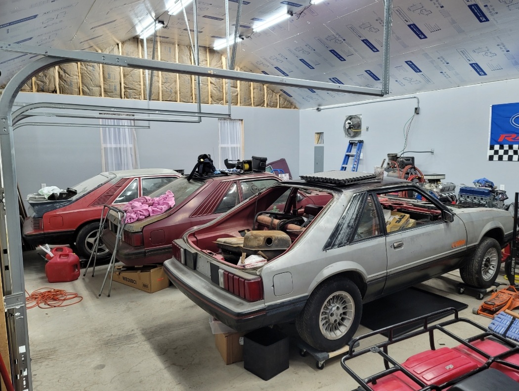

    I got rid of my 1970 coupe to make room for amother project fox. A 79 cobra. It appears to be all original, other than wheels and an aftermarket cassette player. It didn't run and has been stored under a tarp. State inspection shows it was last on the road in 2000. There is a lot of surface rust on the top surfaces, but repairable. The only real rust i have found is the rear hatch (I already have a good replacement) and the very bottom of the radiator core support, which will need replaced. Shock towers, frame, floor pans, torque boxes and even the fuel tank are clean.

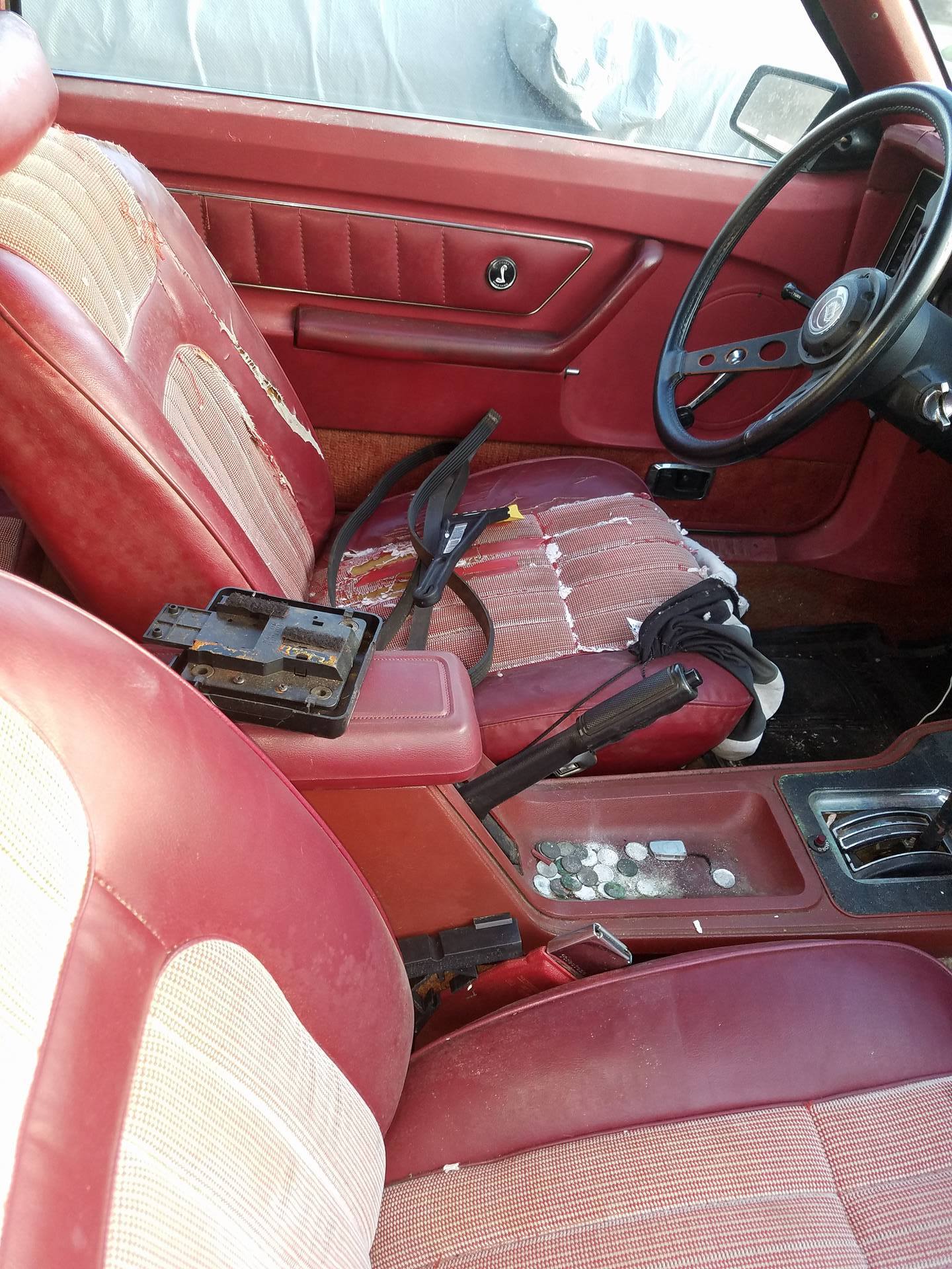

    The driver's seat is trashed, but the rest appear to be fine. I was able to find some nos material to have the one seat recovered.
    I filled the crankcase completely full of diesel and let it sit for a week or so, while my hand was healing from a nasty dog bite. Once I regained use of my hand, I was able to turn it over freely. A buddy came over and we tinkered with it. Rebuilt the original 2 barrel carb, did an extensive tune-up, replaced battery and cables, and she fired up. Not running great, but I suspect some vacuum leaks and ground issues. It was pretty crusty under the hood.

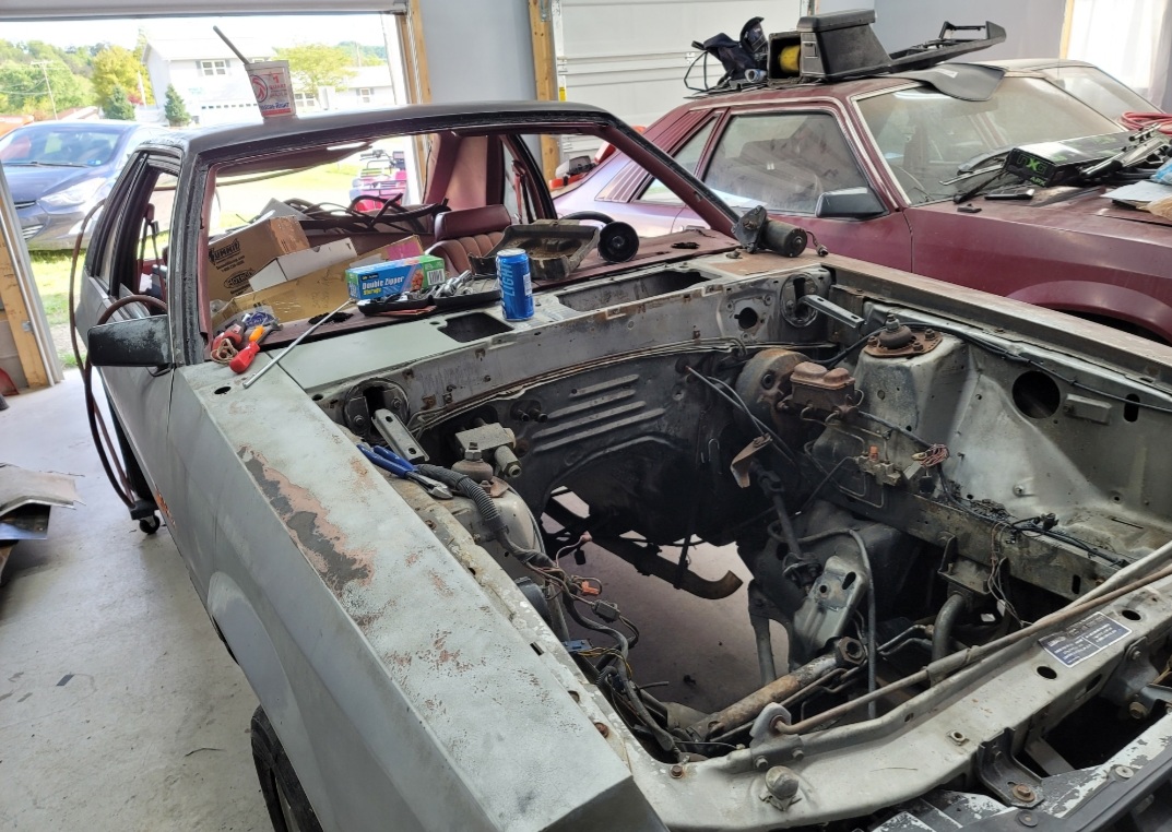

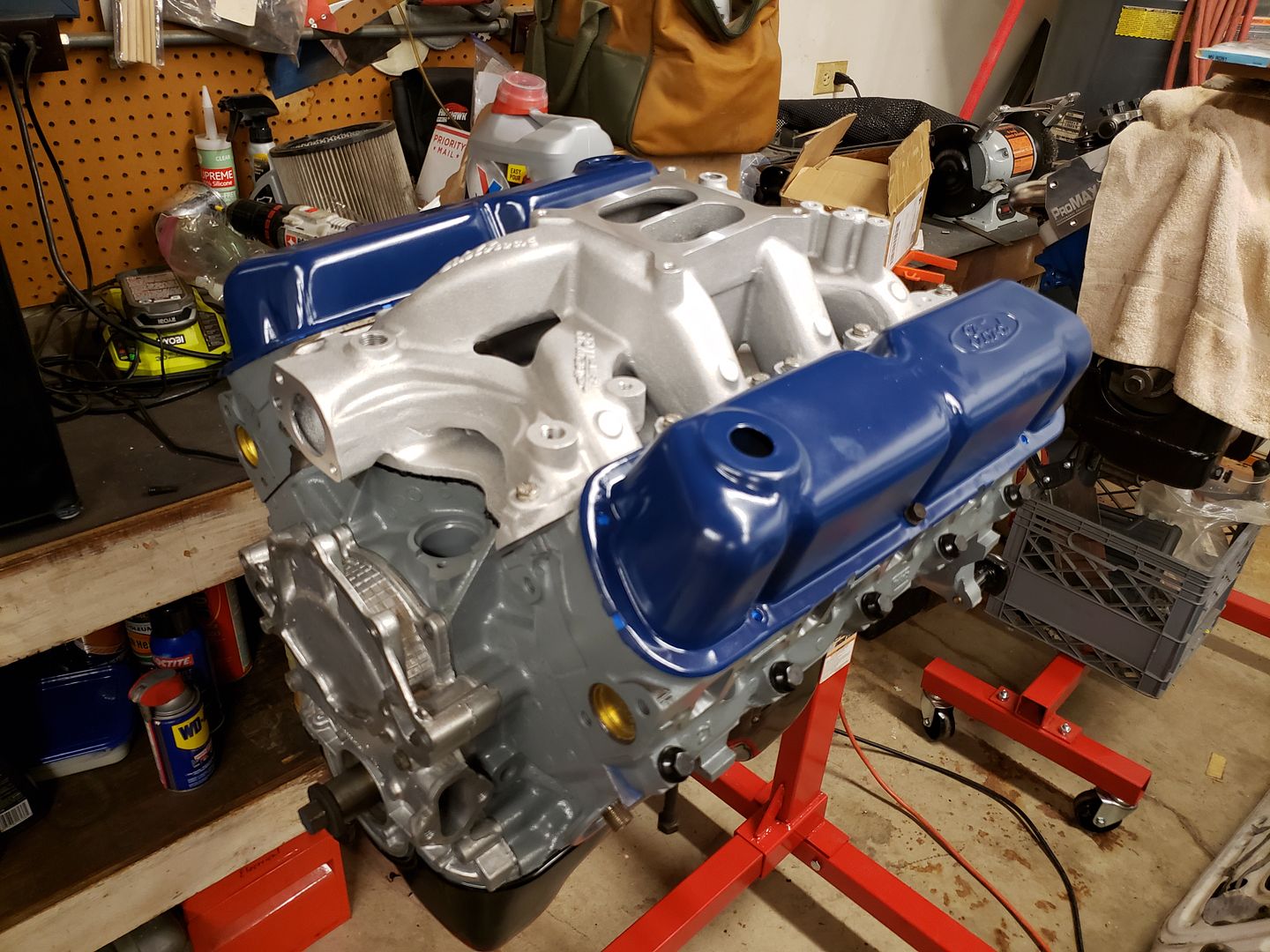

    Pulled the motor and transmission. Closer look and I found a spot of rust at the passenger frame rail...lower shock tower. Not bad, but I plan on repairing it before it gets any worse.
    I also decide to switch directions again. I picked up a low mileage non-ho roller 302 and stripped it down to the short block. Just going to stick with the original plan of a mild-build cruiser. Keeping ac and c4 tranny.
